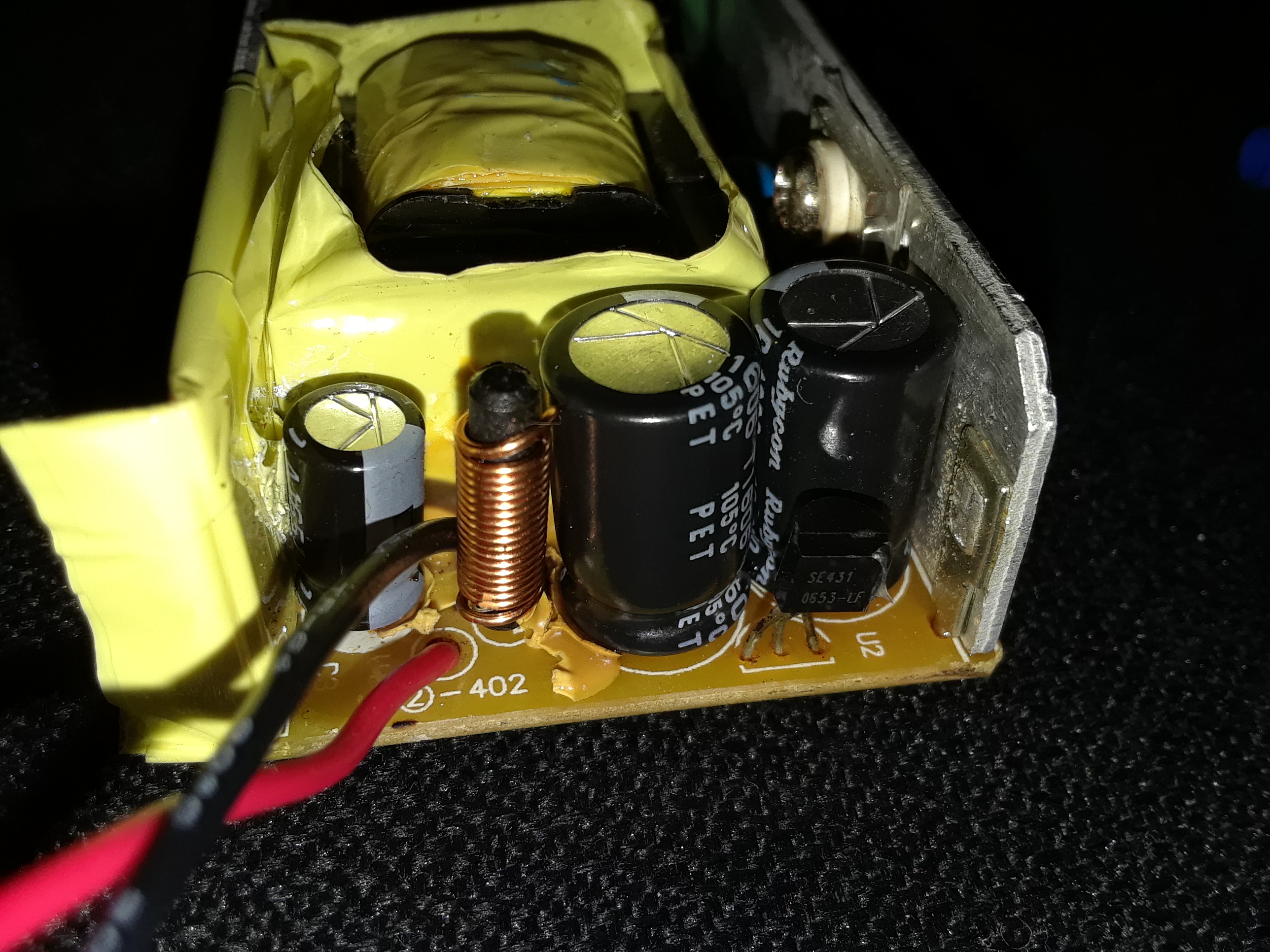

some dead capacitors in a 9v 2.6A power supply
Re: some dead capacitors in a 9v 2.6A power supply
Some cheap chinese power supplies are doomed, as the caps are simply too small - physically and electrically, to last. It has little to do with the make/brand of the cap, more to do with the ripple/ESR heating.
I would look at the ripple current spec. - here it's quite high for most caps, especially at 2.6A output split over 2x1,000uF+220uF low-profile parts.
Sometimes I add an extra bulk capacitance on the output when I need long life.
Panasonic EEU-FR1C102 1,000uF 16V D=10mm H=16mm 1.79A ripple 8,000hrs
I'm not sure how this thread is still alive.Some cheap chinese power supplies are doomed, as the caps are simply too small - physically and electrically, to last. It has little to do with the make/brand of the cap, more to do with the ripple/ESR heating.
P.S. I prefer a "POPcorn" capacitor brand over "BAcon" brand. If you smell popcorn, it's over
I know it's been a year since i made this but i finally got around to fixing this stupid thing and it works. (even when it's under full load)
Photo of the new caps....
I removed as much of the cheap gule as i could and i'm currently waiting for some silicone glue to cure.
The silicone glue is made for electronics and i used it on a different power supply and it did not do any harm.Attached Filesif you find these attachements useful please consider making a small donation to the site
