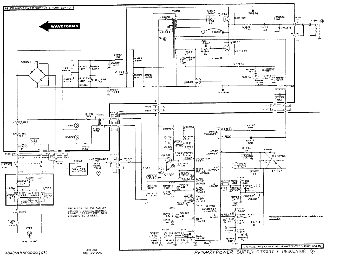

    I'm working from the schematic for sn 500000+. If you look at the logic diagram for the switch they are switching RC networks in and out. Should be able to test basic functionality across the switches, open/closed, in circuit. It's possible that the switch is setting an "invalid" combination that just happens to be off by a factor of 10.
    Good luck and let us know what you find.

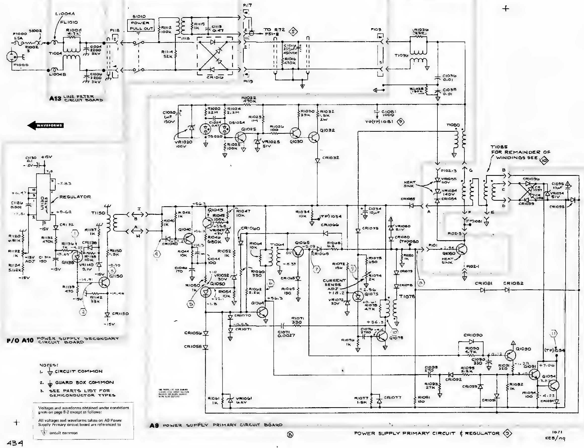

                    Found cold solder near diode bridge now have 325vdc at Q1080 and collector of Q1032 but no low power supplies no lights come on mmmmm.

                      I am looking at service manual pdf pg192/199 primary power supply & reg. for Tek434 s/n 500000 up; Is that correct, because Q1834, Q1844 are the bridge and you are at Q1080, Q1032 ??
                      If I have right SCH, It's an odd SMPS design, but fortunately transformer-drive so a bit easier to work with. Use extra care because U1910 is probably a rare custom IC.
                      It appears to be a self-resonant design that operates full tilt until the control IC U1910 comes up and stops cycles. Start-up happens with Diac VR1831 at 32V.
                      Can you carefully take voltage measurements around the bridge transistors and diac, using DC bus (-) TP1844 for multimeter GND.
                      If the PSU does not come up I think SCR Q1846 overvoltage trip activates and may get in the way of troubleshooting.

                        redwire - that's the schematic that I posted. John I believe has a scope with s/n below 500000. That may be the confusion in the Part #s
                        John - could you post the schematic you're working from? I'm getting a little older and slower and need all the help I can get....

                          Yes guys s/n BELOW 500000 at Tek wiki.
                          How do you think I feel guys I messed about for hours with the cal T/B sweep sorted frequency was really pleased with myself waited couple of days then decided it was good.
                          Put all back together and shorted. Won't repeat what I said.
                          Anyway at moment have 325vdc at p119 also at Q1030, Q1032 Q1080 no low voltages no front lights I am working my way through previous posts I have a feeling that the short is on the secondary board. Tested all transistors on primary board all good (out of circuit).
                          Have 94vdc at c1020 but no 51v Zener tests good.

                              Service manual for Tektronix 434 s/n BELOW B500000 (1971) is here, 17MB PDF is best. Attached snippet.
                              The power supply is all discretes verses the change to custom PWM IC for S/N 500000 up. A bit of extra 'fun' to figure out. May exceed alcohol budget for the month.
                              There is a 56V regulator (Q1032, Q1030, VR1025 51V zener) which supplies the PSU control circuitry. See if it is alive at C1034 or CR1032.
                              The "turn-on circuit" to initially turn on main switching transistor Q1080 (pdf pg57) is the Q1045, Q1040, Q1050 circuit. I think it (Q1050) keeps firing trying to start up the PSU. I would measure around the start-up (oops "turn-on circuit" as Tek calls it), if you have 56V present, and see if it is pulsing.

                                C1081 has 325vdc on each side not across it.
                                • redwire
                                  • Dec 2010
                                  • 3912
                                  #116
                                  Re: Replacement caps for Tektronix 434 Power supply board.
                                  That's fine, just means you have 325VDC primary at C1080.
                                  What about 56VDC rail across C1034? You can't have a party without 56VDC
                                  • John McGivern
                                    • Dec 2013
                                    • 195
                                    • uk
                                    #117
                                    No 56vdc. Either side of cr1032.
                                    Collector of Q1032 has 325vdc. I tested 51v Zener in circuit tests good with diode function on Dmm.

                                      With 325VDC present, the 51V zener should have around 51V across it.
                                      This then feeds Q1030 and Q1032 to make the 56V rail. I would test those transistors or measure their voltages.
                                      If the 56V rail is overloaded, I think R1032 will cook but you measure 325VDC on Q1032 collector, so R1032 must be ok.
                                      Q1025 is a (mains) overvoltage lockout and that transistor should be off. This is the only thing that could shut off VR1025.

                                        What do you have on the base of Q1030 and Q1032? That will narrow down where the 325 isn't getting through.
                                        While your measuring take a look at the emitter of Q1025 to make sure it hasn't turned on.
                                        Just as an aside it looks like there are 2 neon lights on the schematic, are they on?

                                          The neon lamps DS1024, DS1020 are apparently part of a 5 second oscillator for Q1025. It looks like the 56VDC rail is briefly pulsed off when the neon lamp fires. Might be hard to see the blinks.
