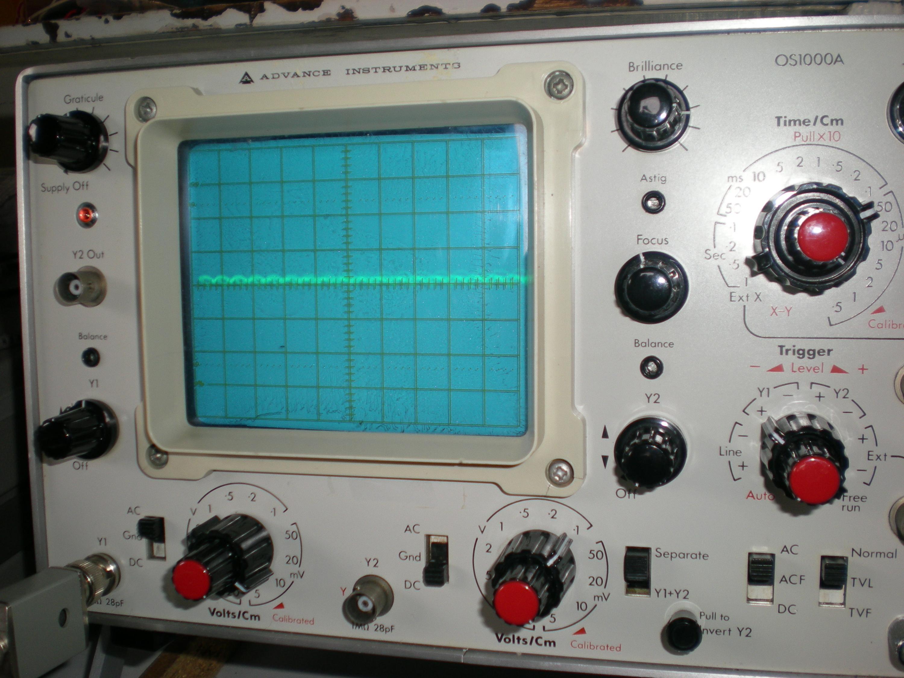

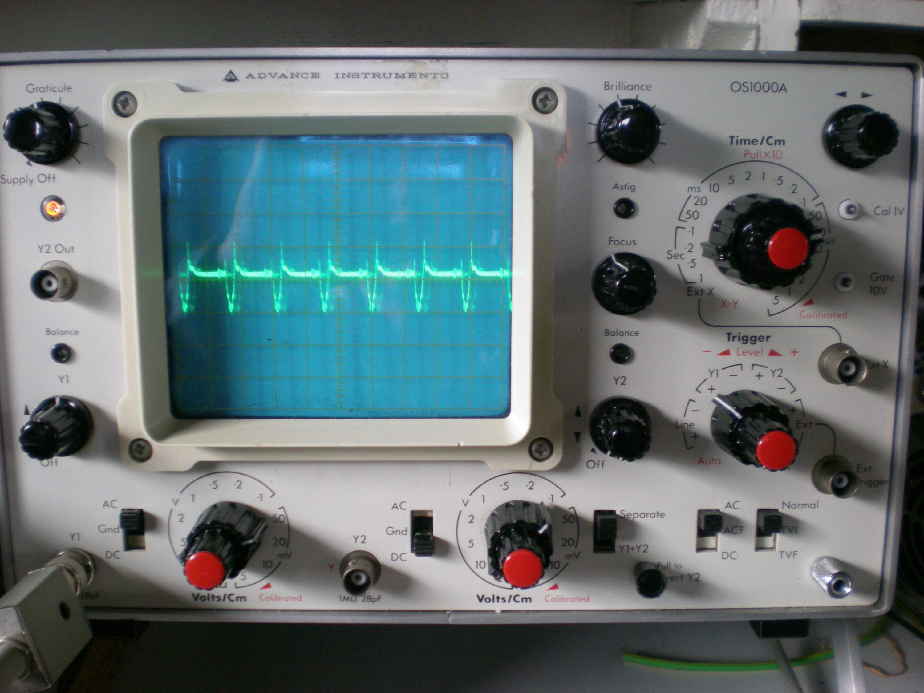

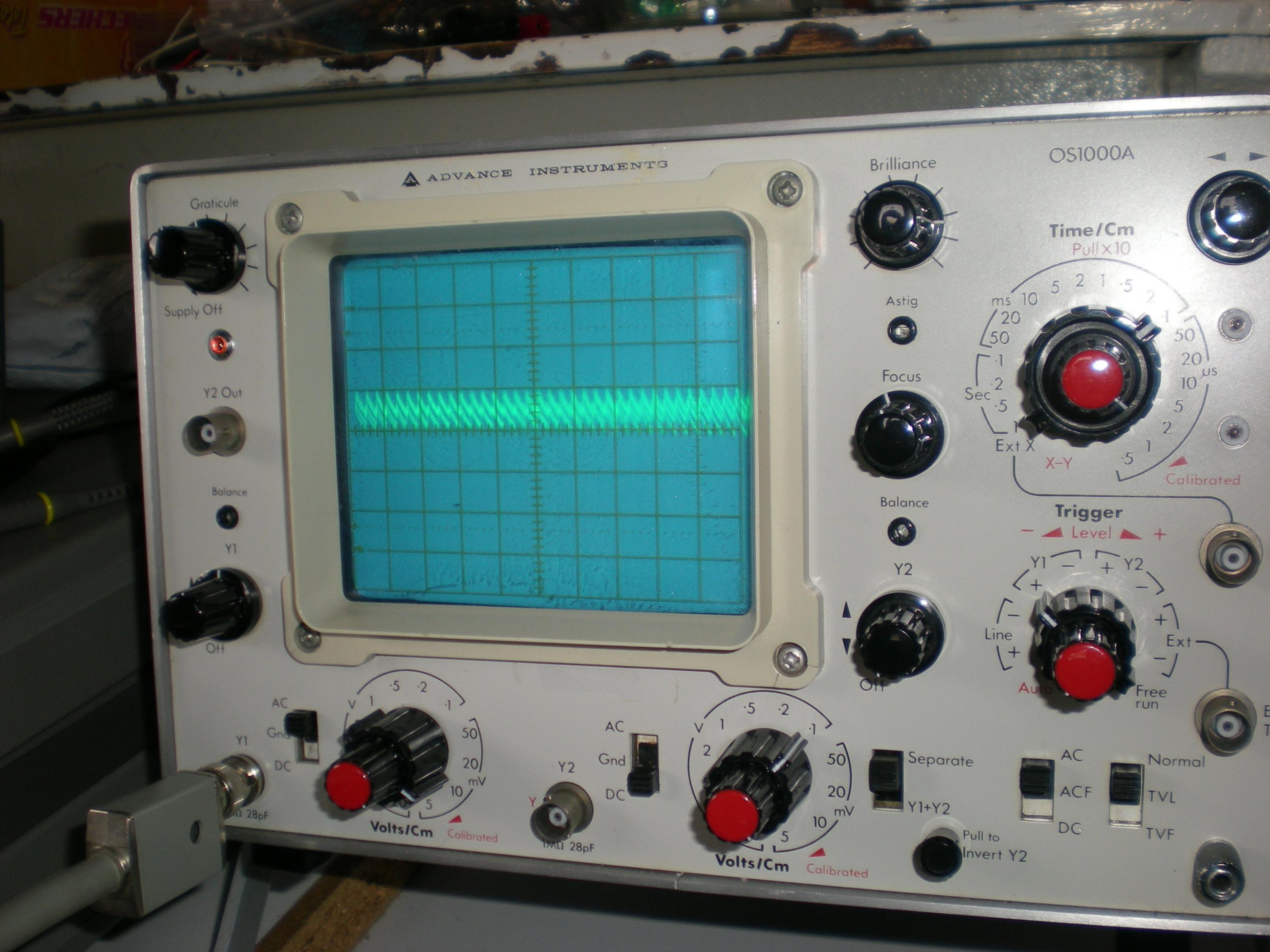

Check +/- 15 volts. Are both these lines free of ripple? (25KHz is your switching frequency). Are those 3 diodes really shorted?
