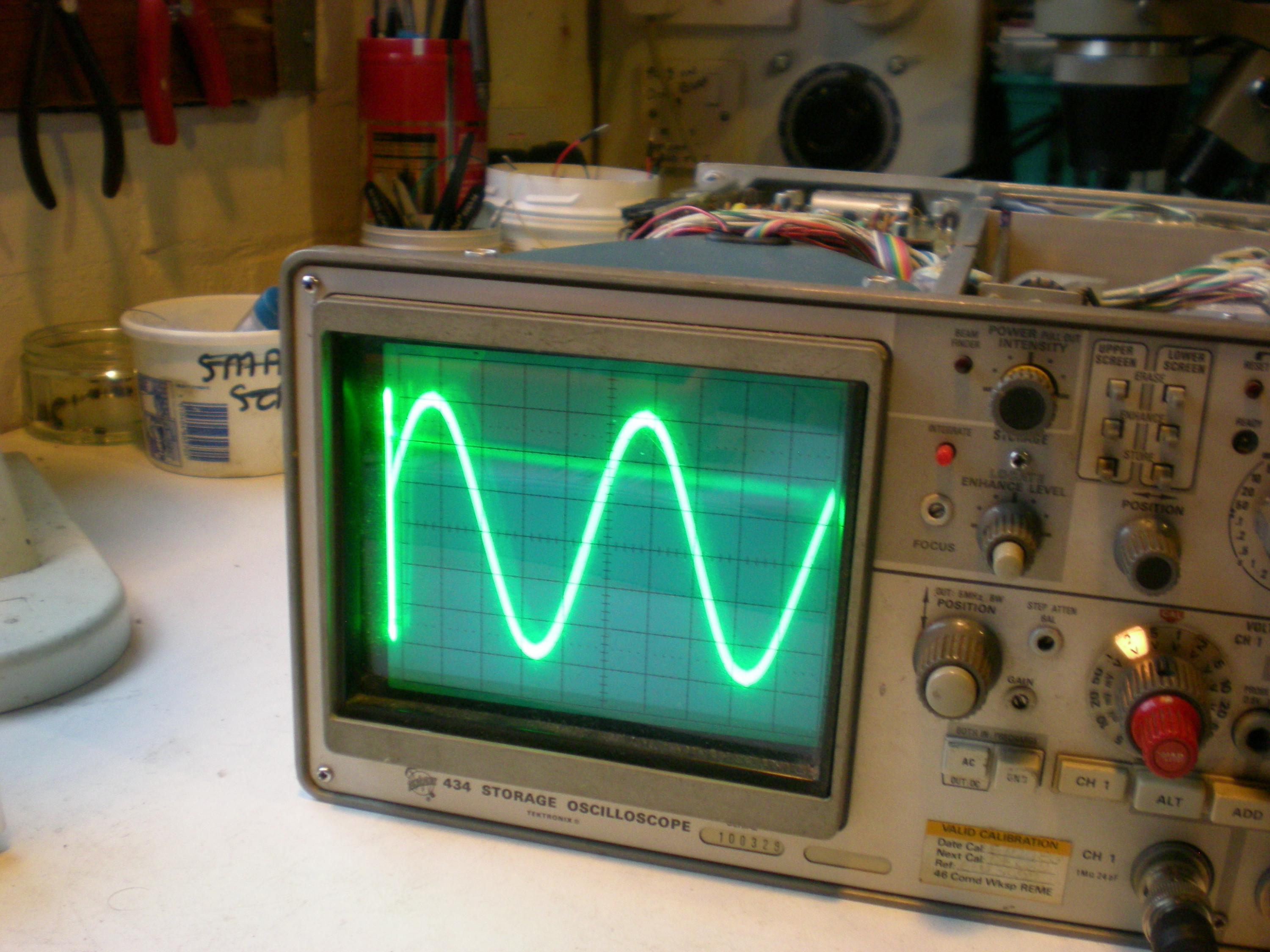

                              Intensity no control still too bright.
                              when turning knob anti clockwise stops at 8.0Vdc fully ccw 89Vdc. TP 924
                              Can anyone explain whats going on here simple sine wave from generator.
                              See photo.

                                Re: Replacement caps for Tektronix 434 Power supply board.
                                Originally posted by John McGivern
                                I still have problems with bright trace, focus and triggering.
                                Pick one. I recommend brightness.
                                Power supply seems ok.
                                Not! Recheck all low voltage supplies in this area. Intensity will be controlled by G1 control grid to cathode voltage on the tube. But, the cathode has -4KV on it w/respect to ground. Use the waveforms to the left of the schematic.
