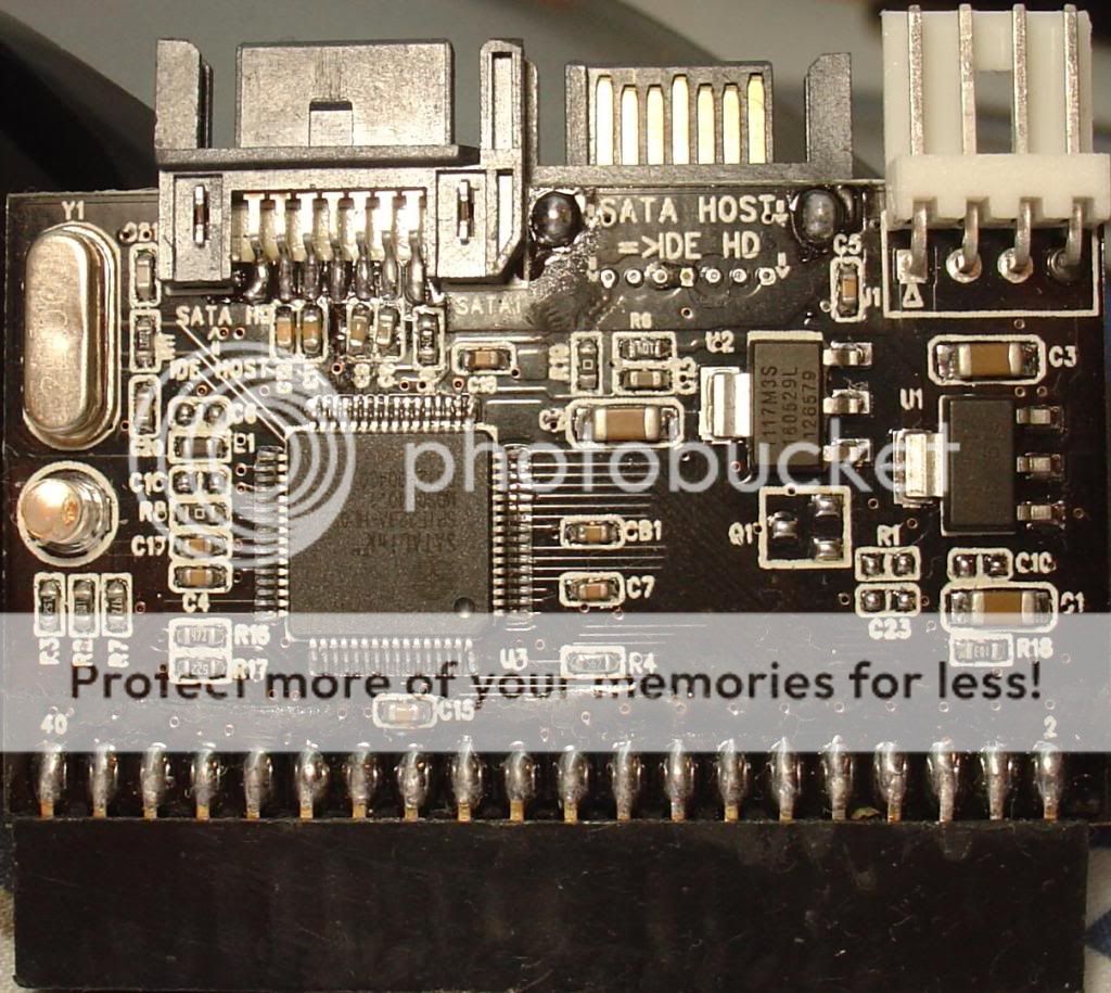

    I recently bought a Bidirectional SATA-to-PATA & PATA-to-SATA adapter to test...It is a small board powered by a 4-pin floppy connector...with the device came a 4-pin floppy to 4-pin ata molex converter...
    I connected the device using this converter, powered by the above mentioned PSU...after powering on and before getting into Windows, the cables of the converter were set on fire, so i immediately unpluged the power supply cable of the PSU to protect the machine from further damage...
    After that, the server could not power-on, so i replaced the PSU with another one and all worked fine...

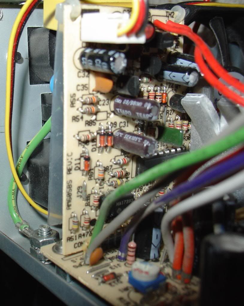

    I powered on the "faulty" psu to examine it and tested the voltage of the rails with my DMM...everything seemed fine except the 12V & the -12V rails, which measured approx. ~10.7V...
    I opened the PSU for internal visual examination but i could not locate any component to have failed/burnt...
    Here are some photos :
    If anyone can give a hint and cotribute in troubleshooting , welcome...
    If photos of specific areas are needed, i can upload more...

    Replace the Fuhjyyu.
    At least all with vents but preferably all.
    Yes, they are THAT bad.

      The Fuhjyyus are crap and need to be replaced, but that's probably not the problem here. Check all the secondary rectifiers on +12v and -12v rails for a shorted or open rectifier. Then check all the rectifiers on the remaining rails (+5v, -5v and +3.3v). Then trace and check the Vsense feedback path from +12v and +5v back to the controller daughter-card, in particular the resistive voltage divider network - it may have a blown resistor. If all of these look clean, then you may have a blown controller IC or op-amp on the controller daughter-card on the secondary side - it's not very clear in the photos.

            do what linuxguru said: no need to replace fuh-crap untill you get it working.
            as it may happen you swap them all and still not get it working.
            i don't really think short-circuit on output will damage caps.
            damage was caused because psu doesn't have overcurrent protection, or it has it but it wasn't working.
            (type of the i.c. on daughterbaord should reveal that..)
            btw. can we see that pata-sata adapter?

              What I meant was it isn't worth doing anything if you aren't going to replace the Fuhjyyu too.
              Two already look a little puffy on top. (By pair of red wires in 2nd pic.)

                  Here is a photo of the adapter :

                    get the SATA adapter replaced. It's burnt up.

                      about protection: felix could you read what's written on the ics on the daughterboard?
                      daughterboard is hting photographed here
                      http://i256.photobucket.com/albums/h...04886_crop.jpg
                      and ics are those black rectangles with metal pins coming out of them, and connecting to printed circuit board...
                      • felix
                        • May 2008
                        • 34
                        Re: TASK 200W ATX PSU - 10.7V on 12V rail after an "accident"?
                        The first one is SEC KA7500B and the second is HA17393 :

                          I agree with PC one of the Fukyuus on that daugherboard looks a bit bulged.
                          The focus isn't too good so it may be just glue though.
                          I purged all of the Fukyuus on my Antecs even the low value ones. Luckily though they weren't on the line filters too.
                          Your PWM controller is a KA7500B here is the datasheet:
                          The other 8 pin IC HA17393 is a dual comparator:
