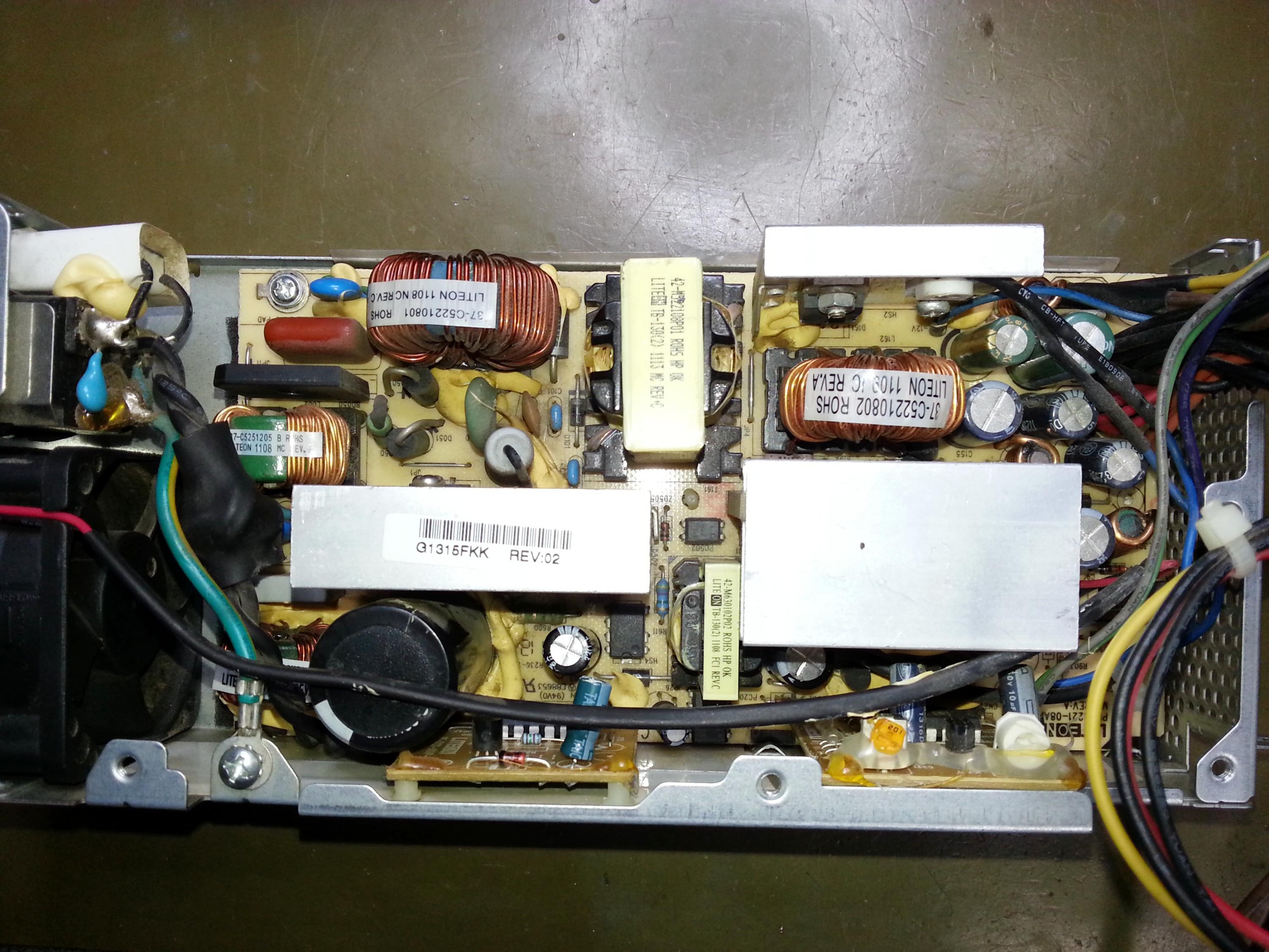

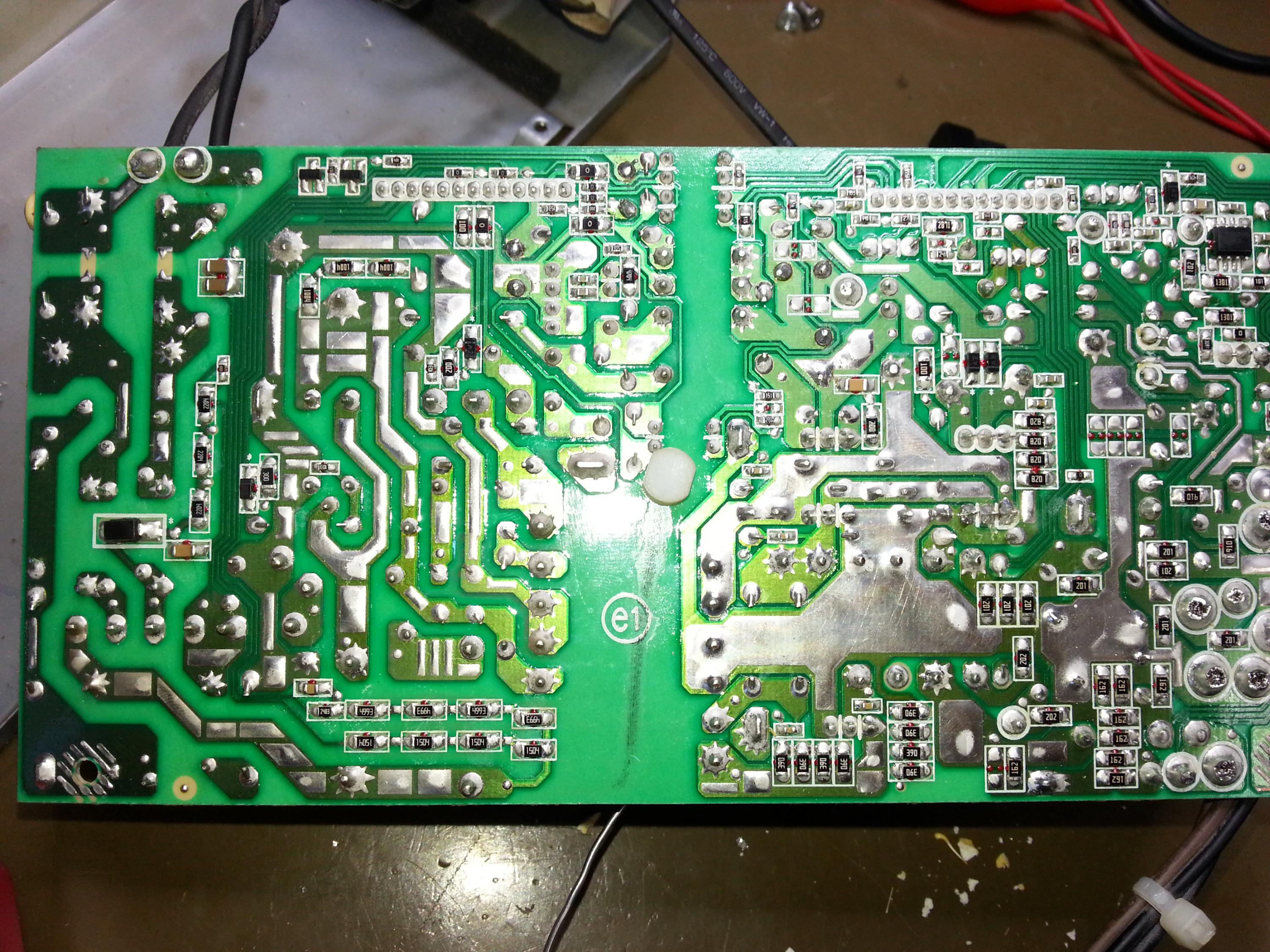

                        Re: Power supply doesn't work on just one motherboard (stumped)
                        Here are some picture of the supply, front and back, just out of curiosity. I know it may not be particularly handy, but I'm just going to put it out there.
                        Wattevah...
                          Yes, you've replaced the caps, but none of those seem to be from brands i trust. Ok, that big green Taicon(?) might be ok, those Ltecs might not be dead yet, but the rest... Kinda make me shudder.
                          Let me guess, those are all recovered / scavenged from other power supplies?
                          On second thought, are these photos from before the re-cap, or after?
                            Actually the pictures were taken BEFORE I started messing around with it The caps I put in are new. They may not be brand names, but they SHOULD work....I'm not exactly interested in this thing lasting a life time - I just want it to turn on enough to return it to the guy who brought it in
