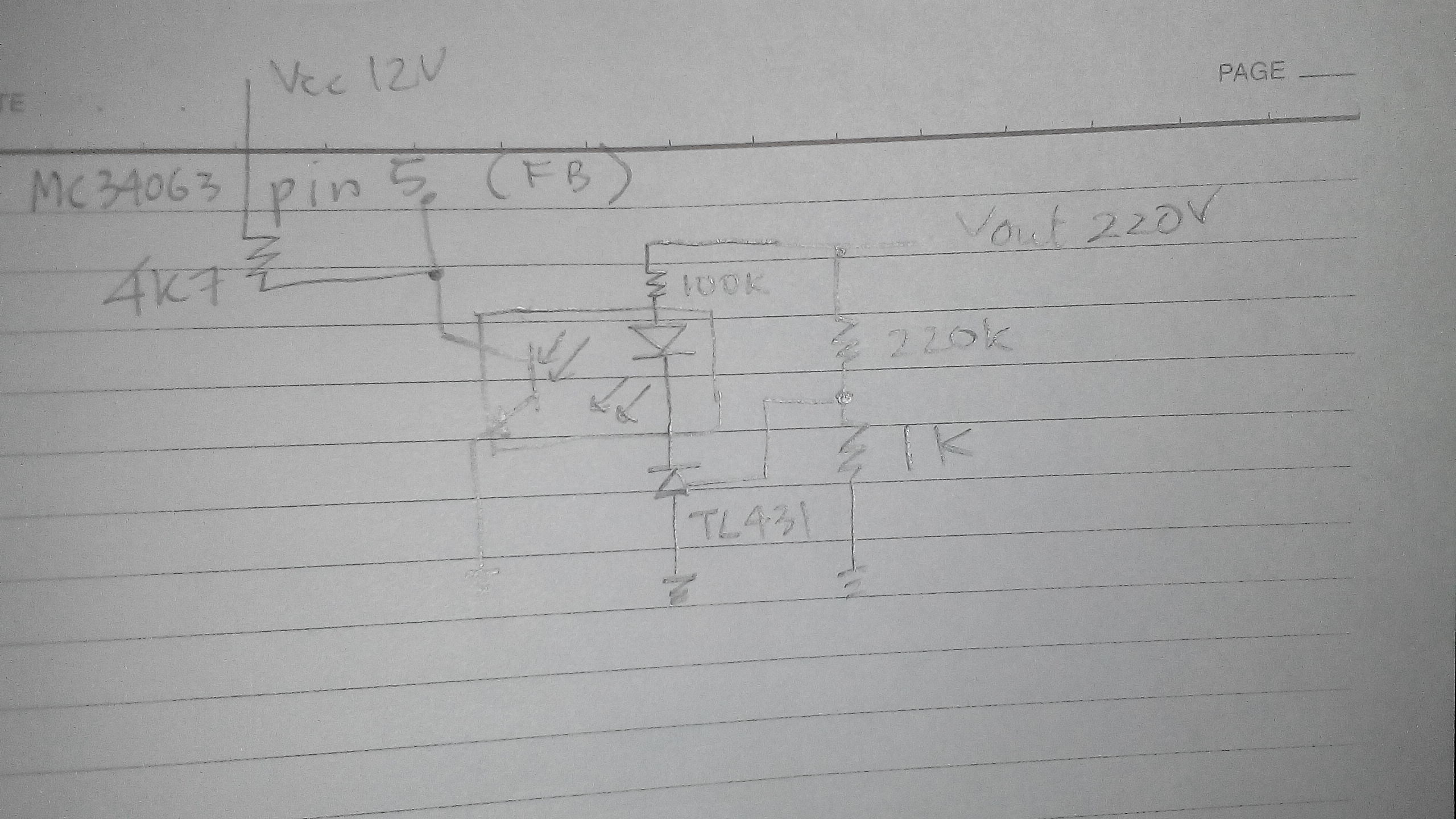

                    How can I add TL 431 and optocoupler for feedback?
                    Inspiration :
                    http://u.dianyuan.com/bbs/u/68/2457951218099004.gif
                    but not sure if it's the right way modifying my voltage divider..

                        can it be :

                          #132
                          Re: DC boost converter max power ?
                          Why exactly do you want / need opto feedback?
                          Compensating the TL431 is only gonna be one extra headache, which i don't think you really want, considering all the previous adventures...

                            #133
                            Okay, I only want to know how that coupler and TL431 work, is that the right circuit ? more or less ?

                                #135
                                It will relate with control system loop with feedback, bode plot ,pole, zero, aha so that's the way it works, return again to the math
