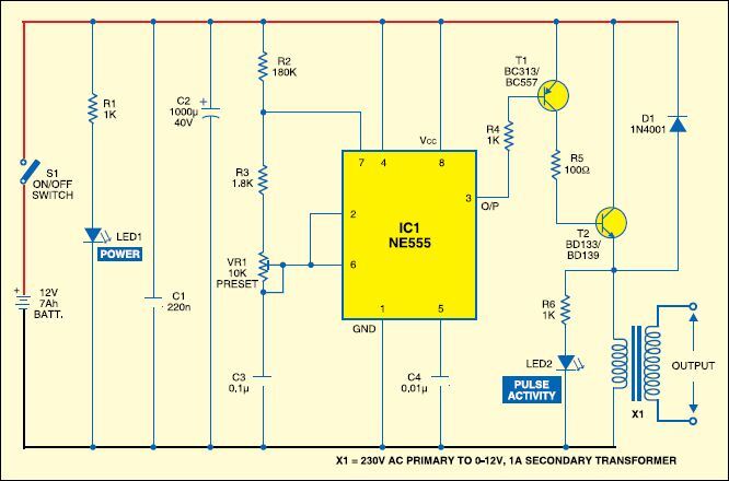

    what is function of diode over power transistor?
    I see on some schematic a diode over power transistor, and dont know is in it some trick to carry current, or what is the point?
    • 31198
    it protects the transistor from reverse polarity spikes when driving a coil.

      EMF blocking diode.

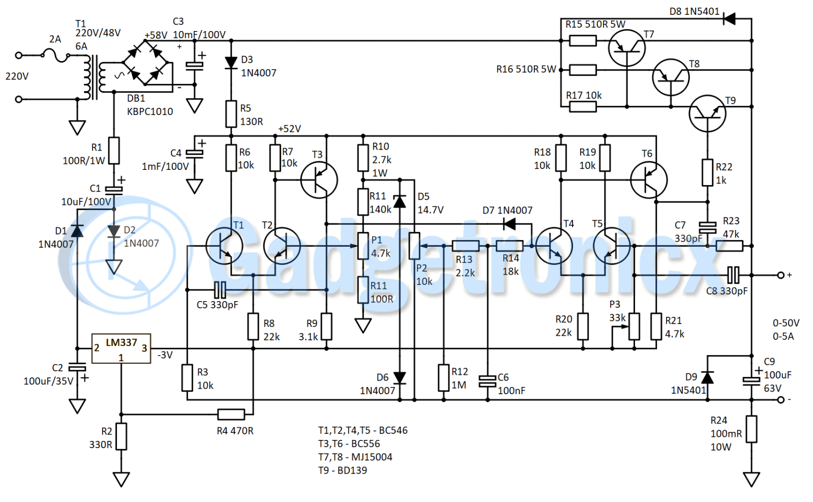

        Aha, like on mosfets... but on first pictures of psu, how current can pass R15 and R16 its 510 ohm in parallel... 5A!? Thank you

          I think the R15 and R16 current sharing resistors should be R510, 5W.
          P = I^2 x R = 2.5^2 x 0.510 = 3.2W

            Yes, it make sense... I was confusing with too many repeated errors and think there is some catch with diode to help pass current... lame...
