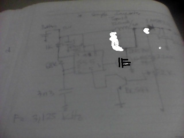

    I've been experimenting DC boost converter,
    How much maximum power can I get from this circuit ?
    I got output 221.8V and input 12V already...
    Does it depend on my inductor ,output diode and my switching FET rating ?
    Output diode is 3A 1N5822 and FET = IRFS730 5.5A 400V L = 130uH ...
    Cheers

      ok thanks, it's DC booster 12V to 220V topology, simple PWM and resistor divider feedback...
      I've read that TI info, it depends on its chip...mine is a simple astable multivibrator PWM
      Doing experiment with 2A 120uH now....
      I haven't got any bulb yet for a small test but I will....
      It doesn't have to be perfect so if it does the job...all good...

            Re: DC boost converter max power ?
            I don't need much for starting ...0.2A ...up to 1A 220V if possible 220VA later on...
            Will I get the same voltage feedback if I put optocoupler on it ?
            Currently I'm using a NPN transistor and voltage divider to get the feedback..
              220V at 1A = 220W, that means the input current will be a lot higher 18.33A (3.67A @ 220V 0.2A: 44W) but that will be more because you will not get 100% conversion,so what kind of 12V supply are you using?
              You are no building isolated output so no need to use Opto-couple.

                      Ok, I put dummy load RL = 220 ohm and the voltage drop to 8.45V equal to battery voltage...any work around it ?
                        If the power supply is actually putting out 220VDC with no load and you are trying to draw 220V/220 Ohms which will be = 1A of current the load is trying to draw from the power supply, that is 220V x 1A = 220W.
                        So what do you think? Do you really expecting that little power supply is going to be able to supply that much power? Just think how much power the battery will also have to supply. Did you do simple Ohm laws?
                        BTW, where is the circuit and where did you get it from? I hope you realize that you are trying to build over 200W converter..

                          I got it, so I need a powerfull battery if I want to get more power on 220V minus efficiency...
                          85W 12V battery , probably only get about 60W 220V...correct me ?
                            You need a powerful circuit which you have not show us where you got it from yet. Look up 200W DC-DC converter to get some idea how big they are. Did you read the many links I provided to see if the inductor and all other parts you are trying to use will be OK per calculation?
                            Is the circuit made to deliver the needed power? You are just going in circle and you are not going to get any where with it until you understand what you are trying to do.
                            With your little knowledge do you really think you can make such device without understanding basic concept?
                            This statement alone "Ok, I put dummy load RL = 220 ohm and the voltage drop to 8.45V equal to battery voltage...any work around it ?" makes me wonder. Work around? really?

                                    Here's the circuit, what do I need to make it powerfull ? I follow the principle of inductor doing its job. Don't say 1A...0.1A of 220V is good for my experiment.
                                    Yup I'm learning ohm law, but something practical is more interested to me..doing all math calculation without my hand working on the PCB making me bored.
                                    I keep learning no matter other people call me, it doesn't matter..
                                    Learning is steep and deep but I enjoy it

                                        It's a simple astable multivibrator and FET with inductor and resistor voltage divider...I'm not running here but I'm learning here.I don't use any advance PWM chip.I want to know how it works.
                                        on SATA and PATA, the dual transistor is the PWM, that's a cheap and smart idea to make it into production and they are all fixed and running now....made abit modification and tested for 12 hours run non stop, all good....learning and learning...
                                        The price of 2 transistors and 1 power FET will be cheaper than 1 advance PWM chip, profitable for production...
