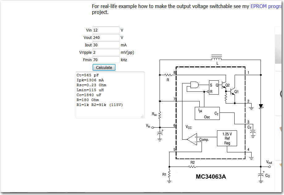

                ok...here's what I see http://www.nomad.ee/micros/mc34063a/

                  Re: DC boost converter max power ?
                  That schematic looks like an inverting converter (to create a negative voltage), by the way. Not to mention, it uses the internal switching transistor as the pass element.

                      Ok, I'll buy it,
                      are the components value right ?
                      from that circuit, I can not see switching transistor or FET ??
                        Are you intentionally ignoring (some of) my messages?
                        Post #108: https://www.badcaps.net/forum/showpo...&postcount=108
                        I quote:
                        "That schematic looks like an inverting converter (to create a negative voltage), by the way. Not to mention, it uses the internal switching transistor as the pass element."

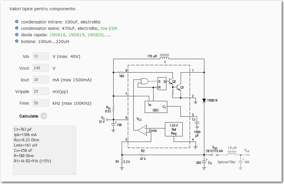

                              Is that the right value ?
                              So I don't need extra switching transistor, but this chip will dissipate a lot of heat
                              http://www.bobtech.ro/tutoriale/comp...ep-up-inverter

                                I see you insist on doing things your own way, and ignoring information others provide you.
                                I guess you didn't even check the links in post #104.
                                http://schmidt-walter-schaltnetzteil...w_hilfe_e.html
                                Scroll down to the graphs. If your converter goes into discontinuous mode, you'll have the entire output voltage across the internal transistor of the MC34063.
                                https://cdn.badcaps-static.com/pdfs/...18f4bb5c06.pdf
                                Scroll down to page 9, to the graphs, and look at the first one. See where the top of the waveform is? I read there "Vout + Vf", ie. output voltage plus forward-bias voltage drop of the diode.
                                https://cdn.badcaps-static.com/pdfs/...88bb560e37.pdf
                                Let's go to page 2 of the datasheet. The 5th row says "Switch Collector to Emitter Voltage Vce(switch) 40 Vdc"
                                You're trying to get over 200v on the output. What do you think will happen? That is, assuming the chip doesn't burn up from the power dissipation alone, before that.
                                      Yes I don't understand MC34063 works, it's maximum 40V output and my target is 240V
                                      ST datasheet page 17
                                      and it's using transformer, making it more complicated, I want to make similar with 555...
                                      I haven't read that yet...too many informations and making the whole point complicated...
                                      I want to make something simple..

                                          Page 17 in the ST datasheet shows what's called a "flyback converter" and it indeed uses a transformer (or, technically, a coupled inductor).
                                          "too many informations and making the whole point complicated..."
                                          So, you DON'T want EVERY step that's needed to create and calculate the circuit you need, shown and explained to you. But you "want to make something simple", by magic? Just wishing it into reality? Or do you expect any of us to present you with a ready-made circuit?
                                          Or.. you're really too lazy to even look into / use ONE simple equation, to figure out two resistor values? Seriously?..
