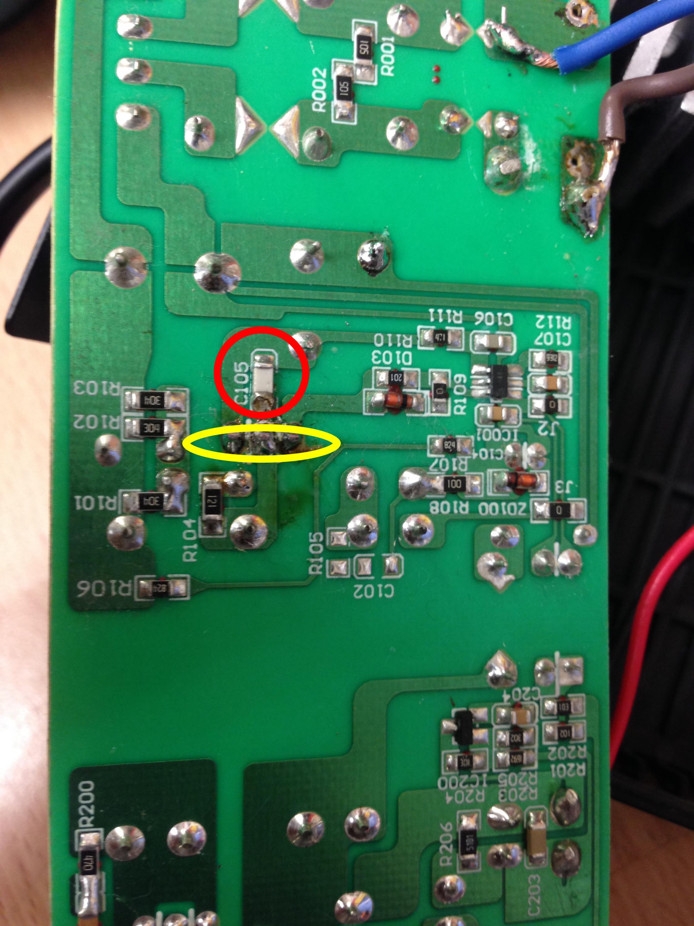

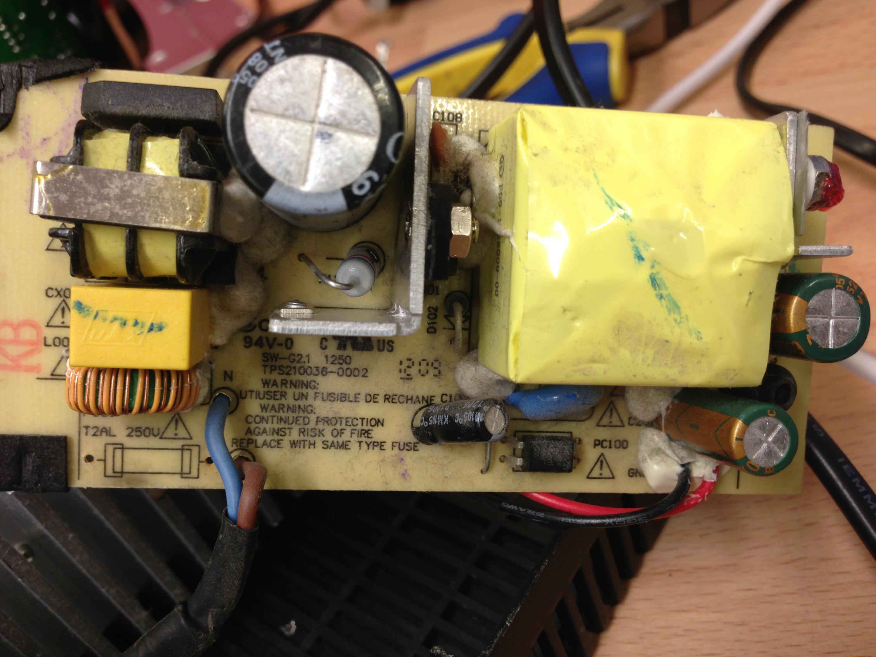

    Im working with one of these amps: no power. Turns out a faulty transistor and blown fuse. Replaced both but still no power. On further testing, red circle is damages. How to know what to replace with? Yellow oval is the transistor ive replaced. Transistor was a NDF04N60ZGOS-ND.

    So that C105 snubber cap shorted out too beside the MOSFET?

        BTW, that big MOX resistor for the Source pin of the MOSFET is still showing <1 Ohm?

          Re: Determining a faulty capacitor
          Yes. On MM is show up as DISC or DESC, not sure but it's gone.
          Originally posted by keeney123
          So where is the brown wire connected to one the board?
          It's just for the fuse. Original fuse was a 2a. Now Im temp using a 1amp.
          That resistor is fine to be honest. I think it's showing 3K, Im not at work to confirm. But Im pretty sure it's ok.
            I do not understand what you mean, Disc. Bottom line is the cap shows resistance reading or not. So what resistance do you get on the cap?
              I'll let you know when I'm at work later.
                That power MOX resistor if I am correct, it should be connected to the Source pin of the MOSFET, when the MOSFET shorted out it will also cause the resistor to go open citrcuit. It should be very low resistance of less than 1 Ohm.
                  Yea it was burnt. I part of the outer part was blown off. I'll confirm in 5hrs time.
                    No resistance for cap. Resistor has about 16Meg Ohms (tested in circuit).
                      that resistor is FUBAR
                        LOL! Ok so what about that cap?
                          probably fine.
