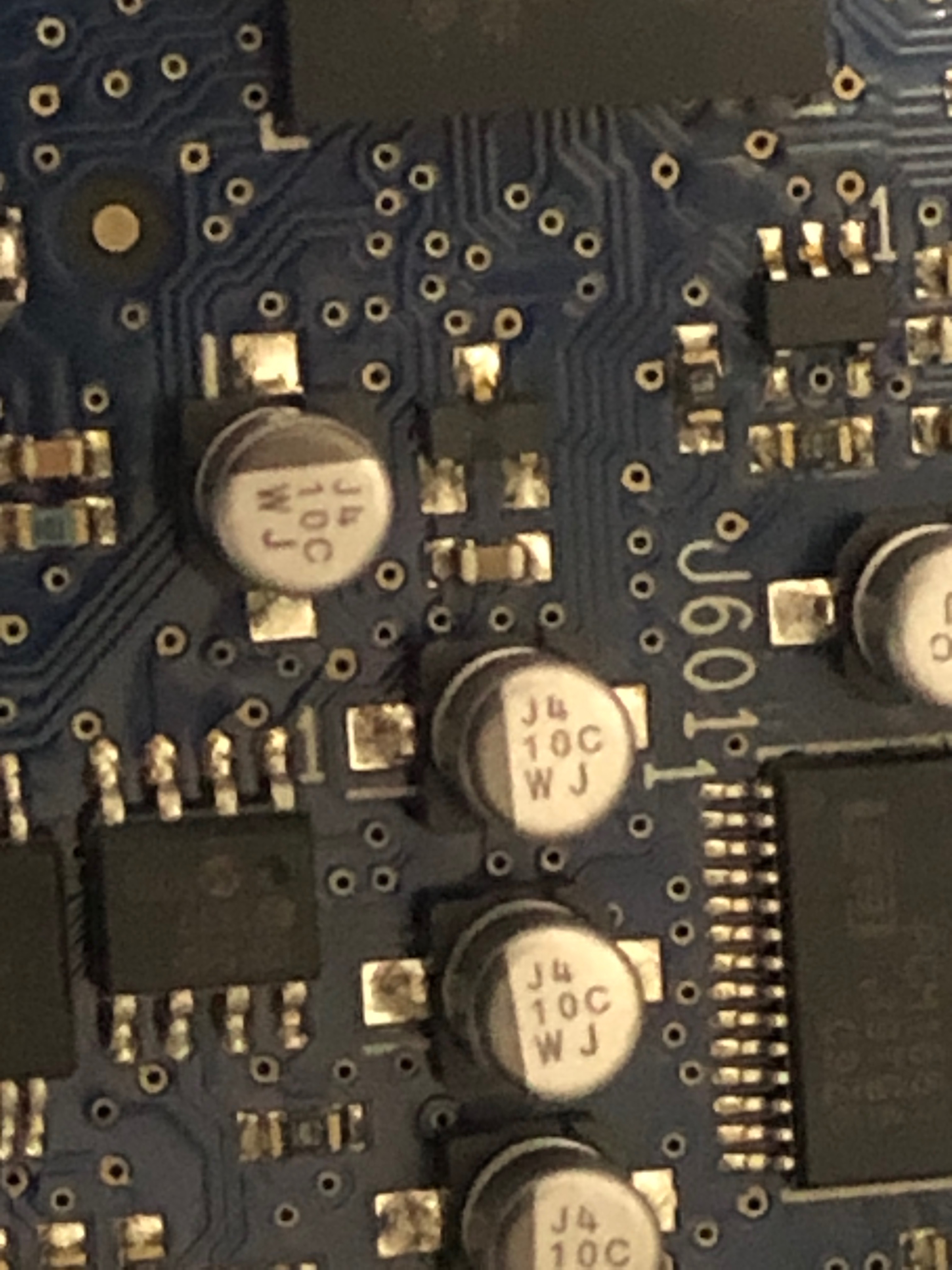

Need help determining capacitor value 10C
  • repair-it
    • Nov 2020
    • 112
    • US
    Not sure what the value is for these caps labeled 10c. I know the WJ is 16v.
  • truclacicr
    • Apr 2019
    • 335
    • australia
    https://www.nichicon.co.jp/english/p...s/pdf/e-wj.pdf
    10uF, 16V, WJ series
