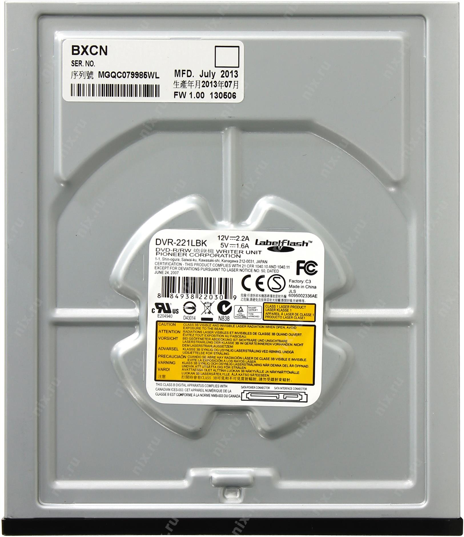

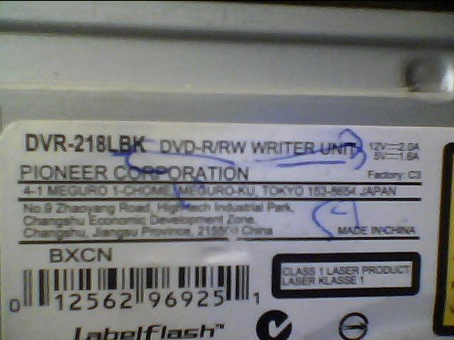

            Originally posted by jiroy
            Did you ask yourself why your calculations came out differently than Pioneer , did you ask yourself why you came up with 32 Watts while Pioneer came up with 27 watts ? ..Here , you have two options :
            jiroy: Scroll back up to my previous post, see how I quote you saying 3.6A
            That is wrong, and I explain why in my post before that.
            So please now enlighten me how I'm wrong and 12v 2A & 5v 1.6A really is 3.6A like you said.
            The fact that Pioneer writes 27w in the datasheet comes down to testing the actual power consumption.
            A drive will never use all the power on both 5v and 12v simultaneously.
            But who am I kidding, you can't even read the label on the drive itself to begin with, it clearly states 2.2A

                "The fact that Pioneer writes 27w in the datasheet comes down to testing the actual power consumption.
                But who am I kidding, you can't even read the label on the drive itself to begin with, it clearly states 2.2A"
                Not only that, it is bad info when published spec only show Wattage but not the Voltage and current requirement for each Voltage.
                There are reason people do the review and test the device to verify if it met the CLAIMED PUBLISHED spec.
                http://www.pioneerelectronics.com/PU...ves/DVR-221LBK
                Very poor specification INFO from PIONEER.

                    #29
                    Re: Need power supply recommendations for older P2/P3 gaming system
                    I feel that's actually insulting the Greek.
                    This is a whole new level of either trolling or stupid, can't make up my mind.
                    It will be interesting for him to show us the label on the unit that he claimed he has.
                    BTW, I am sure there is current draw on 5V too at the same time as the from 12V since it needs that for the logic, LASER, etc.
