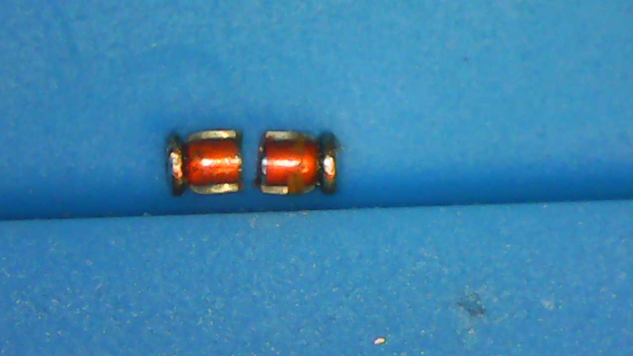

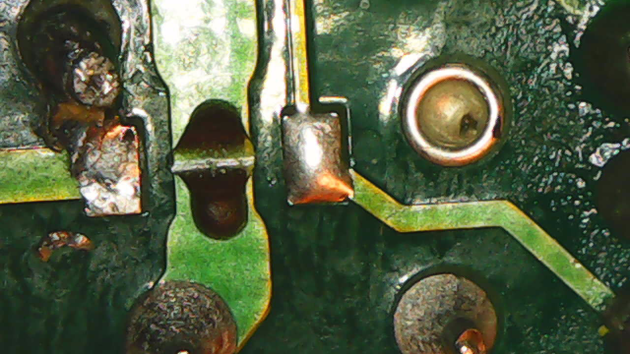

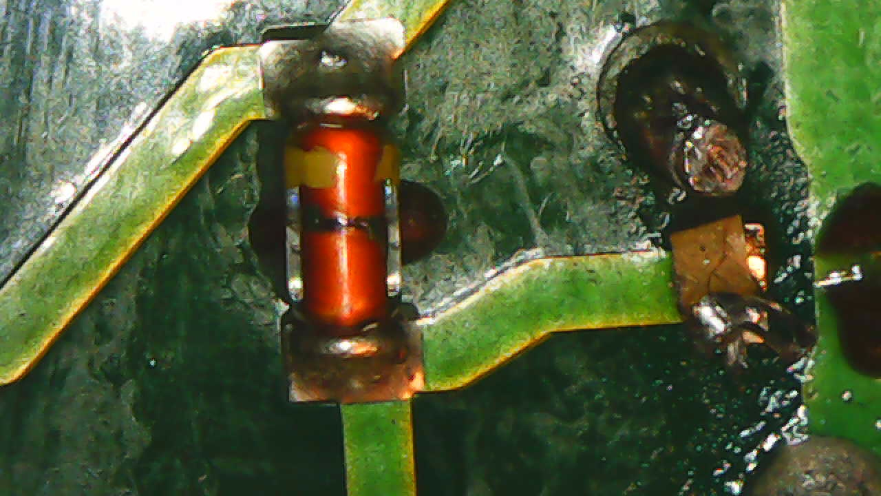

              Hi. can anyone idendify what component this is please (PIC1). I was soldering a CAP onto the board and this came off D305 (PIC2). I think its a Rectifier Diode but with it being in half I cannot test it. Also I am not good with the color's !! Quite close by there is also one I found on the board but not sure if it is the same (PIC3).
              Mike
              • R_J
                • Jun 2012
                • 9607
                #47
                Re: Troubleshooting B&W Original Powersupply
                The diode is a MiniMELF diode, it could be a BAQ134-GS08 Switching diode or it may also be a zener diode BZV55 series?
