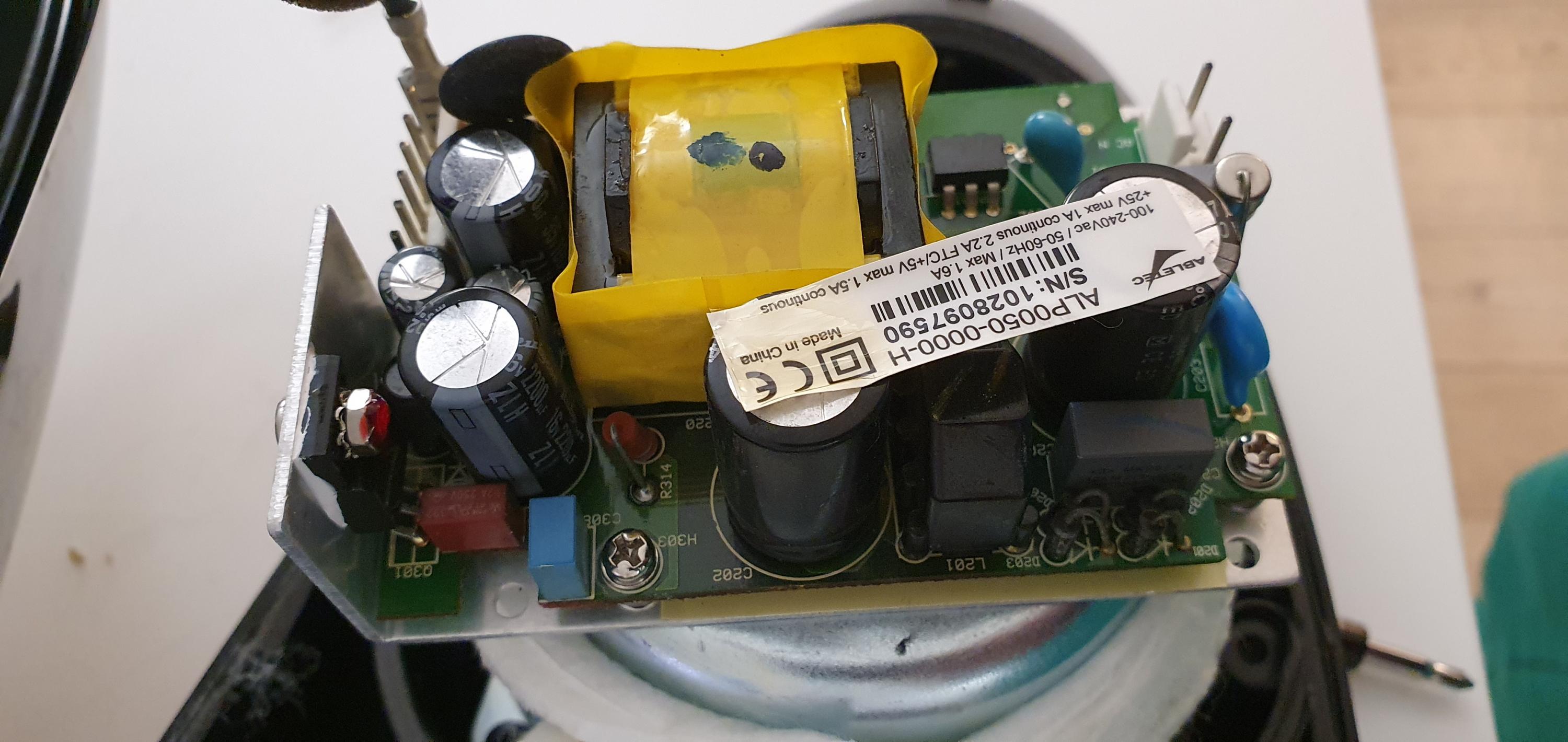

      Picked up a B&W Zeppelin for free last night and was told it had stopped working although it lights up but shows the red flashing LED. After following the guide I found the 47uF 400v and 2200uF 16v caps swollen, ordered up a full set of Panasonic FR caps for £12 and going to see if I can get it going.
      I'll keep you posted on whether its operational at the end of the next week.
      Thanks for your write ups and advice, most helpful.
      • SilEng
        • Nov 2020
        • 2
        • United Kingdom
        Re: Troubleshooting B&W Original Powersupply
        Hi again,
        I took the opportunity to replace all 6 caps with Panasonic FR types and paid princely sum of £12, it took no more than an hour to repair. It's now working again and sounds great, for a freebie I cant complain. Just need a blue tooth dongle and add some new fabric over the speaker grills to make it mint again.

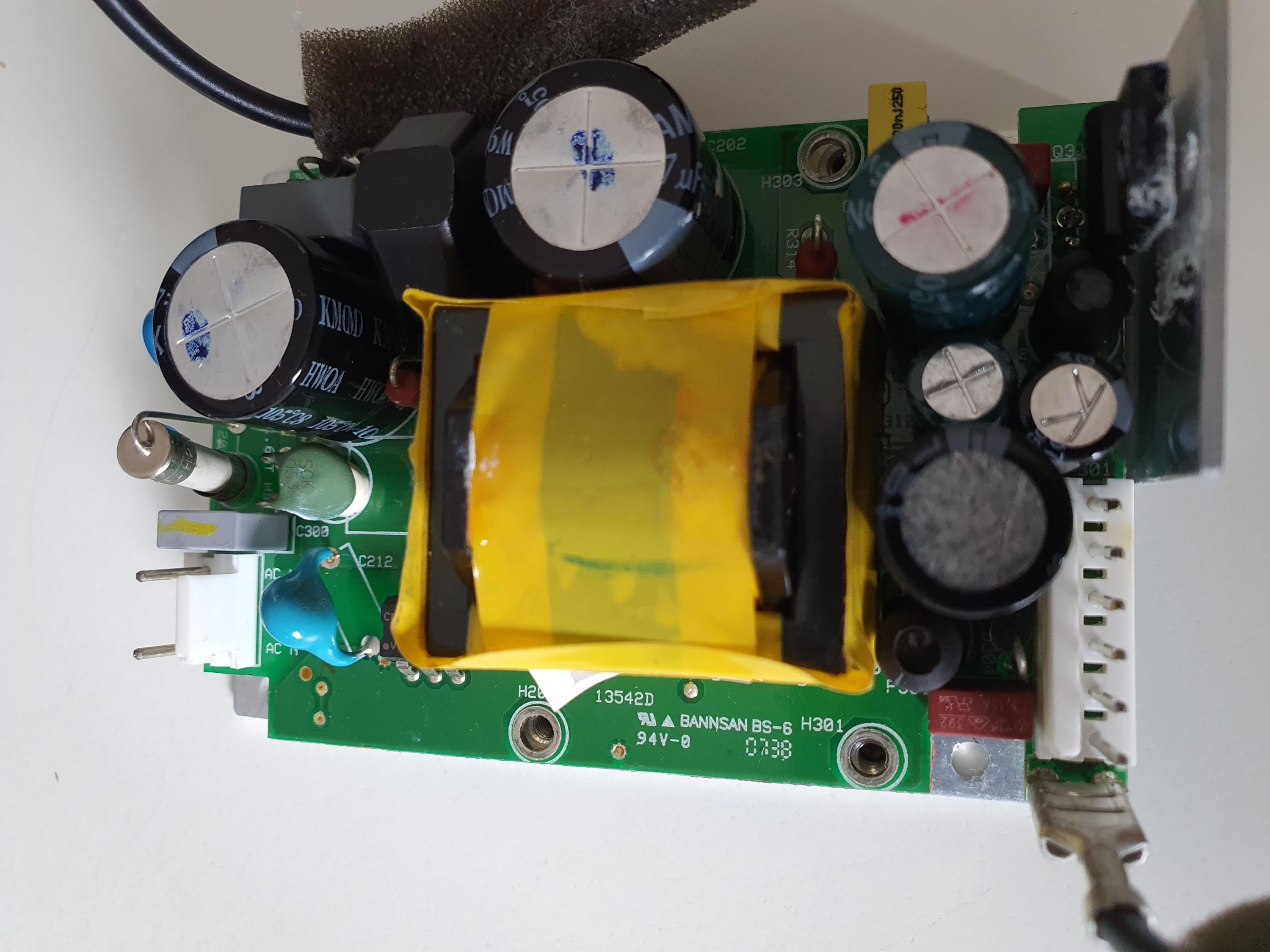

        • OmidN
          • Jan 2021
          • 8
          • France

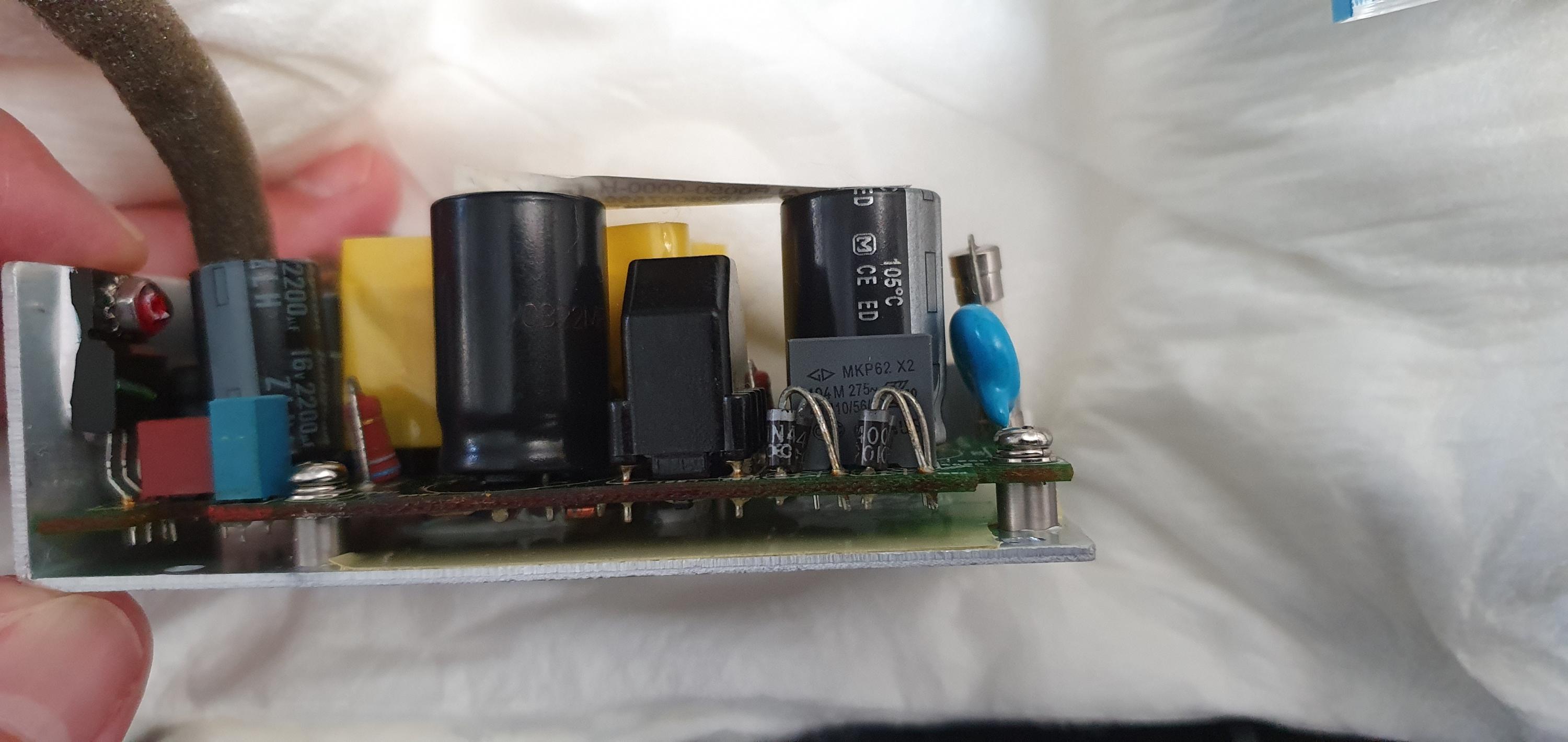

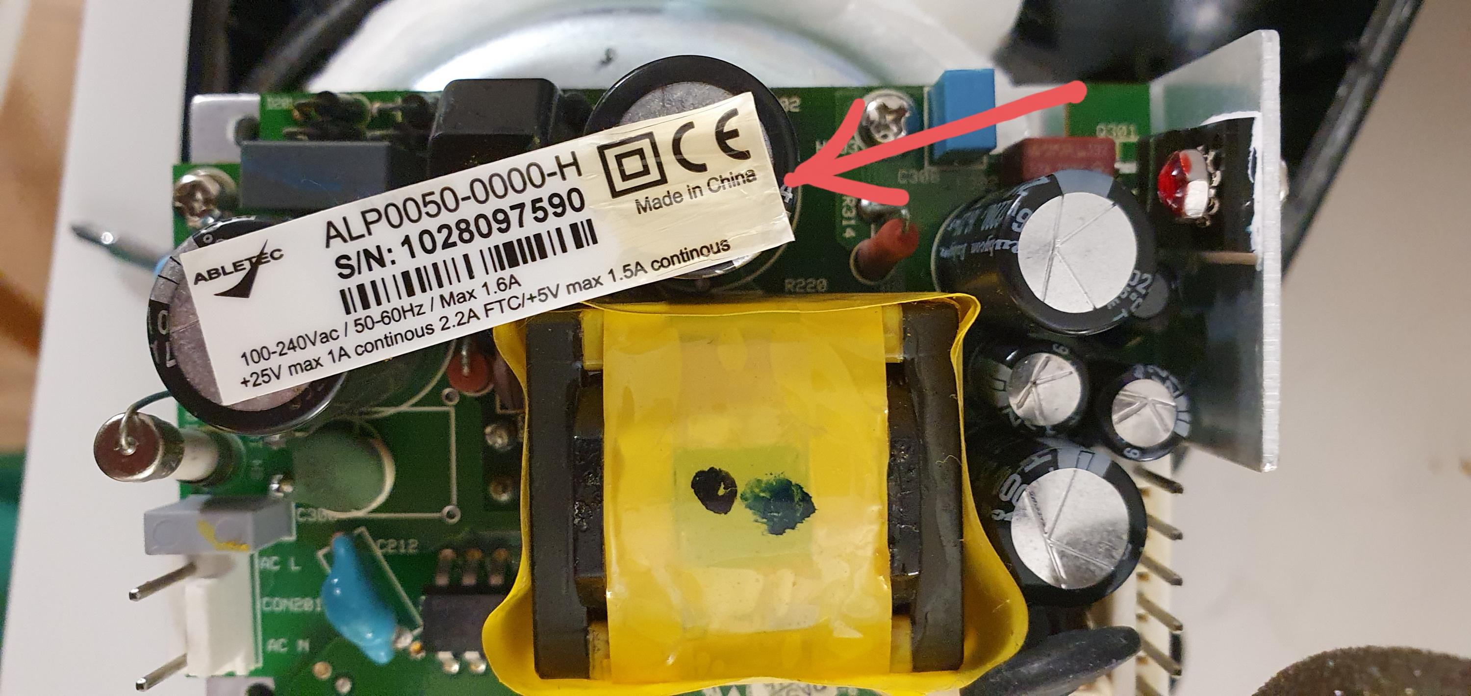

          I came across this forum and it seems it the only good help on the net. I had the same issues and I decided to follow the instruction to open my speaker, but when I reached PSU it doesn't look evident to me. Maybe the yellow one?
          I appreciated it if someone could help.
            • 30917
            strange,
            the 4 diodes - D201 etc look like they have burned/corroded leads.
            • OmidN
              • Jan 2021
              • 8
              • France
              Hi Stj,
              Many thanks for your quick reply, so do you think i would change them first and give it a try?
              could you please let me know the model and the details of the 4 diodes to purchase?
              Sorry I don't have electronic background , I am just trying to avoid throwing electronics
              Thanks again
                  Thanks for your help and prompt reply.
                  I should find a place to test them since I don't have the meter.
                  When i looked closer it doesn't seem to me that they are burnt, maybe it was the photo.
                  PFA a better photo
                    • 30917

                      • OmidN
                        • Jan 2021
                        • 8
                        • France
                        #31

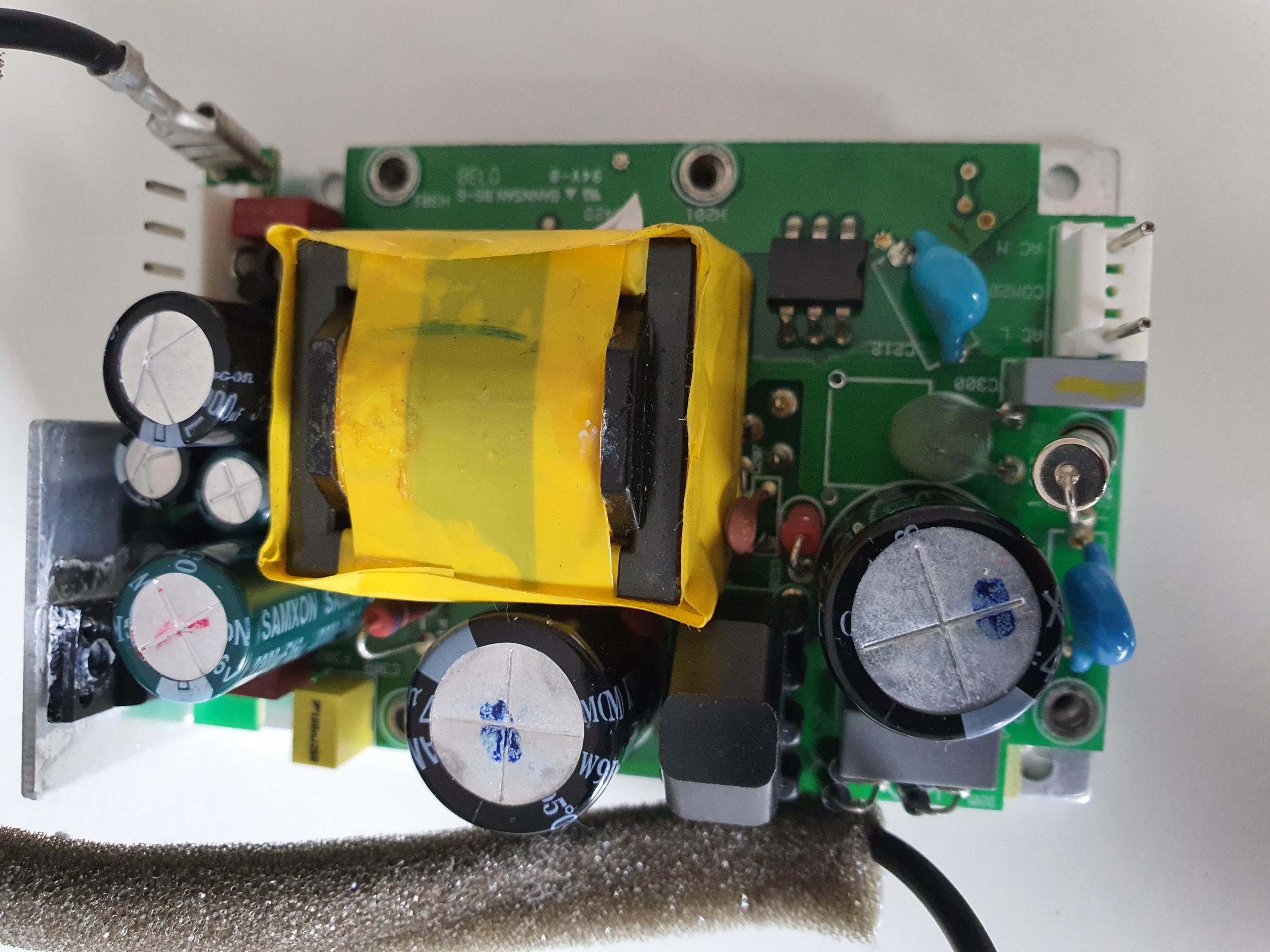

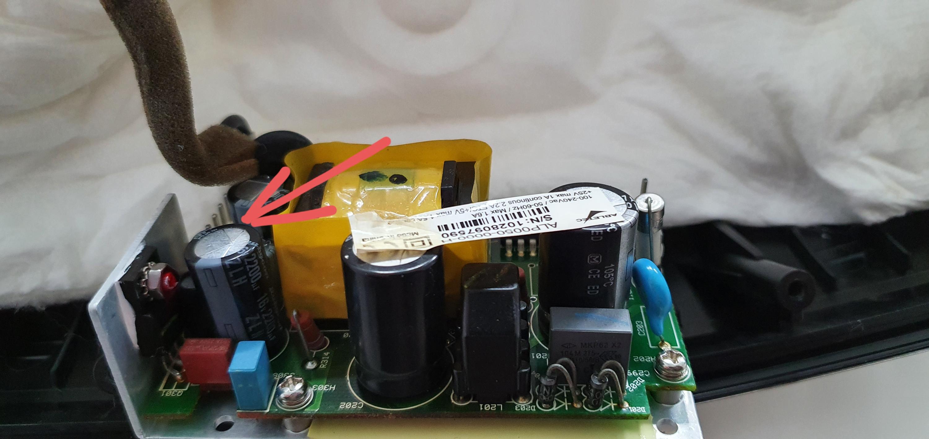

                        Hello Stj,
                        I have check the diodes D201, all 4 seems to be good, on the good direction they are reading around 470 and opposite OL.
                        on the other hand I touched the surface of the capacitor in the photo, it seems bulged, I also see the one behind is a bit bulged, as far as I understood from this forum I have to order 4 capacitors below:
                        Rubycon ZLH 2200 uF 16 VDC
                        Rubycon XYG 470 uF 16 VDC
                        Rubycon ZLH 220 uF 35 VDC
                        Rubycon ZL 1000 uF 35 VDC
                        could you please advise?

                            • 30917
                            #33
                            bulged caps are bad.
                            it means the liquid in them has boiled or generated gas.
                            • Per Hansson
                              • Jul 2005
                              • 5895
                              • Sweden
                              #34
                              Originally posted by OmidN
                              Hello Stj,
                              Yes I was going to say they look bulged in your first pictures...
                              Replace them and see how you go...

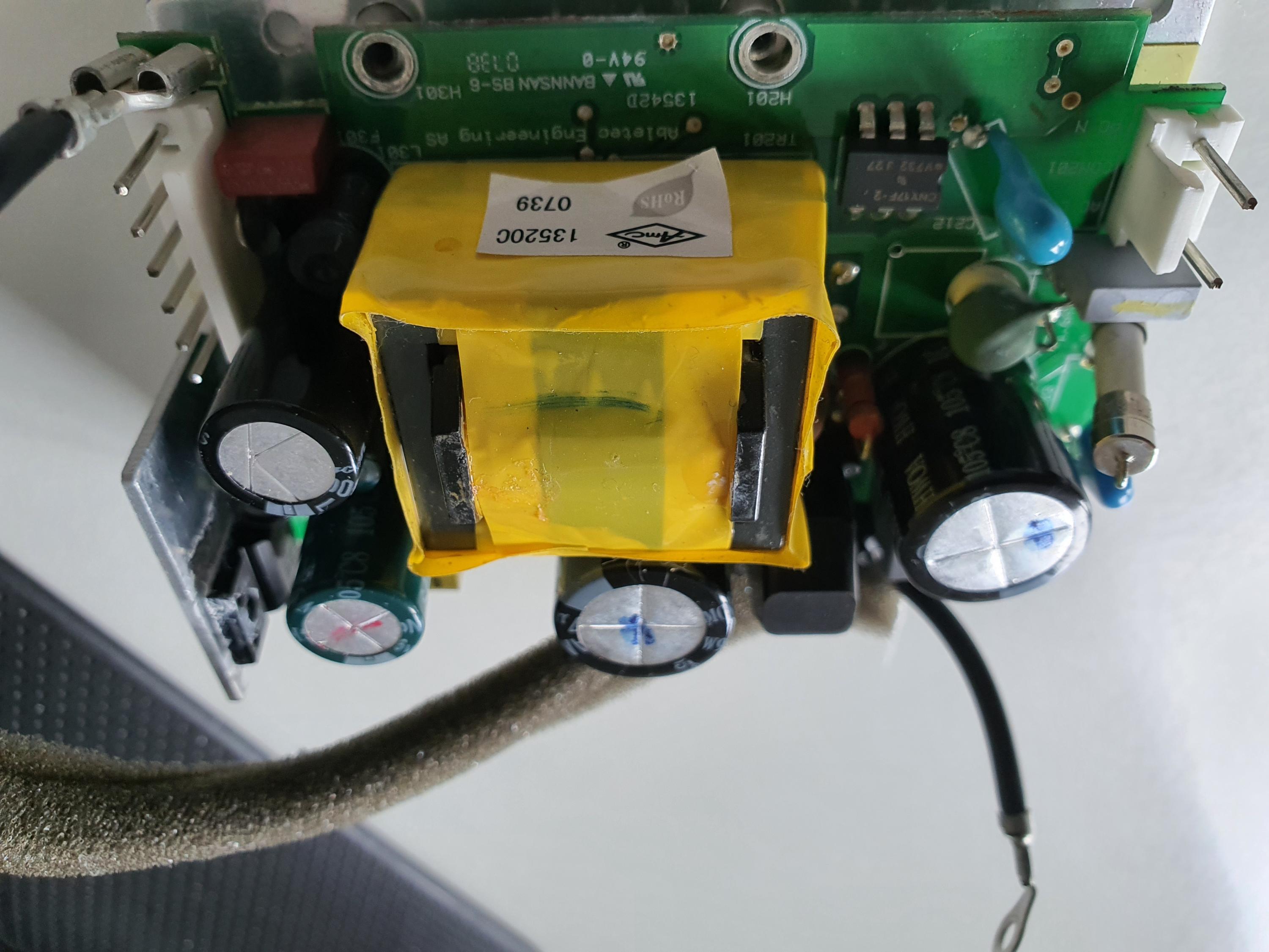

                                • OmidN
                                  • Jan 2021
                                  • 8
                                  • France

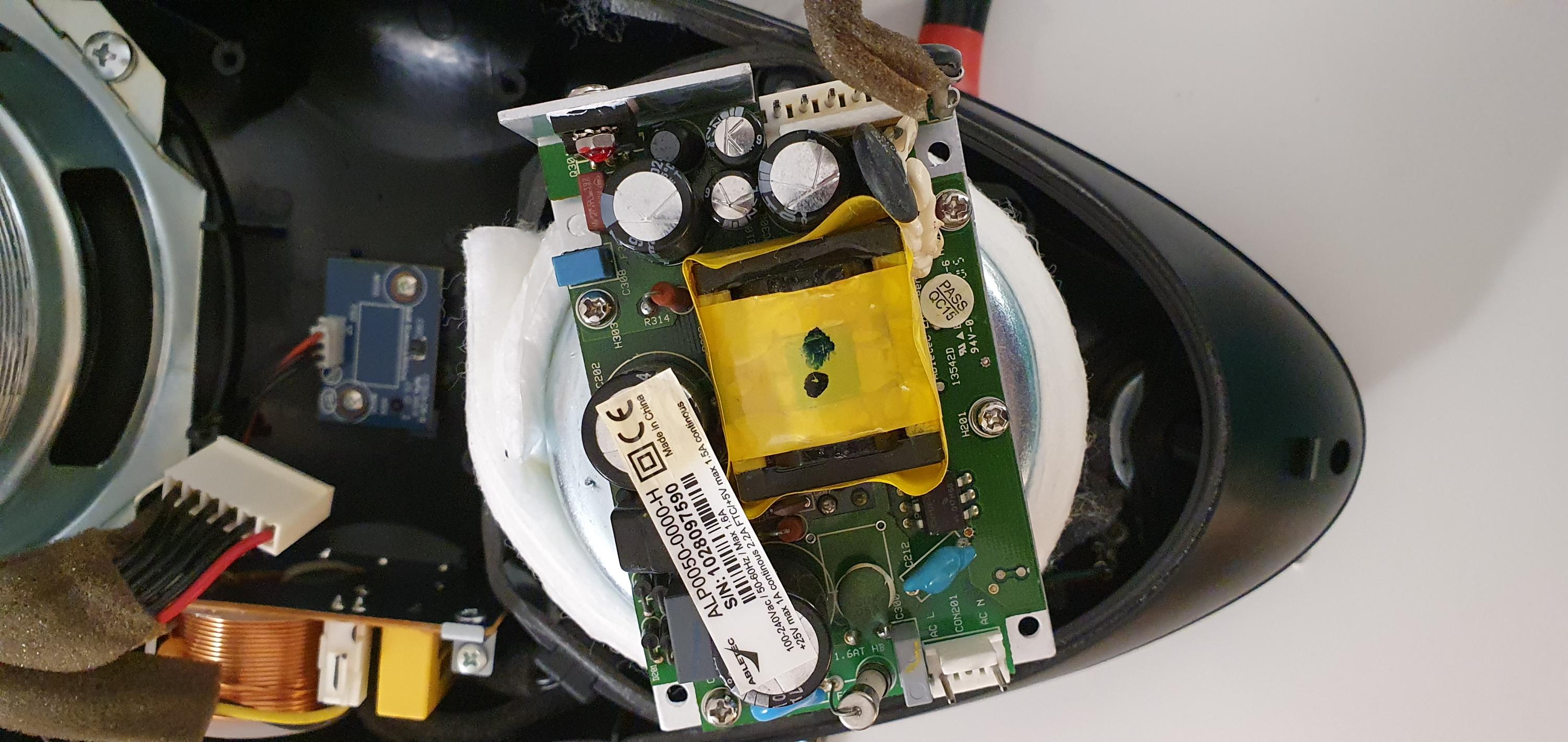

                                  #36

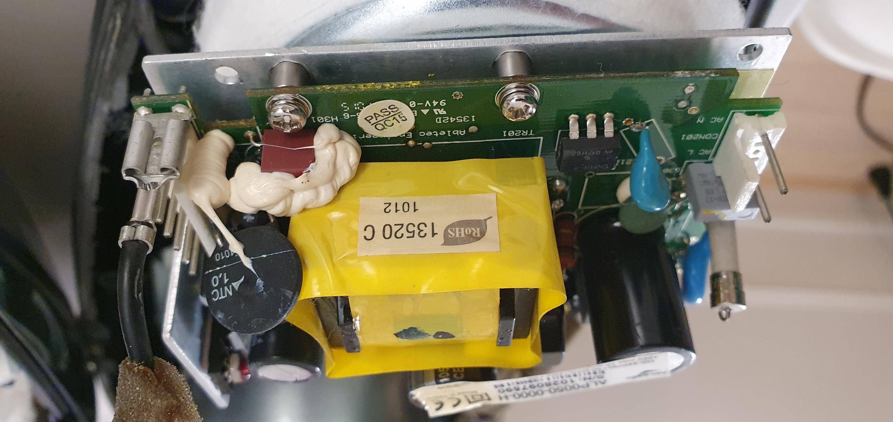

                                  Many thanks for your feedbacks, I changed those 4 caps and my speaker is back to live. I appreciate it, A few comments for the next person:
                                  1. I have damaged the seat for PSU, basically I tried to screw it back gently but somehow all the seats damaged. The plastic became brittle. I eventually managed to fix 3 of the screws so PSU doesn't move.
                                  2. Please look at the disassembly a few times before you start opening, I damaged the locks for the front cover. now the cover is not 100% fixed in its place.
                                  3. In my order the 470uf caps were a bit fatter than the original one, so I was struggling to solder it in its place.
                                    • Jul 2011
                                    • 6018
                                    #37
                                    If you have access to plastic spacers or plastic square bar and the right length screws and square bar would probably be the best thing to try or metal “L” bracket screw one side of the “L” into the cabinet and the other side of the cover if you have access to treaded rivets mount them on the side of where the cover is being mounted to the “ L” bracket
                                    I have done this many times in the past when the original plastic pin break use plastic spacers and screws in place of the broken plastic pins or if you have access to circuit board stand-off is the best solution for this type of problem

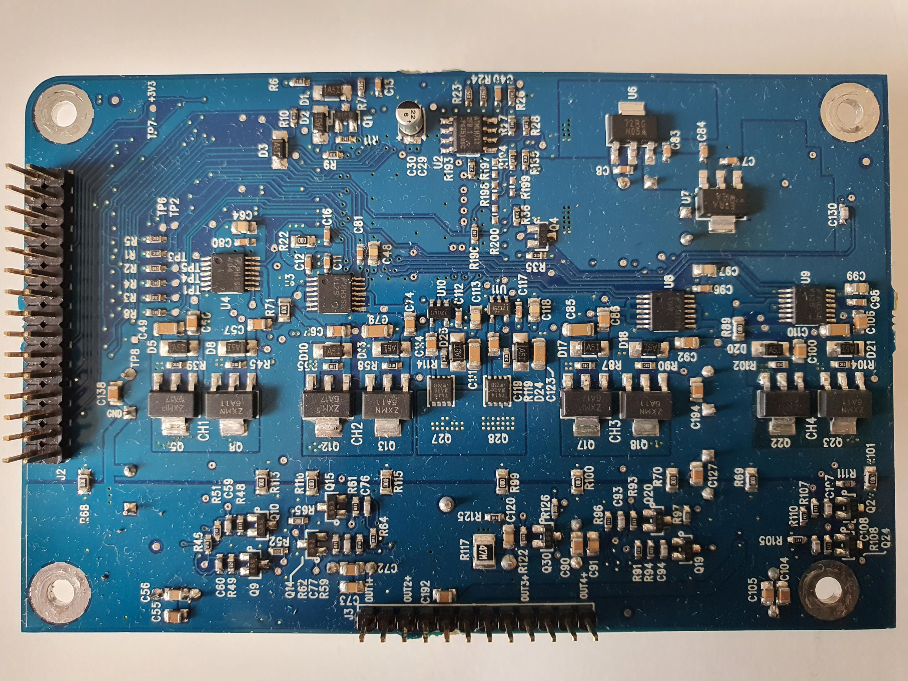

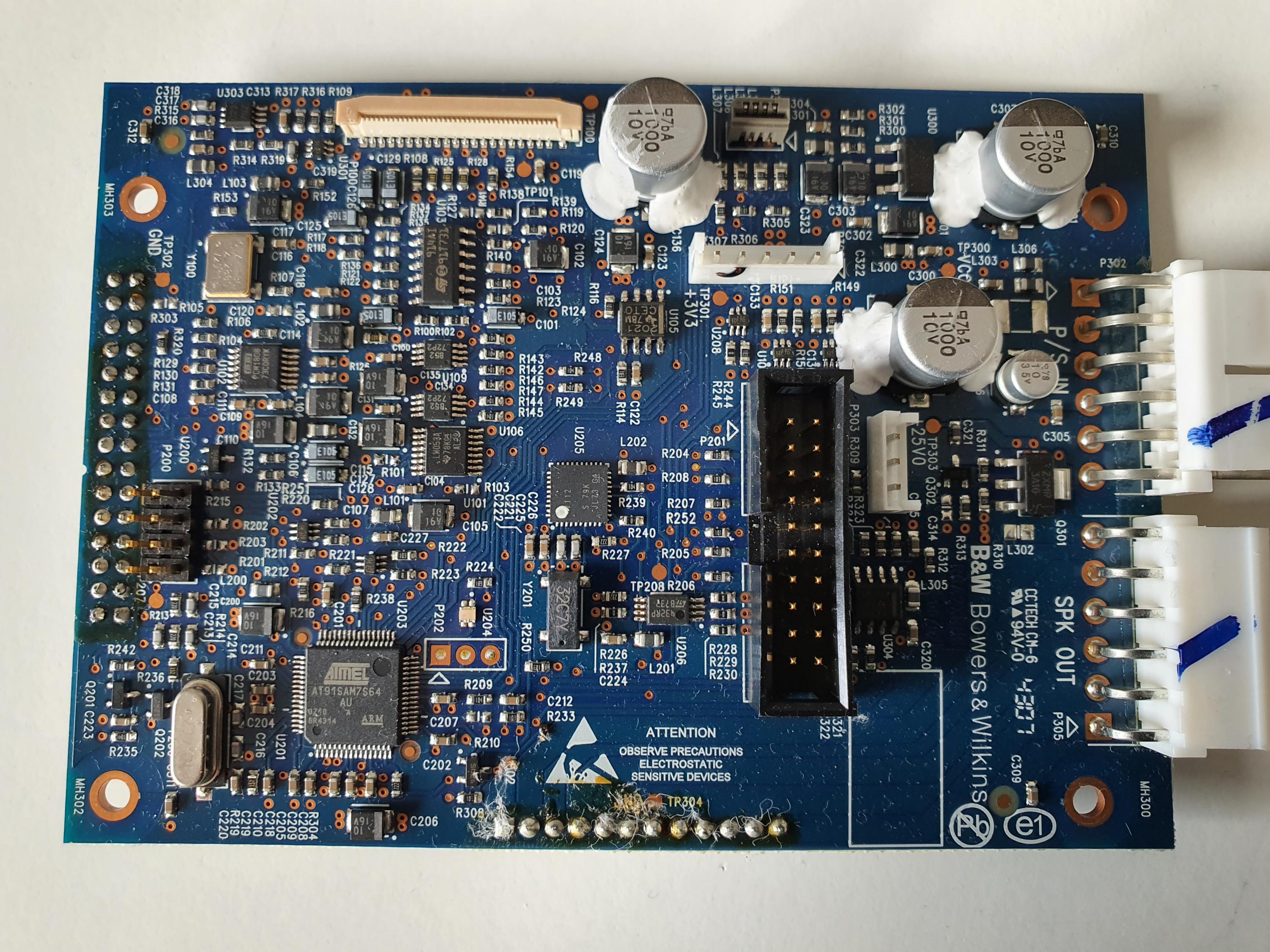

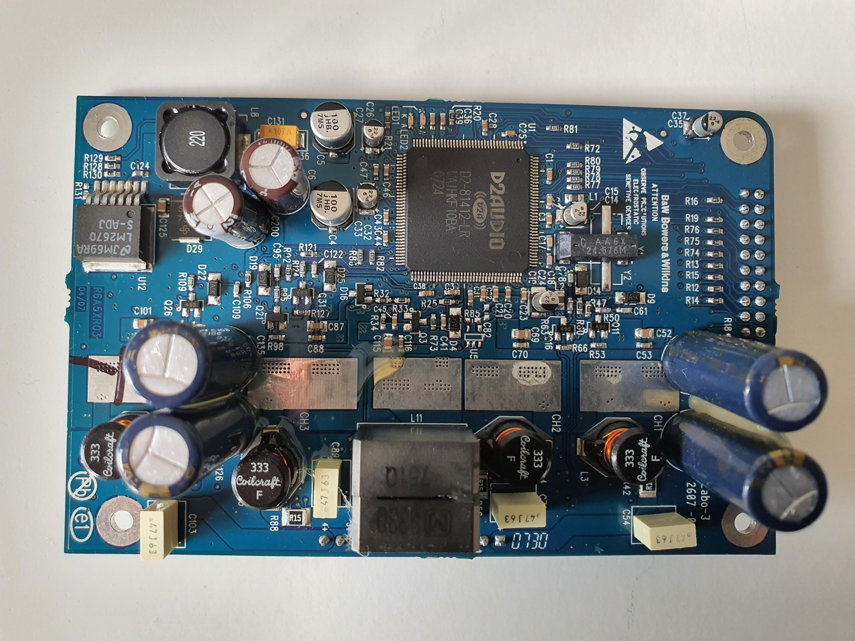

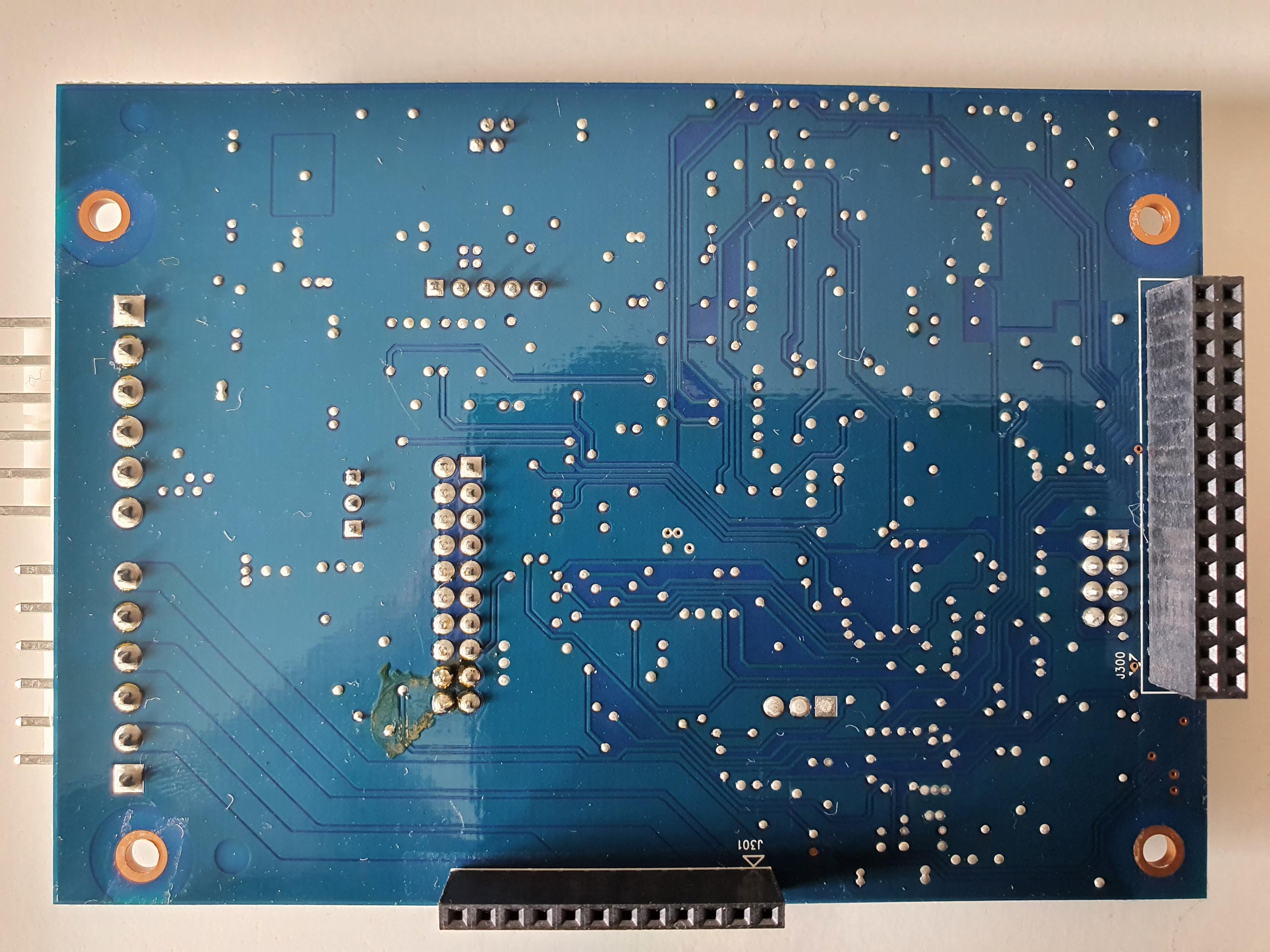

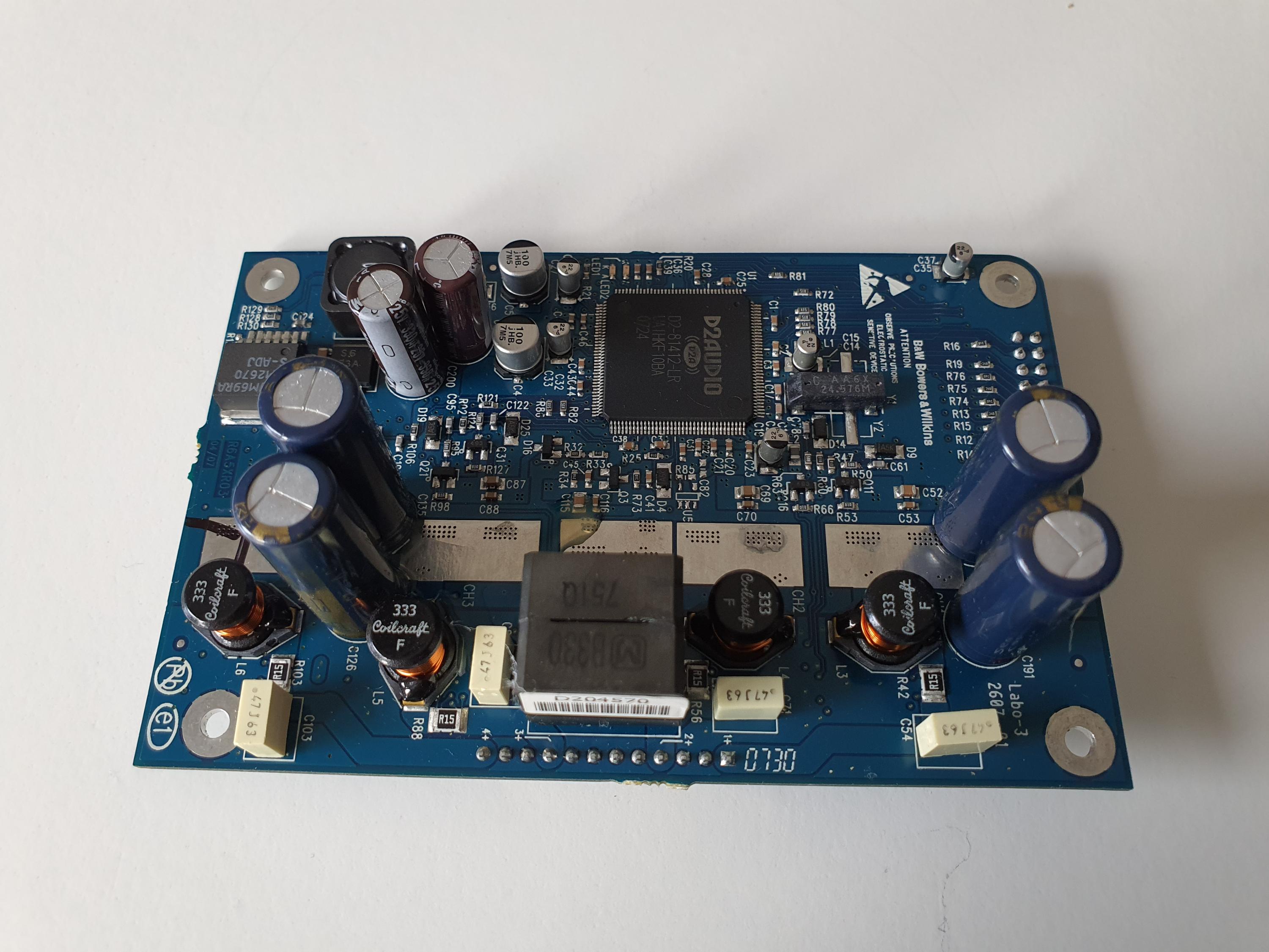

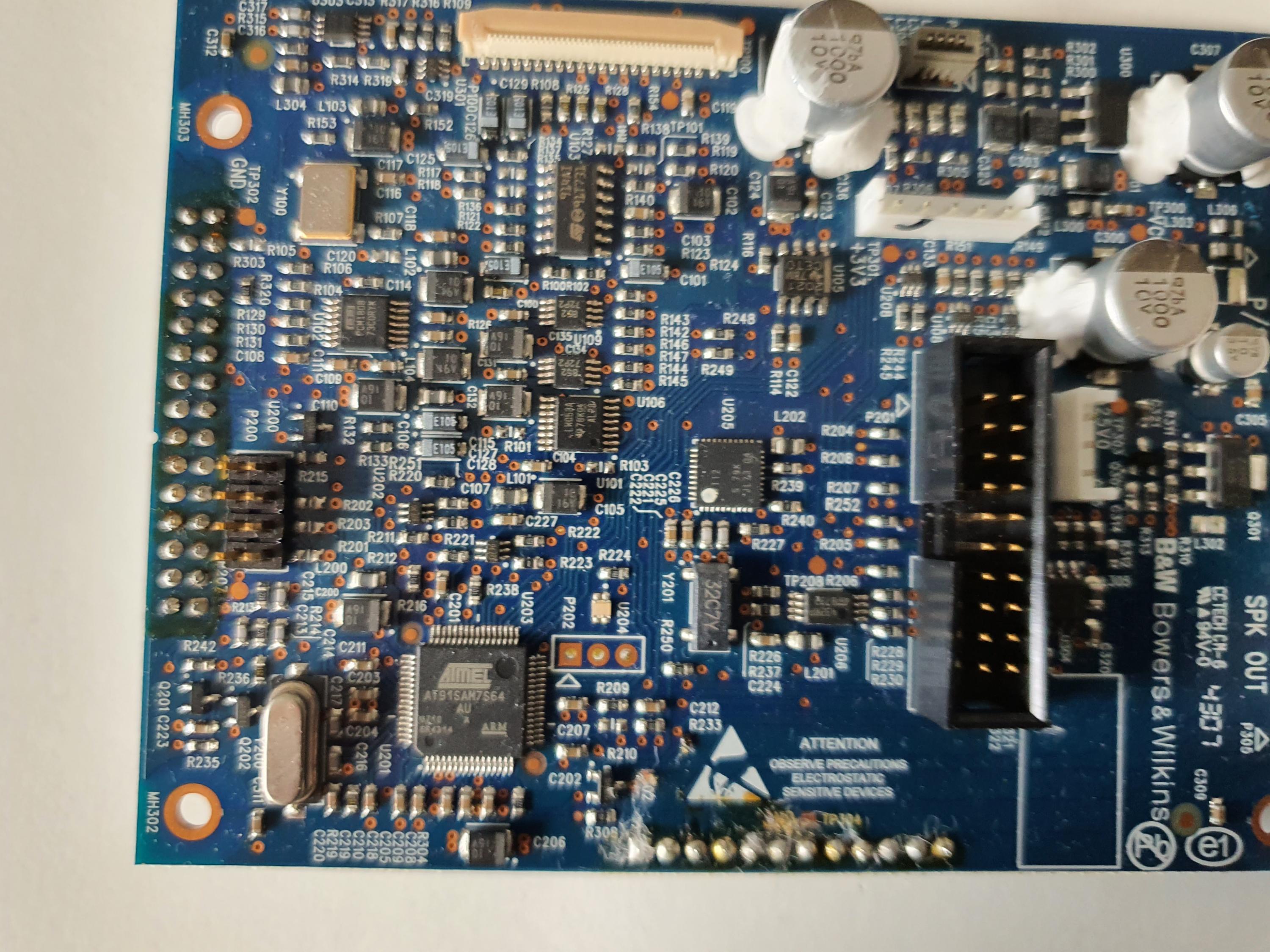

                                      Oh boy, I lost mine Zep (1st Generation, metal back), too. - When plugged in, red light is flashing.
                                      When reading related topics here and elsewhere, i suspect the PSU.
                                      After dissassembling the unit, I expected to find some broken caps, but I would say that all caps look fine.
                                      So this is the root cause why I'm here, I hope that some more experience eyes hint me to the possible reason.
                                      But to be save, there are several photos taken from PSU and Controller Board #1 and #2, maybe i have overseen the broken part.
