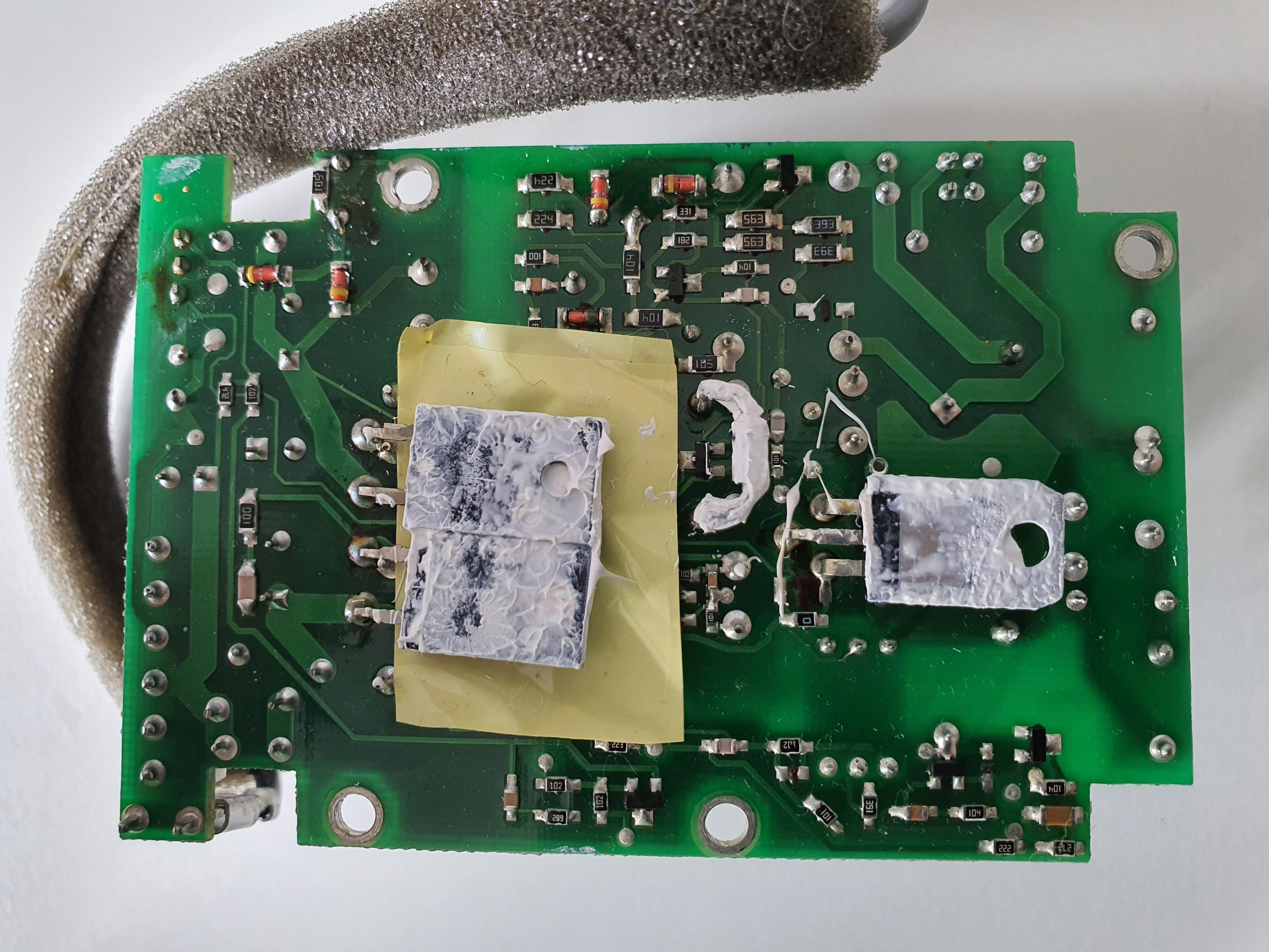

        • OmidN
          • Jan 2021
          • 8
          • France
          Re: Troubleshooting B&W Original Powersupply
          I came across this forum and it seems it the only good help on the net. I had the same issues and I decided to follow the instruction to open my speaker, but when I reached PSU it doesn't look evident to me. Maybe the yellow one?
          I appreciated it if someone could help.
            • 31012
            strange,
            the 4 diodes - D201 etc look like they have burned/corroded leads.
                  Thanks for your help and prompt reply.
                  I should find a place to test them since I don't have the meter.
                  When i looked closer it doesn't seem to me that they are burnt, maybe it was the photo.
                  PFA a better photo

                      • OmidN
                        • Jan 2021
                        • 8
                        • France
                        #31
                        Hello Stj,
                        I have check the diodes D201, all 4 seems to be good, on the good direction they are reading around 470 and opposite OL.
                        on the other hand I touched the surface of the capacitor in the photo, it seems bulged, I also see the one behind is a bit bulged, as far as I understood from this forum I have to order 4 capacitors below:
                        Rubycon ZLH 2200 uF 16 VDC
                        Rubycon XYG 470 uF 16 VDC
                        Rubycon ZLH 220 uF 35 VDC
                        Rubycon ZL 1000 uF 35 VDC
                        could you please advise?

                            • 31012
                            #33
                            bulged caps are bad.
                            it means the liquid in them has boiled or generated gas.

                              #34
                              Originally posted by OmidN
                              Hello Stj,
                              Yes I was going to say they look bulged in your first pictures...
                              Replace them and see how you go...

                                • OmidN
                                  • Jan 2021
                                  • 8
                                  • France
                                  #36
                                  Many thanks for your feedbacks, I changed those 4 caps and my speaker is back to live. I appreciate it, A few comments for the next person:
                                  1. I have damaged the seat for PSU, basically I tried to screw it back gently but somehow all the seats damaged. The plastic became brittle. I eventually managed to fix 3 of the screws so PSU doesn't move.
                                  2. Please look at the disassembly a few times before you start opening, I damaged the locks for the front cover. now the cover is not 100% fixed in its place.
                                  3. In my order the 470uf caps were a bit fatter than the original one, so I was struggling to solder it in its place.
