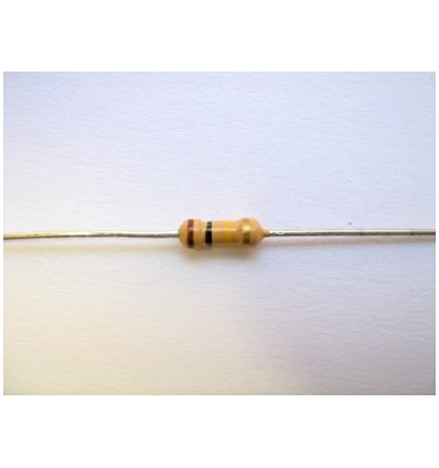

    Also, I just checked some removed parts when I was doing the early repairs, There is a 100K ohms resistor which I don't remember where it was. Could this come in the place where 1ohms one was? Because I don't feel good to keep a circuit with empty part slots
      Yes, possibly.
      How big is that resistor, though? (As in, power rating) - 1/2 Watt? 1/4 Watt?? Less/more? Smooth finish or gray with "rough" finish? The latter could indicate a snubber resistor. On that note, what's the value of R14?
        Just a 1/4 watt small resistor. Like the image I attached.
