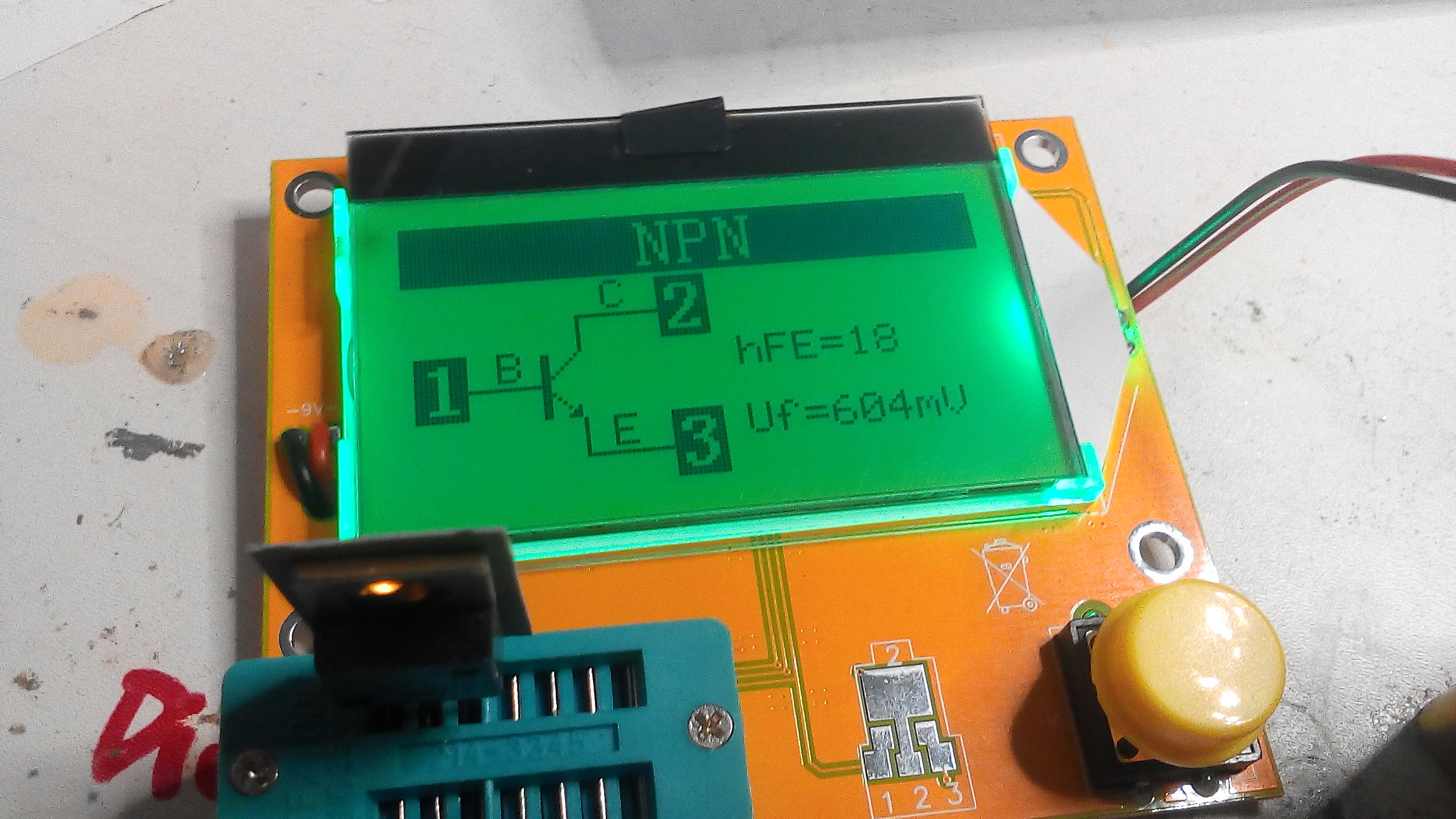

                              here's the test from primary transistors...how do you reckon ?

                                #115
                                Re: 12V rail is not on ?
                                I'm going to test the secondary rectifier and show you the result...give me a moment...
                                I still think that my 2003 chip had died already since it becomes the overvoltage or undervoltage protector...and it was short either 12V or 5V rail....

                                    Here's the secondary rectifier result.....3.3V rail is not good result it's showing resistor result 28 ohm and 205K result...it was brand new before I tested it in circuit...
                                    Brand new from the tray 198 mV and 198 mV
