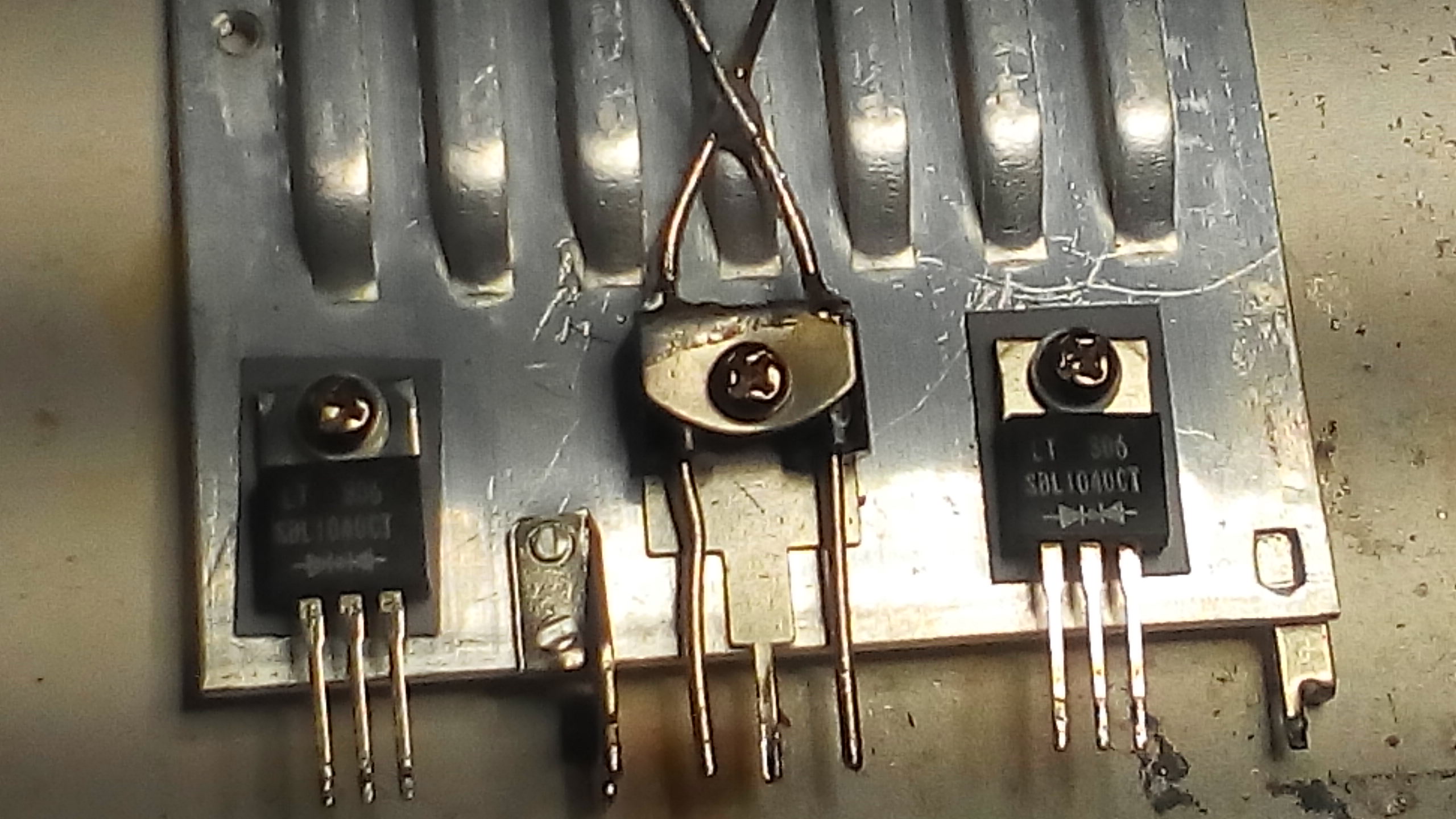

    Does anyone know why my 12V rail is not on ?
    5V standby is on....
    The power supply is LC 300ATX, does anyone have the schematic ?
    I suspect my 12V rail is short, because of short on my capacitor on motherboard..
    it's using to diodes soldered together into heatsink...is it FR302 ?

    5VSB is always on. I am guessing that is the only thing that is powered up. No -12V, no +12V, no -5V,no +5V neither the +3.3V. To turn the rest of the PSU on, take a 1k resistor and jump 5VSB to PSon.
    Other than that, check that D8 isn't shorted, T4 has continuity between pin 5 and 6, L6 isn't open, and that C26 isn't shorted to GND.

      D8 is bad...from my diode test 0v

                    Re: 12V rail is not on ?
                    CapLeaker has already identified the components that are likely culprits.
                    In any case you appear to have already found the problem -- shorted D8. After removing D8, test for shorts across the 12V output again. Also confirm that D8 tests shorted out-of-circuit. There should be an electrolytic capacitor filtering the 12V output. Test it also.
                          Diode in the middle is connected to 12V rail...
                          and I measure with diode 0.1V both side from the base...
                          and the left and right diode SBL1040..
                          I got only 0.4V left and right from the base...
                            Are they all faulty ? I measure from new diodes 0.6V

                              Some photos :
                                Looks like it's different from the schematic, since it's not D8...
                                • bianchi77
                                  • Jun 2016
                                  • 1121
                                  Almost the same with :
                                  "LC-B250ATX ch. Y-B200-ATX ver. 2.9 JNC Computer Co.""
                                  I can see diode label is match...
                                    Umm... that link isn't showing.
                                    With your DMM set to diode mode, probe the left and right pins of the diode to the middle pin. If there is a short, the diode is bad. easy.
                                    The SBL1040 is a 40V, 10A Schottky rectifier that has a voltage drop of 0.6V. Problem is that it is only a diode with 2 legs, it should be one with 3 legs.
                                    Maybe you can upload nice straight shot, high resolution pictures here to badcaps, using the attachment feature.
