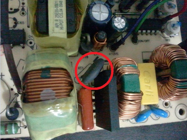

          I will post some images, is missing some components because I am testing on multimeter one by one.
          NTC (INrush Current limiter) or PS:

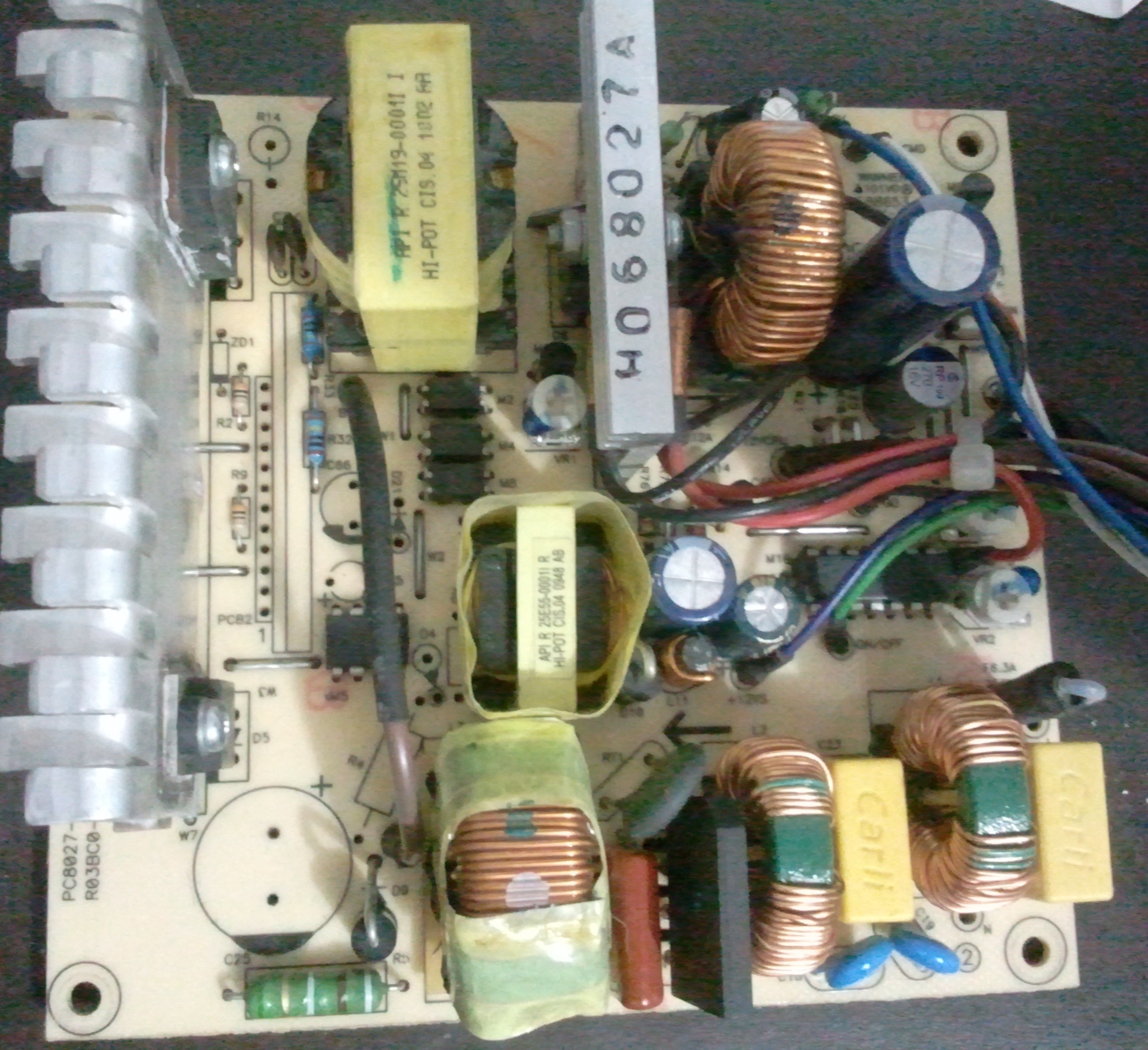

          The circuit viewing from TOP:

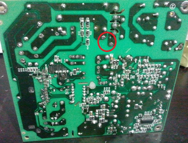

          The Circuit viewing from Bottom:

          This is a Power Supply from HP 8000 Elite SFF Auto 110V or 220V 240Watts 90 or 80% Efficiency, I do not remember now
            Re: Alternative to Varistor UEI 13SP 2R5
            OK, it is NTC for inrush current limiting, the one on MOUSER is fine to use.
            BTW, was the old one burnt up?
