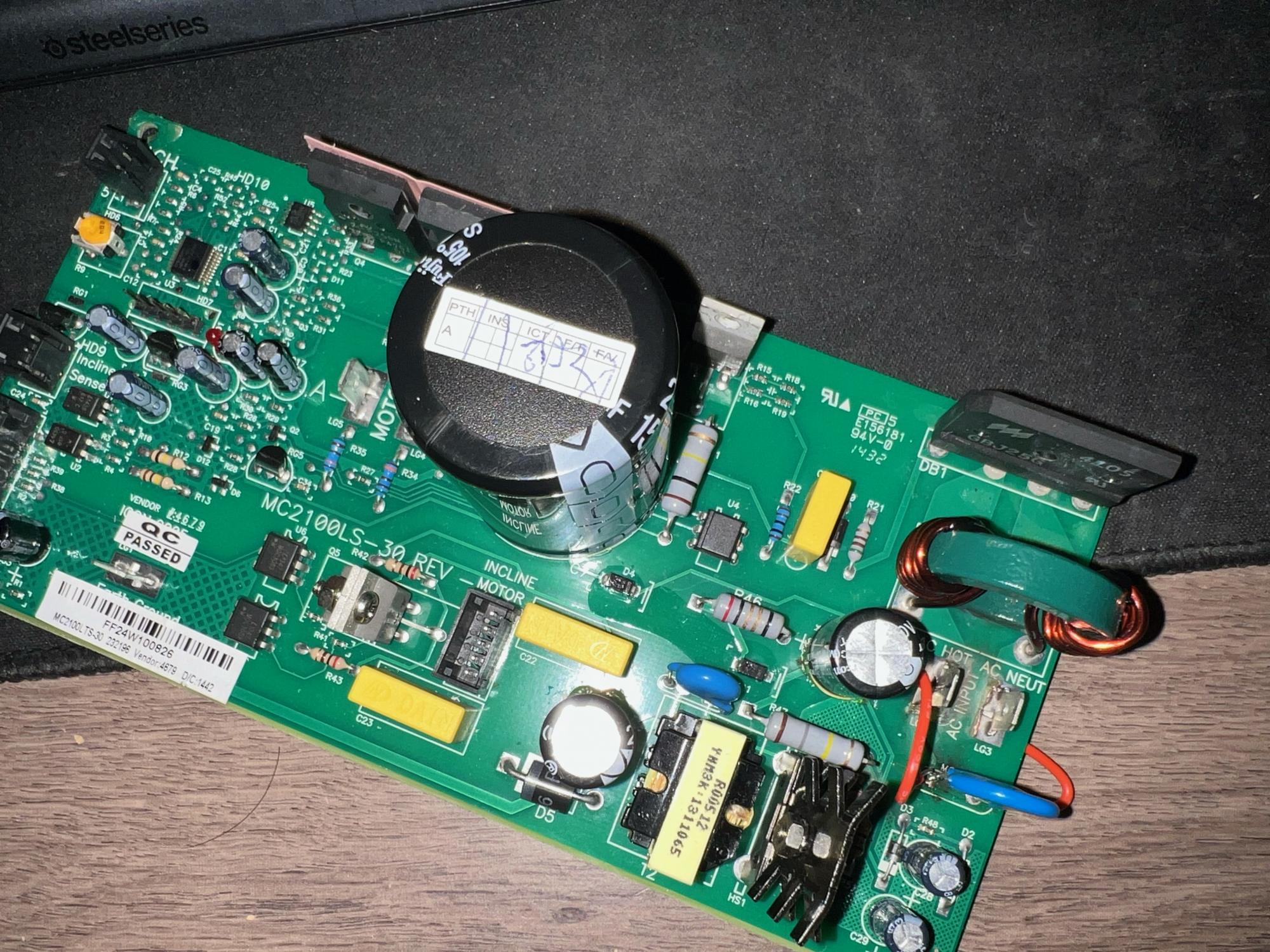

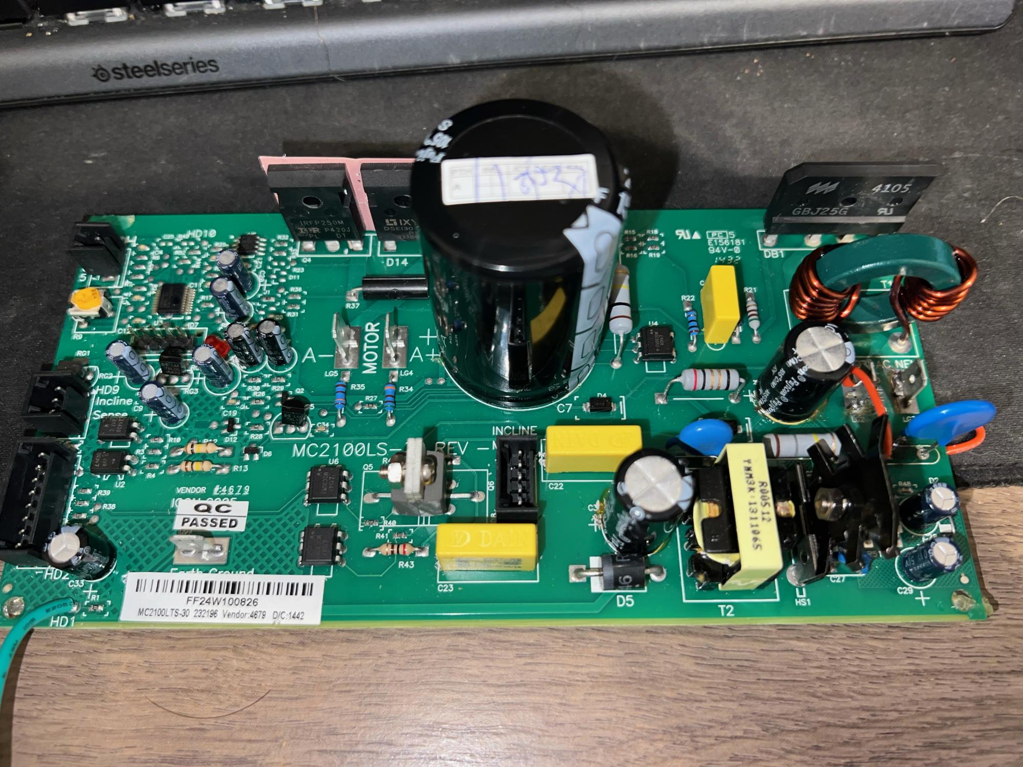

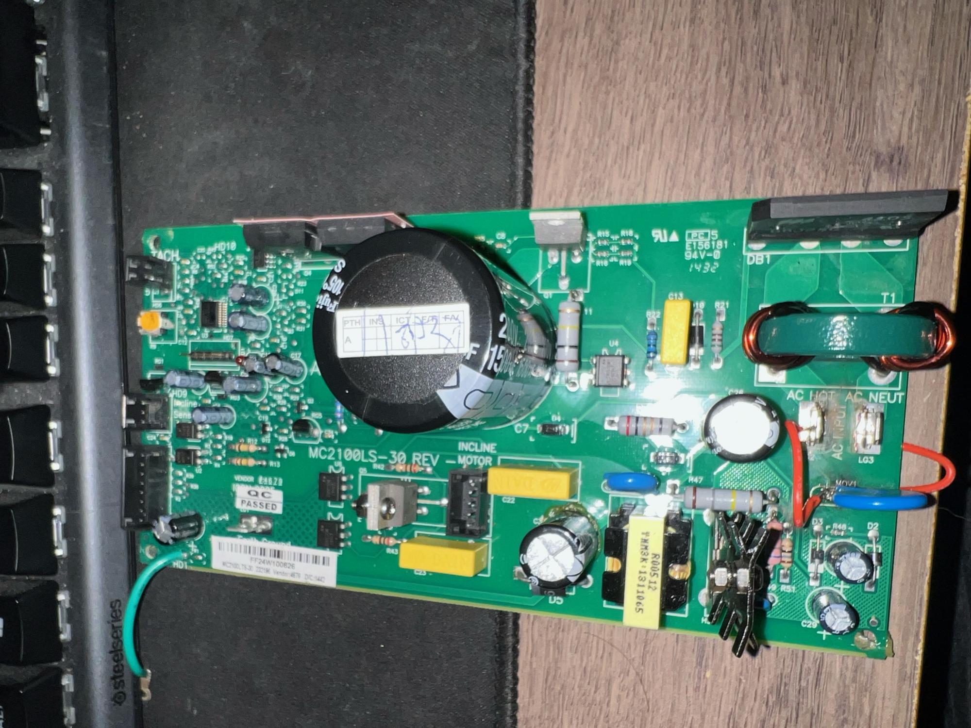

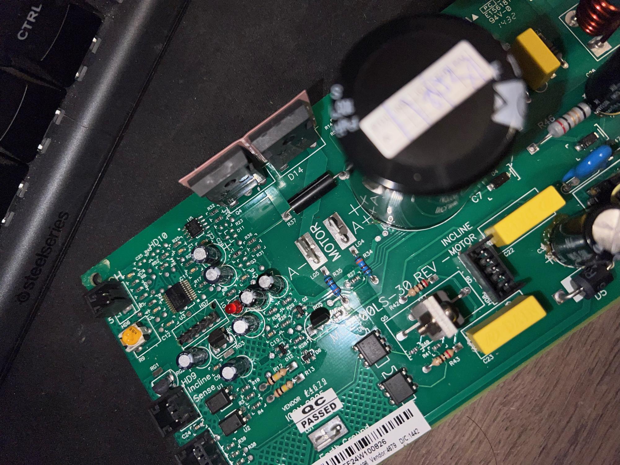

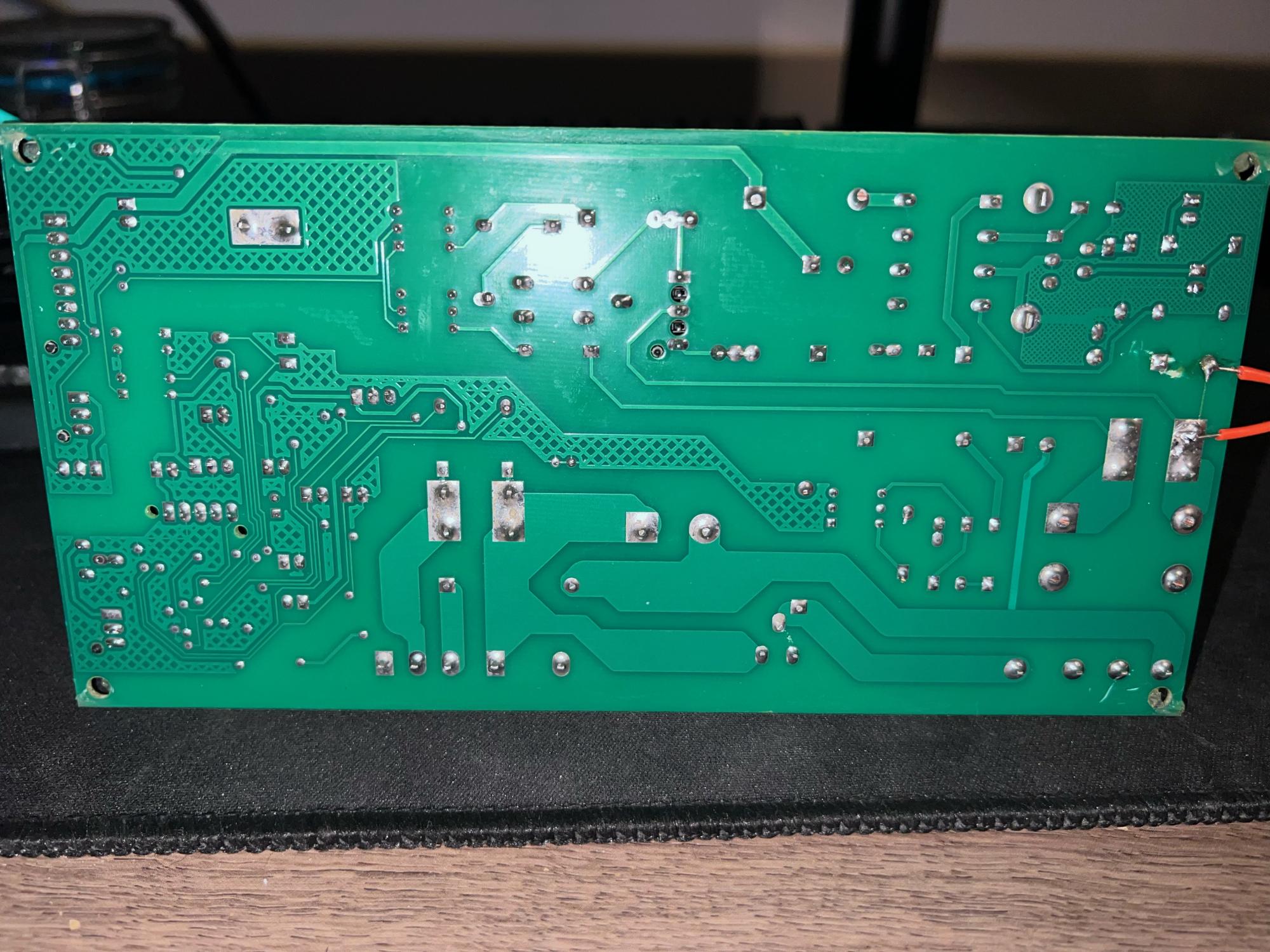

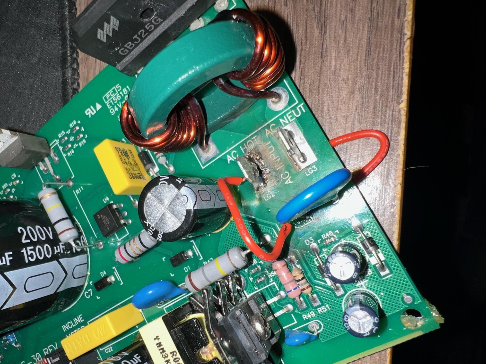

    Hi everyone,

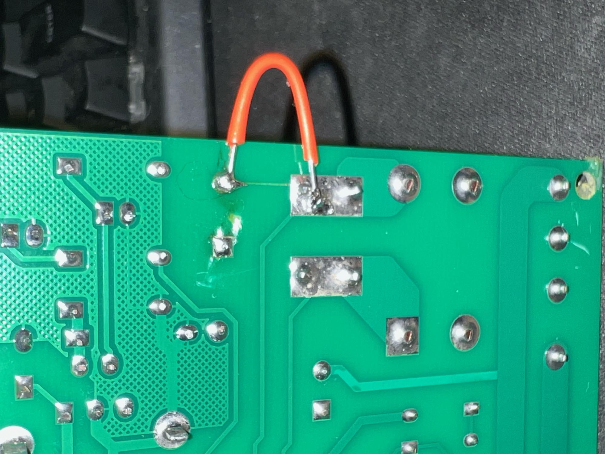

    Recently I acquired a treadmill that was hit by a power surge (I assume). On the control board, there was a varistor that was blown apart and two traces that were partially blown out. I replaced the varistor (to my knowledge it is a matching one) and wired back where the traces were with some 22 awg solid copper wire. When I went to power it on, still nothing. On a quick inspection with my meter, I was getting incoming voltage on the AC in terminal.
    The board is a MC2100LS-30 treadmill controller.
    Visibly, there are no other problems. I am wondering what some other things I could check that may have been damaged in the surge. Attached will be some pictures.
    Thanks!

    Re: Treadmill hit with power surge
    check for dc leaving the bridge rectifier and check the big gray resistors

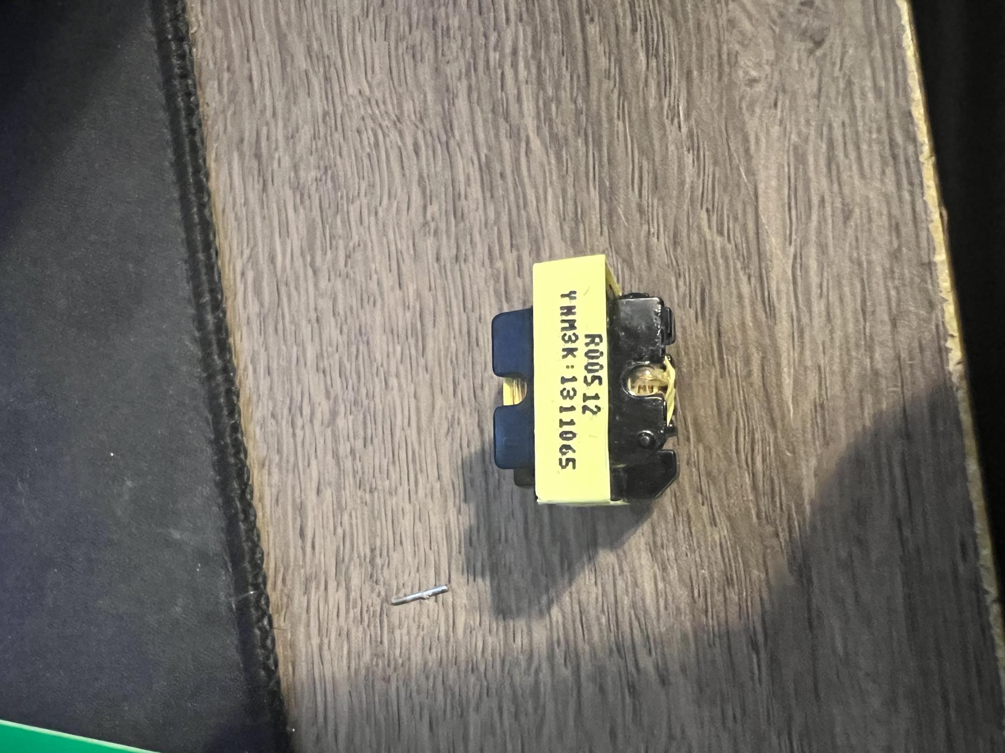

                Poking around with it tonight I found that this transformer (I think that's what it is) had no voltage coming out on the secondary side and looked kind of melted on the underside. I couldn't see until I got it unsoldered. Going to try to identify the part and see if I can find a replacement.
                  Your DC ground reference on the primary side of a power supply is always the negative post on the main filter capacitor. So when you measure from any of the main filter capacitor legs to chassis ground, you are using the wrong GND. The voltage across the DC side of the bridge rectifier being at 170VDC is o.k.
                  Next to the pink resistor looks like a TO220 device probably something similar like a TOP247YN with 5 legs mounted to a heat sink. Replace it.
                    CapLeaker
                    I was thinking the same thing weather or not it was a TOP something device
                    That why I was asking for both devices “U4” can not read the part number
                    What is the part number for “U4” also what is the part number for the device that has the heat sink or if you do not want to take the heat sink of how many pins does the device have
                      The number for the part attached to the heat sink is STR G5551. The “u4” device is MOC3052-A.
                        Can anyone identify that transformer?
                            If the STR G5551 is dead, there won’t be anything happening on the secondary of the transformer.
