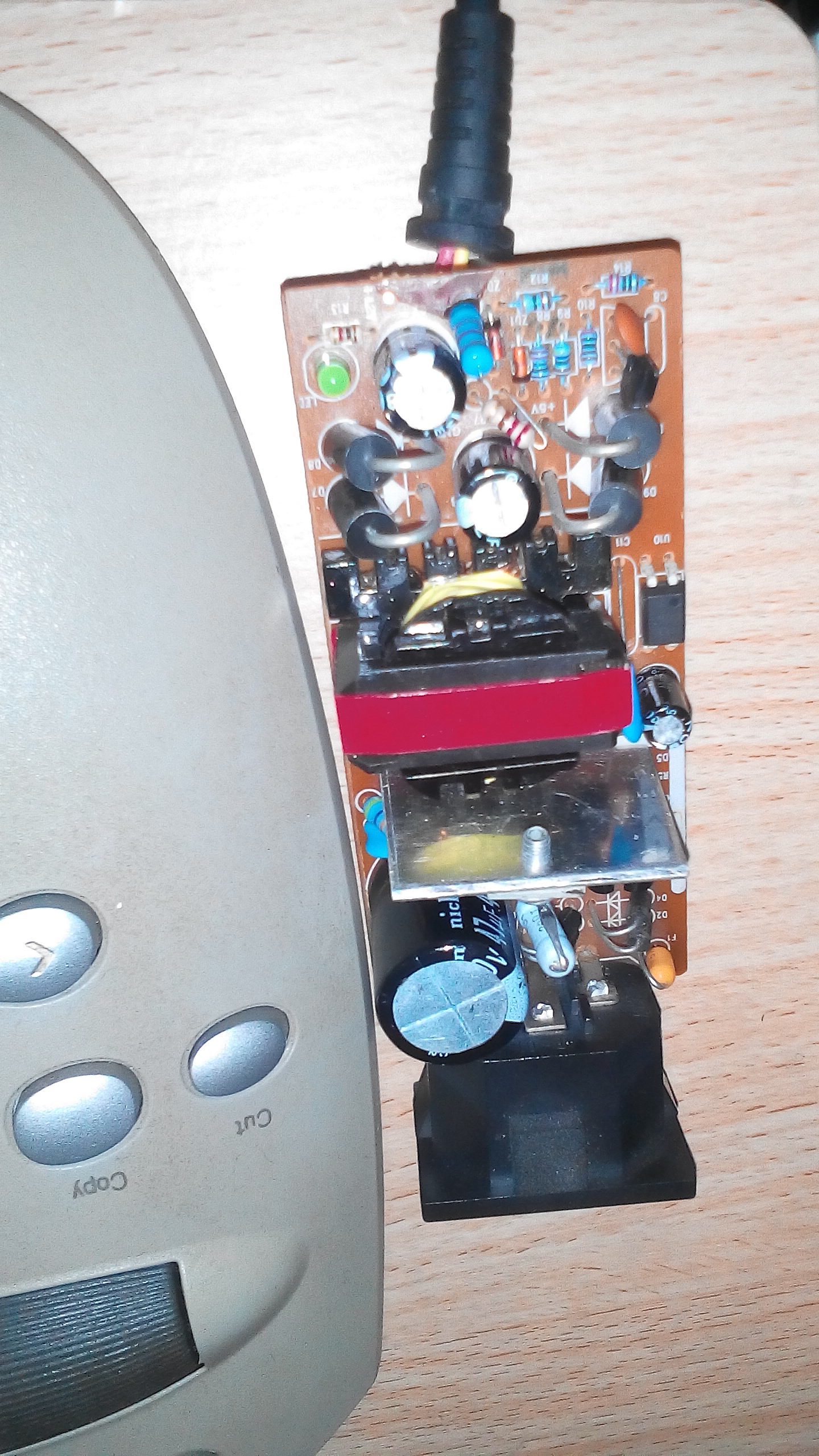

    Guys,
    Anyone knows about this SATA/PATA external supply ?
    I suspect 4N60 FET burn....
    Fuse blown, I've change it, is it possible if the small transistor frequency generator broken as well ?
    Photo :
    cheers

    Those things don't fix.... They are dangerous when working, and would need a complete redesign to be fixed. However, they do make for a great learning experience because they are so simple. Look for bad solder, they are known for it. We need to see the bottom of the board. The switcher does look cooked, as well as the resistor in-between the cap and the MOSFET.
    But for the sake of your self, your computers, and your data, don't use it once you've fixed it. You're better off with an older computer PSU.

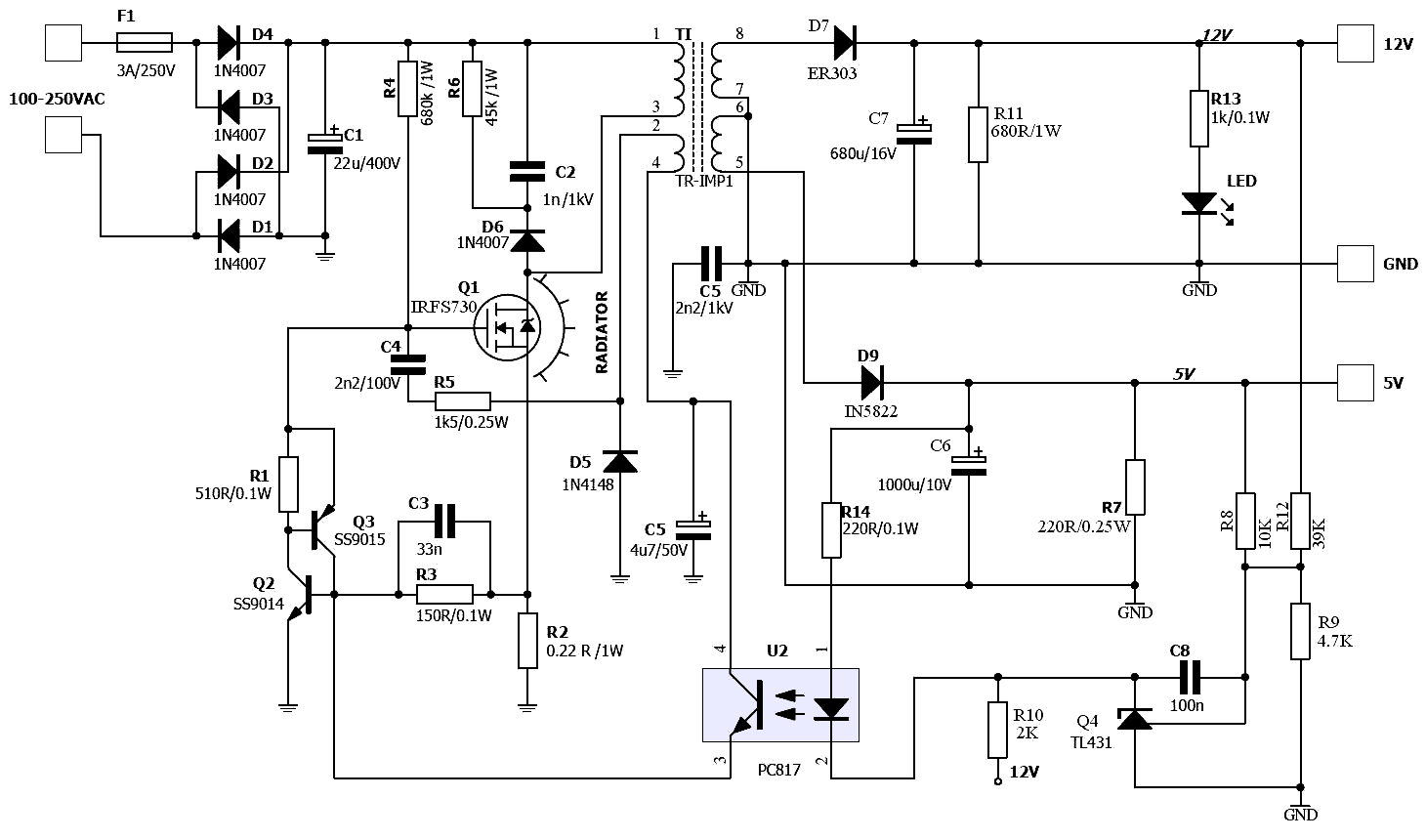

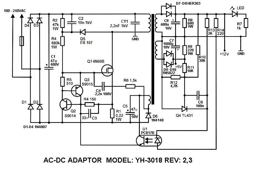

      Here is a diagram that might help.

        the switcher is a pair of 9014 and 9015, FET 4N60, are they all burned ?
        Yea, I want to fix it but not for HDD, I'll use it for something else...
        @zx8401....tx for the schematic

          ok, I'll show you guys, the bottom one, it's terrible PCB...I need to fix it....
          What's the value in circuit between E (emitter) and C (collector) of 9014 and 9015 when I test with multimeter ?
          FET is definitly burned....

                    Check those 1N4007 there are 4 of those they usually go along with the fuse and mosfet but from your pic the resistor by the cap looks burned too.
                          Which resistor?

                                    Here is another schematic, this basic 12v and 5v supply is copyed by many.
                                    • bianchi77
                                      • Jun 2016
                                      • 1121
                                      Re: SATA /PATA external supply ?
                                      Thanks for the schematic,
                                      it's working now...but I don't have 0.22 ohm /1W....
                                      temporaly I change to 22 ohm / 2W.....It gives me a lower DC voltage output...
                                      I'll change to to the proper one later on....waiting another month
