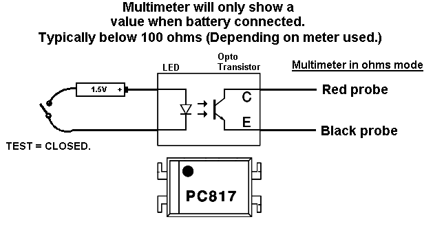

        The 0.22 ohm resistor should not be controlling the output voltages, with no load on the output they should be about 12v and 5v, if not then you have a fault with the feedback opto coupler circuit.
        Take your suspect diodes out of circuit and check them for conduction in one direction only, use the diode check on your multimeter.
        If your meter does not have a diode check then put the diode in series with a small bulb and battery, it should light only in one direction.

            How can I test opto coupler ?

                  Re: SATA /PATA external supply ?
                  A Basic test to see if the opto coupler is working is to connect 1.5v to the led side and see if the transistor side goes low resistance in value.
                  The meter should show open circuit with no voltage applied.
                  Here is a piccy to show the connection.

                    I got the output 0.3V and 1.3V, suppose to be 12V and 5V, could it be opto coupler ?
