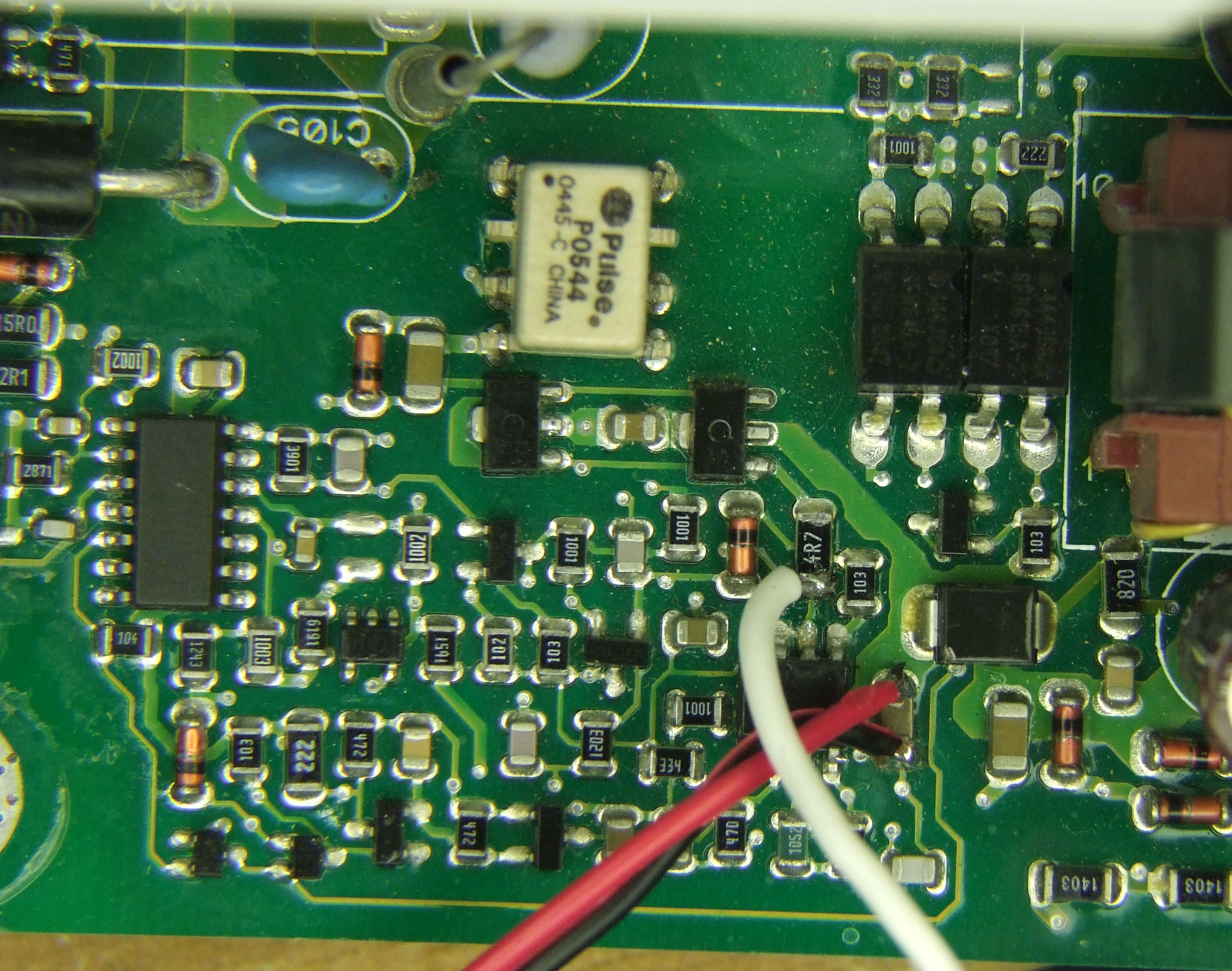

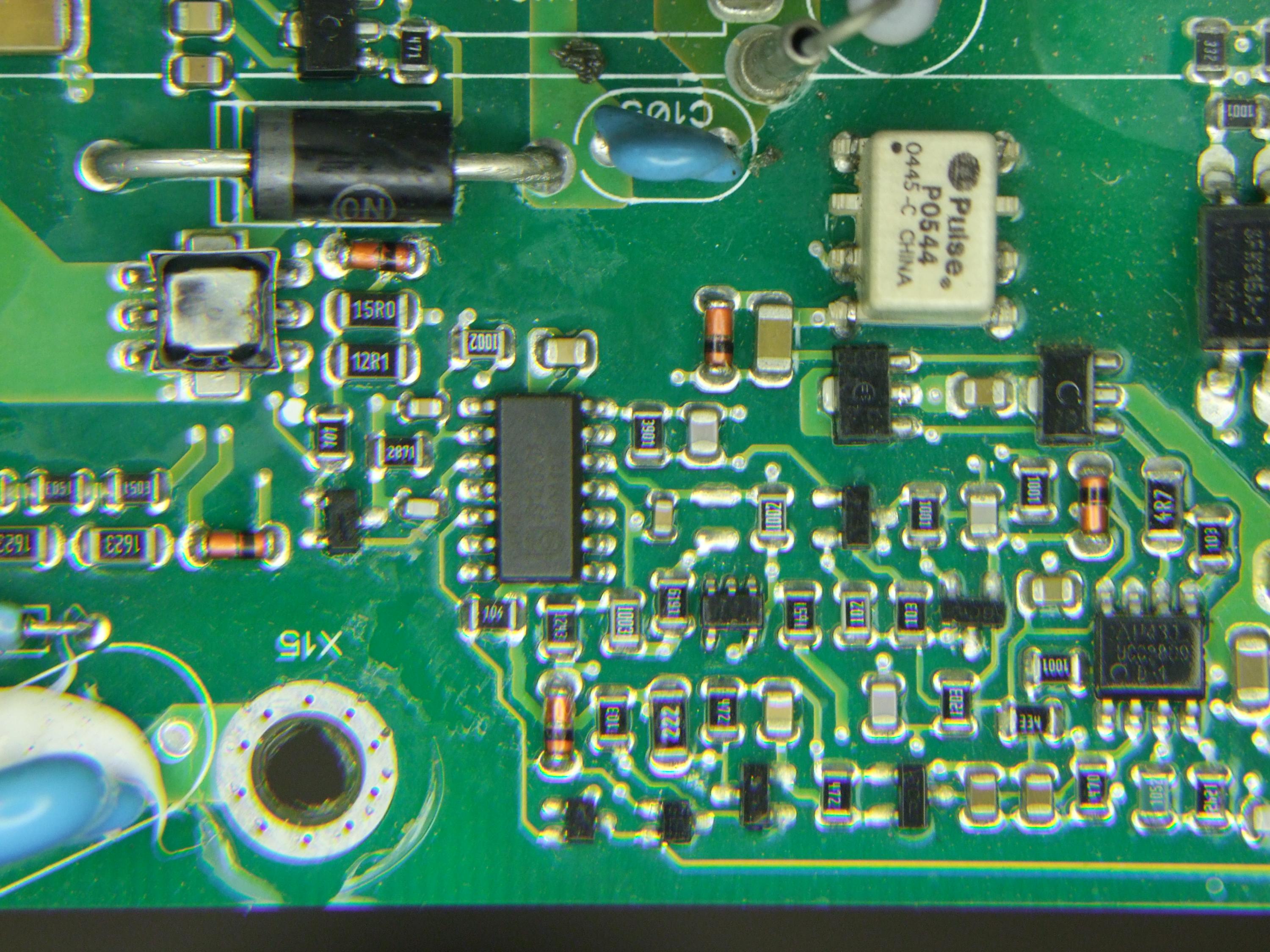

            Re: Quick Nautical Equipment - SBC 500 FR ADV PLUS - Shorted Output Error E1
            This is the circuit (the part with the 4x SOT-23) that connects to the outputs and goes to the microprocessor.
            For some reason resistor values are way off but they may be connected in parallel at a different place?
            Just another note: I measured the output of the FETs on the primary contacts of the transformer and i don't get any voltage upon power on....

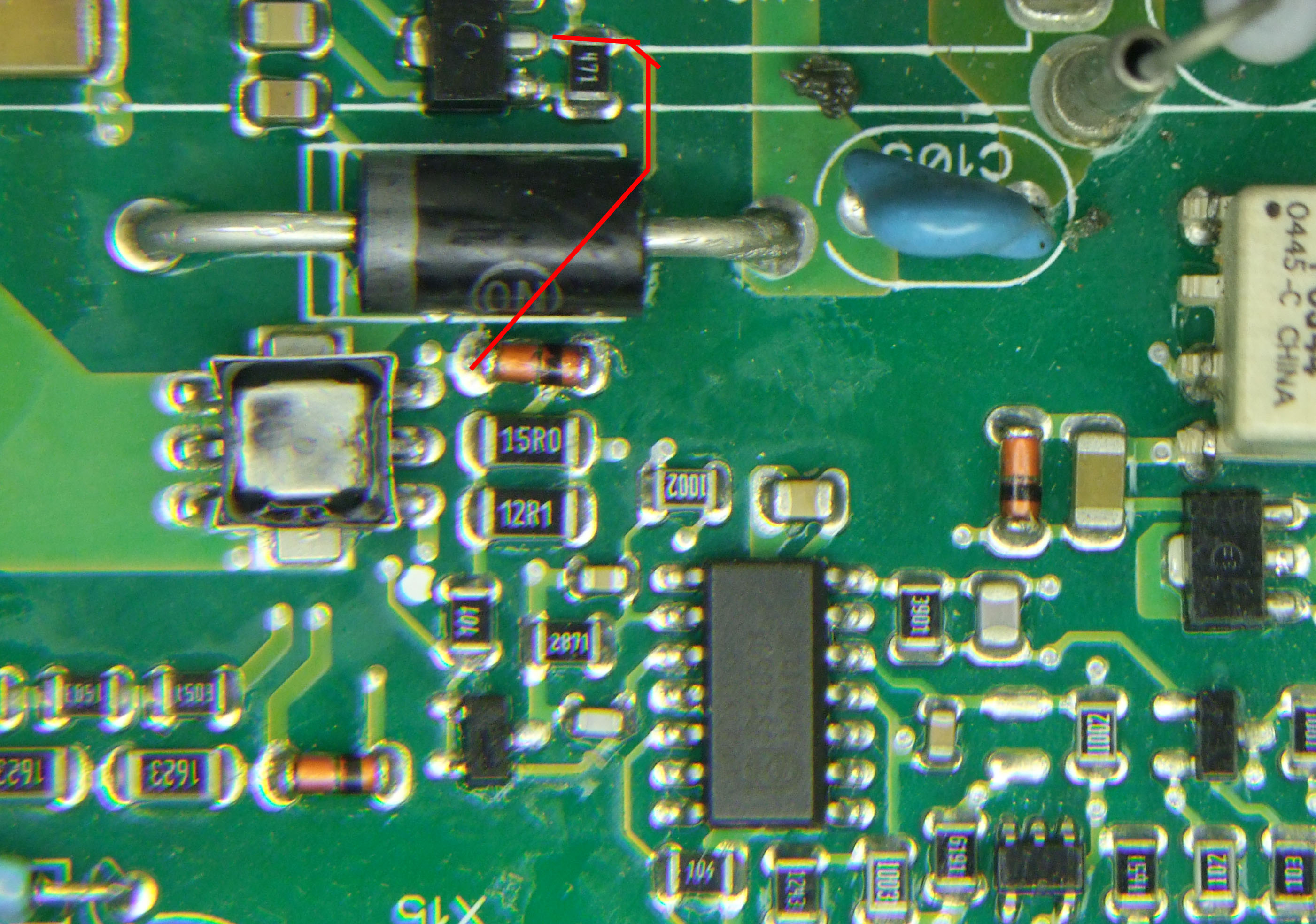

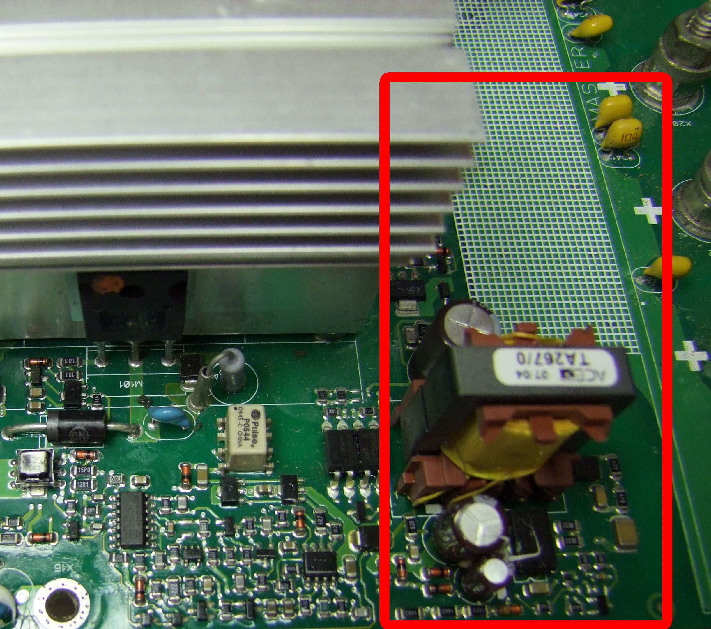

                  I have to give the charger away tomorrow so i want to take a last look to maybe find what the problem is. Checking the circuit on the primary side i noticed a strange reading of 1ohm across the diode noted in the picture. The diode measures ok.
                  Next to that there is a part which a can't recognize. If it is a coil the maybe the readings are ok. But if its something else it definitely measures shorted.....
                  If anyone has any more input about the part o whatever i will give it a try!
                  Thanks!
                    https://www.badcaps.net/forum/attach...0&d=1466185446
                    It looks like current sensing transformer, the two big tab (one-turn winding) under the the transformer has one end connected to GND plain, another tab goes some where around the MOSFETs section, the 3 pins on the right side are the outputs side, that Diode that shows 8 Ohms or so may be showing the total resistance reading of the two resistors (15R0, 12R1) connected in parallel. I cannot tell exactly how that section is connected together to form the circuit, hard to trace the board.
                    • sententia
                      • Oct 2013
                      • 269
                      • Greece

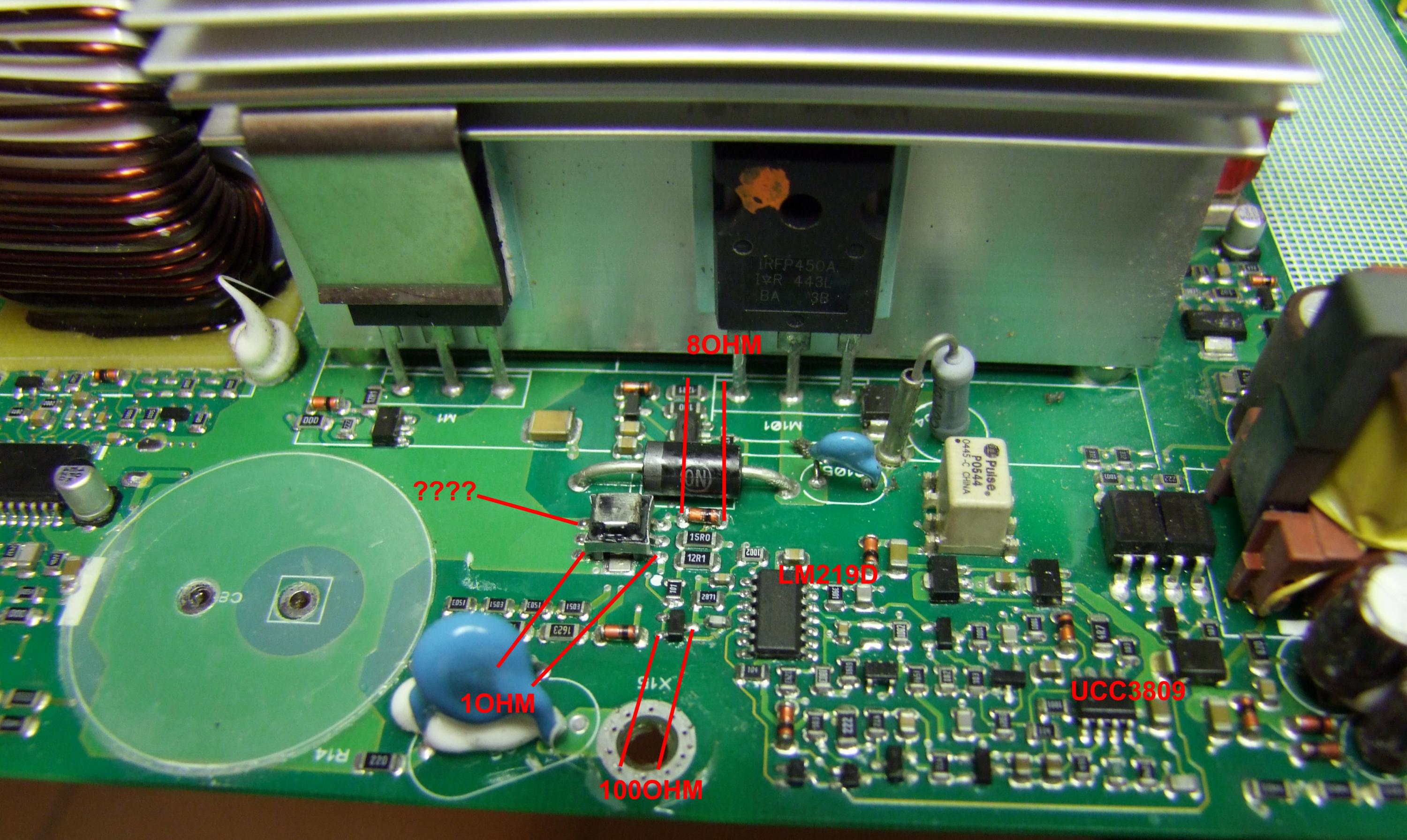

                      aaa ok! That makes sense...
                      The diode connects to the circuit above as noted in the picture.
                      The diode does not measure the same as the parallel resistors which measure 7ohms.
                      bump with this one....
                        check that UC3809 PWM. See if it gets Vdd (min. 12V), and if there is something coming out of the gate drive. Since the PWM has a HV pin, maybe it got fried (power surge).
                          Ok! Although UCC3809 gets steady 13V on VDD, the gate drive output is 0V. Not even a small peak upon power on.
                          However i am not sure how the feedback circuit works but i think the gate output should give something..... hmmm
                          EDIT: UCC3809 gets power on VDD upon power on and not when the relay closes (2-3 seconds after power on). When power on i get 0.7V on the gate out for a split second....
                                Had same thouble today.
                                One winding of small pulse transformer was broken by corrosion.
                                Solved.

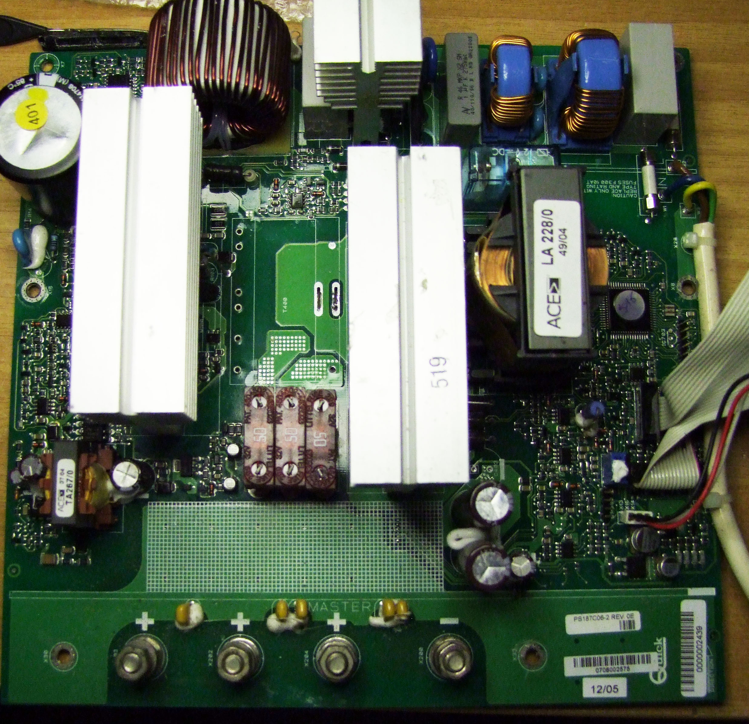

                                • heffner
                                  • Jul 2021
                                  • 3
                                  • Sverige

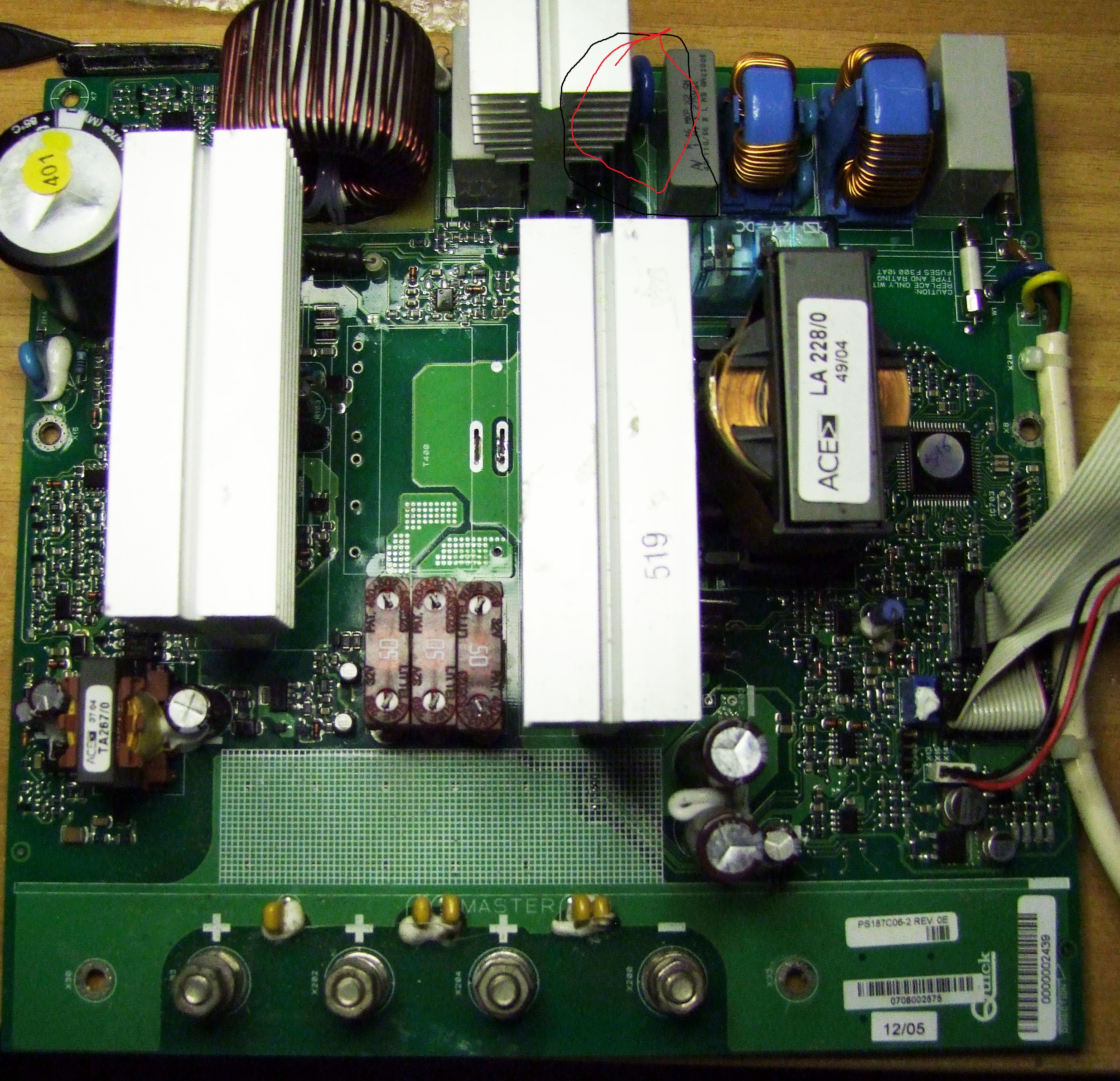

                                  hello guys i have a problem my charger is missing the component i have marked in your pic is it possible for you to read the nr on it and share it? brgds
                                  • heffner
                                    • Jul 2021
                                    • 3
                                    • Sverige
                                    pic
