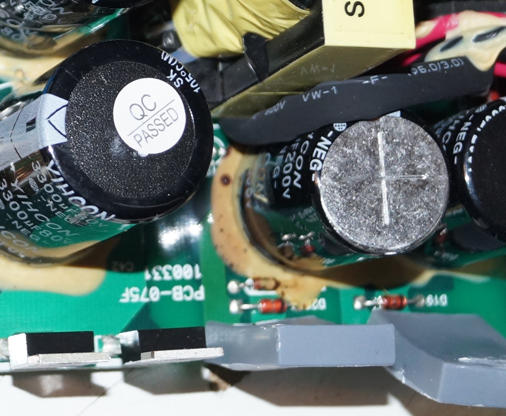

    Working on a Monitor Audio 370HD sub which is blowing fuses.
    Nasty yellow glue on board again which looks like its turned conductive and evidenced by the burnt nature of it around the big cap and this diode.
    Anyhow need help identifying diode value. In diode mode is reading 0L both ways, and it isn't shorted so that means its open?
    Any idea what value it is and a suitable replacement?

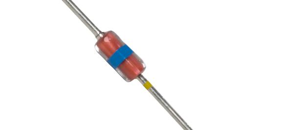

    Not a plain diode, no cathode marking, so it's a bidirectional something.

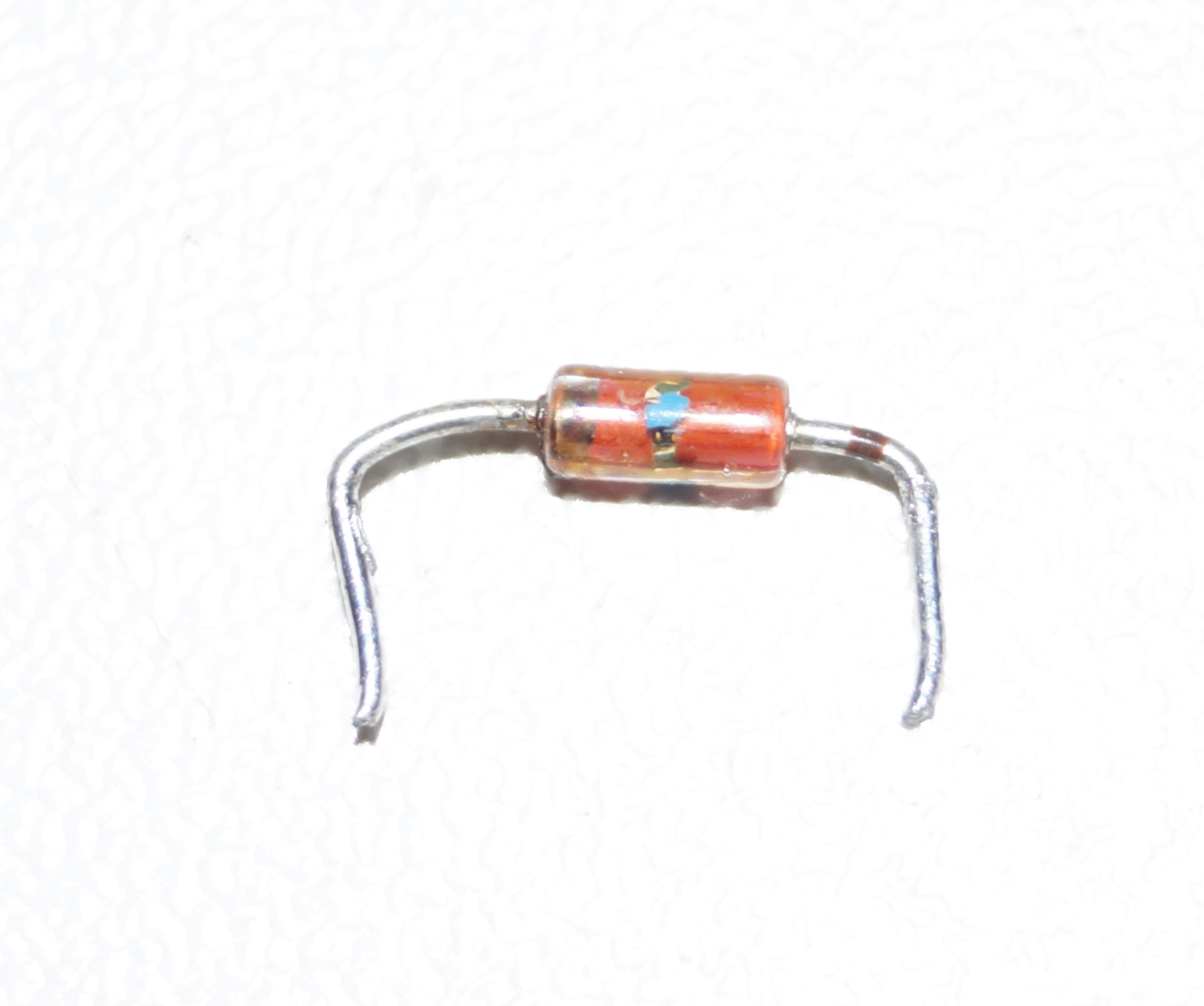

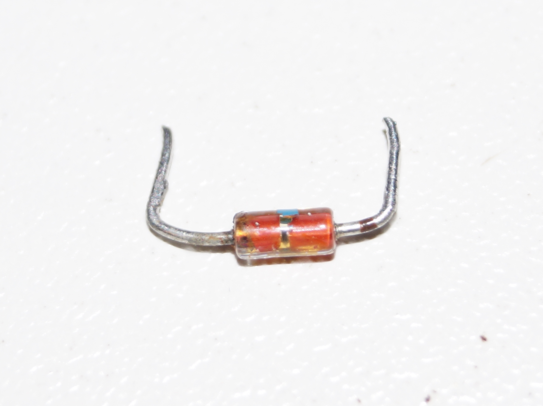

    The only thing I know that looks like that is a Diac, like a BR100 or Asian DB3.
    The brown bar on the lead is the voltage category I think.
    They read open until you exceed their trigger voltage (in either direction) 28V-45V depending on the part.
    You'd have to scrape the glue off the silkscreen for more info, or trace what it connects to.

      Have scraped the glue but its just says D24 which is placement number.
      Tested big cap and it reads ok 330uf @ 200v, reads 334uf 0.2esr.
      hmm might check the rest of the caps first as they are the usual suspects but given the burnt glue and what I assumed was a dead diode since it was reading 0L I thought it was that.

          Re: Identifying a diode value, conductive glue strikes again!
          It is visible it was there before, second pic left side. I think it's the thing you call brown, it is just scraped off.

            On the board its got a cathode marking. Anyhow budm some pics
            the transitor is a Toshiba k4107 the its directly below and in line with

              If the primary side is a self oscillating design, the diode is likely to be a diac to produce starting pulses. It would be normal to read open on diode test. Diacs trigger at some high voltage.
                I think you are correct, it looks like half bridge drive with two large lytics caps and two power MOSFETs drive setup to drive the power transformer.
