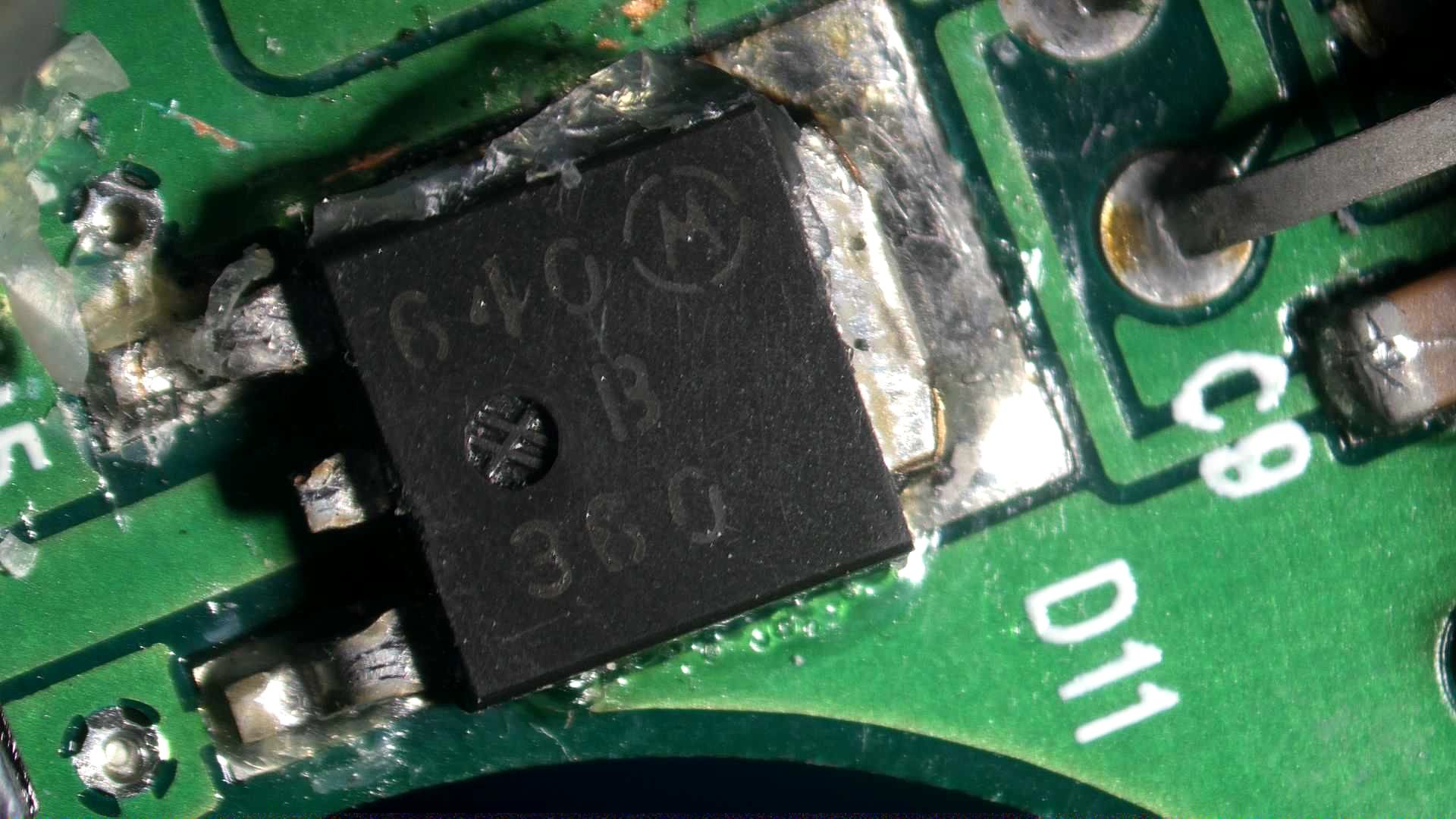

    Need help identifying this (double?) diode
    I tried to locate online without any success but maybe someone else might have better luck. If it is a double diode - it's done - based on the reading I got in diode mode.

    nuttn much, but a plain Schottky 6A 40V common cathode ultra fast diode.

      MBRD360, 3A, 60V, single Schottky barrier rectifier:
      https://www.badcaps.net/download/?id=dc6454d4
      The top line is a date code.

        Thank you for the replies, seems to be fine once I tested it out of circuit.
