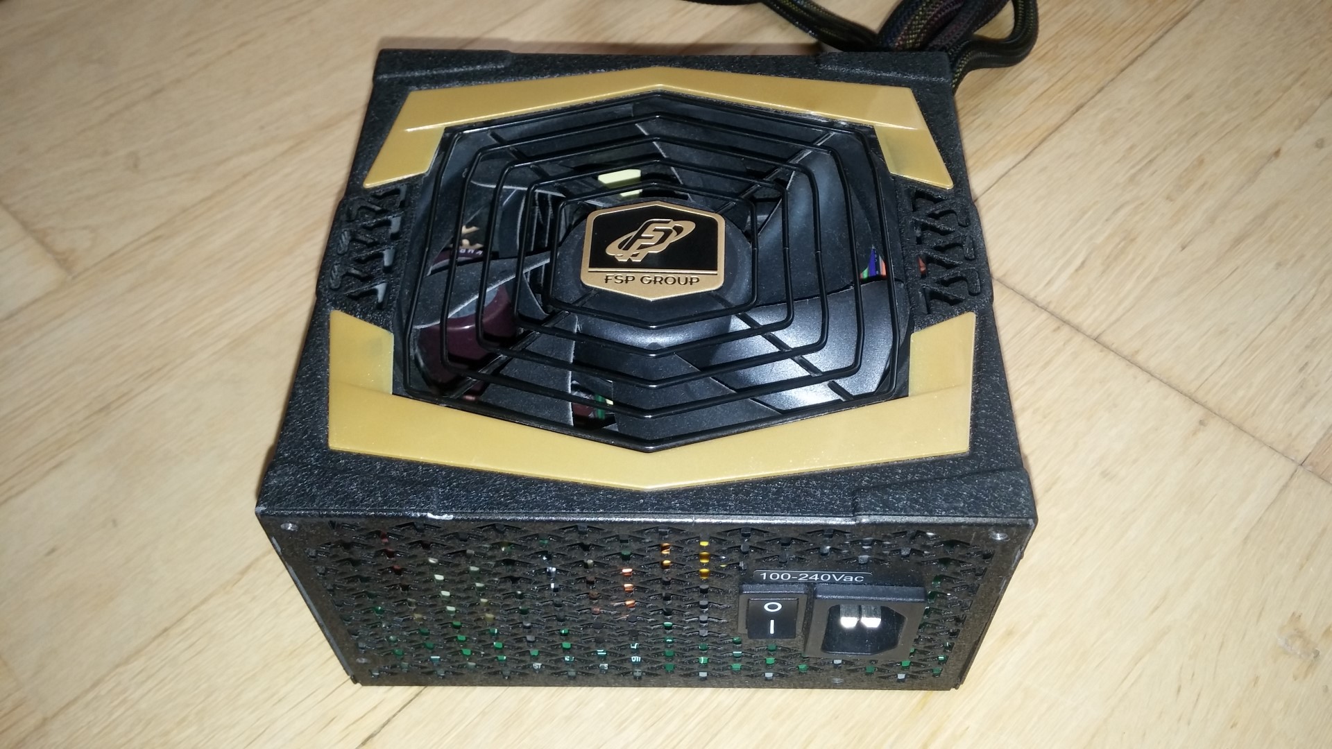

    My FSP AU-500 served me well during 5 years with no problems.
    Then all of a sudden my ASUS main board warned for inconsistent power and then shut down the system. After a few shutdowns I changed to an older corsair CX400 and all was well.
    Tried the AU-500 in a another system to see if it was the anti-surge in the ASUS motherboard causing the problem. Worked well on a gigabyte 880g for a few hours with some load on it and then again it restarted. Tried again and this time it shutdown not wanting to start at all.
    As my warranty was nullified during RMA, due to damaged package during shipping, I now have it back wanting to try and fix this.

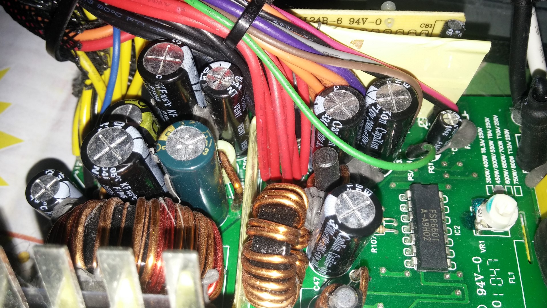

    Caps (All measures in circuit)
    4 3300uf 10v Capxcon
    2 3300uf 16v Capxcon
    1 2200uf 16v OST
    1 ? Brown
    1 47uf 35v Capxcon near FSP IC 6600
    (57uF 0 esr)
    1 4.7uf 50v Capxcon near FSP IC 6601
    (5.2uf 3.3esr)
    1 100uF 50v ?(Nippon) Brown near mosfet
    1 270uF 400v Nippon-Chemicon
    There is no sign of bulging caps and in circuit measures of the larger Caps does not reveal anything had 7600uF and 0 esr, but again its in circuit.
    It could be a problem with the control circuits fail-safe triggering on a false reading or damaged. I´m looking at the two caps near the FSP ICs.
    I am surprised to find this many Capxcon in here.
    Any suggestions?

    To get reliable measurements you have to desolder the caps.
    CapXon KF being 5 years old; it would be surprising if both ESR & capacitance is still within spec!

      I would remove the capacitors that are close to the smaller yellow transformer, test those for low esr.
      The 5v standby supply is used to feed the control chips of the whole thing, so make sure the standby voltage is stable.
      Thats my starting point :-)

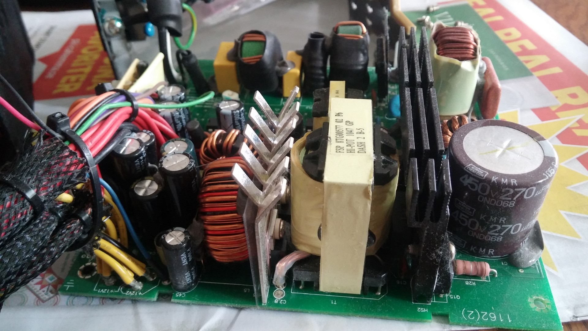

          Ok here are the caps out of circuit with pcb numbers for future referens:
          Measured value(CAP,ESR)
          C45 Capxcon KF 1000uF 16v (979, 0.01) 8mm
          C43 OST 2200uF 16v (2000, 0.00) 10mm
          C42 Capxcon KF 3300uF 16v (3250, 0.00) 10mm
          C44 Capxcon KF 3300uF 16v (3240, 0.00) 10mm
          C49 TEAPO 4700uF 10v (4820, 0.00) 10mm
          C50 Capxcon KF 2200uF 10v (2400, 0.02) 8mm
          C47 Capxcon KF 3300uF 10v (3600, 0.00) 10mm
          C37 Capxcon KF 3300uF 10v (3940, 0.00) 10mm
          C46 Capxcon KF 3300uF 10v (3880, 0.00) 10mm
          +1 Capxcon KF 3300uF 10v (3788. 0.00) 10mm
          Note no number but adjacent to C46
          The 0.00 ESR is odd, but that might be my meter lacking granularity
          What do I put there instead?
          Any thoughts?

            Re: FSP AU-500 Aurum series
            c50 onwards.
            any time you have a noticably higher uF reading than the cap it's a red flag!
            does your tester show leakage current?

                i would panasonic the whole psu personally.

                    isnt the aurum series supposed to be a full japcap psu? bait and switch again?

                        Aurum CM is, the 'normal' is not.

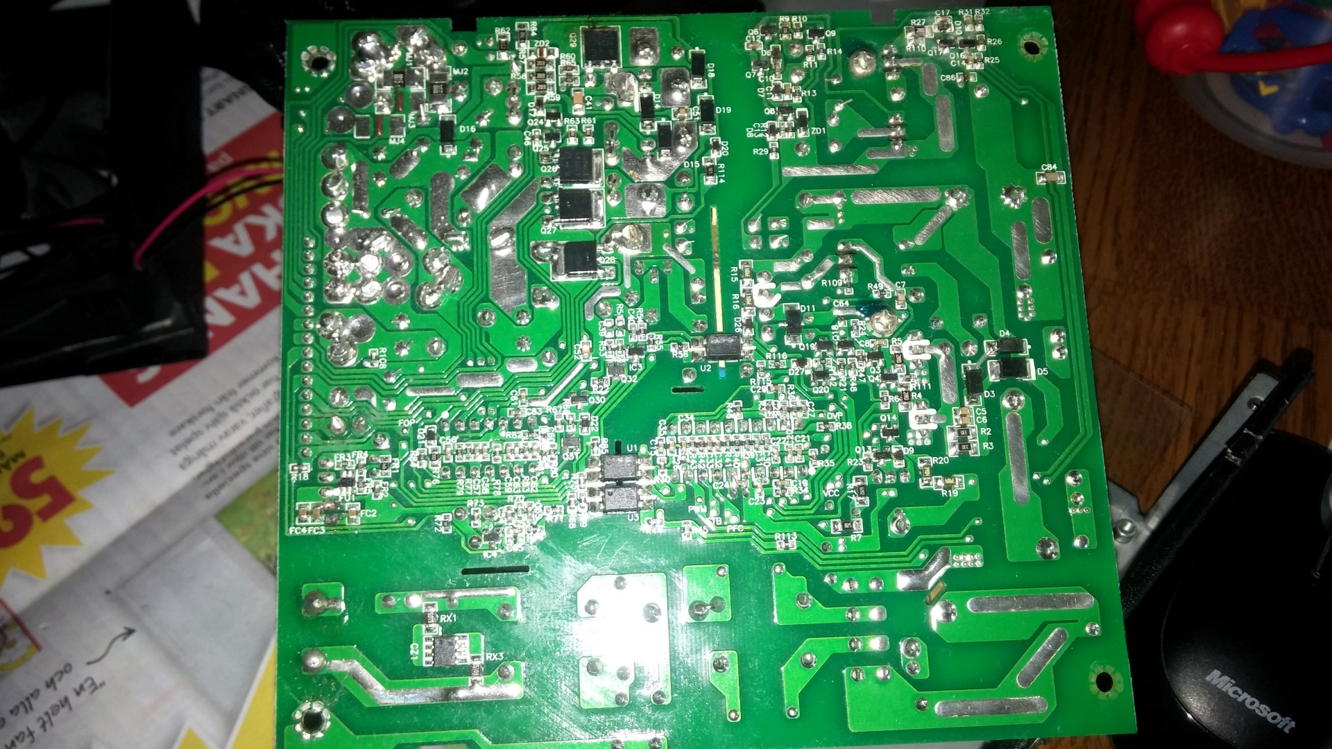

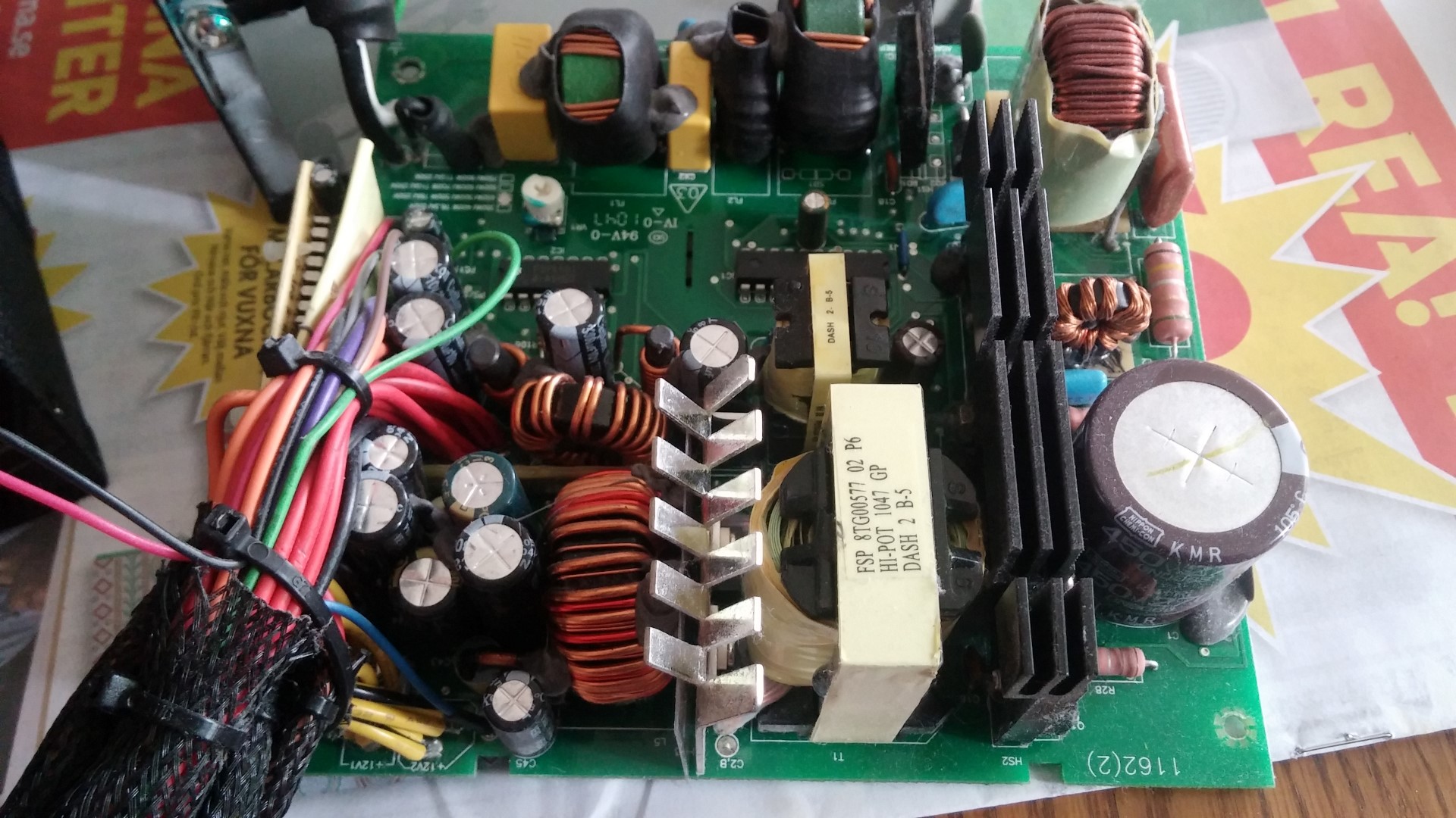

                                      This project semi stalled as I moved on to others. To "recap", all capacitors on the secondary side was replaced with nippon-chemicon/Rubycon including the small IC caps for the two FSP chips.
                                      Had a short test run and it worked really well with stable voltages and powered on every time. I shelved it as a good replacement for later use.
                                      Success? No.
                                      I tried it today for a secondary machine and i behaves like before. Twitching fan, when it powers on its usually not for long.
                                      Measured voltages:
                                      5vsb: 5.0V
                                      5v: 5.0v
                                      3.3v: 3.3v
                                      12v: 12.6v
                                      So this project is back on, any tips where to look next?
                                        see if you missed any.
                                        FSP is well known for hiding one or two caps in black heatshrink tubing.
