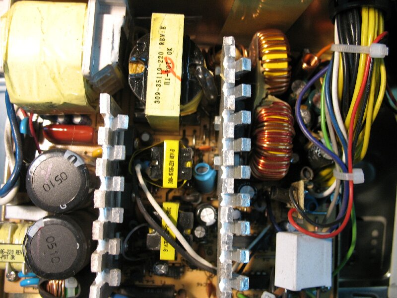

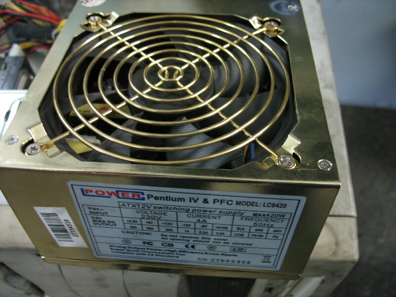

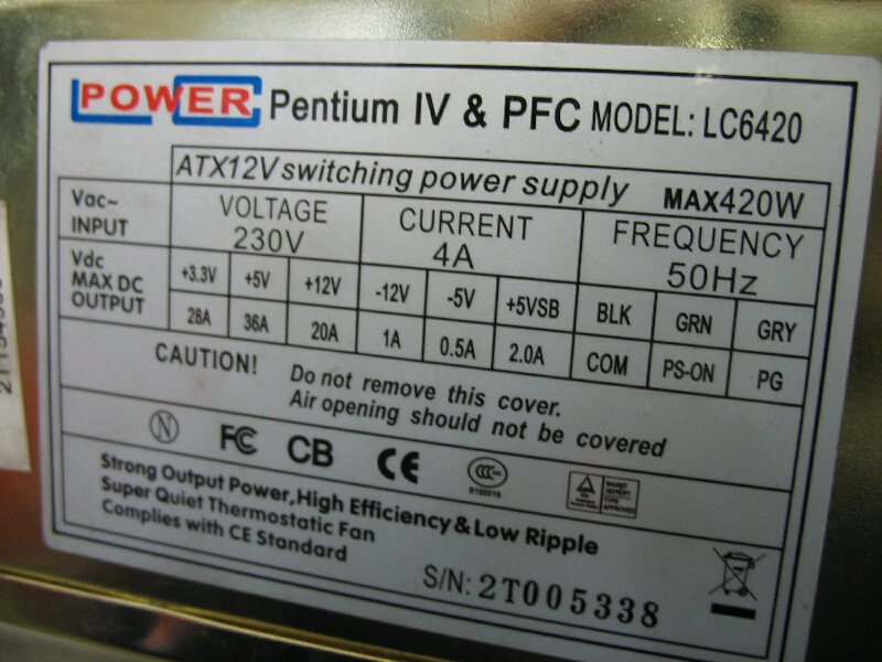

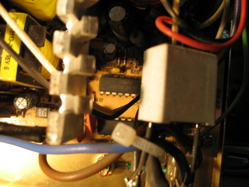

    LC Power LC6420
    really crappy. everything cramped up, bad caps, just silly looking thing.
    it costed as much as a decent fortron supply, can't really say why. probably beacuse it was bought here, where pc-shops are scarce so anybody can put as high price as he wants...
    beware, don't buy this.
  • linuxguru
    • Apr 2005
    • 1564
    Re: LC Power LC6420

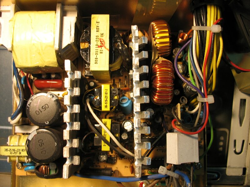

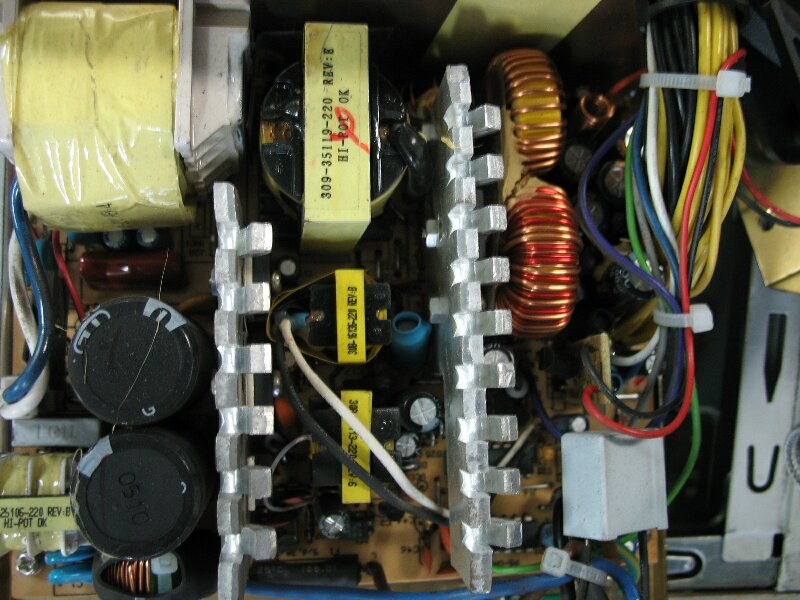

    It may be rated unrealistically, but it doesn't look too bad. I'd probably recap it, replace the fan and continue to use it.

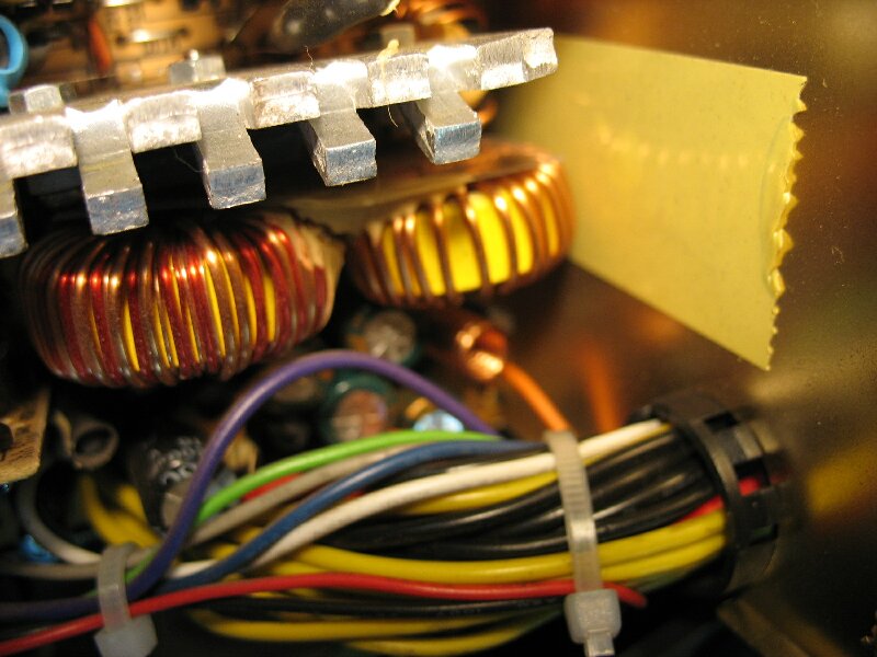

            Some dealers sell this psu in Italy for about 40 euro since a year: it's less crappy than Deers, but it's slightly overrated (a decent 300 W, but not a 400 one) and I don't know if there is an emi filter (it seems not, but I'm not sure).
            Can you tell me wires' thickness (AVG20 or 18)?

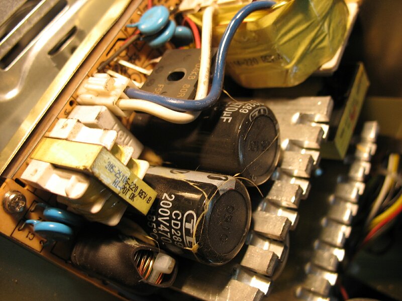

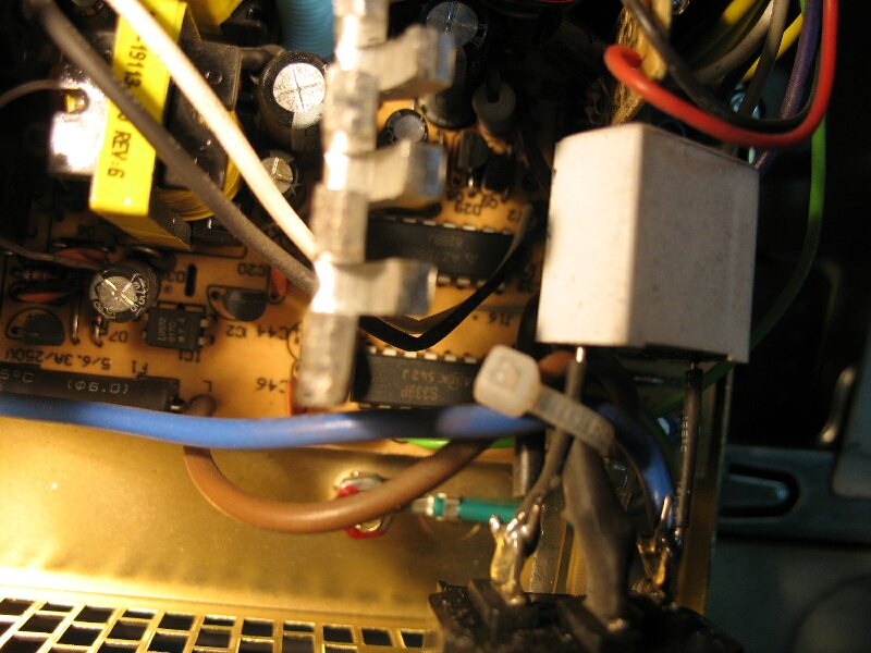

              I have used a few LC Power PSu`s too and i would say as long as they are cheap, they aren`t the badest you can get.
              Sure, the capacitors are not the best (but similar in OEm Seasonic & FSP), they are probably a little overrated and tend to fail more often then e.g. FSP ones and they are not that pretty designed.
              But at least i haven`t heard, that one of the LCPower PSU`s would have caused damage to other components.
              In most cases, it does shut down in an event of error and this is for me the most important issue regarding PSu`s.
              I have all of them recapped, due to start up problems caused by bad caps at the 5v Sb & auxiliary supply.
              Apart from that, they are running fine at a nominal load of about 200w to 300w (for the 550w version i have bought ;-) ) and have survived a bunch of other POS.
              But sure, today i avoid them, simply as i can get some OEM Seasonic or FSP cheaper and the fact that very good psu`s with good capacitors are more and more available as low as 50€ (Corsair, VX, HX, Seasonic S12 etc.).

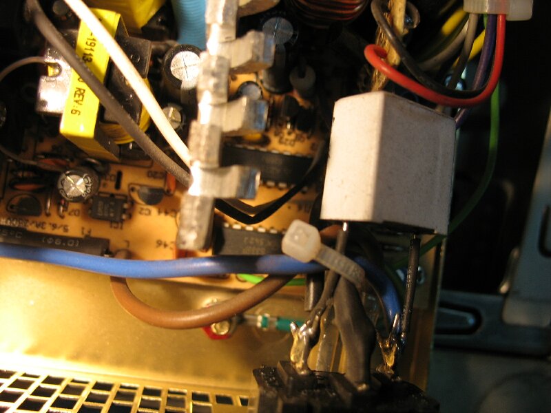

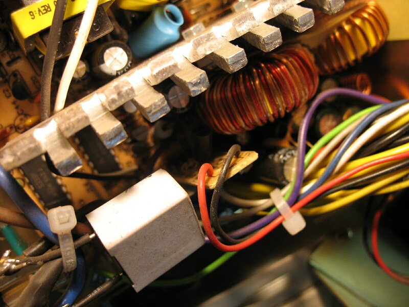

              • linuxguru
                • Apr 2005
                • 1564
                Re: LC Power LC6420

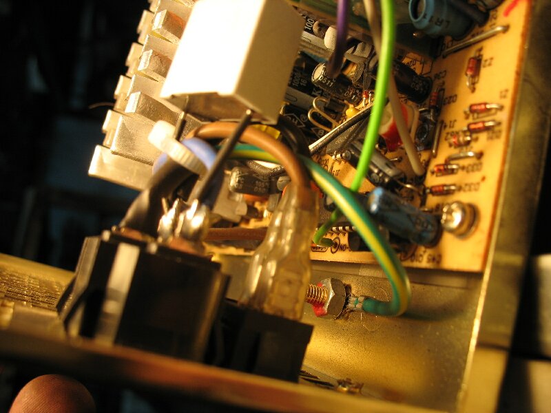

                It appears to have both an EMI/RFI filter as well as a PPFC choke. It's not too bad a design to recap and retain.

                  Re: LC Power LC6420
                  This is a Shenzhen/Huntkey build. It is not a very good PSU indeed:
                  http://www.hardwaresecrets.com/article/527
                  But I have to say some of the secondary capaciotrs are TEAPOs so not bad at all...
                  LC Power have good PSUs though. The ones based on CWT desings for example.

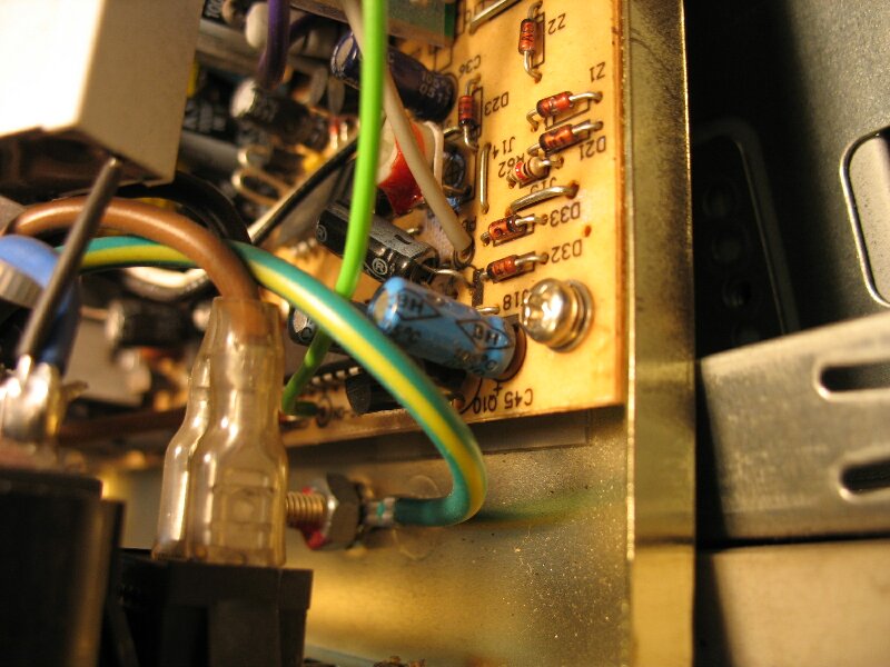

                  • hkivan
                    • Mar 2006
                    • 122
                    Re: LC Power LC6420
                    I brought 4 PSUs from mainland china B4:
                    a 300W Huntkey, a 250W Hopley ( now renamed as Great Wall) , a 350W Hedy
                    & a 350W segotep.
                    I Found Teapo caps in Huntkey & Segotep , Samxon caps in Hedy & unknown
                    cheap caps in Great Wall.
                    The 300W Huntkey also use AWG16 wire on 3.3V of the main 20-pin ATX connector.
                    Huntkey's quality is a bit above average in mainland china but
                    if a 500W version only gives out 200W to 300W is very bad.
                    EMI/RFI filter is a must for passing CCC certification in china
                    but manys PSUs are skipping a MOV.
                    • PCBONEZ
                      Grumpy Old Fart
                      • Aug 2005
                      • 10661
                      Re: LC Power LC6420
                      Hardware Secrets test on that unit was bogus.
                      It says right on the box:
                      12v1 + 12v2 max = 286w
                      12v1 + 12v2 + 3.3v + 5v max =431w
                      Total max = 450w
                      If you watch the meter in the video it was at approx
                      12v1 + 12v2 = 293w
                      12v1 + 12v2 + 3.3v + 5v = 435w
                      Total max = 453w
                      when it blew.
                      Not that I think it's a great PSU but calling it bad when you exceed 3 power limits at the same time is bogus.

                        Here he tested a Dynex 400w which is the 400w version of the same Huntkey unit.
                        http://www.hardwaresecrets.com/article/557/1
                        He got 437w out of it without ripple going out of spec.
                        He keeps saying that the internal parts are identical but if you read the reviews the caps (size and brands) are different, main rectifying bridges are different, and the +12v rectifiers are different.

                          • linuxguru
                            • Apr 2005
                            • 1564
                            Re: LC Power LC6420
                            If Huntkey honestly made its rated spec., it is good and worth recapping for longevity - period. Definitely worth considering in an era of overrated/overpriced junk PSUs with crap caps.
