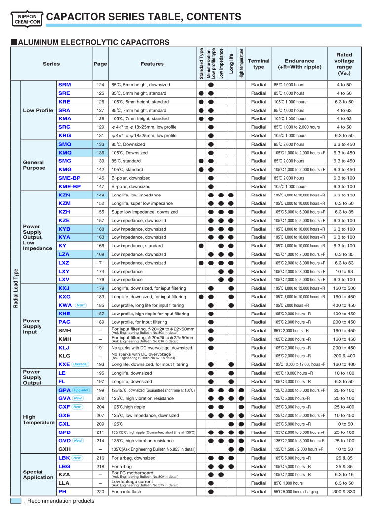

      Originally posted by momaka
      Chemicon KYB (preferably), KY, or KZE
      Chemicon KYA, LXV, LXY, and LXZ
      You still live in 2000's.
      LXV, LXY, LXZ, KZE are utterly obsolete. KY are just obsolete.
      KYA, KYB, KZN, KZM, KZH are the new and worthy series. Rubycon has some new and interesting series as well, but I won't market them till I got them on stock. In the meantime, you guys can stay in last decade for couple more months
        So?
        Sure they might be a bit bigger than the newer series, but if they fit and work, the rest doesn't matter. Online stores like Mouser and Digikey (and possibly a few other places as well) still have them too last time I checked.
        Don't give me that "newer is always better" Micro$haft attitude now.
          KZH isn't exactly new. It's been in production for well over a decade and its oldest datasheet is dated October 2003.
          If those series were really obsolete, I think UCC would discontinue them, even if they were slow to discontinue some other series. And there's no better bang for your buck than NCC KY. Not everything old is obsolete, and not everything new is relevant.
                  The KZH series has been upgraded though. I bet some of the old series will be discontinued soon. KZE has been also upgraded, but it makes no difference, it is still huge for the poor capacity and the lifetimes are very short! Compared to the capacity, there is no reason to buy them new.
                  Most of the new series provide not only much better capacity per volume (=smaller cans, or better capacity in the same size), but also longer lifetimes, lower ESR and higher currents. KY is the only exception which may still be worth, I said they are only obsolete, not utterly obsolete Besides, many of those old caps series are custom sizes, we have no idea what their parameters are (most likely better, I would even go as far as saying some of the new series have been made in the image of those custom sizes).
                  The LX* series have single advantage - as they have oil-based electrolyte, they can be used at some specific conditions. For our usage, it does not matter at all. Just recently I got new KZN 100/35 over old LXZ 100/35. The KZN is about 3 times better in all main parameters, smaller and I got them for half the price.
                  Manufacturer price difference is only about 5 % between all these series. The end price difference is given by you letting yourself get robbed from all those big-ass resellers. I have these modern series much cheaper than they got. Lets compare two comparable ones:
                  http://www.digikey.com/product-detai...1488-ND/756004
                  vs. my KZH 1200/6.3. KZH are 5 mm shorter, have the same lifetime, lower impedance and higher ripple current. My cost about 16 US cents, Digikey wants 41 US cents for KY. Did I hear somebody saying *bang for your buck*? Yeah, that bang, in your face maybe.
                  To be clear, I said nothing about those old caps being bad. But they are clearly worse while there are better alternatives for the same or lower price. Because it costs the same to make most of the caps no matter what they are, there is absolutelly no reason why the old should be cheaper than being on sell-out. I can see no better definition of obsolete than the ability to get better thing cheaper, when deciding what to buy. I said nothing about replacing them in already existing devices, just to get the better stuff when you are already on shopping spree!!

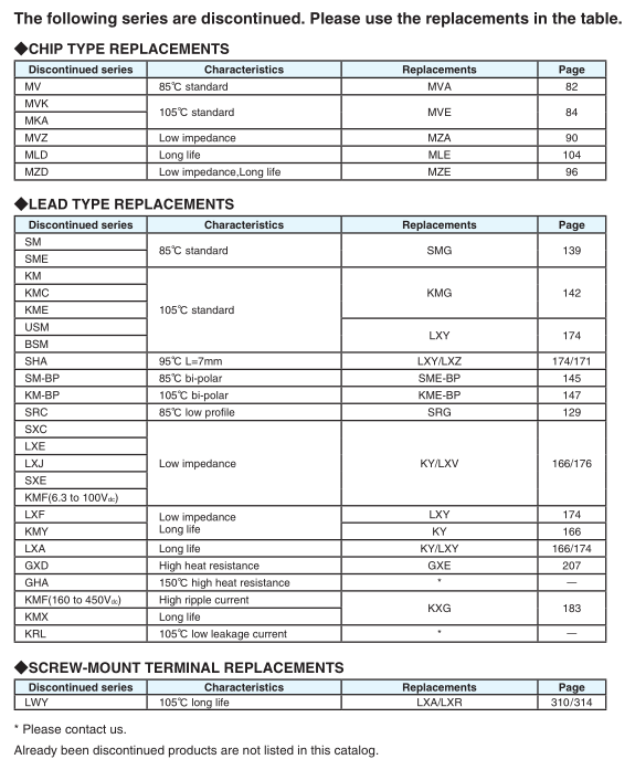

                    Why should they?
                    Especially if they are 'proven reliable designs'.
                    There are designs out there where you do not need low impedance capacitors, the specs KZE and KY deliver are just enough for them...
                    If NCC is able to manufacture them cheap enough, why should they be discontinued?
                    Especially since they are used in a variety of products that need 'Long term Support'!
                    Yes, they are products that come out now that will be sold for at least 5 years or even more, without any dramatic changes at all...
                    Like osciloscopes and other lab stuff for example.
                    Or DIN rail power supplys...
                    And the best things:
                    The enviroment isn't as hostile as it is with PC power supplys as you know exactly what that power supply has to supply and you can design the PSU accordingly...
                    So there isn't a need to discontinue them. Especially as NCC has no alternative to the KY series. Especially if size isn't an issue at all!
                          What the hell are you talking about, really? Have you actually seen the datasheet lately? Can you show me those 5000 hours?
                          Oh, you surely mean this!
                          "KZH up to 6,000 hours, KZE 5,000." That means up to, not only for 5,000. Of course case size directly affects lifetime. The datasheets make that very clear. Also, those endurance ratings are only made with 60% confidence. Yes, I know you're of the opinion that KY is only "just obsolete" because of the high endurance rating. KY is indeed an upgraded series. When KY first went into production (early 2001), it was only rated up to 6,000 hours (datasheet attached), and was later upgraded to 10,000 (in April 2002 in accordance to an old record of NCC's site on the web archive).
                          Yeah, D12.5+, those which are used by the rate of 1-2 % in most ATX power supplies, very relevant indeed! And for your information, I am just looking into Corsair HX750i and I see four D12.5 caps there…KZH (instead they put 10mm KZE on the SB rail, a stupid choice)
                          Not sure how that's stupid exactly. KZE is only a hair below KZH in terms of ripple current handling ability and a hair above it in terms of ESR. And they both have the same 500 hour @ 105*C shelf life spec. In fact, the Chemi-con series you sell (KZx, KYx) all share that spec. KZE is not a prematurely failing series, not in any sense of the word. What you reference in the datasheets is only numbers and there's no evidence to support the notion that KZH would last that much longer than KZE in the real world. And as I said before.... KZH did significantly worse than KZE in Petes in CA's torture tests. So that does not make KZE a stupid choice at all. By that thinking, using KZH instead of KZM is stupid because KZM is rated for 3,000-4,000 hours more.
                          Otherwise there is nothing good about using them so from me, they are not getting the best recommendation. Yeah, KZE with 4k hours is still better than most of the chinese crap on market, but still, there are bloody 8-10k caps on the market for years now.
                          The endurance ratings are good information, but they don't decide everything. The defective 2,000 hour @ 105*C KZGs are often outlasted by 2,000 hour @ 85*C SMGs even in storage.... because the stability of the electrolytic composition matters more.
                          Indeed, but your definition of obsolete is strange, not mine. When it is clearly sure something is worse in most of the aspects, than it is clearly obsolete for me. Your definition is like "when single person in the whole universe is still using it, than it is not obsolete". Duh
                          I said when enough people are using them in their repairs. That means more than a single person.
