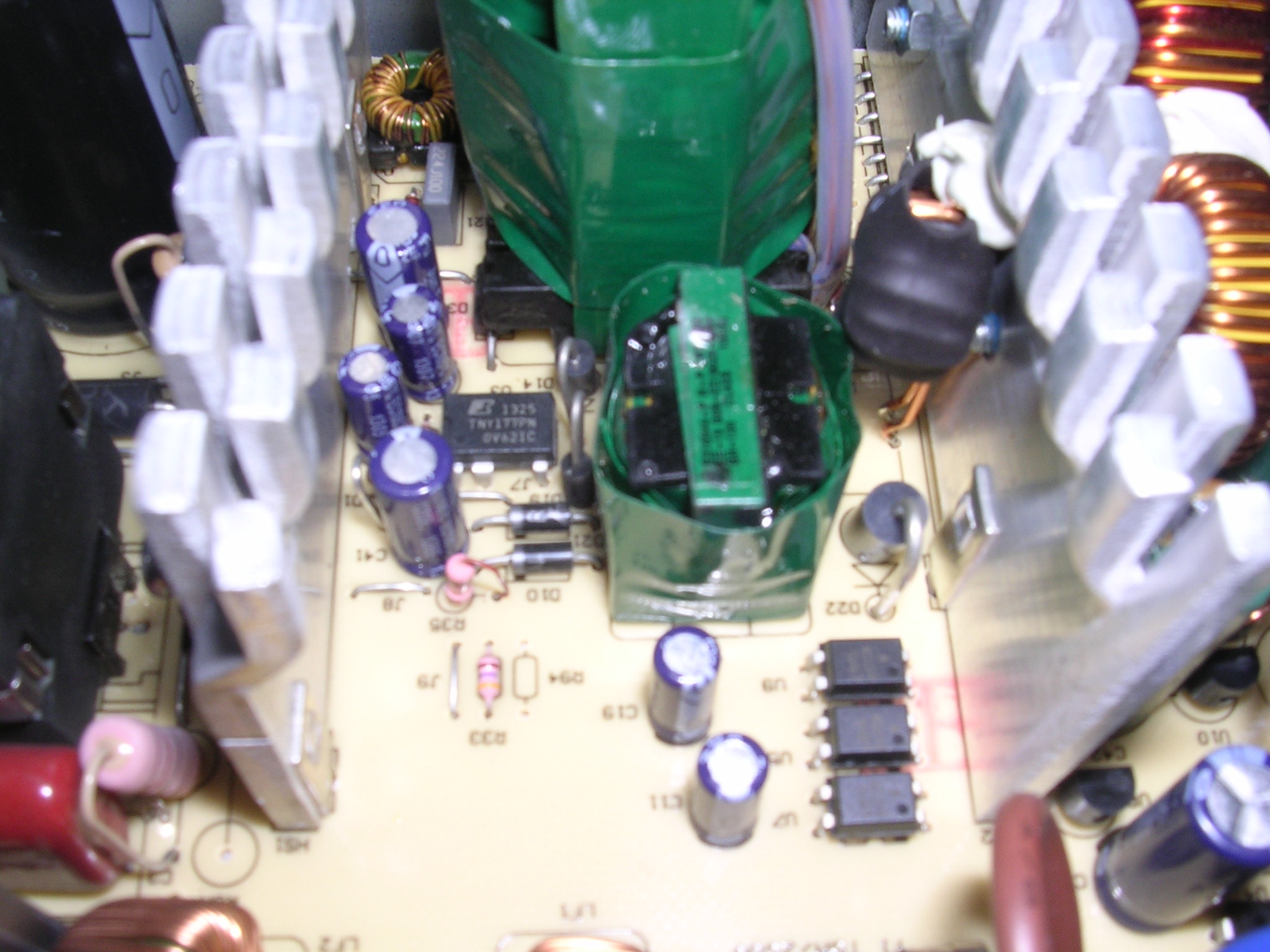

    for a year I have got a still working Corsair VS450 PSU. While searching in this section I have found some traces of this topic in several threads but no specific one. Encouraged by your comments and my curiosity I opened it (so forgetting about its warranty) and discovered that it has been capped by poor quality only capacitors, which of course I would recap.
    While I am not 100% confident of the respective rails (sorry I am still an amateur novice), here is the whle list of the capping:
    Filter: 1x Aishi 180uF, 400V
    Primary: 2x JunFu 2x 220uF, 25V + 2x JunFu 2x 4.7uF, 50V
    Secondary:
    5VSB Rail: 1x Capxon 2200uF, 10V + 1x Aishi 1000uF, 16V
    3.3V Rail: 1x Capxon 2200uF, 10V + 1x Capxon 2200uF, 6.3V
    5V Rail: 2x Aishi 1000uF, 16V
    12V Rail: 2x Capxon 2200uF, 16V
    -12V Rail: 1x Capxon 2200uF, 16V
    Others (PWM, fan etc): 2x JunFu 2x 2.2uF, 50V + 1x Aishi 1000uF, 16 + 2x Capxon 100uF, 16V
    My purpose is to replace every cap with the IDENTICAL ones but of good quality (and low ESR in the secondary zone), any suggestion?
    Moreover, some questions arise:
    1. is the capacitance of the filter big cap high enough (180uF), or should I consider (if it is possible) to increase it?
    2. how is it possible to put together caps of different voltages besides different capacitances as I saw in some rails of this PSU?

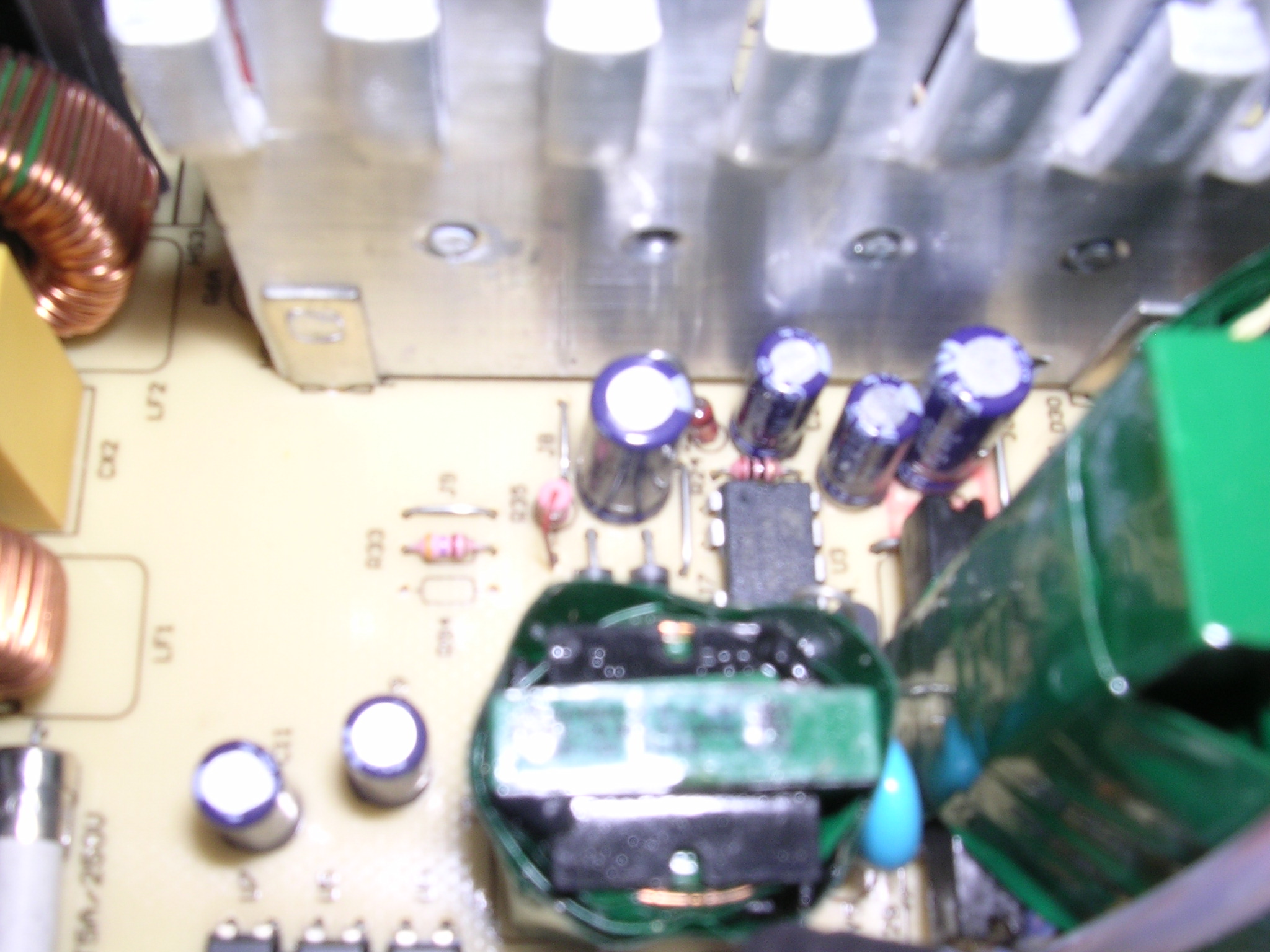

      Re: Recapping of Corsair VS450
      Sorry I forgot attaching the pics of the PSU.
      Originally posted by Stefan Payne
      It's important to get the ESR value right...
      The trouble is that most of the specifications omits just the ESR.
      Anyway the CapXon series is GF except for the 12 rail, which is KF.
      Yes, I am aware that good caps are rather expensive, but Momaka encouraged me to repair this PSU.

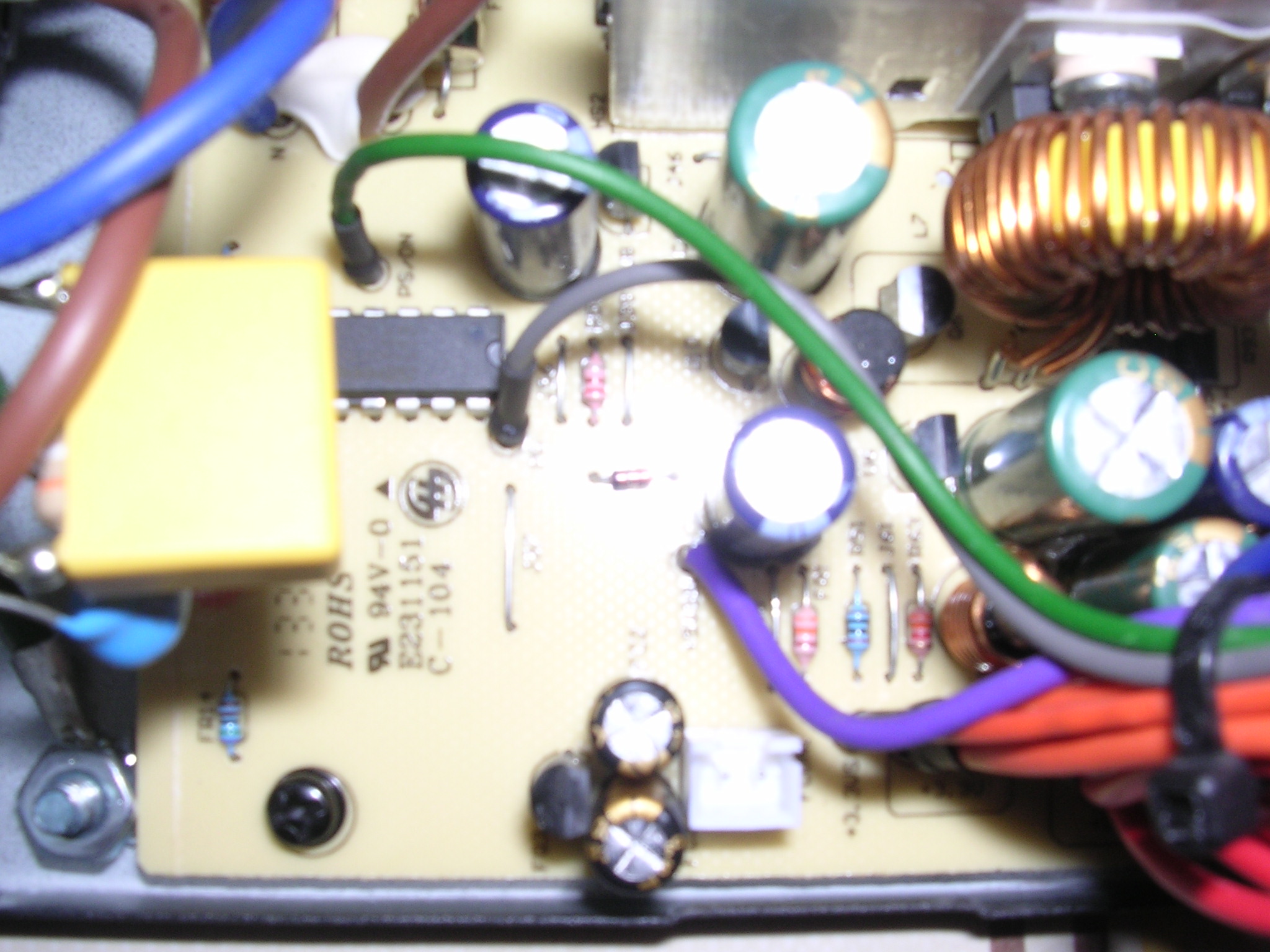

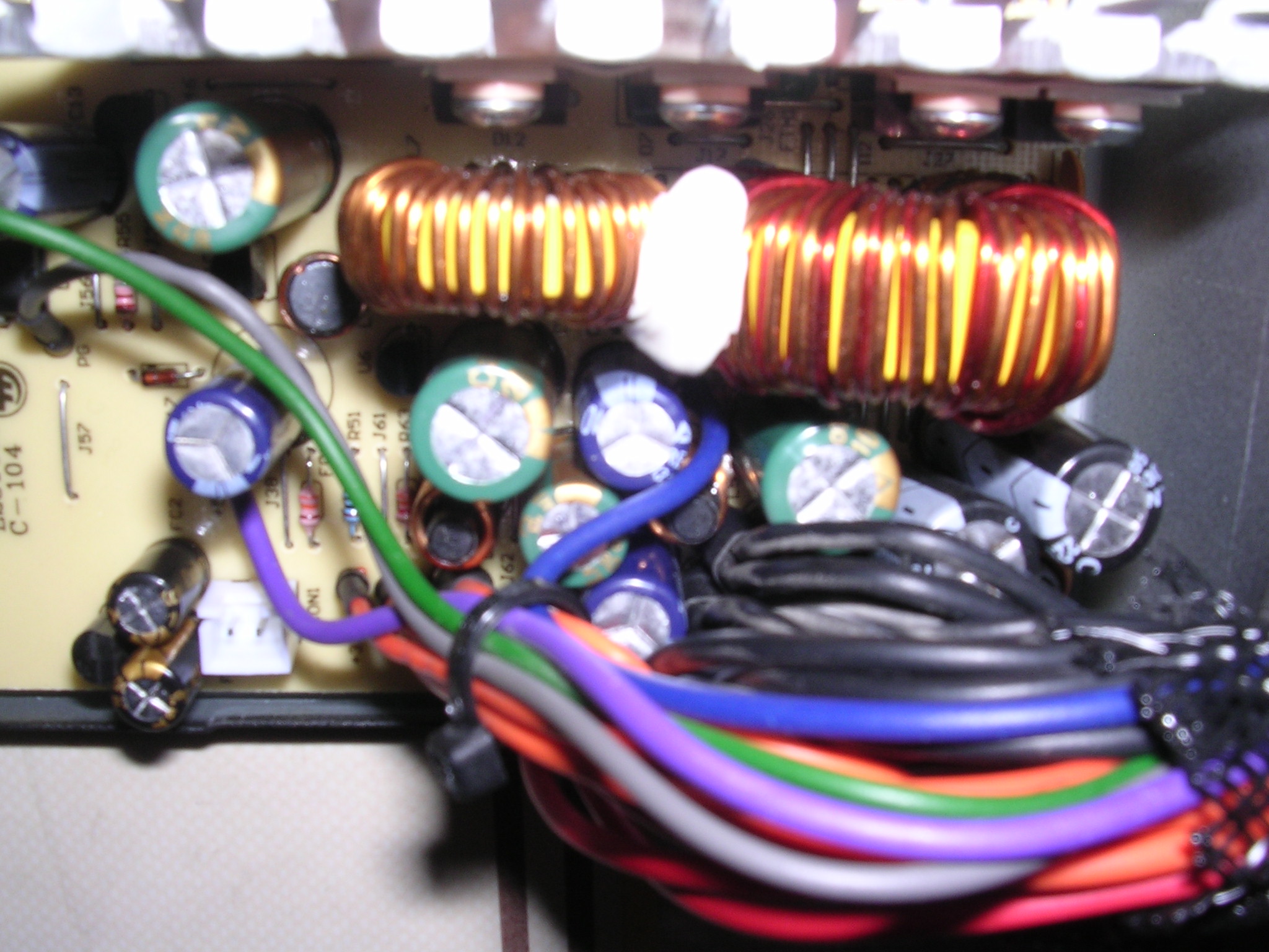

          • omega
            • Mar 2014
            • 47
            • Italia
            Originally posted by goodpsusearch
            Are you sure the -12V has 1x Capxon 2200uF, 16V??? Isn't it 220uF?
            Difficult to read the value of this cap, even with a knife blade as a mirror. I will be confident once I desolder.
                              Originally posted by omega
                              While I am not 100% confident of the respective rails...
                              If you want us to confirm, it is best to put pictures both of the top side and solder side of the PSU. For the top side, do not zoom in too much. A picture like the one TELVM uploaded in post #11 is good.
                              Indeed it can be sometimes.
                              The easiest thing to do is to number each cap and make a "cap-map" as you remove them one-by-one. You can do that digitally (on the computer with Paint, Photoshop, etc.) or by hand on paper. Or, as you remove each cap, note down its specs (voltage, capacitance, brand, etc.) and then see which designator number on the board (i.e. C15, C20, Cxx, etc.) it corresponded to, then write down the info on paper.
                              That way, you won't get lost when all of the caps are removed.
