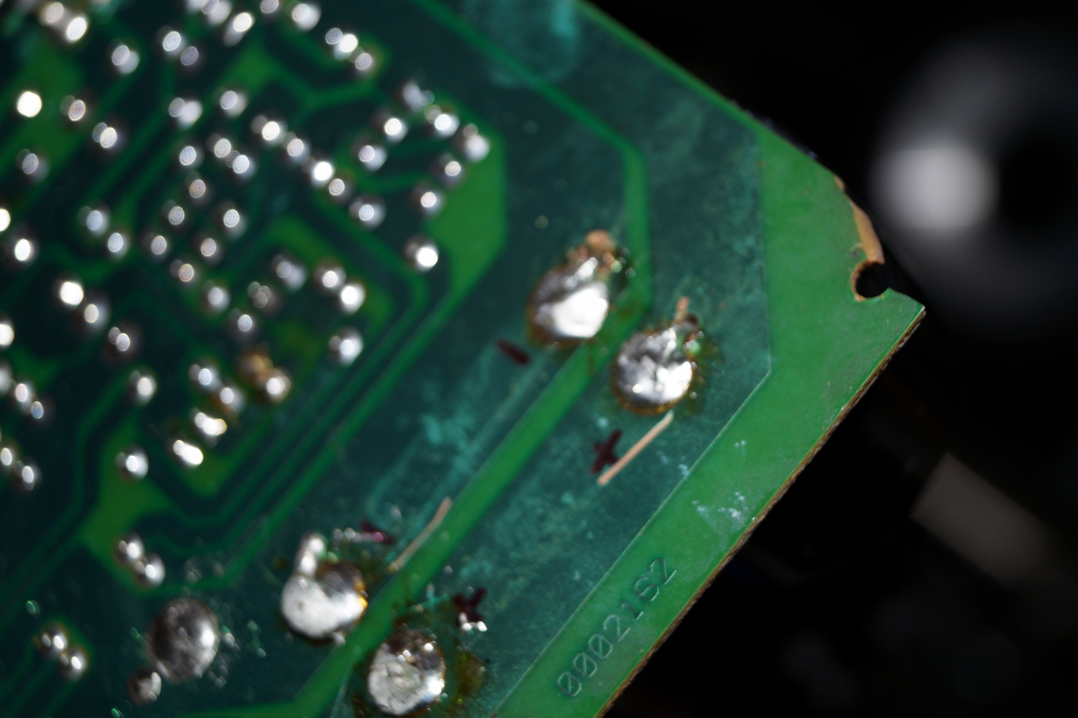

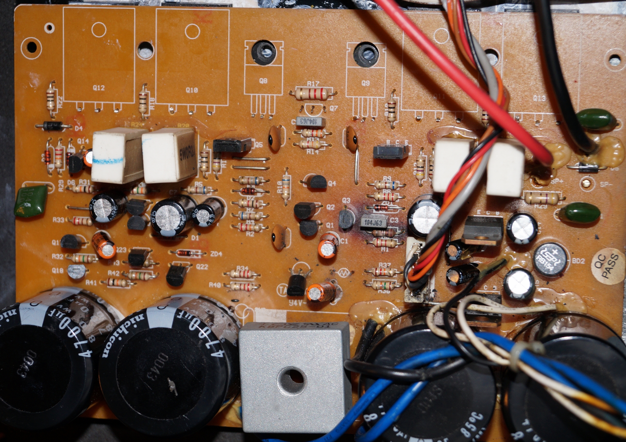

    Got this Monitor Audio FB212 subwoofer, which unfortunately the previous owner has absolutely butchered the power board. Never seen such negligence
    Problem started out as a hum and original owner proceeded to change main caps with some ebay jobbies which blew spewing guts out all over board. That and hes changed the bridge rectifier as the one fitted is not the original. After the replacement main caps blew he took them out and put back in the old ones.
    So as it stands only the bridge rectifier isn't original (he says its the same specs but don't really trust anyone who has done this to the board)

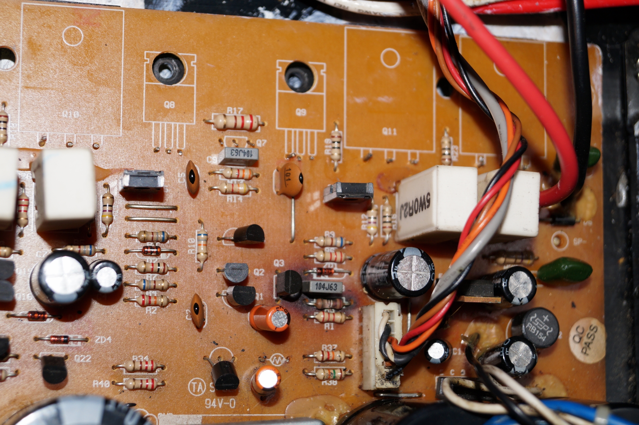

    Visually as far as i can see there is a blown resister, which I've identified as a 100k Resistor from schematic. (Position R3)
    So what I'm trying to figure out is what the original bridge rectifier was from the schematic but following / reading them is a bit beyond me at present.

        just noticed in the schematic the main caps are supposed to be 10000uf 80v, and the ones fitted (which owner said were the originals) are 4700uf 80v!!
        and the bridge rectifier fitted is a KBPC2501, which is 25a 100a, so wrong part again?

              For R3 100K resistor to burn up like that I would check ZD1, D1, Q23.

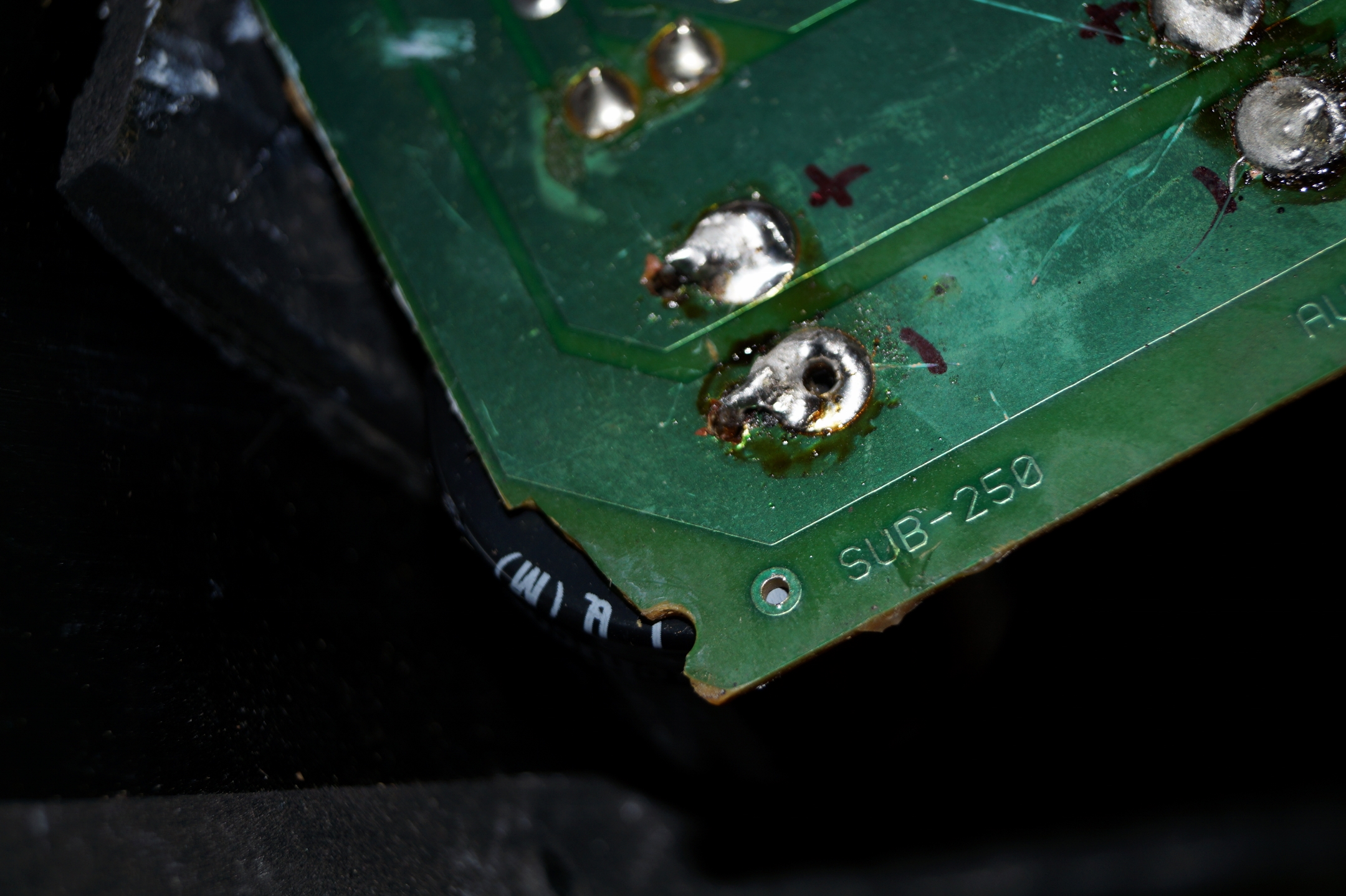

                From the marking on the board thankfully its gives values.
                2 x 55ac
                2 x 12vc
                2 x GND
                2 X 12vc going to 2nd bridge rectifier RB154 (BD2 on schematic)
                2 X 55ac going into the main bridge rectifier GBPC2504W (BD1 on Schematic)
                2 X GND going into ground
                Any advice on a replacement?
