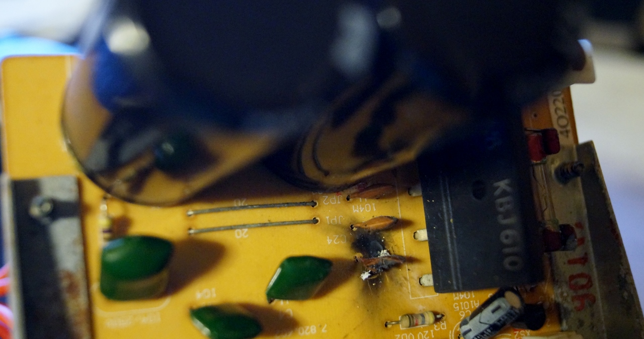

    What is this that has blown?
    Somethings blown in PSU for a powered sub, not sure what it is. 3 of them in a row.
    Both internal fuses blown too

    Re: What is this that has blown?
    They are ceramic capacitors the ballast across the bridge rectifier. Checked bridge rectifier for S/C ? More than likely its shorted.
      Says 104 with a line underneath
          104 = 100000pF = 0.1uF
            Bridge rectifier is KBJ610 which I will test tomorrow
            http://www.ebay.com/itm/KBJ610-6A100...0AAOxypthRv~-m
            The text is placed in a different location to mine, but will that work? (if it indeed is shorted)

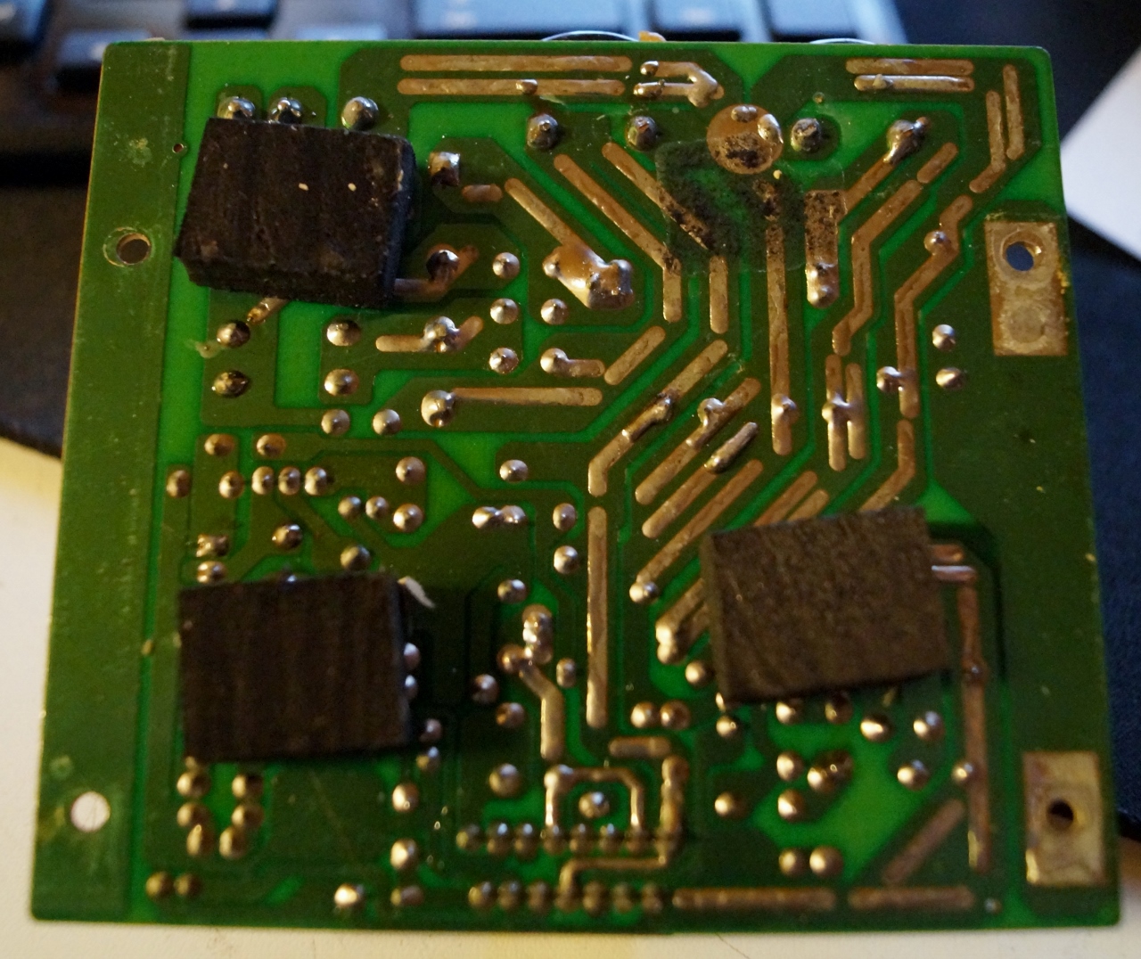

              s/c = short-circuit
              o/c = open-circuit
              104 = 0.1 uF
              Can you post more pictures of the board (both top and bottom side). Perhaps it would be good to know what these caps are used for, which might explain why they blew.
                oh boy, those caps look too small to handle high voltages...especially if they are hooked across the diodes in the bridge. I wonder if they blew just because the voltages were too high for them?

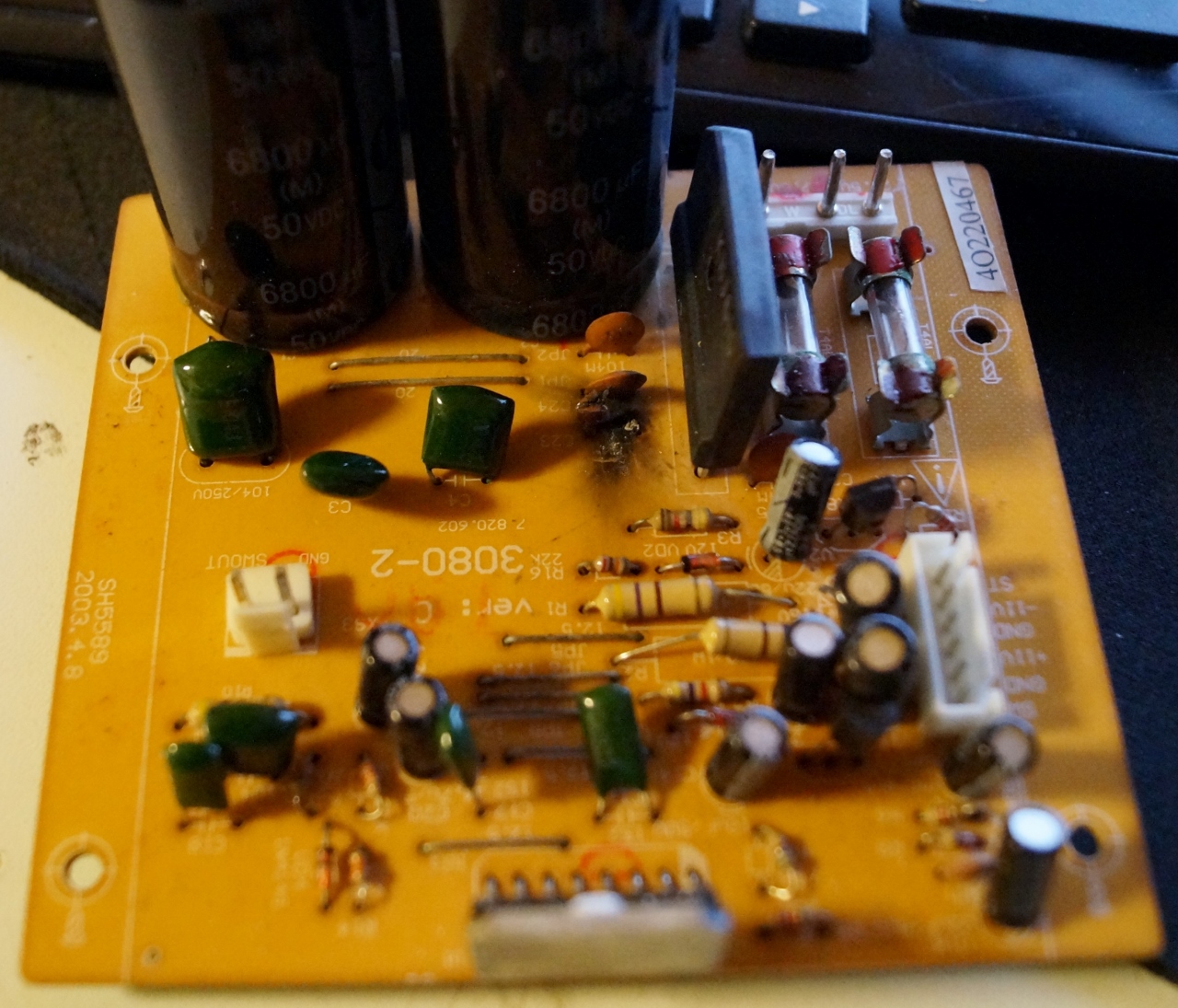

                          Looks like you are 100% right, based on the pictures that mikay786 just posted.
                          I would just remove those caps, test the bridge rectifier, and if good, test the amp like that.
                                    @mikay786, could you tell us the part number of the main IC on your board? I'd just like to satisfy my curiosity.
                                    • mikay786
                                      • Aug 2014
                                      • 765
                                      Bridge rectifier seems to be ok like the one in the video
                                      measures in at 0.466 & 0.456
                                      Theres not much else on the board apart from caps, resisters and the TDA7294
                                      What else should I check?
                                        Next could be the main transistors. Tbh you could probably run it with out them caps present.
