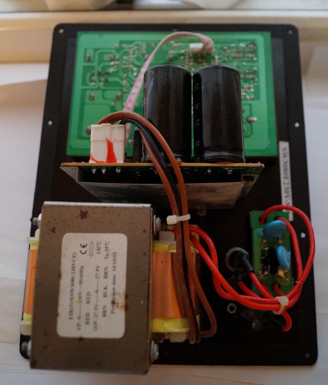

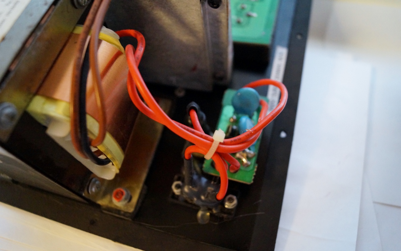

What is this that has blown?

    Tested both transistors and they seem to check out ok c1815 & a1015

      Is it safe to just put in new fuses and test without the 0.1 uF caps (as have removed them (3 in a row))

        Re: What is this that has blown?
        Yeah you can remove them, and run with out them I have in the past. Let us know what happens.
          Had to go to maplins to get some fuses and they had a couple of them .1uf caps so bought too (Why is it they only have a couple of what ever you need ever)
          So soldered everything back in, fuse holder legs on either side had corroded off so not holding fuses tightly so soldered the fuses in as best as I could on one end.

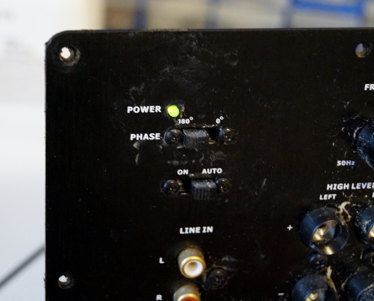

          Powered up and seems to power up fine, green led. Switch off and switches off. Not got the speaker connected so will reassemble and get speaker hucked up.
          I don't have a amp with a line out (well a working one anyway) can I just connect a normal music source via rca to it just for testing?
            Nice one, also what Voltage were the caps you got ?
              Unless the unit has protection relay, I would check the DC Voltage at the speaker terminal first to make sure it does not have high offset Voltage just in case there is problem in the power amplifier sections that will damage the speakers.
                0.1uf
                • mikay786
                  • Aug 2014
                  • 765

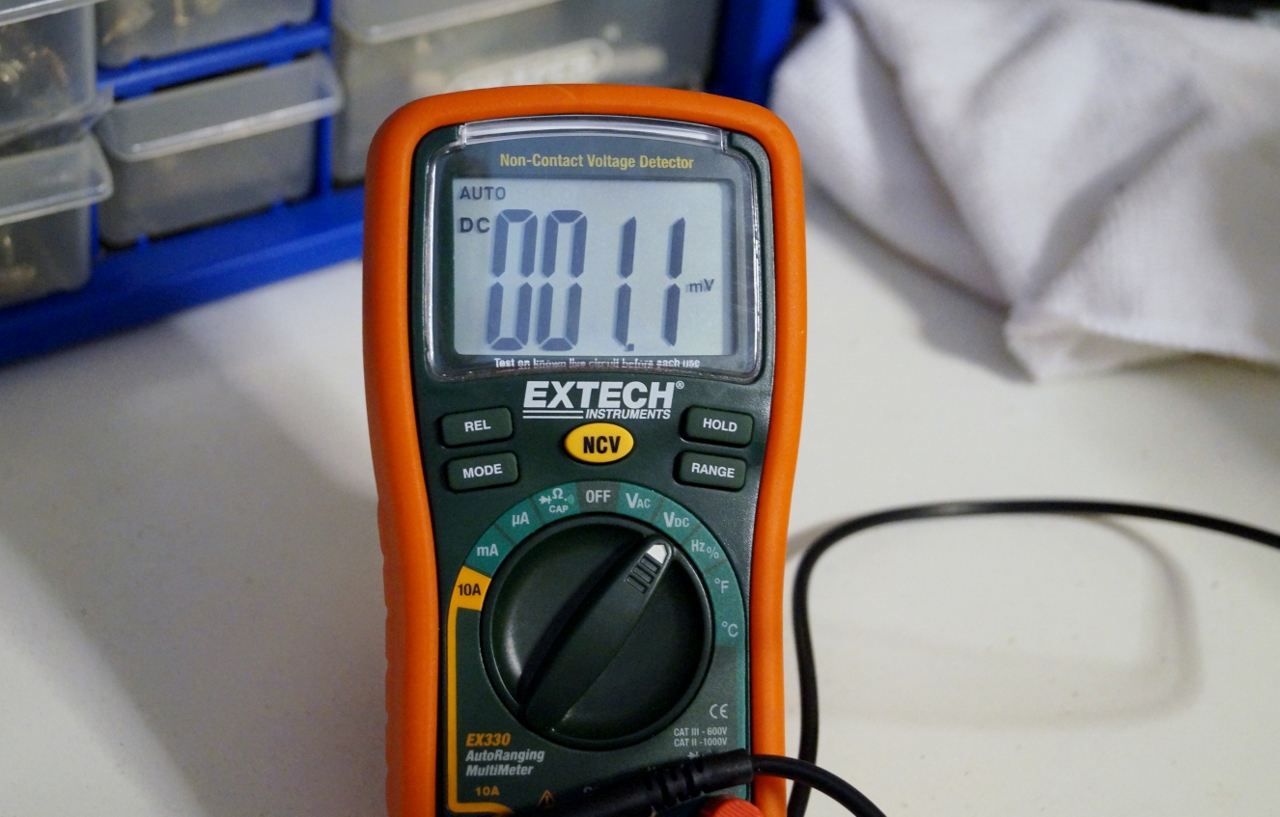

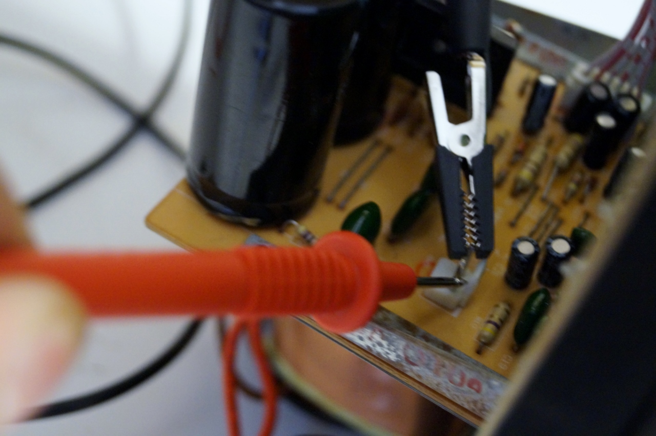

                  so just measure the voltage of the wire that connects to the speaker?
                  If so can I just measure it on the board connector pin out for speaker?

                    #29
                    Originally posted by mikay786
                    0.1uf
                    No I meant voltage not capacitance ? Uf is capacitance btw.
                      #30
                      'so just measure the voltage of the wire that connects to the speaker?, If so can I just measure it on the board connector pin out for speaker?' Yes.
                      Can we see the pictures of the whole unit and the boards?
                      • SteveNielsen
                        Retired Tech
                        • Jun 2012
                        • 2327
                        #31
                        It's better to check at the output on the amp itself in case the speaker wire is damaged.
                          should get 1kv or 2kv caps
                          and some fuse clips / holders.

                            #33
                            Barely measuring anything at the pins, like 0.001v
                            Is that good or bad?

                              #34
                              50v according to the receipt
                              Crap totally forgot about that, not sure what the original ones were

                                #35
                                You know, I was pretexted by the initial photos that this was a switching supply. Now I am thinking this is probably a low voltage (or at least relatively low) supply made from a transformer, and 50V capacitors may be fine...
                                As I thought most audio equipment runs around 40V or so, a 50V capacitor may be on the borderline, but only half of the voltage should be across the bridge diodes...
                                  #36
                                  It looks like just a small power amp using TDA IC and just plain linear power supply.

                                    #37
                                    borderline my ass, your suppressing spikes - that's why the original smoked.

                                      #38

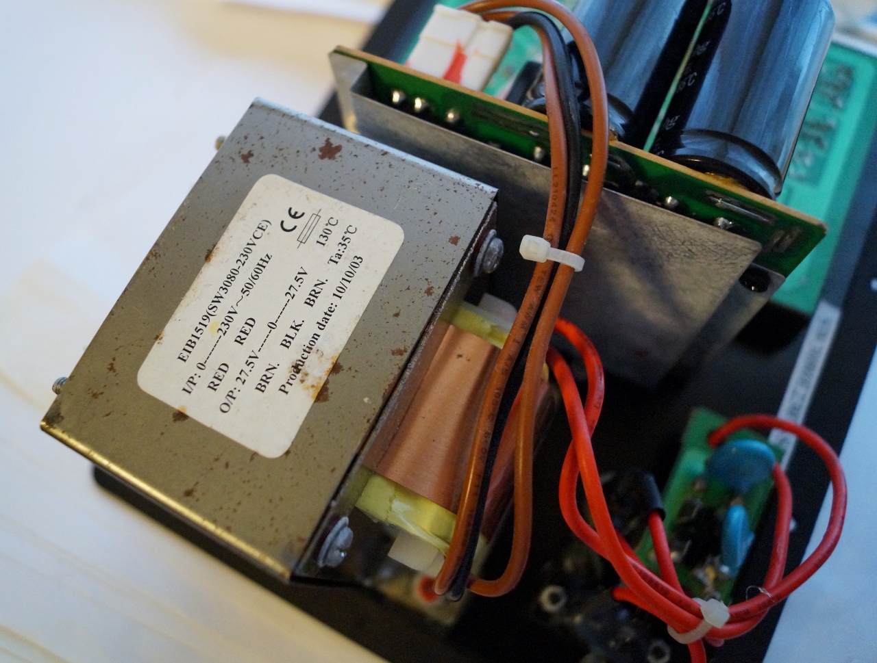

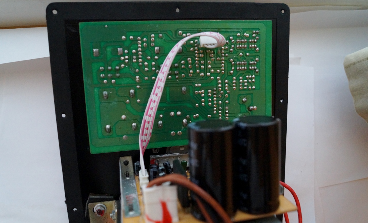

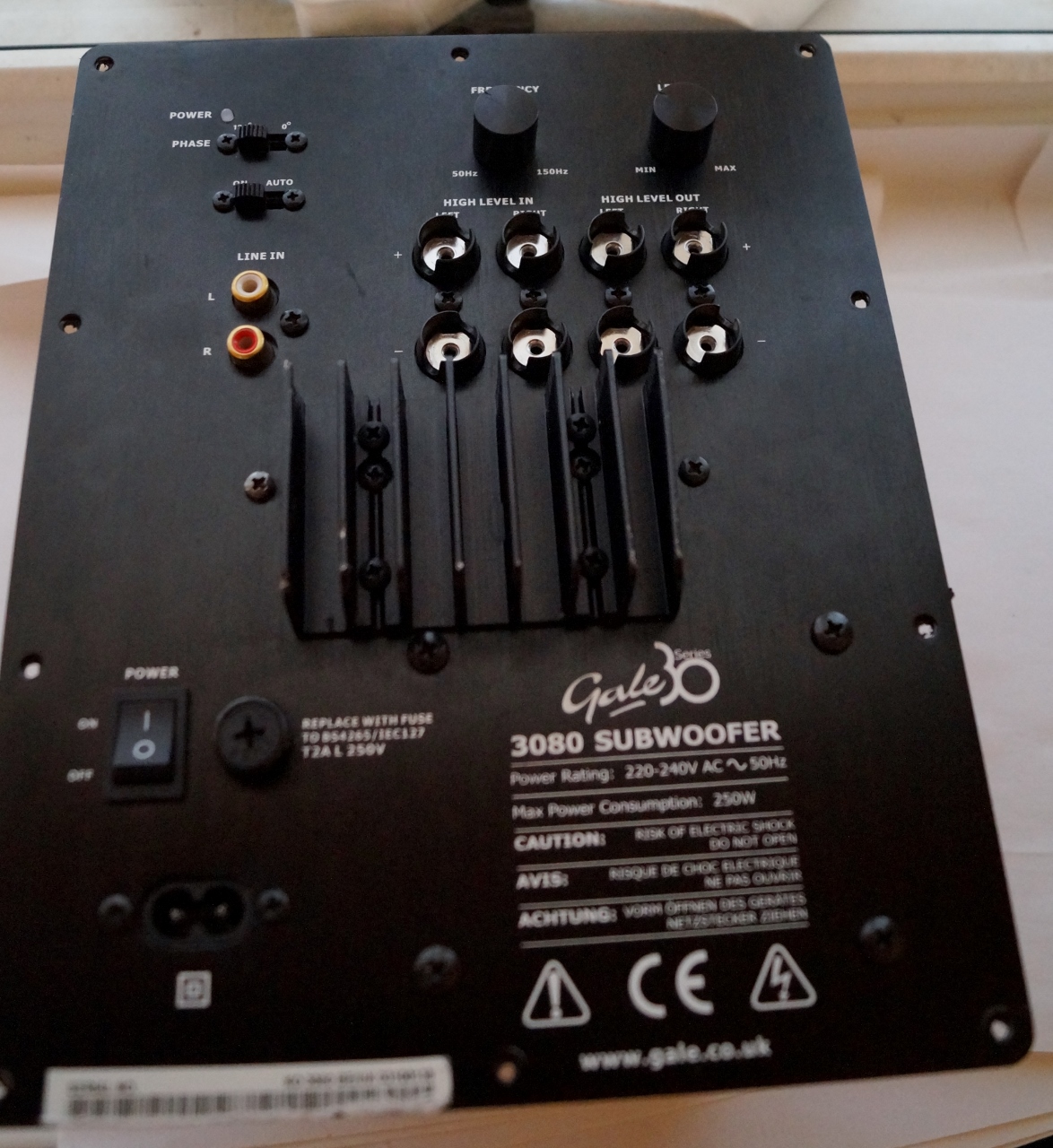

                                      heres the full section
                                        #39
                                        They are snubber caps (4) connected in parallel with each diode of the bridge rectifier.

                                          #40
                                          the caps are probably seeing about 35v
                                          not including spikes.
