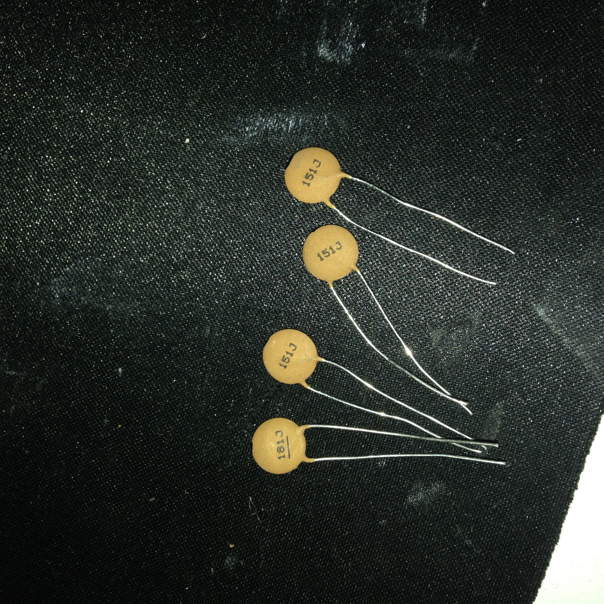

                        #51
                        Re: What is this that has blown?
                        Went to maplins again and they only had 3x 150v and 1x 180v capacitors.
                        Will these be ok?
                        And just googling the numbers on them I'm not sure they are the correct ones
                        151j + 181j
                        He was saying all there parts draws are a mess as workers keep putting stuff back in the wrong place.
                        Also picked up some new fuse holders as per stj's recommendation
                        • fzabkar
                          • Mar 2009
                          • 772
                          #52
                          Those are not voltage ratings.
                          151J = 150pF
                          181J = 180pF
                          Neither capacitor is suitable.

                            #53
                            wtf maplins are bloody useless, I told him 0.1uf
