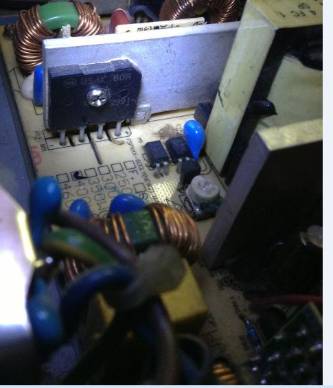

    Got a corsair HX850w PSu that has a blown internal ceramic fuse
    Tested it by just doing a continuity test out of board and its dead.
    E.T12AH250V Pigtail (soldered to board) Anyone know where I can source in UK?
    Also given it has blown is just a case of replacing it or perhaps a sign of other issues?

    Re: Corsair HX850w blown internal fuse?
    you need to fix what killed it first.
    start by checking the rectifier & fets.

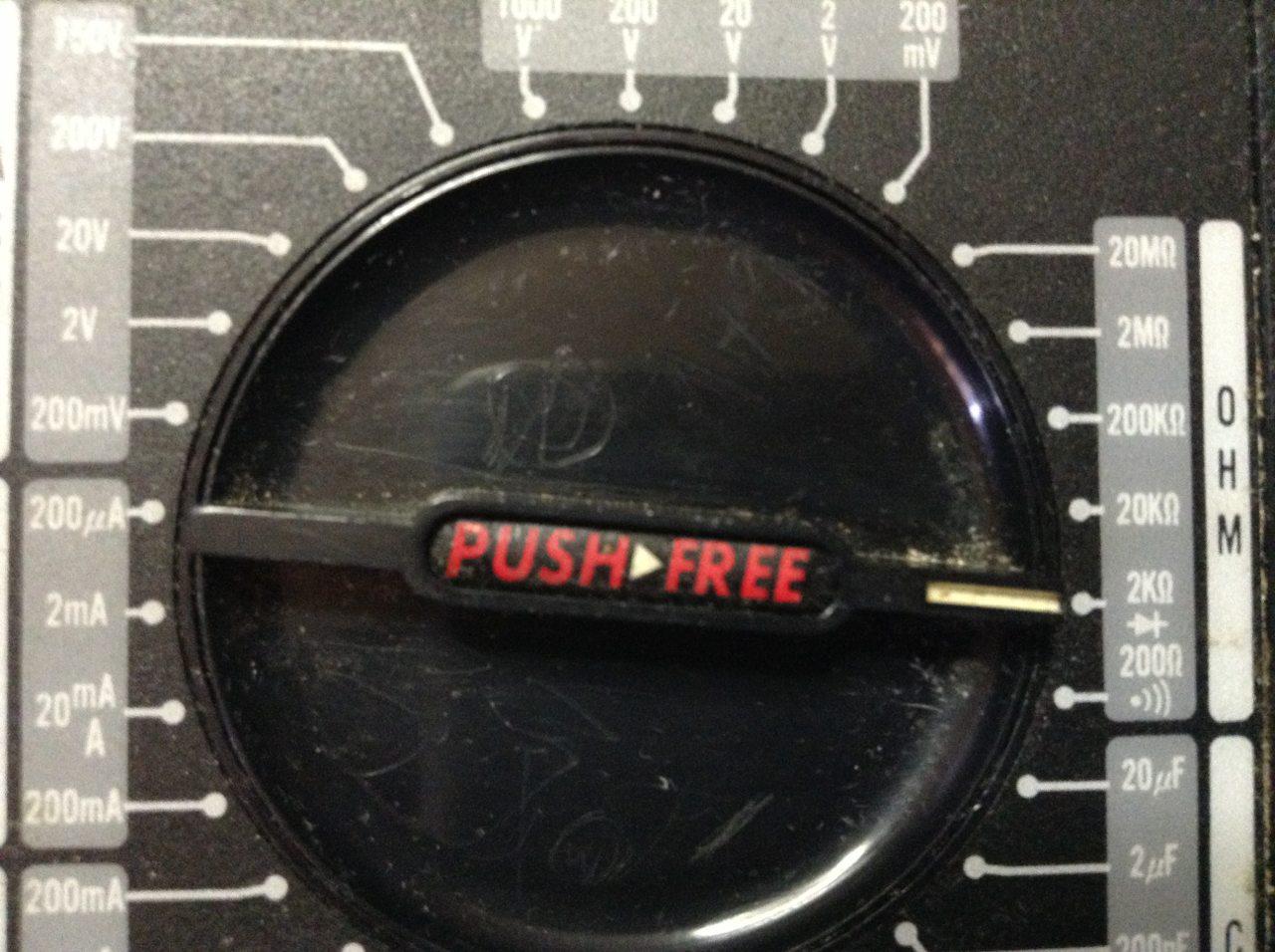

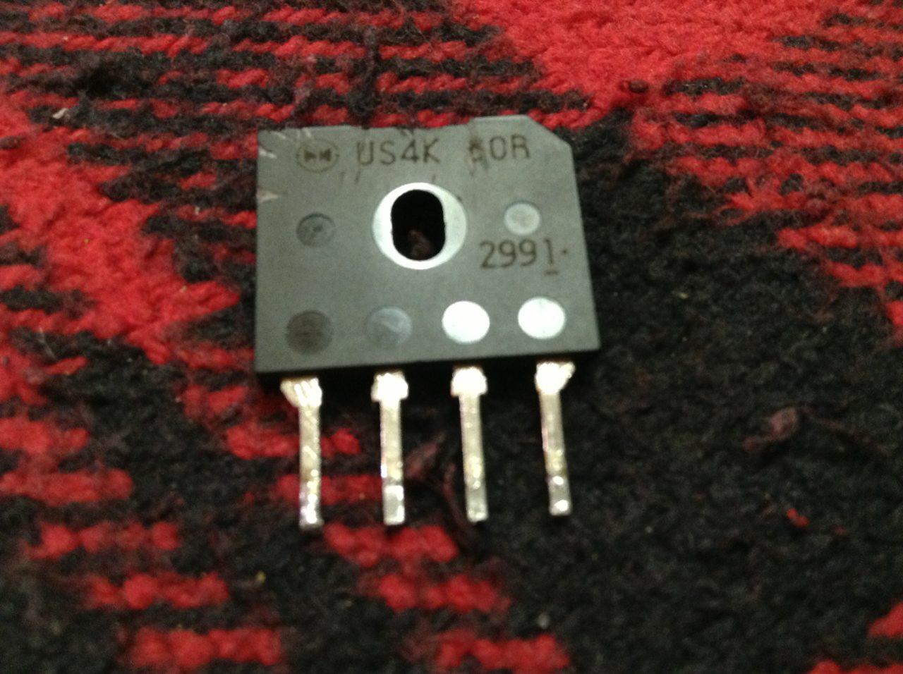

          Originally posted by ep9es
          Well, I'm stupid
          I was using in the multimeter the continuity scale(200R) but not the diode scale (2KR).
          I desoldered the rectifier.
          If the pins are like this - ac1 ac2 + , and the multimeter cables are Red(R) and Black(B), the measures are:
          -(R) ac1(B) 0.55
          -(R) ac2(B) 0.55
          -(R) +(B) 1.241
          +(B) ac2(R) 0.544
          +(B) ac1(R) 0.544
          +(R) -(B) infinite
          ac1(R) ac2(B) infinite
          ac1(B) ac2(R) infinite
          Other combinations, also infinite.
          Then, Is it ok??
          I will wait your answer to solder it again into the board.
          You can try to check bridge rectifier soldered to the board.
          If wrong measures, then check it unsoldered.
