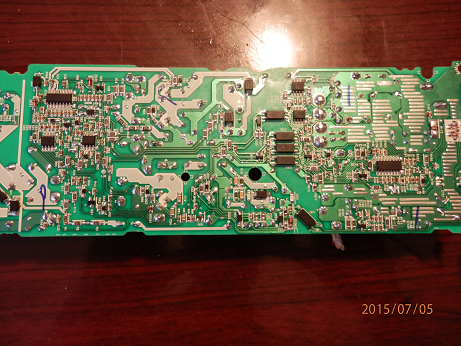

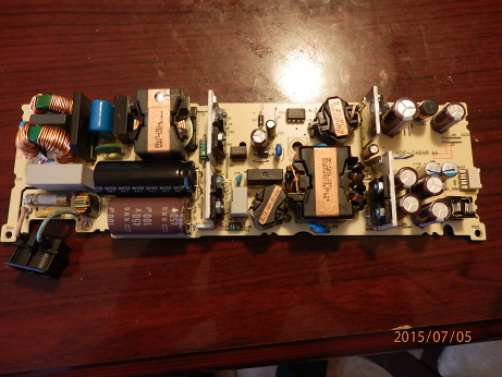

    Ok, as the title suggests this the SMPS found from a PS4
    Here's a little run down
    I have 2 PS4s
    One system boots up, the other attempts to turn on and the quickly shuts down, SMPS ISSUE
    The good power supply keeps both systems on.
    Next
    I'v measured the voltages across both SMPS, by manually turning them on
    12 11.85 on both units
    5v ~4.7 on both units
    I can't seem to see what's the problem here with the bad supply...
    Current issues?

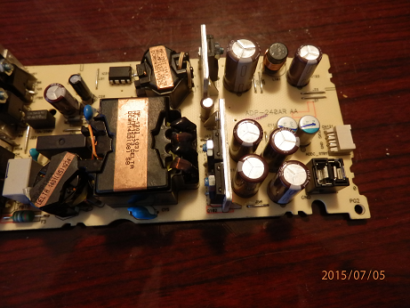

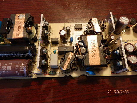

      Re: Ps4 smps
      It doesn't seem to be the typical SMPS, with a main Mosfet, it has several.
      I'v metered a bunch of components nada, everything looks fine
      I was hoping when I powered it on, it would show a low on one of the rails, but their identical pretty much and probably within specs.
      I looked into the optocouplers and found them on mouser or digi pretty much saying their low quality and not recommended way to go sony...
      Maybe its the feedback circuit, and PWM.
      Was wondering if anyone else has seen this on a SMPS giving out proper voltages, and why a system would reject it.
      I'm no Novice but here are the photos, nothing obviously blown...
      But i dont know SMPS that well, I have a good understanding
      Any suggestions on locations to meter while the power is on to find out whats wrong would be great... Going to check the PWM

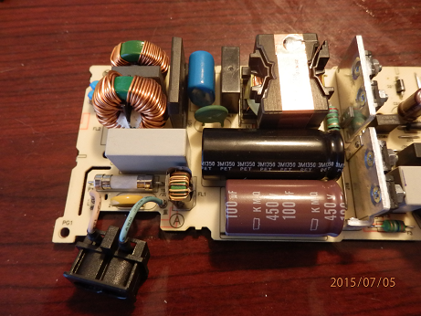

        it looks like it has 2 psu's and a pfc circuit.
        the problem may be the pfc circuit.
        next time use jpg btw, then the images will show in your posts.
        what's on the bottom of the board?

          Re: Ps4 smps
          I'm not exactly sure whats on the bottom, except for the optocouplers for sure.
          IF your talking about the white thing sticking from under, that would be a pizza crumb...
          Are there 2 PFC circuits on the bottom of the board, one for High and Low side?

            Re: Ps4 smps
            I'll get the chips listed, the little one on the topside 8 pin guy, is power control chip...
            Thing i dont understand is that the voltage outputs are correct...

              Re: Ps4 smps
              Bottom Side
              4 little chips are DAS09, for signal conditioning
              One on the high side is DDA001AG Can't find much out about this chip... except its on EBAY
              Lower side is DNP012A having problems getting specs of this chip as well
              And on the top side, a DNP015
              Going to power everything back up and check their pins, atleast the ones i can get specs for and compare them with the good supply.

                Re: Ps4 smps
                Took voltage measurements all the chips measured the same

                  well i'm not seeing any foto's
                  i'm wondering if the pfc circuit is running - it boosts the incoming voltage.

                      Re: Ps4 smps
                      -STJ -
                      All the photos so far are in my second my post.
                      I'm going to take measurements again, and do better documentation on it.
                      I think the PFC is running, i measured the same voltages on both the good and the bad.

                        • 31304
                        Re: Ps4 smps
                        measure the voltage on the 2 big caps.
                        be carefull not to short the pins aganist that heatsink because it could be upto 400v
