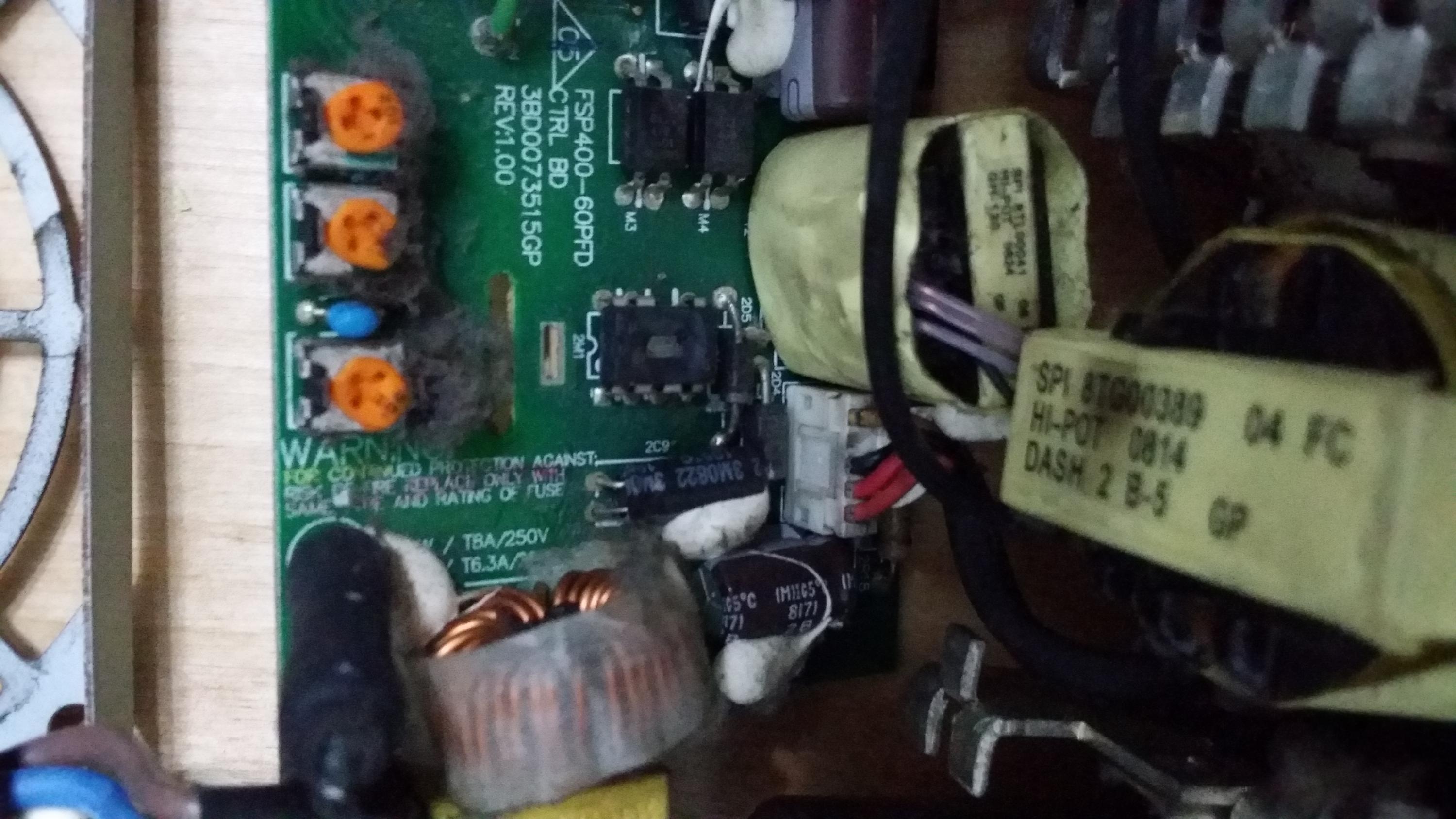

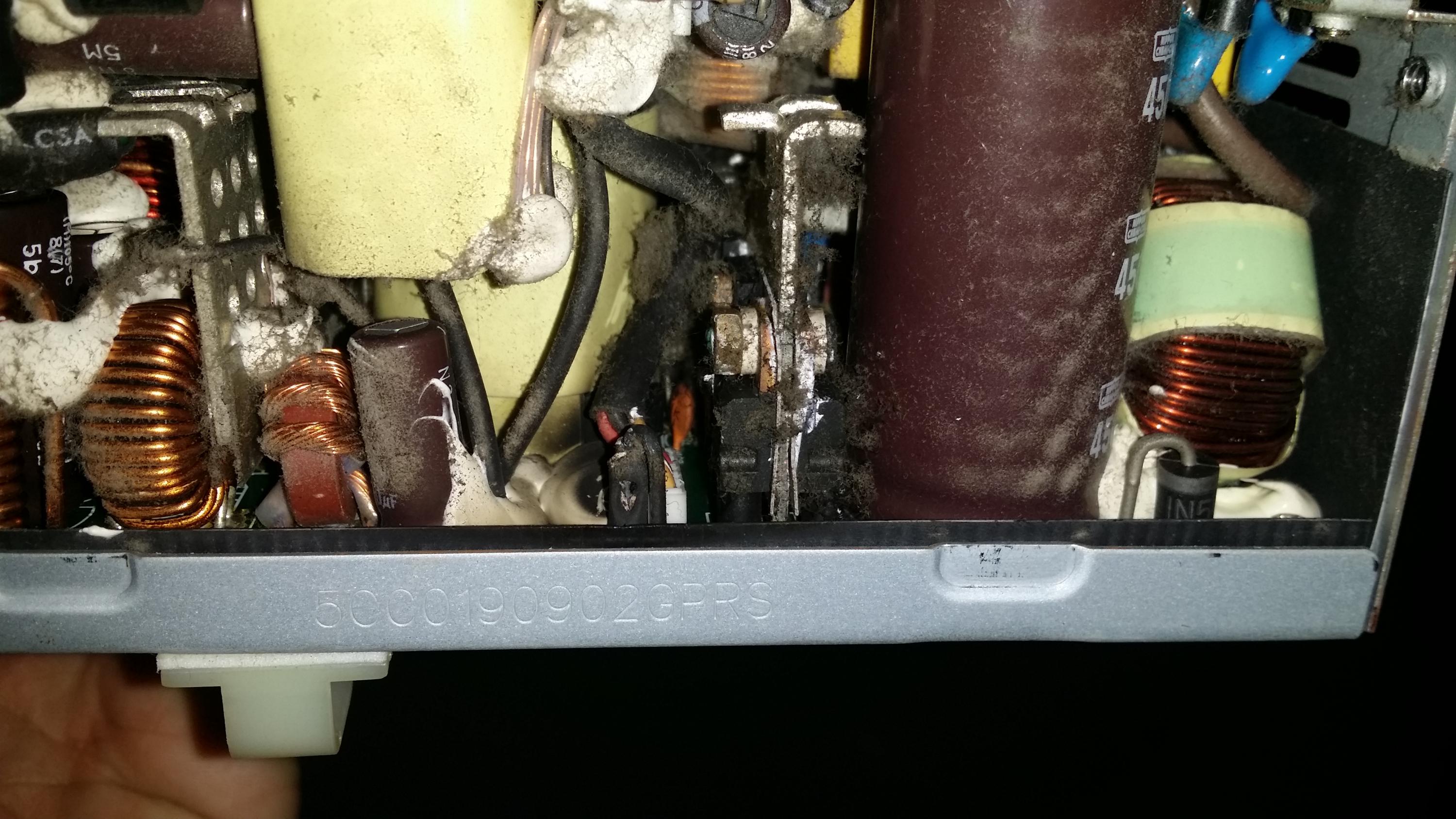

    I am new here. currently I am trying to fix my shuttle power supply which went up in smoke the other day. Here's the model and some pictures:
    Brand : Shuttle
    Model : PC71I0005
    Can anyone tell me the rating of the burnt resistor? On top of that, the 5v standby power regulator was burnt and I couldn't identify the part number. Will upload the pictures once I get home. Anyone's help is much appreciated!!! Thanks.

      The PC was shutting down when there's a huge spark, after which the house circuit breaker was tripped.

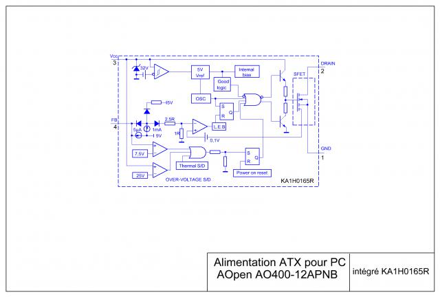

          well, fsp units.
          I don't know, but i do hate this platform..
          for me, it's rather hard to fix, because many components suffer leakage in full load rather than just fail..

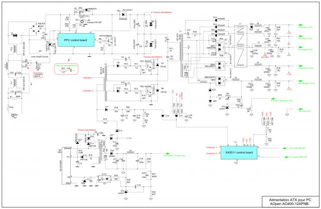

          But, here is the schematic.
          i do hope you'll find the missing component.

            Re: Help needed Shuttle power supply
            Can you post top and bottom *overall* shots that show the whole PSU (and maybe point where the bad resistor is)? All I can see is that it is on the primary side (I think), possibly the snubber or current sense for APFC or main PS.
                "huge spark" sounds like the mov shorted and exploded - i'v personally seen that happen.
                before you do anything else, get a small brush or a vac cleaner or compressed air and clear all that dust & fluff out
                  The IC which is blown is most likely to be a TNY26x series device (for the +5VSB section - a TNY265 handles 11W output and a TNY266 handles 15W output given this unit has active PFC and is of the open frame type and not an external adaptor) with the pins Drain (D), Source (S), Enable/Undervoltage (EN/UV), and Bypass (BP).
                  Also check capacitance of the 400/450V unit (after carefully discharging) - I've seen a surge damaged power supply which the 400/450V unit had barely any capacitance left in it.
