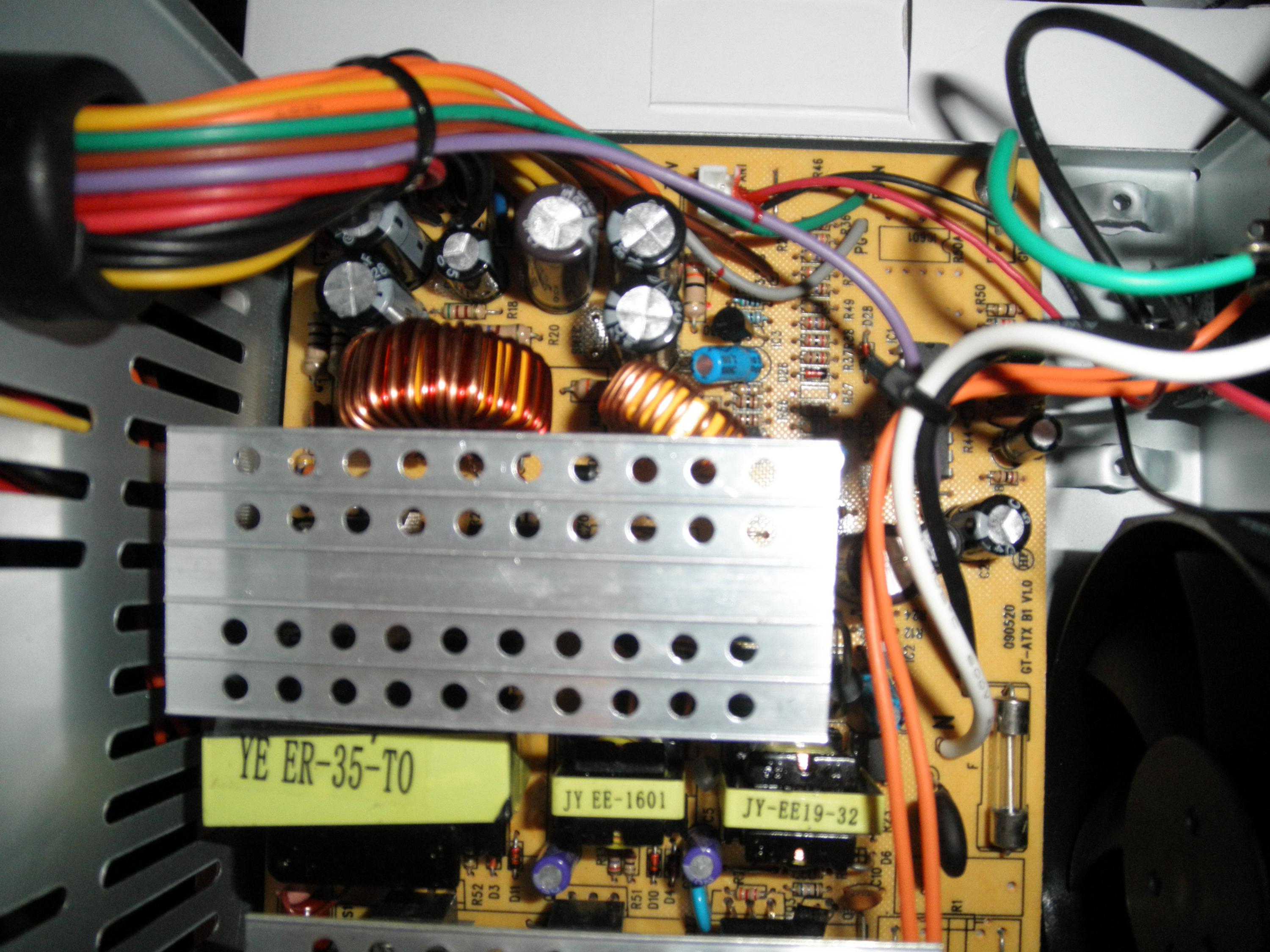

        Re: Diablotek Power Supplies
        Originally posted by goodpsusearch
        There are incidents of 13009 large package with good primary caps, big heatsinks and good psu design to do 400W but I don't think that would be the case here..
        Like this?
        500W Gembird PSU,using Sun Pro's AT-2005B.
        Main rig:
        Gigabyte B75M-D3H
        Core i5-3470 3.60GHz
        16GB DDR3-1600
        Samsung SH-224AB DVD-RW
        Delux MG760 case
          Only c hedge could tell for sure if he load tested the unit.. Sun pro is not famous for its designs though.
            master hoarder
            • May 2008
            • 12175
            • Bulgaria
            Originally posted by Dan81
            I'd actually say more than that,as the transformer is ERL-39. Also,notice that it's bigger than EI-33.
            Looks more like a 35 core. And I don't trust SunPro designs. They are up there with Leadman/PowMax IMO. So I still stand by my 200-250 Watt rating. Sure the thing might make it up to 300 Watts... maybe even 350 W. But I bet the ripple will be through the roof at that point. Also, what about long term reliability? Would you trust this thing to run even 8 hours a day every day? I wouldn't - not past 250 Watts anyways. Below that, it should be okay... until the caps cook, that is. Let's NOT ignore that 8.2 Ohm dummy load resistor on the 3.3V rail now. (At 3.3V, it would be dissipating a whopping 1.33 Watts. Can we say, cap cooker?)
            • goodpsusearch
              • Oct 2009
              • 2850
              • Greece
              Missed that. Seems 35 core to me too.

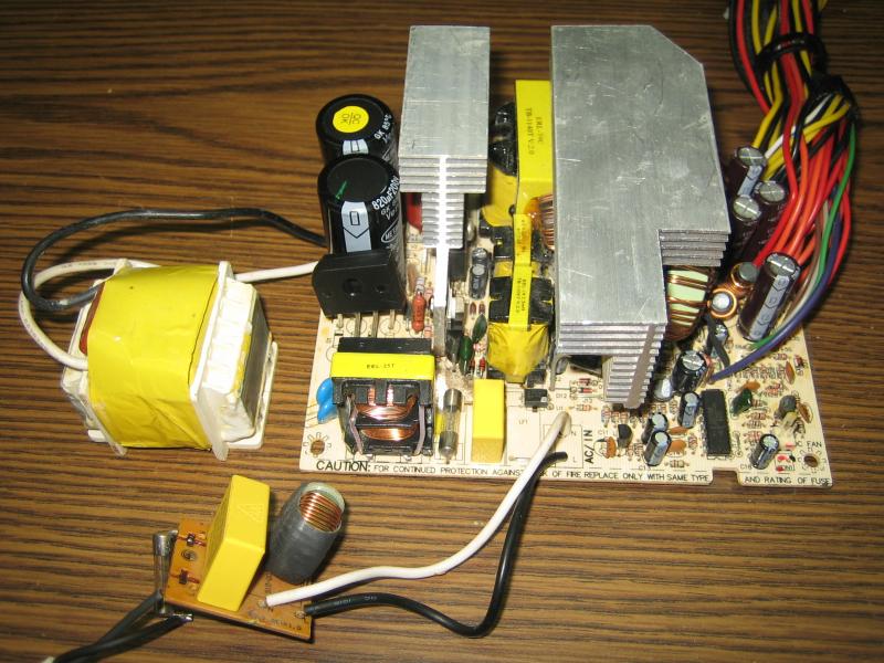

                      Finally found the problem with the 500 watt devil. The bottom switching transistor (13009) had emitter to base short. Didn't blow the fuse. The transistor must have been acting like a diode allowing the other transistor to conduct properly. The shorted emitter to base caused the driver transformer to look like a short on one of the output windings, and was reflected back to the primary winding. Therefore the primary side signal had only a half of what was expected - when the good transistor was conducting. Made it look like the driver transistors were bad and had low output. Even with one switching transistor working properly, there was not enough power, so the supervisory circuitry shut down the output. Now this devil is working!
                      This one had no line filter, no x cap, and only one y cap across the line side. Strange to see only one y cap. This has been corrected. It now has x cap, line filter coil, and both y caps.

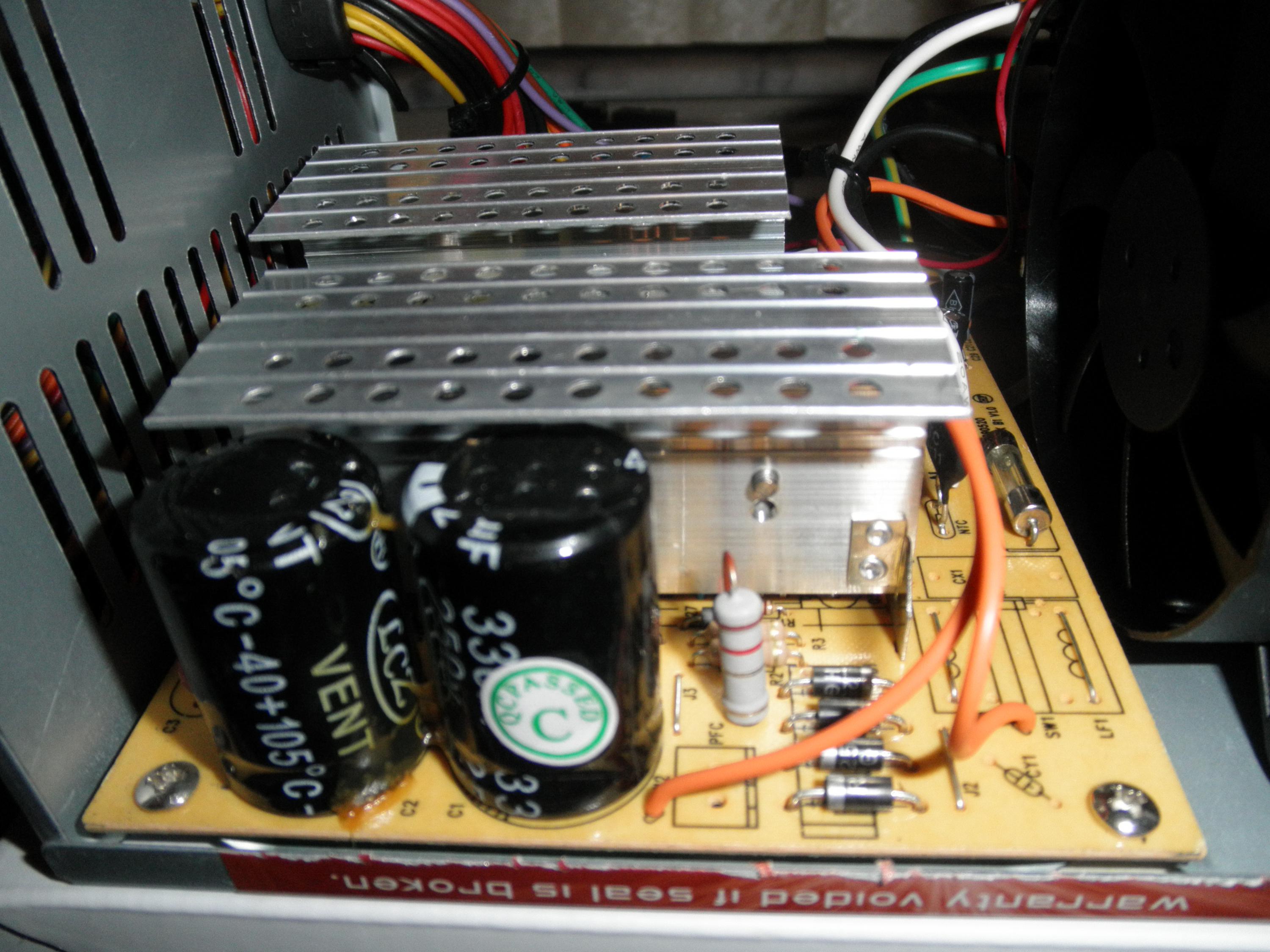

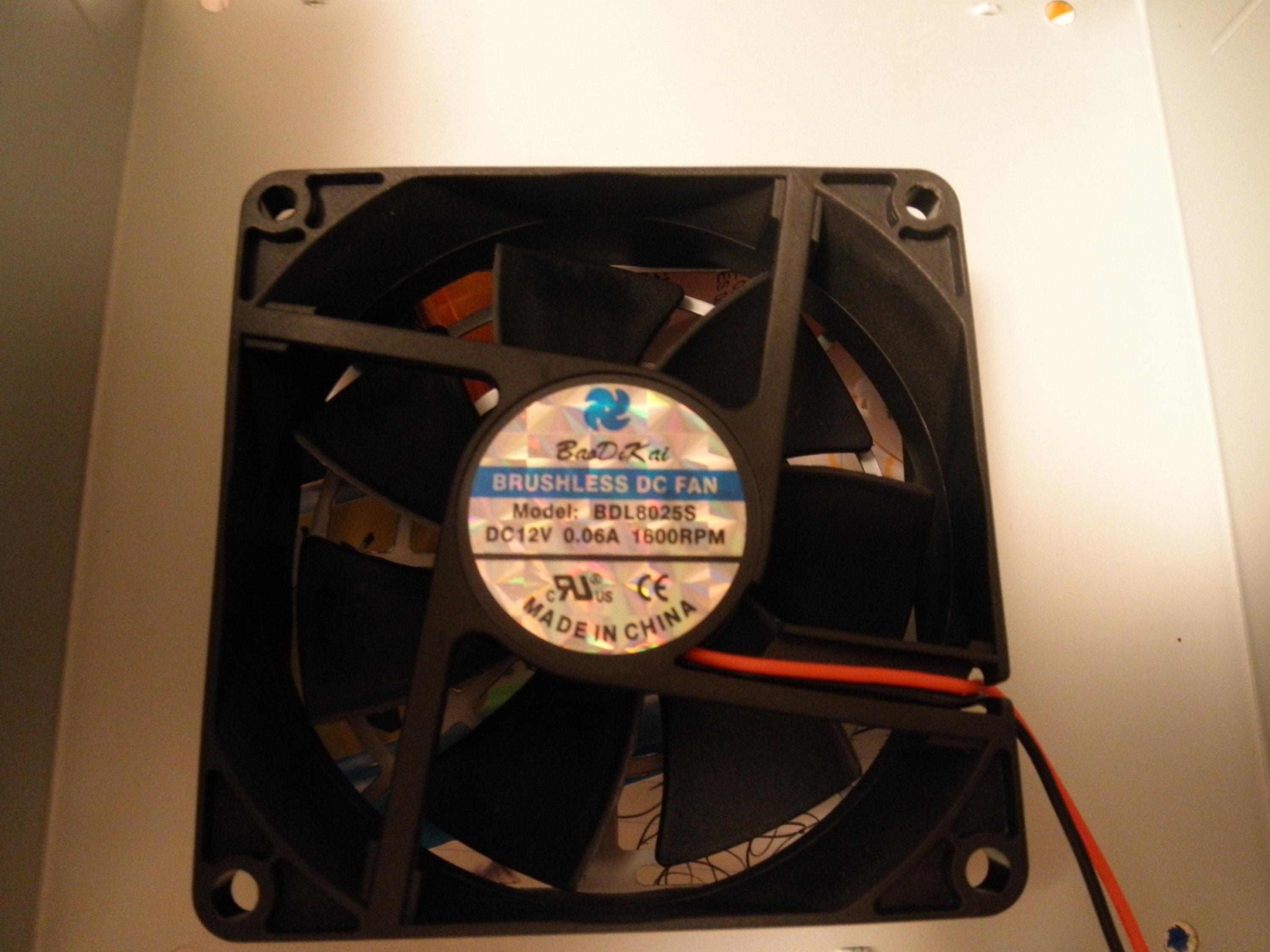

                              Hello everyone, boy do i have a treat for you guys and gals too today. I went to the computer store liquidation sale and managed to snag a Diablotek PSU that was sitting in their storeroom for almost 4 years. I snagged it for 2 dollars.I won't pay more for this kind of crap.
                              It's a Diablotek 350 watt psu with 2 fans and it reminded me of a same brand psu i had in the past (more on that later) it says in the box 350 watts
                              NOOOO Input Filters at all( so that was that hum around my house was when i plugged it in)
                              4 Diode Treatment
                              LCZ main craps
                              BH craps the rest
                              Bao DI Crap Fan
                              It has all ST and Fairchild chips ( i can't believe these brands are in there)
                              Now about why this reminded me about a previous PSU, i used to frequent this store back in 2001 when i had my first pc an Emachines etower 667ir ,I wanted to upgrade memory ,cd drives etc, and i decided i needed a better power supply (2003) yeah boy was i a , i purchased a diablotek 350 watt micro atx psu since it was so small, i thought this was great ( i wish i had joined this site long ago) maybe it's better quality? i only used the power supply for a total of three months then decided to build a new pc.
                              I tossed the PC in the closet and forgot about it, more than a year ago doing cleanup i decided to take a look at that PSU it had the same layout but had G luxon all caps and none were bulged, it had a sort of full input filtering minus a x cap and looked beefy enough to me at the time maybe i was wrong what really caught my eye was at the corner of the PSU board it said : "ENGSMPL" and thought of nothing else at the time so i guessed it wasn't a final version? how did it end up in my hands? but i didn't need the computer as its motherboard went bad. and turned it over to a recycler , which i wish i never did, so diablotek maybe good in the past , wtf now....
                              sorry for such a long post
