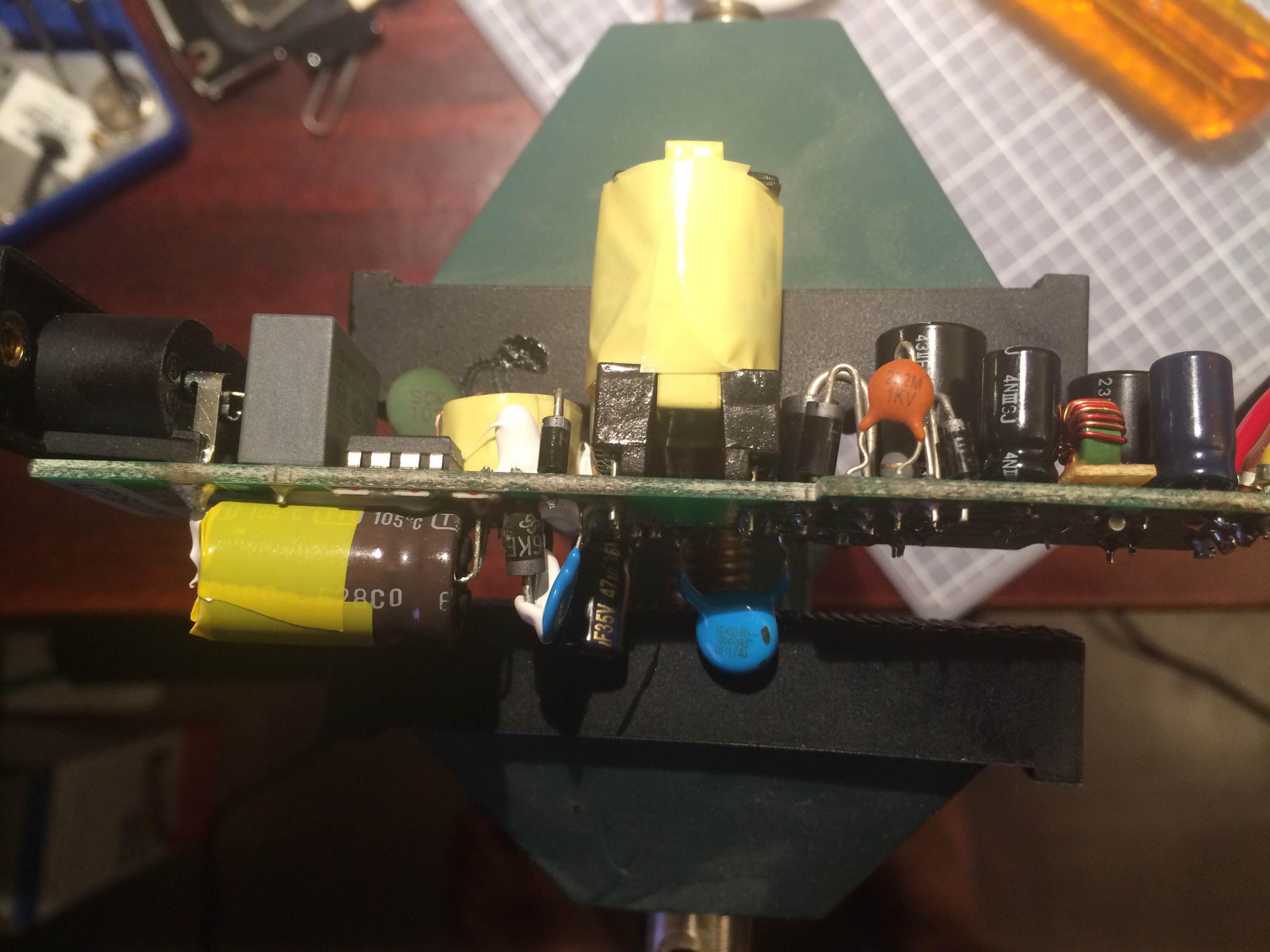

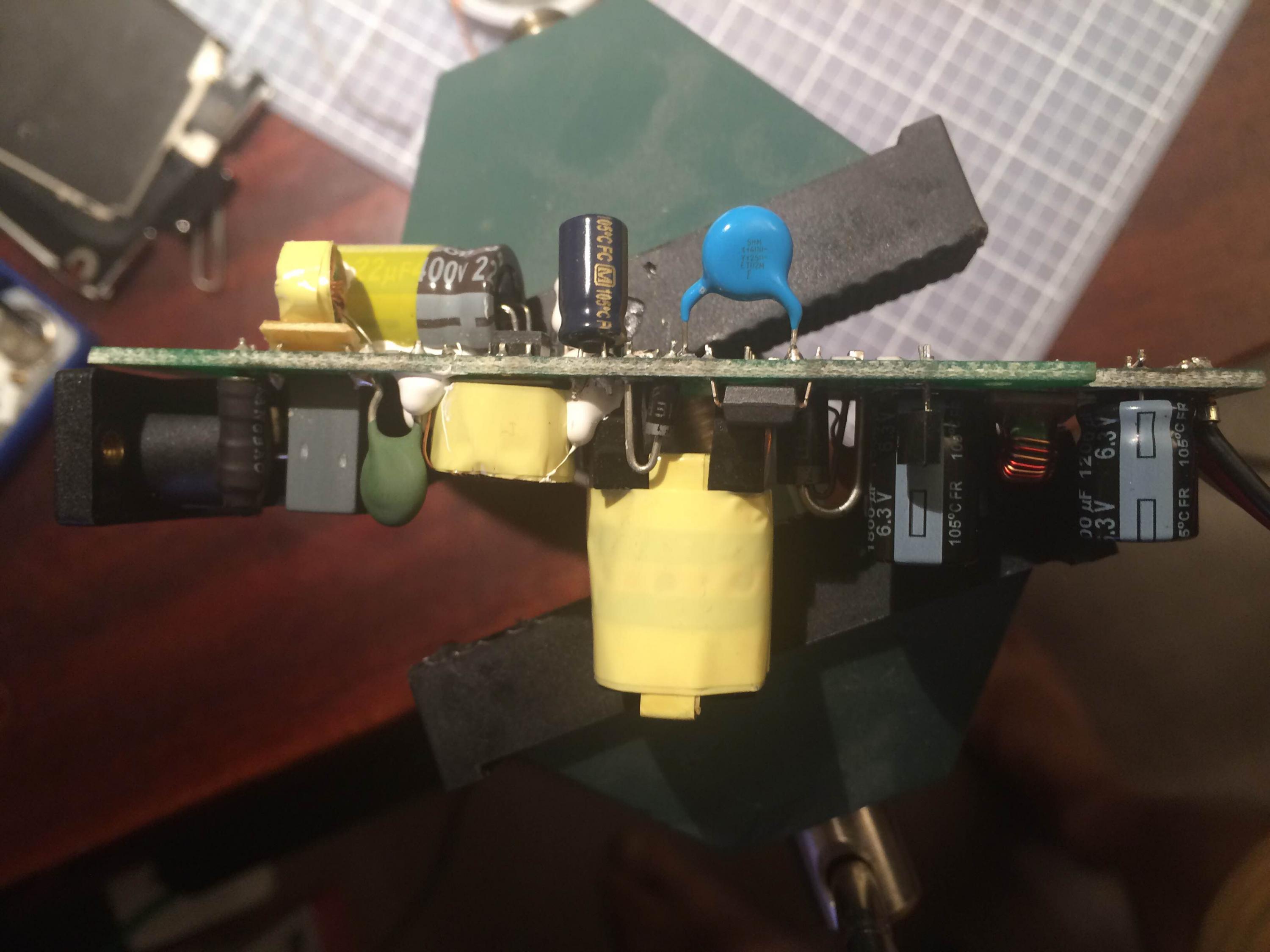

                          #32
                          Re: Troubleshooting AC/DC circuit board
                          pics with new caps
                            So you do have 160VDC between the two legs of the main filter cap?
                            And you also replace that small lytics start-up/running cap in the primary side?

                              #34
                              yes 160VDC is measured but only the radial caps was replace didn't know about the other that need to be replaced. which one are they? do u think they are bad as well?

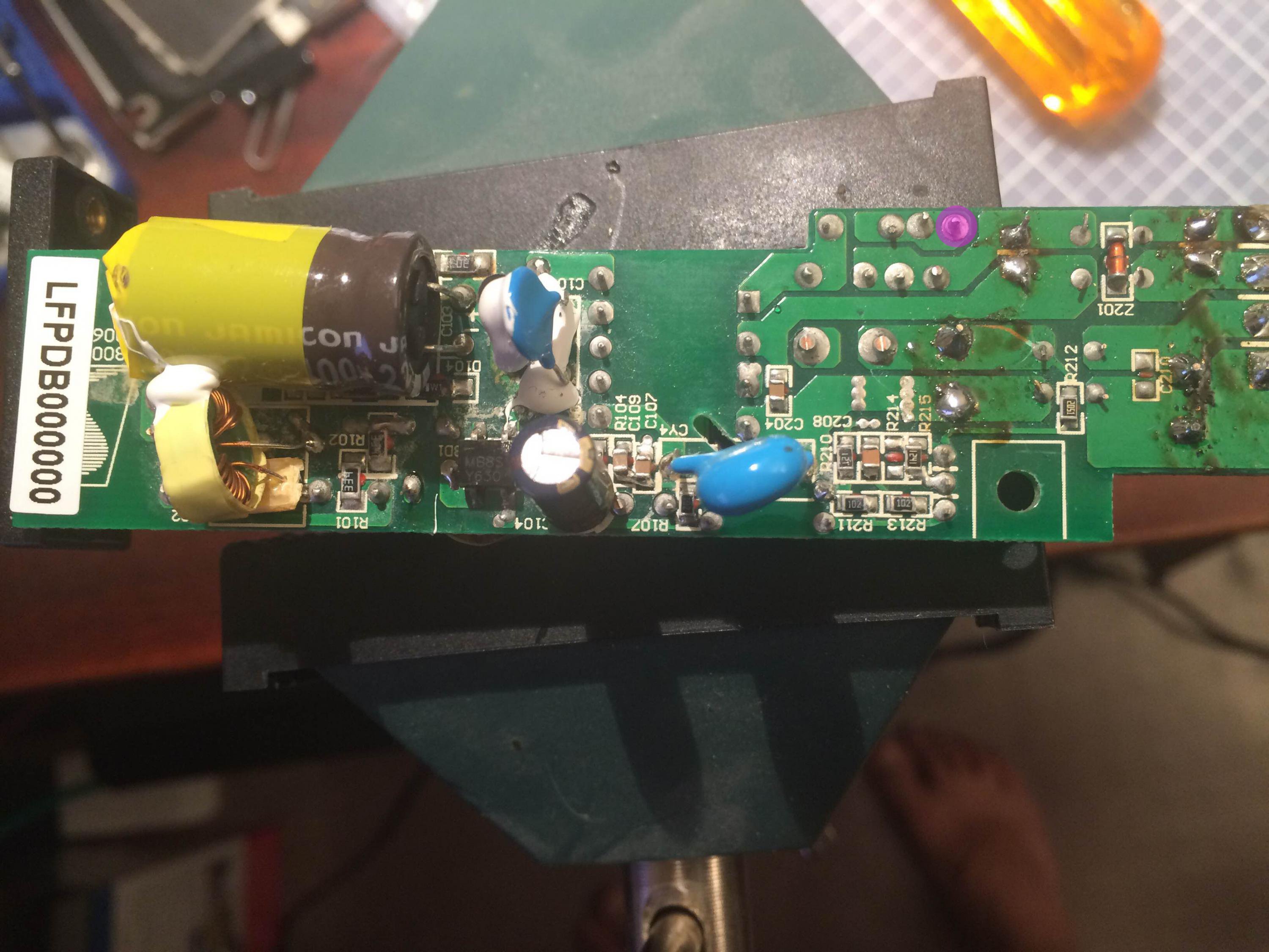

                                • 31281
                                #35
                                check for cracked soldering like in the circle.

                                  #36
                                  i'm a bit in experience when it comes to visual inspection. But I just tried resolder the crack as shown in the red circle. Doesn't do it...still same problem.
                                  Which component is the bridge rectifier? There are several IC chips, can any of these be the culprit? Is there way to test for these?

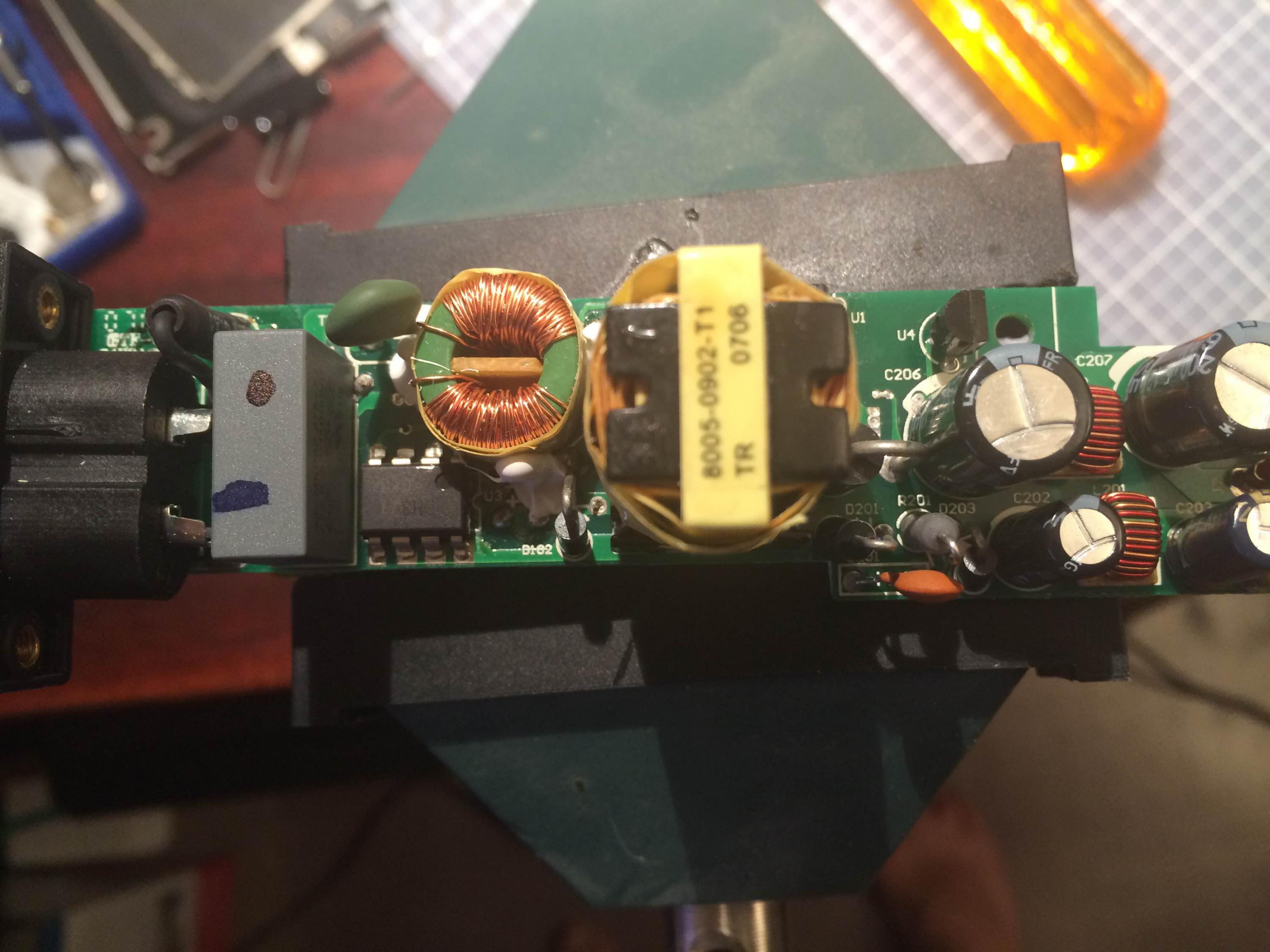

                                    #37
                                    There's a chip on board next to BD1. I assume this is the Bridge Rectifier?
                                    Testing this with ohm meter setting at 200ohm. Tried to test all for legs and couldn't get any reading out it.
                                    Could this be the culprit?
