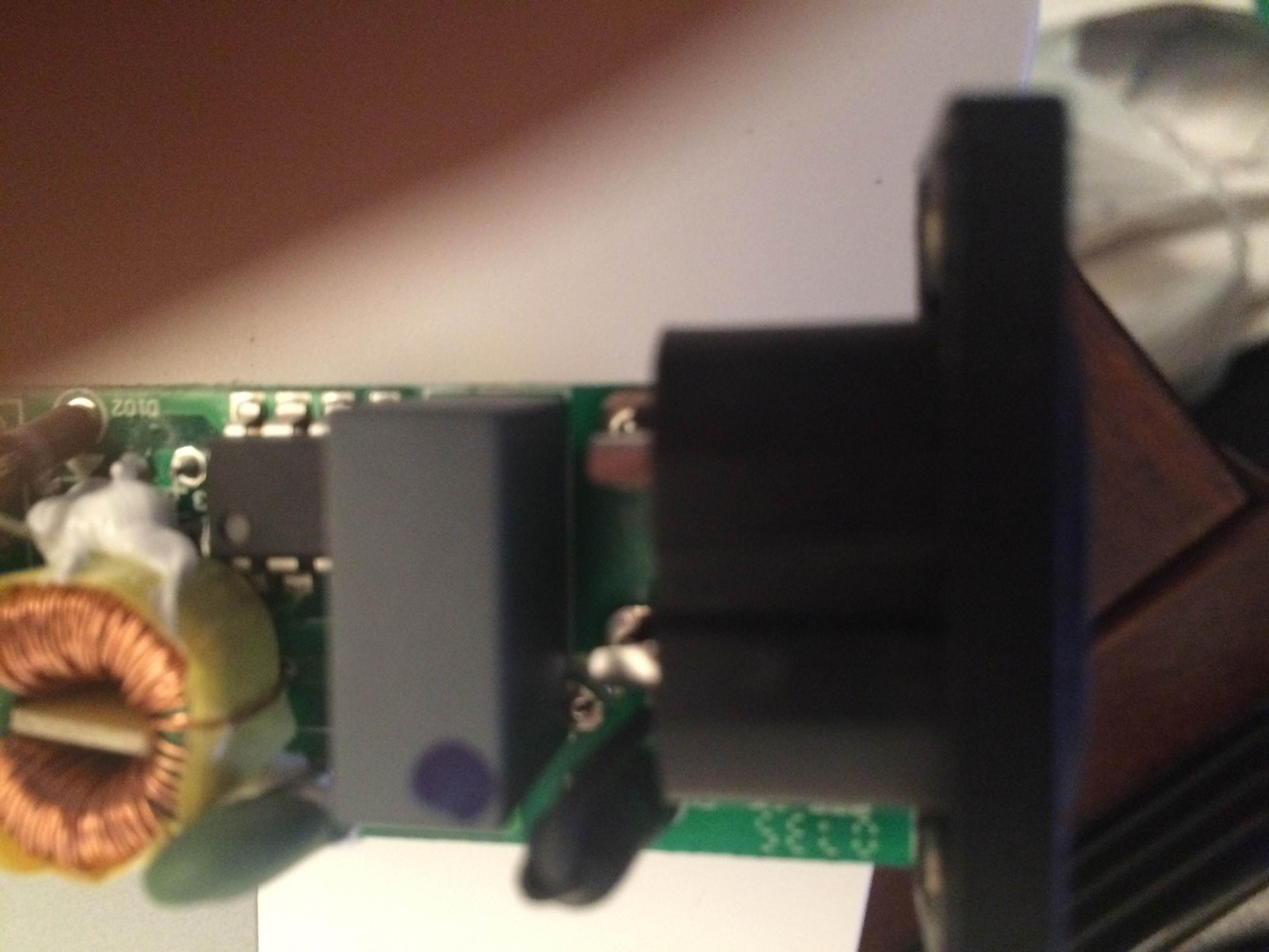

      We need better straight shot pictures of the whole top side and the bottom side of the board so I can locate the main AC fuse.
      Right now we do not know if the SMPS circuit is getting the DCV to run or not, so you should check and see if you have 160VDC on the two legs of the main filter cap (big brown cap laying on the side with yellow tap on it) first. If there is no voltage there then we need to check the main fuse and the bridge rectifier.

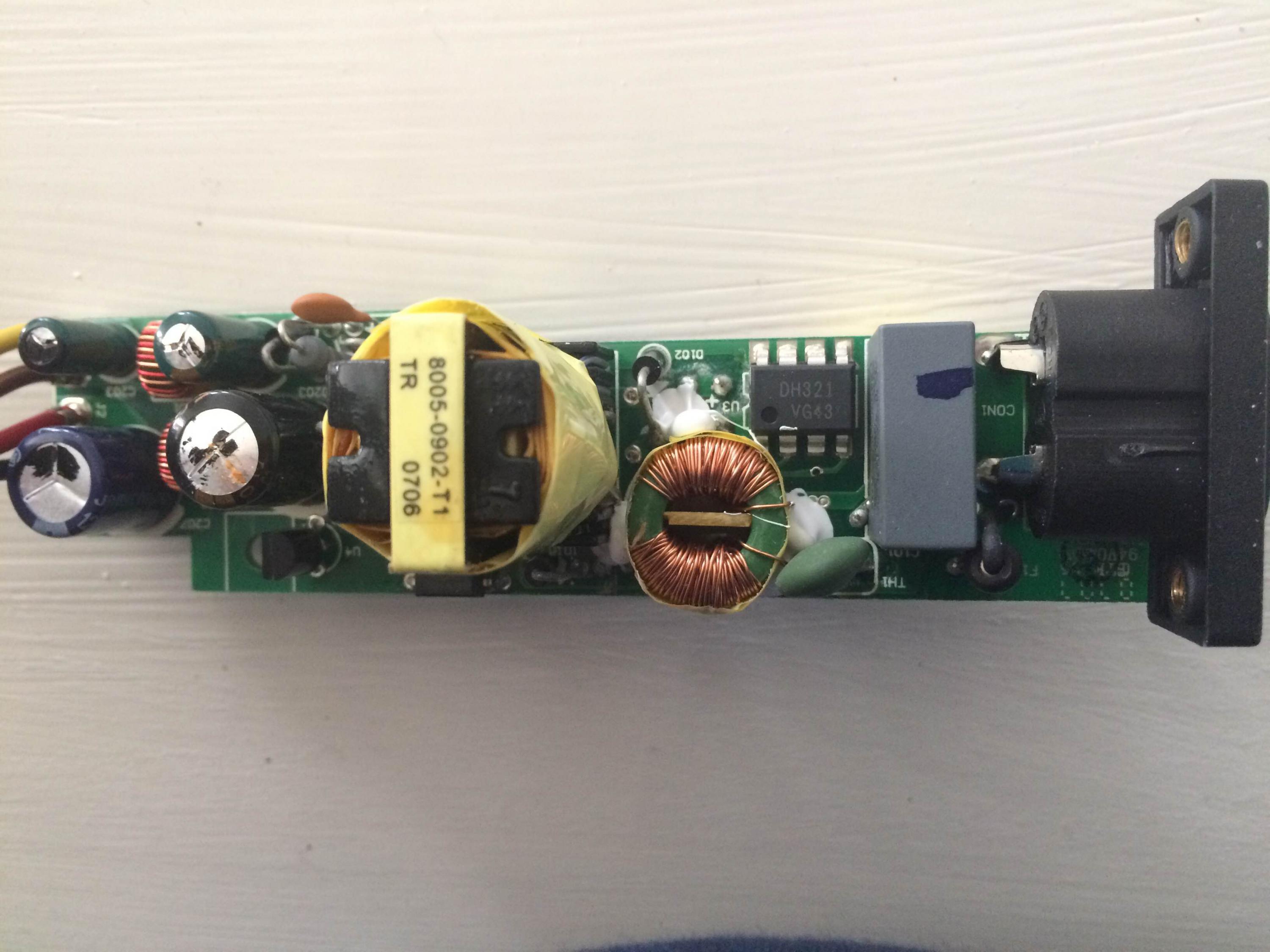

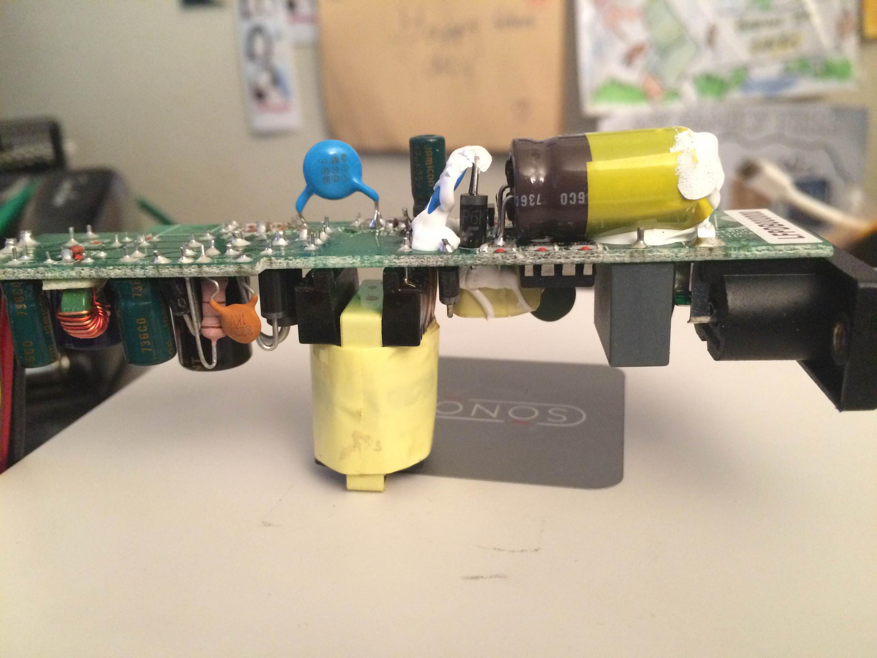

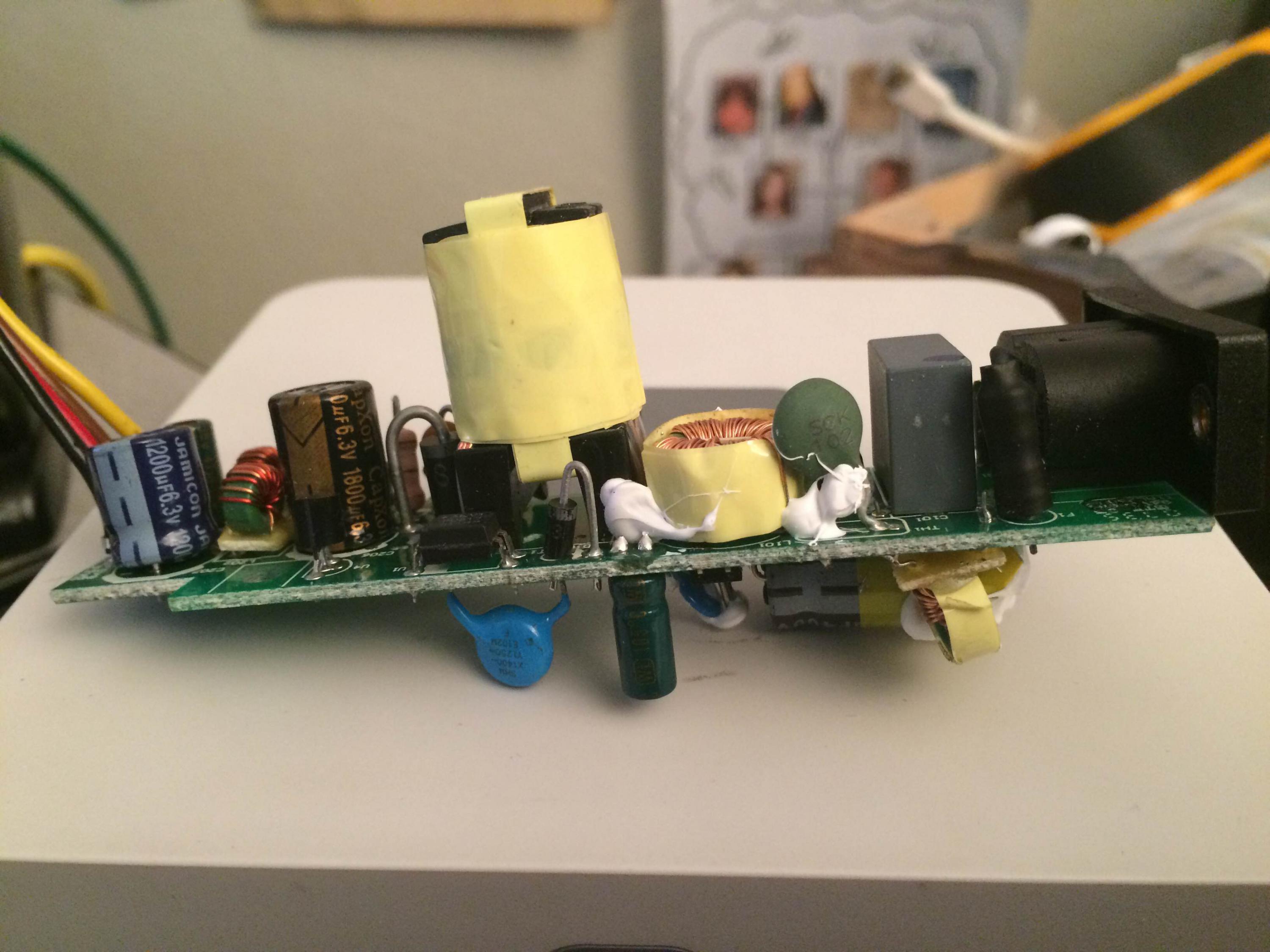

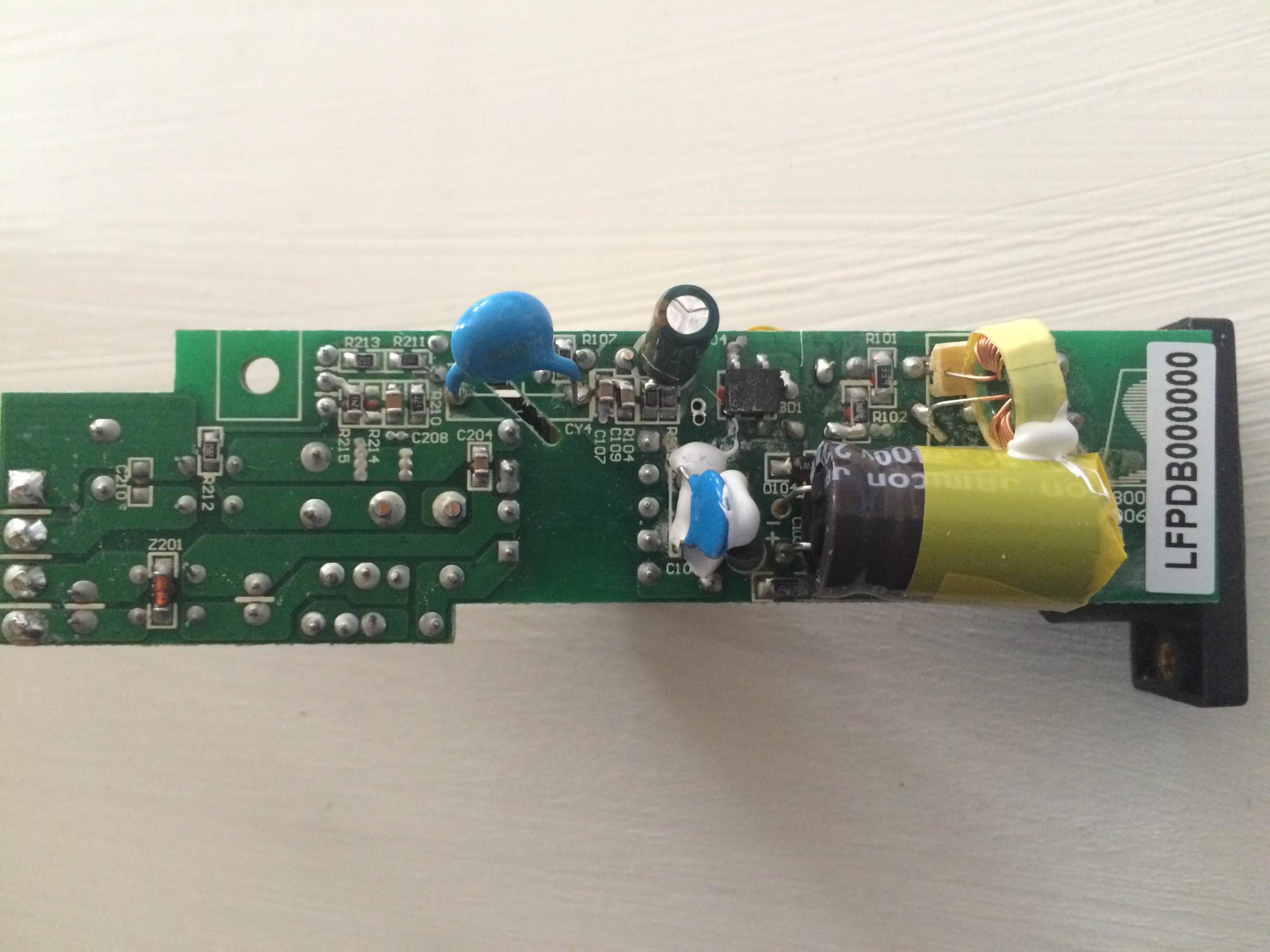

            more pic of top and bottom as requested
            159.99VDC is measure on the capacitor
              Re: Troubleshooting AC/DC circuit board
              OK, so we get to see to top side of the power supply board, I can see at least 3 bad caps with bulging top, I would replace all 4 in the secondary side.

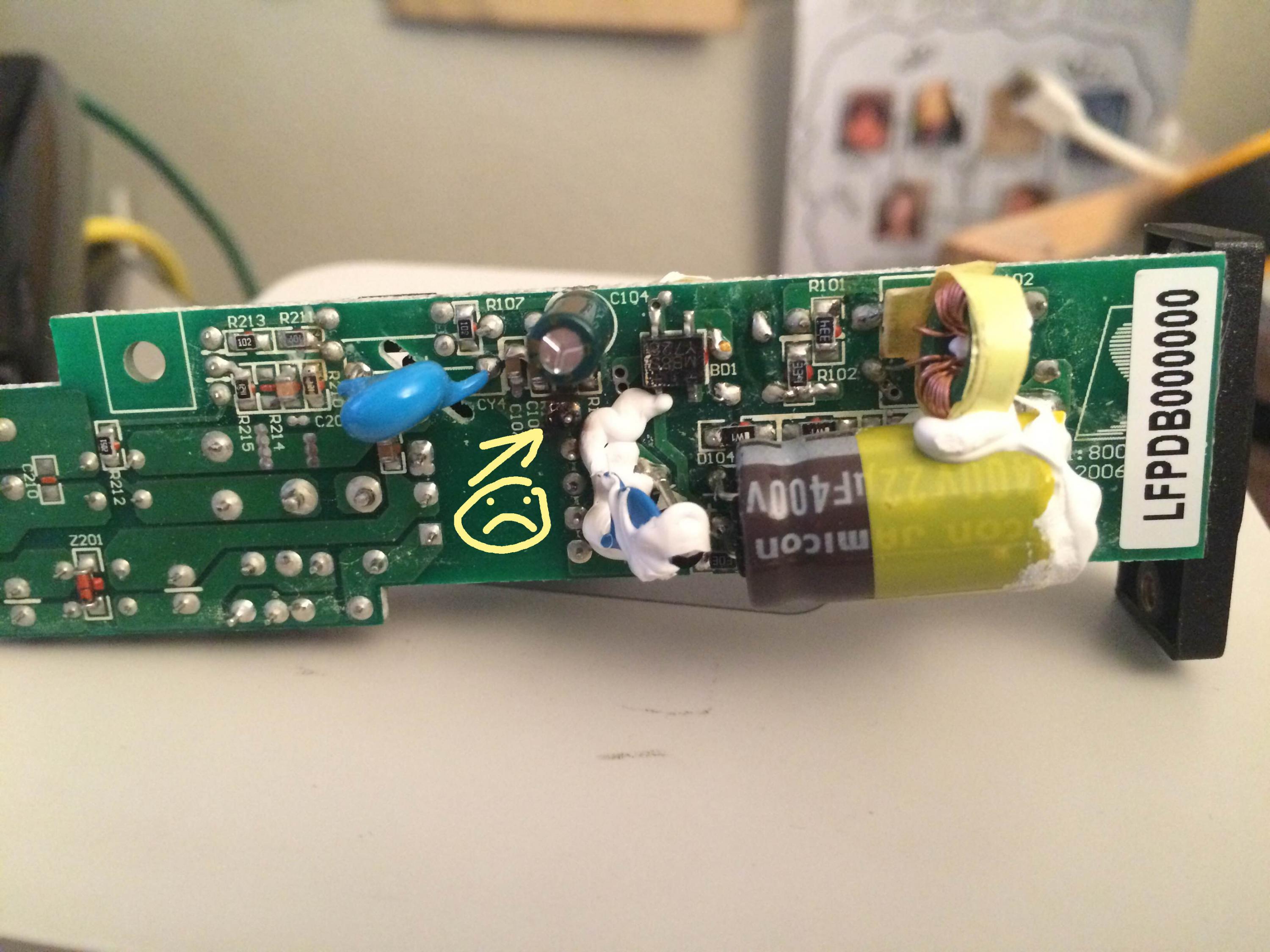

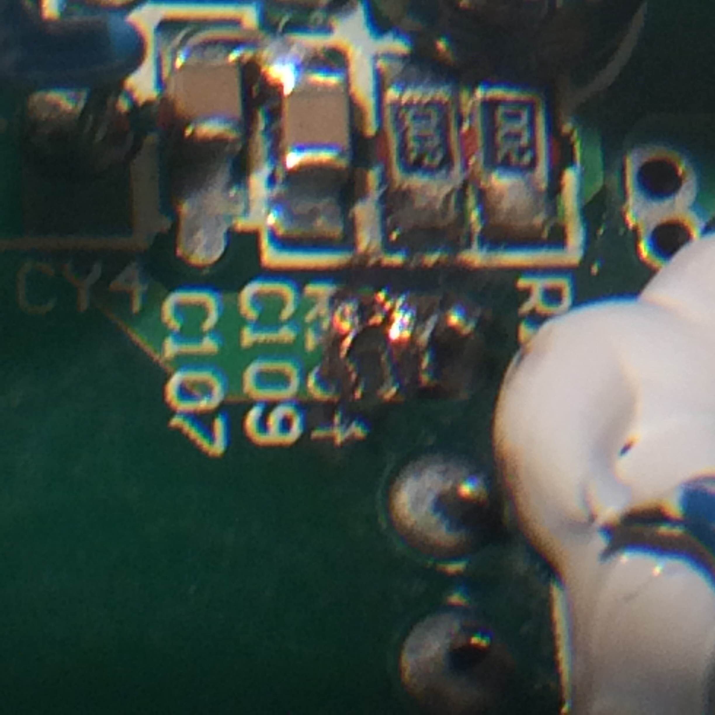

                              In the process of testing and out the output from various capacitor, spark fly and this happen. See pic
                              The blow lead belong to the transformer...the big block module sitting in the middle of the board.
                              Does this mean it's bye bye? Or can I just resolder it? How do I test transformer.
                                Clean off the black carbon with IPA first and look at the pin really well, it looks like it has cold solder joint on that transformer pin.
                                  not sure what to make of this. Appreciate any pointer
                                    It looks like the trace burnt open. Did that location make contact with other conductor or something while you were probing the board?
                                    But looking closer I can see that the pin has bad solder joint, so you can try fixing that connection and resolder all the pins of the transformer as well.
                                      I was probing the caps...and then it just sparkle. Wasn't sure what it was...until i see the black charred. I decided to disconnect and kind of don't want to do anything else now
                                      Will re-soldering cover the trace burn out? If I resolder and reconnect, how do I tell/test if transformer still operating? can I read it off volt meter? there's a lot of lead wire onto the board...wasn't sure which wire to tap on the volt meter.
                                        The fuse on the PSU might be blown as well now too. It's covered in some black heat shrink tubing.
