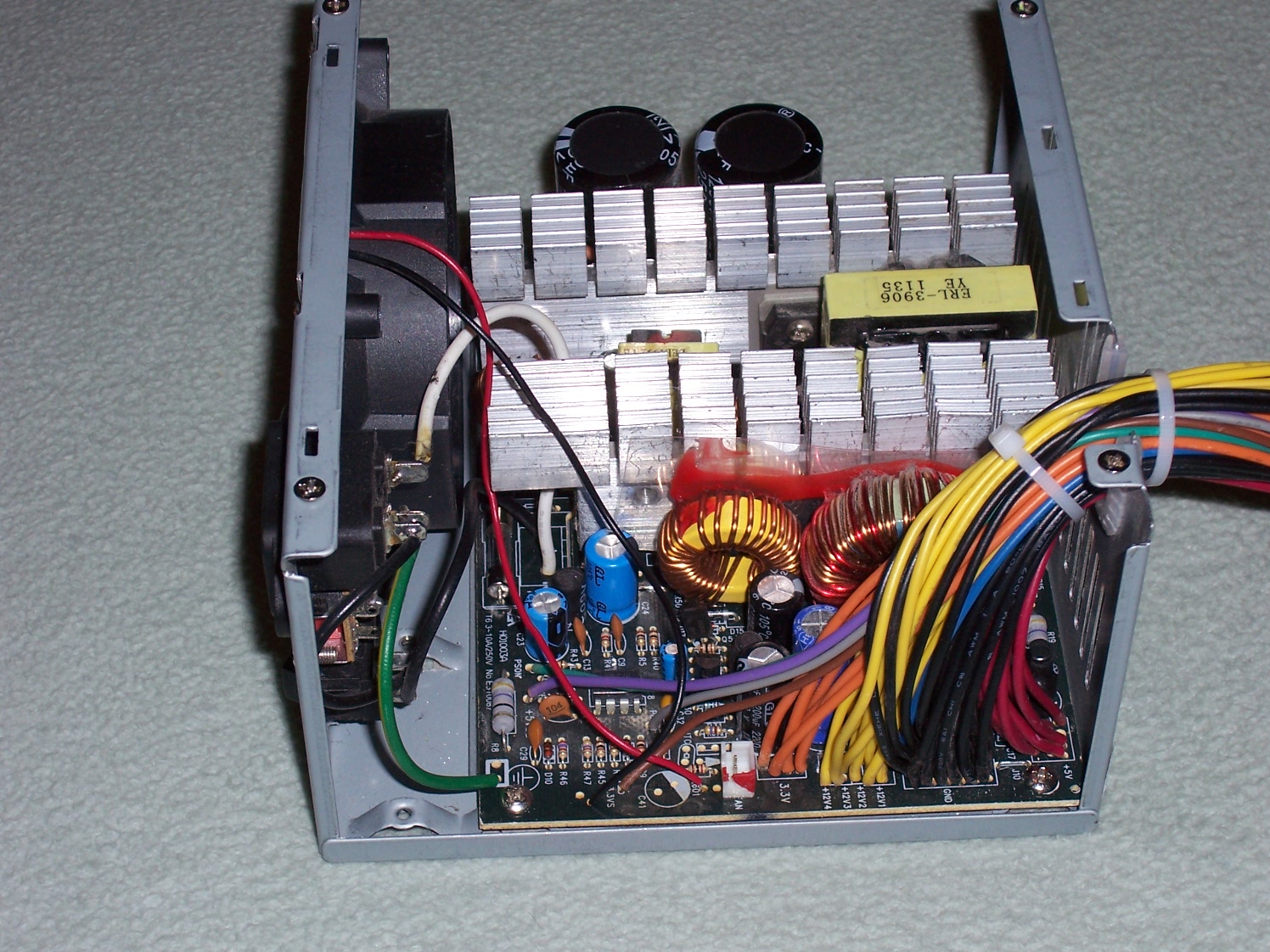

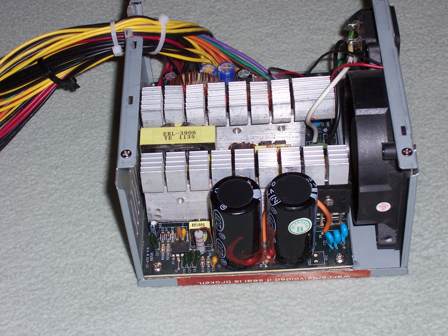

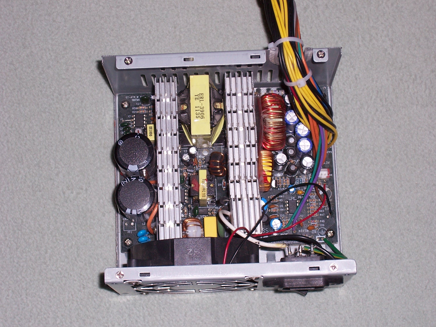

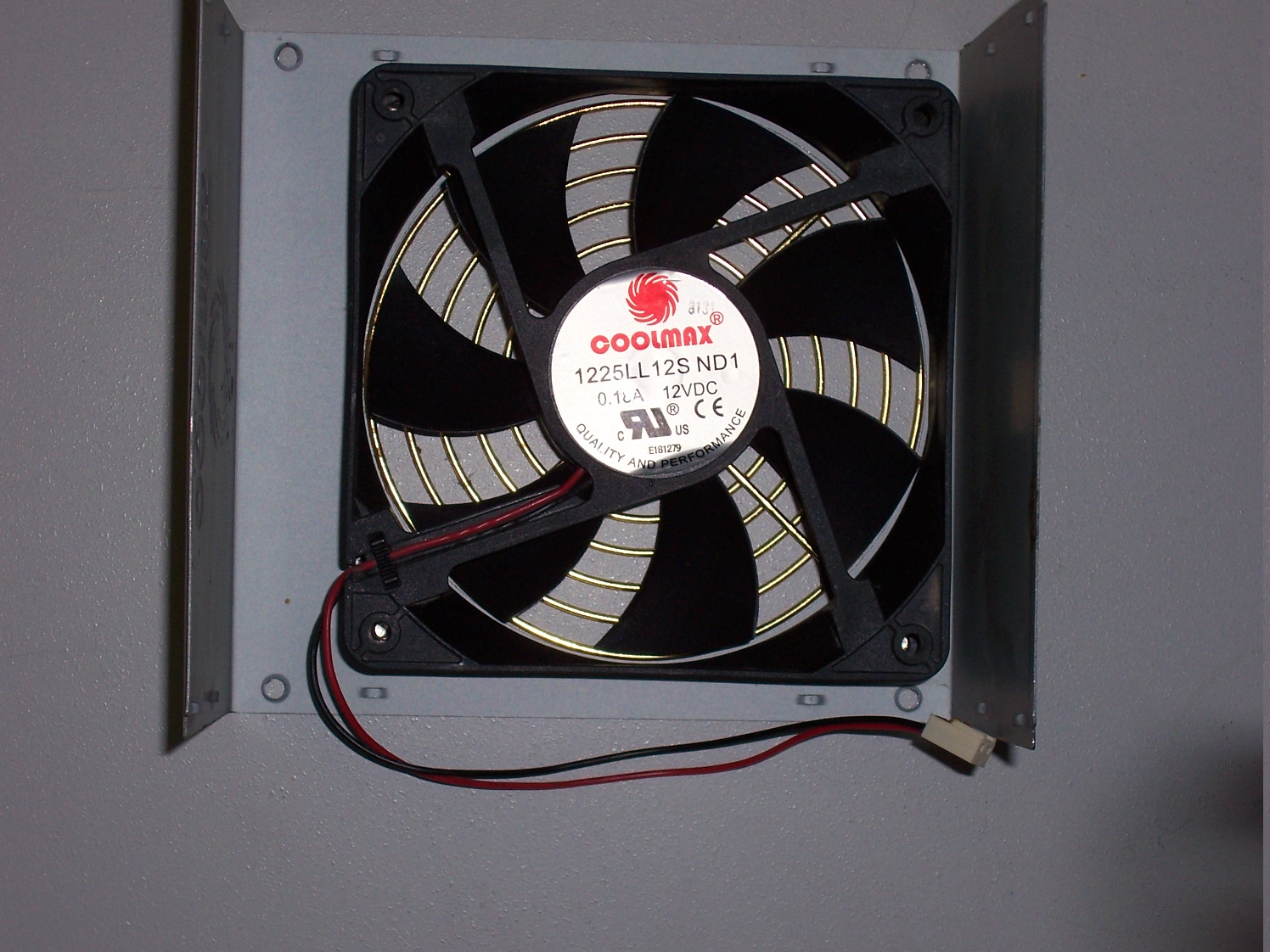

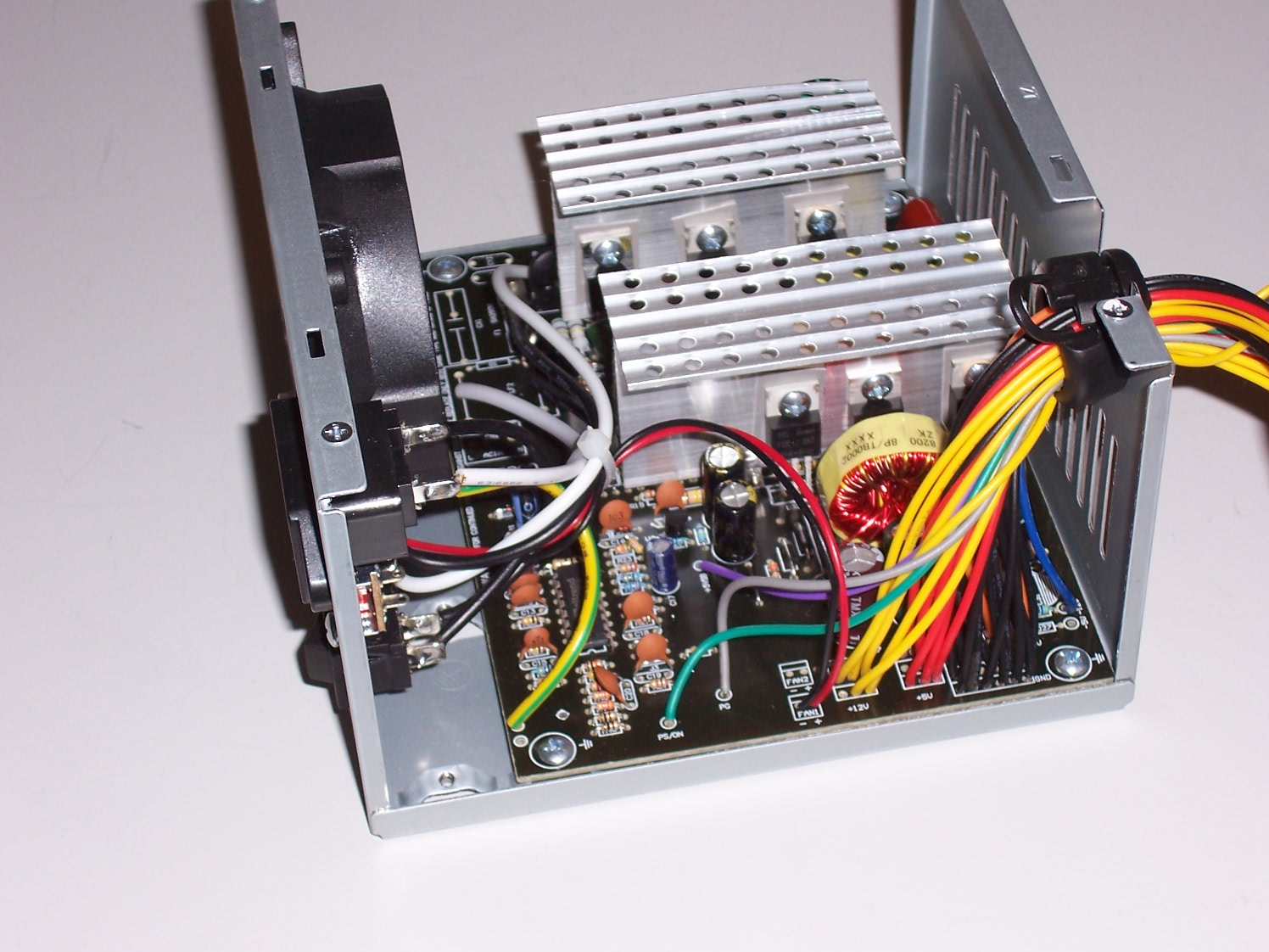

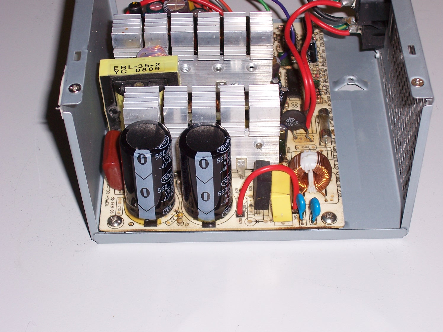

    This Coolmax V-500 ATX power supply recently came my way. Initial look revealed that the fan was stuck. As can be seen from the picture, the label says "Quality and Performance". Took it apart, cleaned the shaft and bushing, oiled it, and now it works fine. Most of the output capacitors were bulging, so did a recap using measured pull-out capacitors. The 3.3 volt and 5 volt outputs have pi filters, but the 12 volt output has only a single 3300 uF/16 volt capacitor. Perhaps OK for an older computer but not much to my liking. Biggest problem was all the burnt glue covering the top of the pc board and components. Lots of scraping, looks much cleaner now. Even a Bestec does not have this much glue. Coolmax is not my favorite power supply. What I am wondering now is......will it do 500 watts as the label suggests.......or will it do 400 watts? I am not holding my breath to see!
    Old proverb say.........If you shoot at nothing, you will hit nothing (George Henry 10-14-11)
  • Pentium4
    CapXon Be Gone
    • Sep 2011
    • 3741
    Re: Coolmax V-500 quality power supply
    Good work everell It looks to be ATNG or Long Yi Power. That fan is most likely a rebranded T&T. They fail all the time. 20A ultra fast on the 12V? I'd say 350W tops IF those bulk caps are actually 560uF. And those TO-220 13009's might not even be able to do that since the heatsinks aren't that large. So, 300W continuous, 350W peak would be my estimate. I actually think the 3300uF cap on the 12V would keep things in tolerance up to 20A. But yes, PI filters should always be installed, especially on the 12V!
        Yeah. I would say about 300 too (assuming 12A BJT switching transistors). And yes, T&T fans are pure junk. It was one of those than failed in a Delta GPS-300AP I posted about a while back and turned the PCB completely black.

          Ideally, a high quality sleeve-bearing fan should posses the following traits:
          1) rubber o-ring beneath the snap ring that sits between it and the sleeve.
          2) rubber o-ring on the other side of the shaft
          3) cap that seals off the inside, good sticky seal on top. I've found that a sticker itself without the cap is insufficient. The adhesive finds its way into the lubricant and contaminates it.
          Now there are well-molded (and I mean made using smooth molds and high-quality plastics) fans that lack some of these things, and there may be cheaply molded, low quality plastic fans that have all the above attributes.
          The lubricant of -ALL- middle-tier - that means to say - Taiwanese/Chinese fans (even of good quality) is always of poor quality. You can get 5 years or more out of it, but despite the recommendations here of not replacing the lubricant because of the fear that it might react with the lubricant in the sintered metal sleeve bearing, I've never had this problem, and good silicone lubricant has always worked wonders for me.

            teflon loaded would be good, but cost more than the fan.
            i see a lot of clip-together fans now that dont have a clip on the shaft - you cant even get to the shaft without a drill.
              Magnetic bearing, I use SUNNON in our products.
              http://www.hardwaresecrets.com/print...uter-Fans/1039

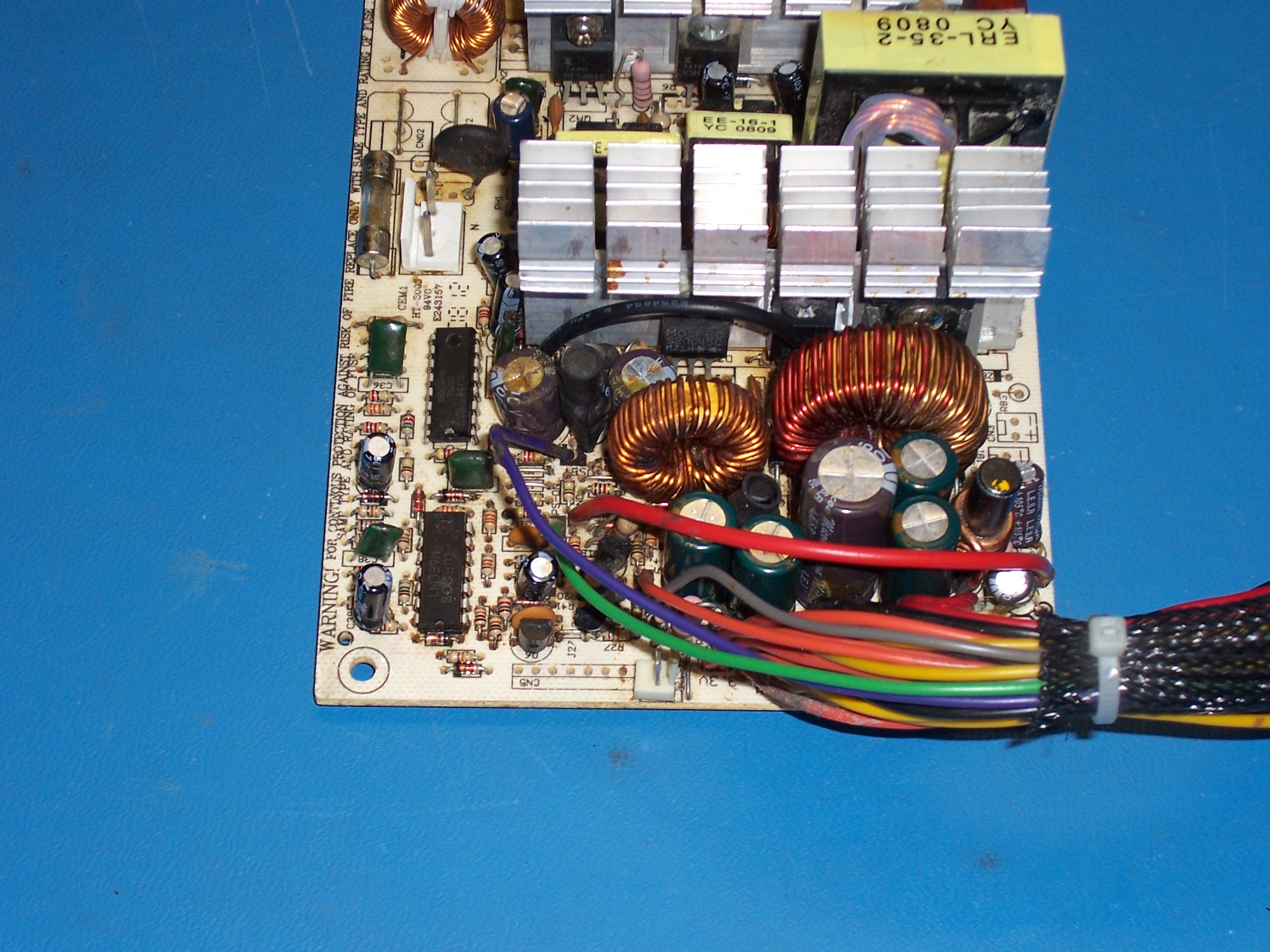

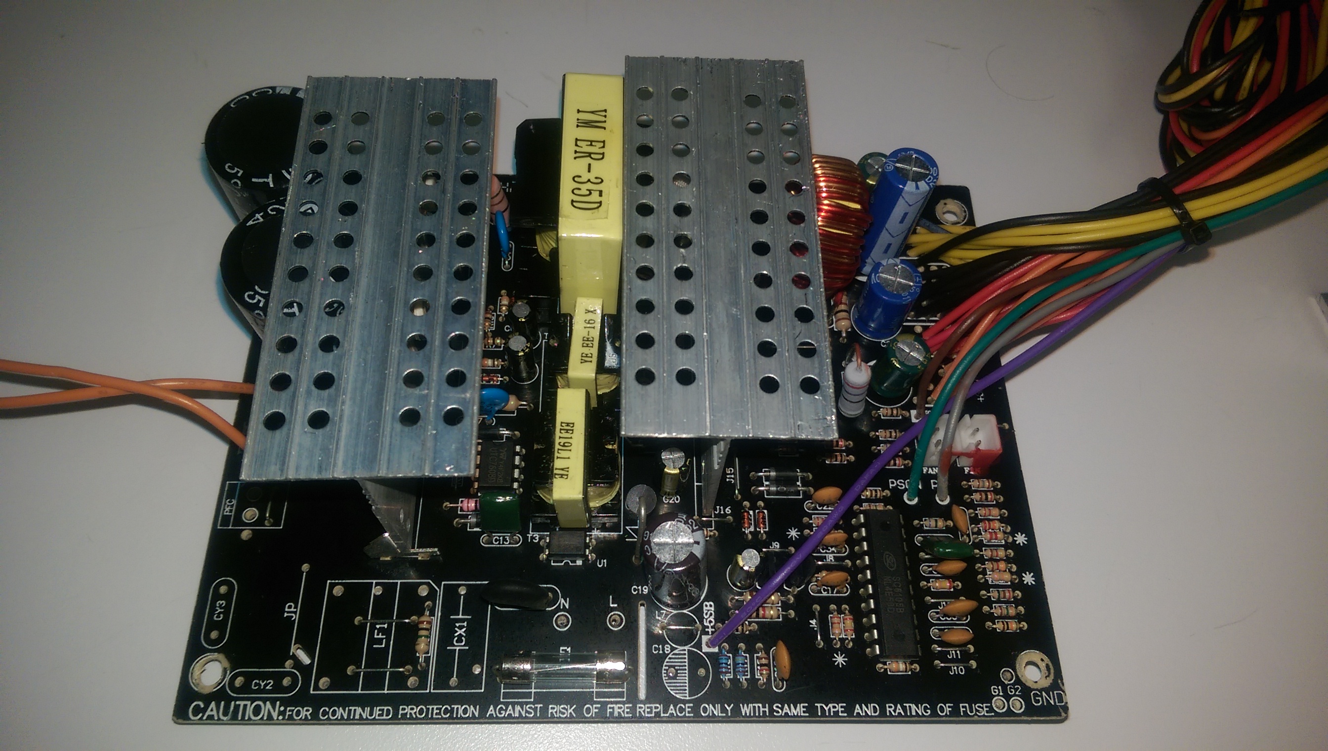

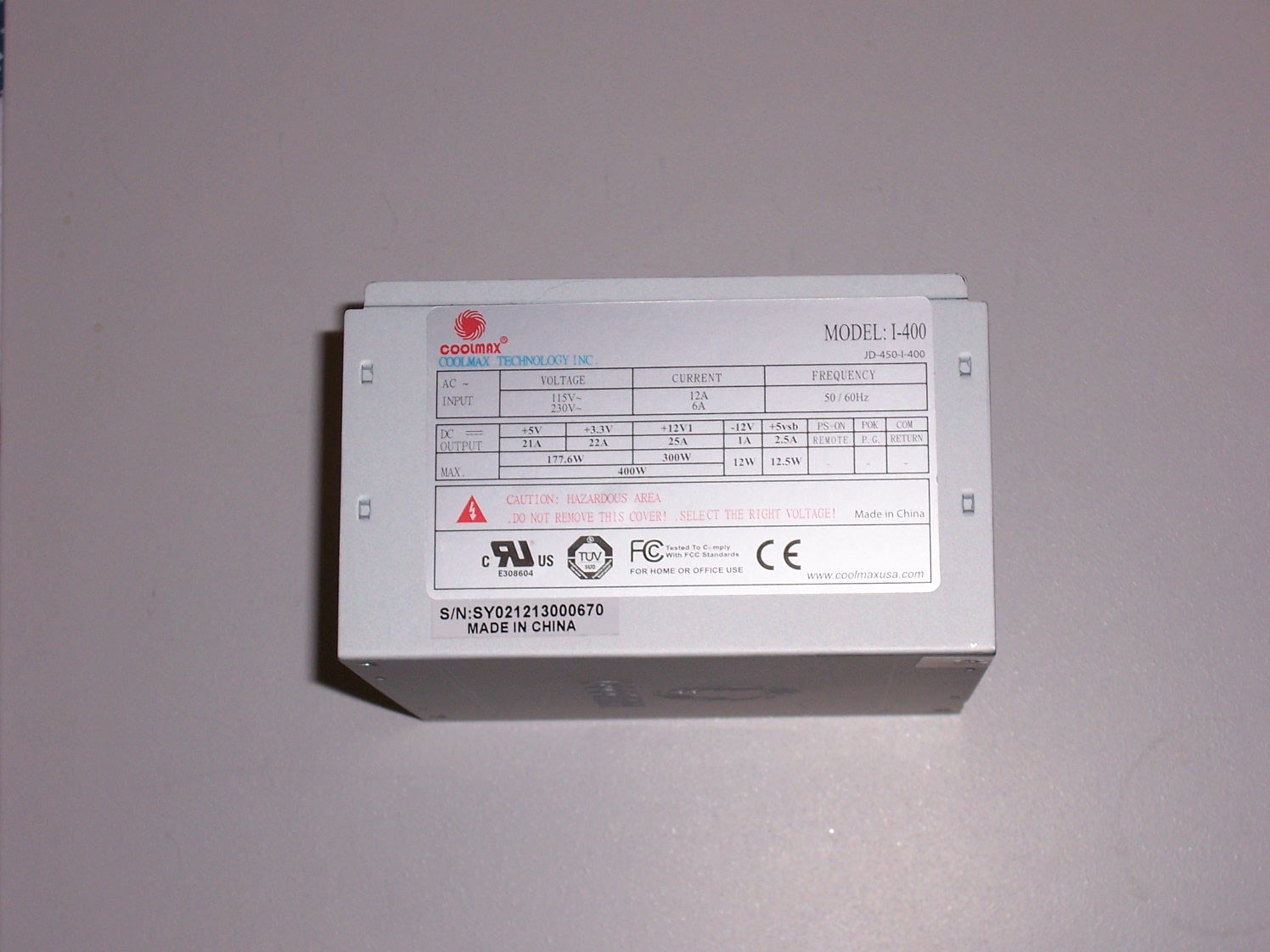

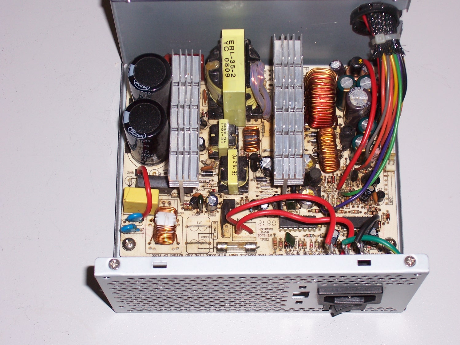

                Here is another Coolmax I recently acquired. Supposedly rated for 400 watts. Didn't look like it had as much potential as the power supply in the first post. Haven't done anything with it except to put it aside for a cold snowy day.

                  that's um - minimal on parts.
                  still, atleast you can see everything, unlike a pair of maybe chieftec's i recapped recently that where so packed it was a pain.
                    Same OEM that is now pumping out Diablotek units. Essentially useless for anything since there isn't even two caps per rail. Doesn't even look like there's a coil on the 5VSB filtering

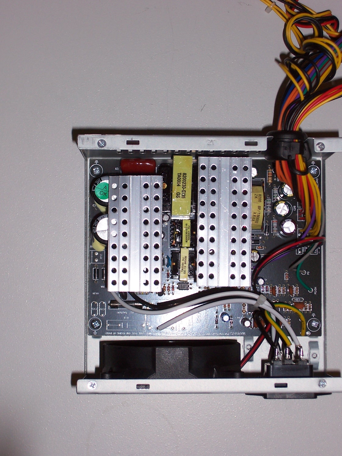

                        So what's the beef with Diablotek power supplies? I have one and I think it looks pretty good. Decent heat sinks, current forward topology. decent output pi filters, decent sized transformers, and main filter capacitors are 1200 uF/250 volts. The thing I think is really cool is the little driver transformer to isolate the main pwm chip from the switching transformer. On cheapie power supply no driver transformer, and when the switching transistor shorts, it also takes out the pwm chip and lots of other parts. The label even boasts a three year warranty.

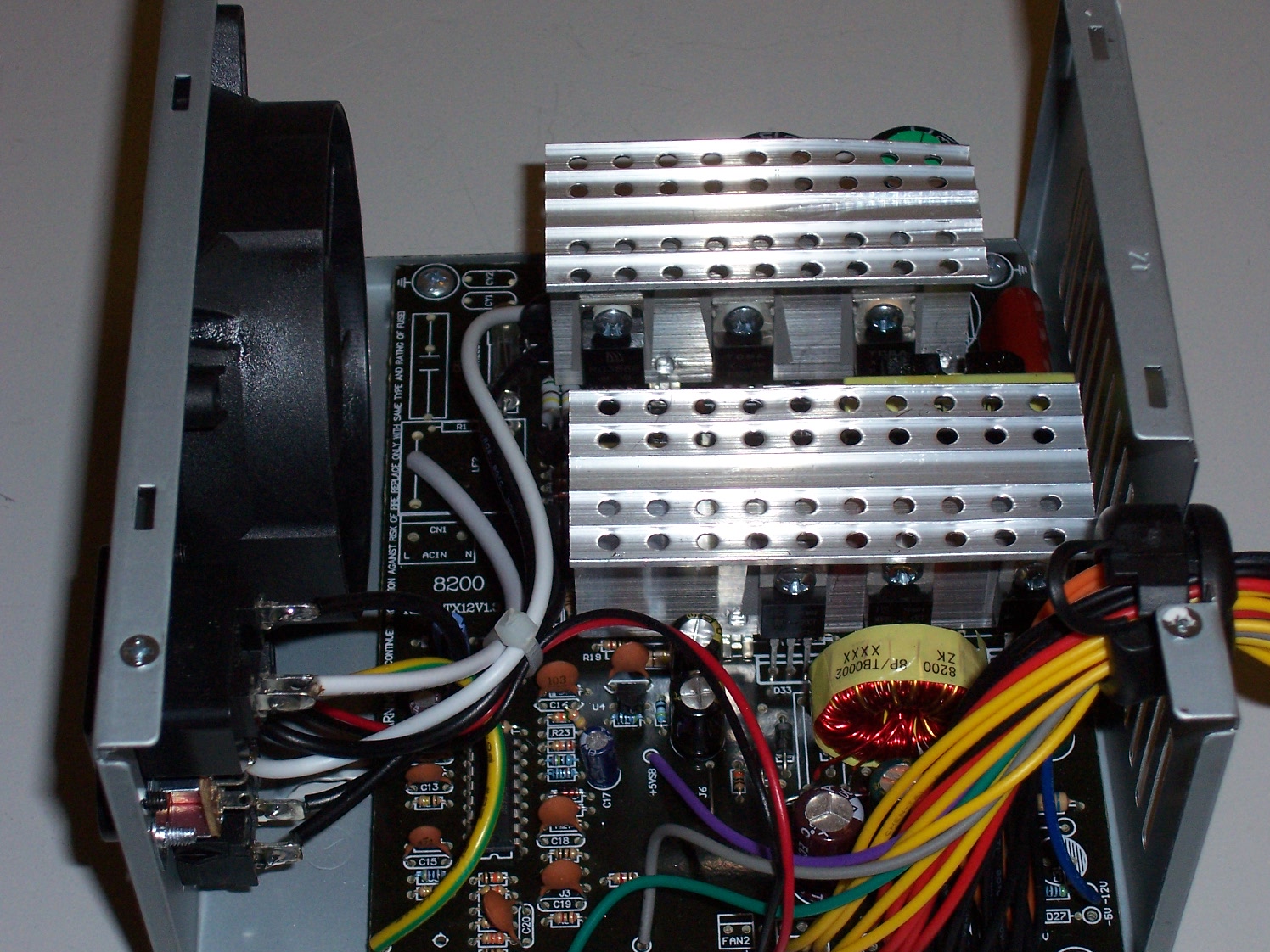

                          No, that's for driving the high side MOSFET. Looks like a dual switch forward converter.
                          One that's cheep enough to not have a dedicated highside driver IC.
                          Believe me, when the MOSFETs (yes, both) short, you'll lose the PWM IC- one MOSFET is directly connected.
                          The wire on the output inductors is way too small- clearly that thing's never been loaded to ~20A on +12.
                          Clearly a unit meant to be "dumped"- black and white line wires tells all. Whoever's behind that unit was thinking "there's nothing those suckers in the US won't fall for."

                            Haha. I have to say, though, that, Everall's Diablotek unit looks like it might have a bit of potential. It's a 2TF design, not a Half Bridge. It might even do 450 or 500W in spec. I have a Cooler Power GX850 which looks somewhat similar internally (although mine had a PPFC coil screwed to the back exhaust grill directly behind the secondary heatsink, which would cripple the airflow.

                              Wow, that thing might even be able to do 40A on the 12V if the rectifiers are good enough. I was expecting worse.

                                  I removed the pc board from the case and have been tracing the circuit. The primary winding of that transformer connects to the pwm chip U3843. Each of the two secondary windings of that transformer connects to a FET. Unless the transformer shorts (which is possible) the transformer provides isolation between the pwm chip and the MOSFET switching transistors.

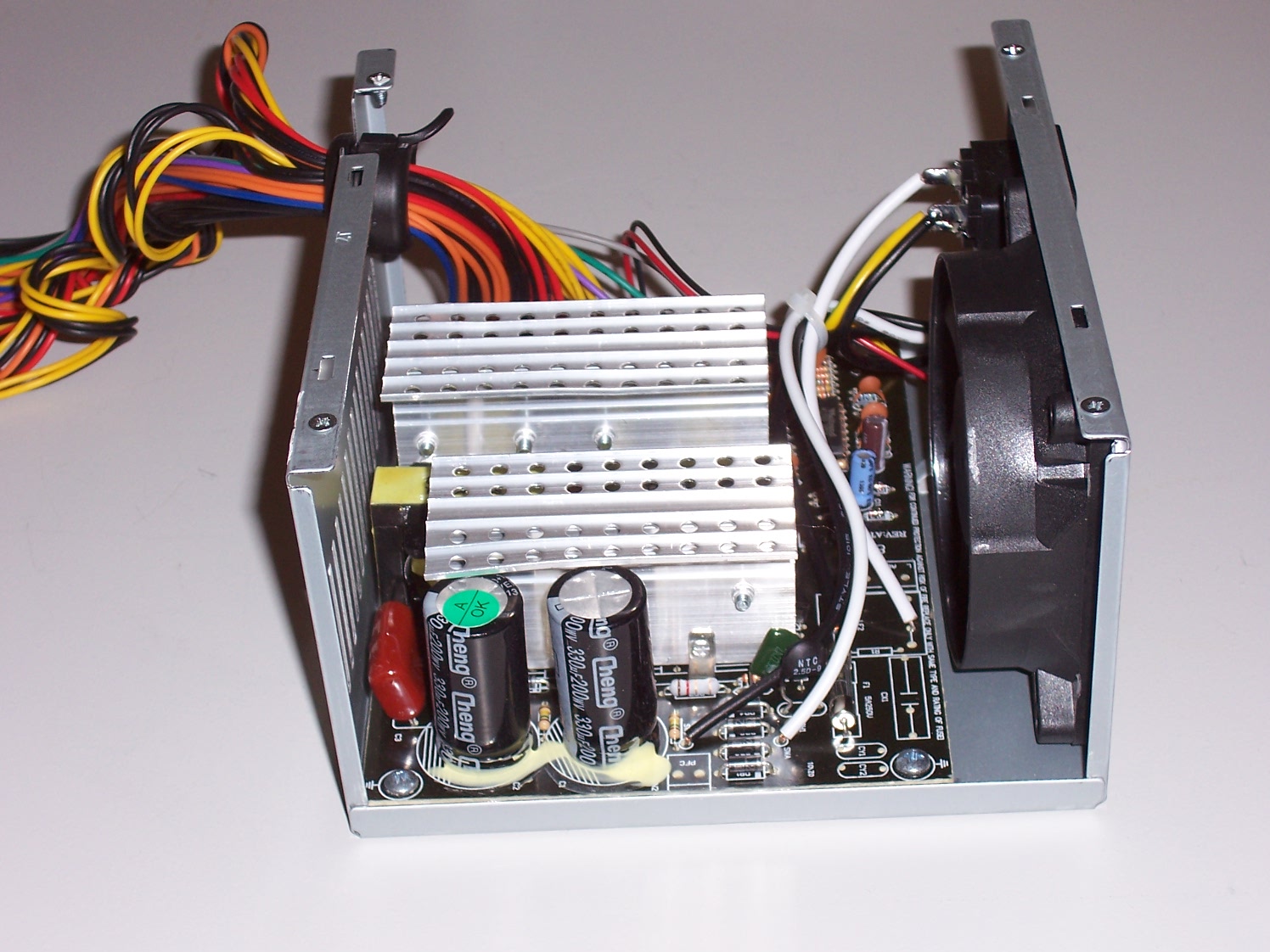

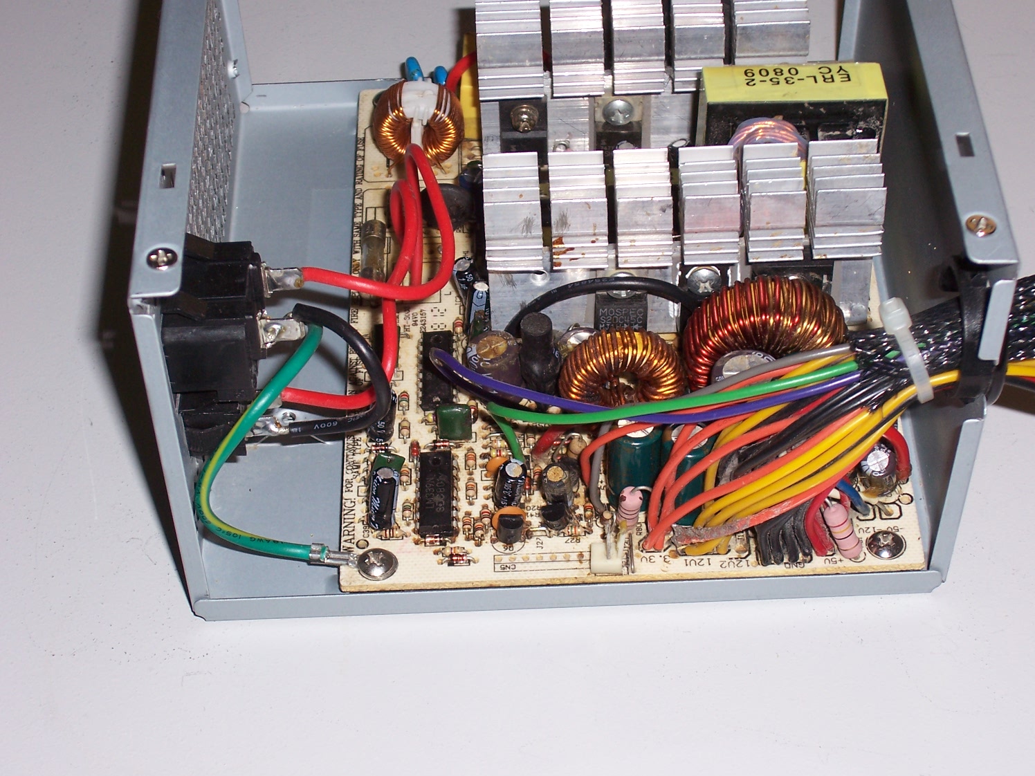

                                    This is why.....This one was made in October, 2013. The label claimed 450W. Only one cap per rail, even the 5VSB!!! First time I've ever seen that.
                                      That looks like a "cool" power supply. It has TWO fan connectors! It even has an IC for the 5vsb circuit. But like the IMicros, only one capacitor for each of the output rails, and no line interference filter. Probably light weight, much lighter than my Diablotek power supply. I would judge this one as pos, but the one I showed earlier has far greater potential.
