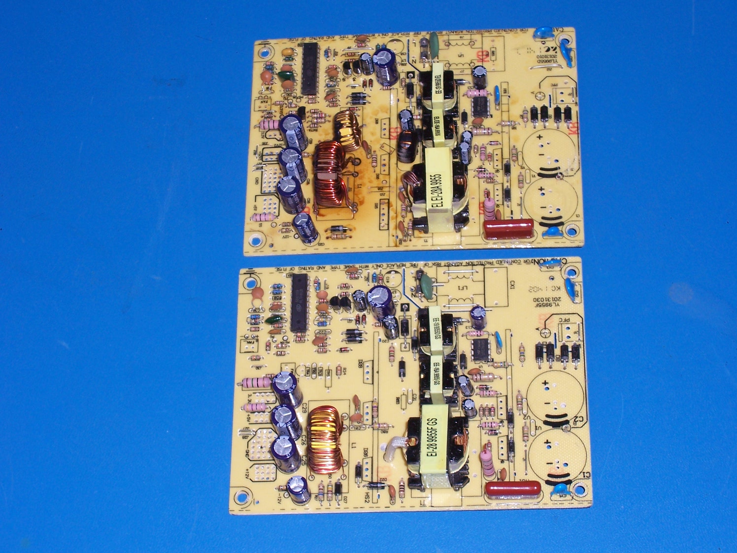

              Here are the circuit boards from two recent Coolmax V-400 power supplies. I took the wiring harness off and both heat sinks off so that we could see the difference in the circuit design. First and very impressive is that they have moved away from the old TL494/KA7500 design and moved to the SD6109 pwm chip. Next, the two transistor 5vsb design has given way to an integrated circuit UTC7608D, No line filter, and on one of the boards there are no jumper wires to wire around the line filter. This is because the circuit traces on the bottom of the pc board short out the filter! Obviously they never intended to have a primary filter. Four small diodes rather than a bridge, I could not make out the markings. The Main filter capacitors were Canicon 470 uF/200 volts measuring only about 70% of marked capacitance. The switching transistors were the same ole 13007. The output diodes were two S20C40C and a SFR12S20T. The output filter capacitors were (one per rail) AsiaX 1000Mfd/16 volts (12 volt rail, 5 volt rail, 3.3 volt rail, and 5vsb rail). And that line up will run 400 watts?????
              The top board had a heat problem. The fan was stuck! Notice that the color of the yellow painted group regulation toroid core has turned a light brown from the heat. The glue between it and the 3.3 volt coil has turned black. Also the white sleeving on the main switching transformer has turned brown from the heat.
              My guess is that it might hold 200 watts. So what do you think?

                i'm sure the missing filter is because it has a passive PFC choke.
                i'v got a few psu's like that - the filtering is moved to the back of the power inlet.
                • c_hegge
                  • Sep 2009
                  • 5219
                  Re: Coolmax V-500 quality power supply
                  It will probably manage 250W without blowing up, but with no PI coils and only one cap per rail, probably nothing in spec.

                    At least the pwm chip they are using, the SD6109, is a big improvement. Here is a data sheet on the SD6109.
