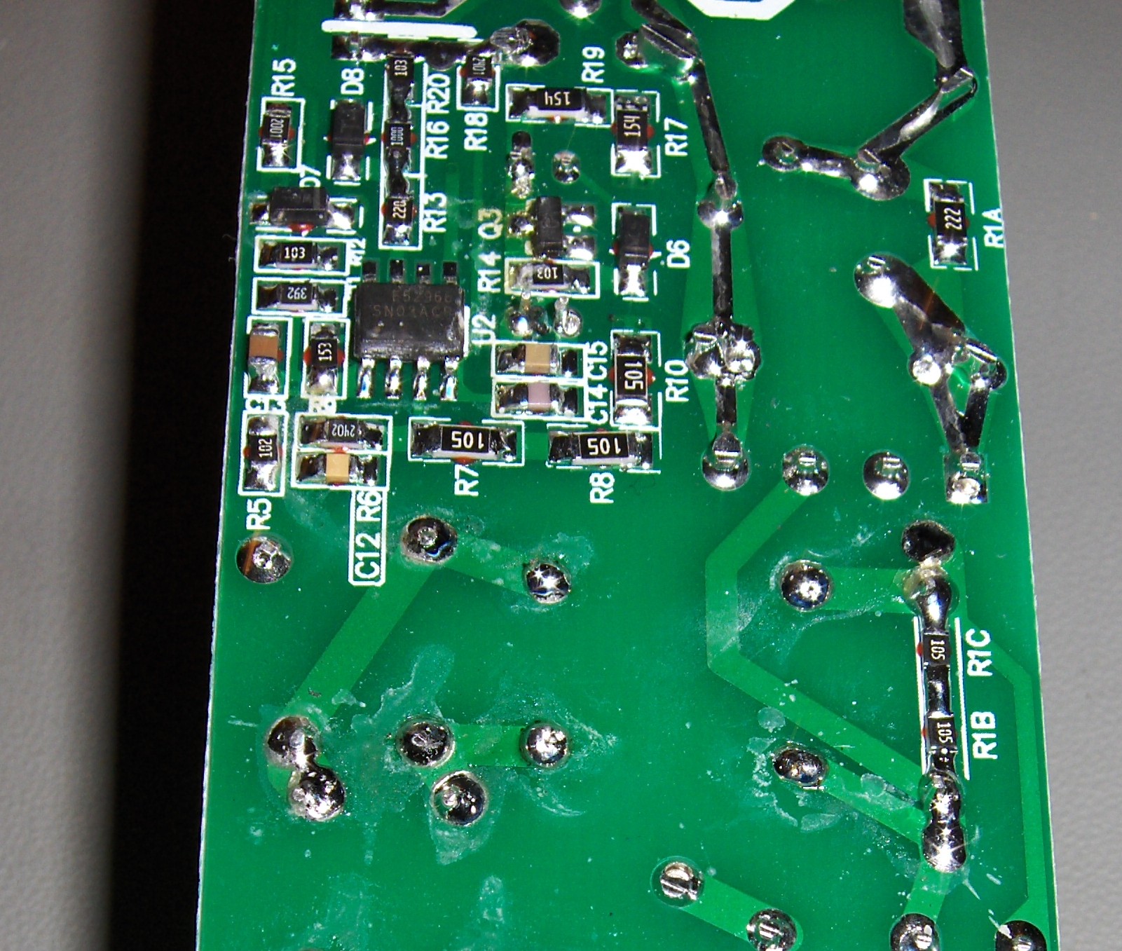

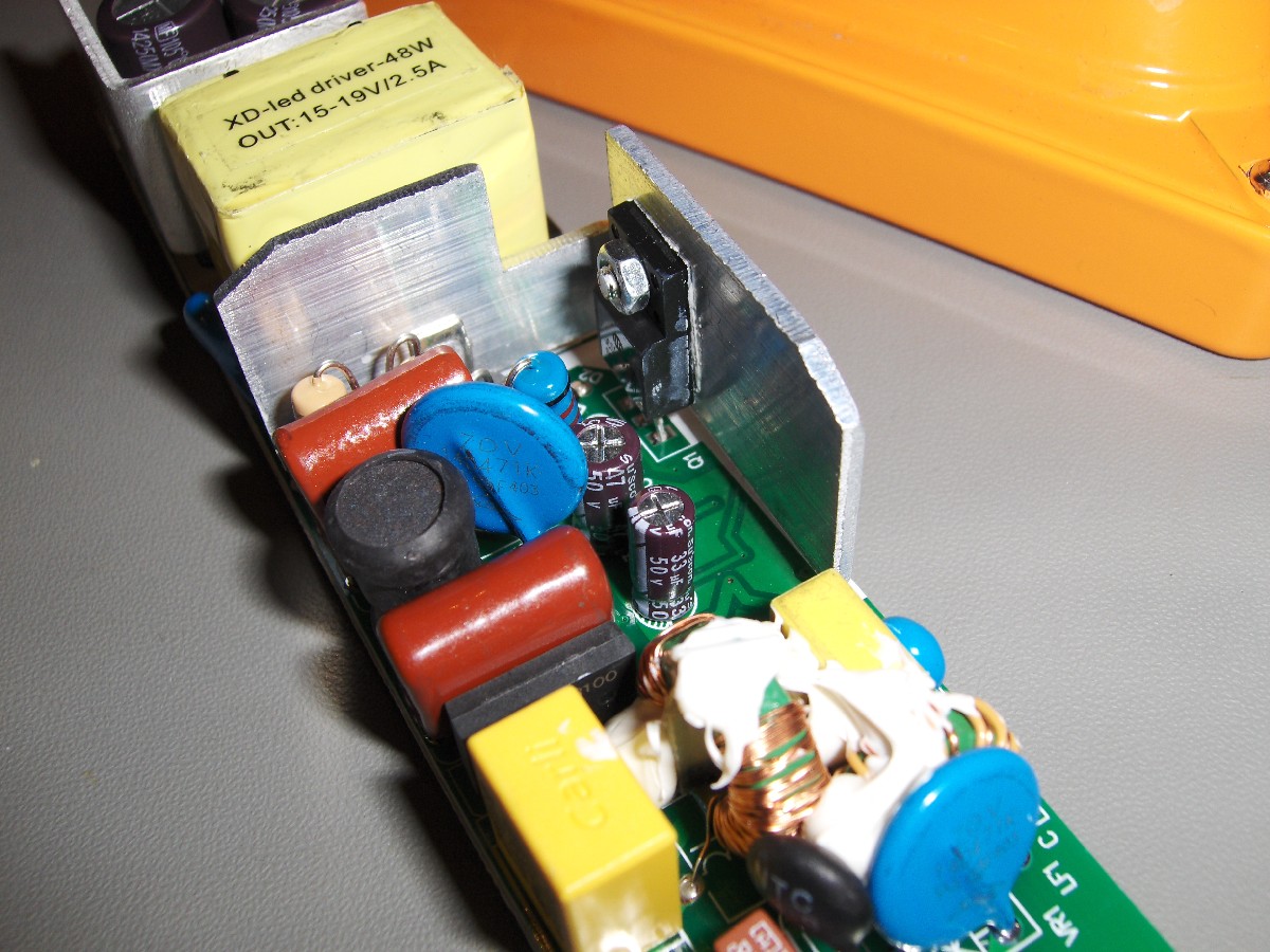

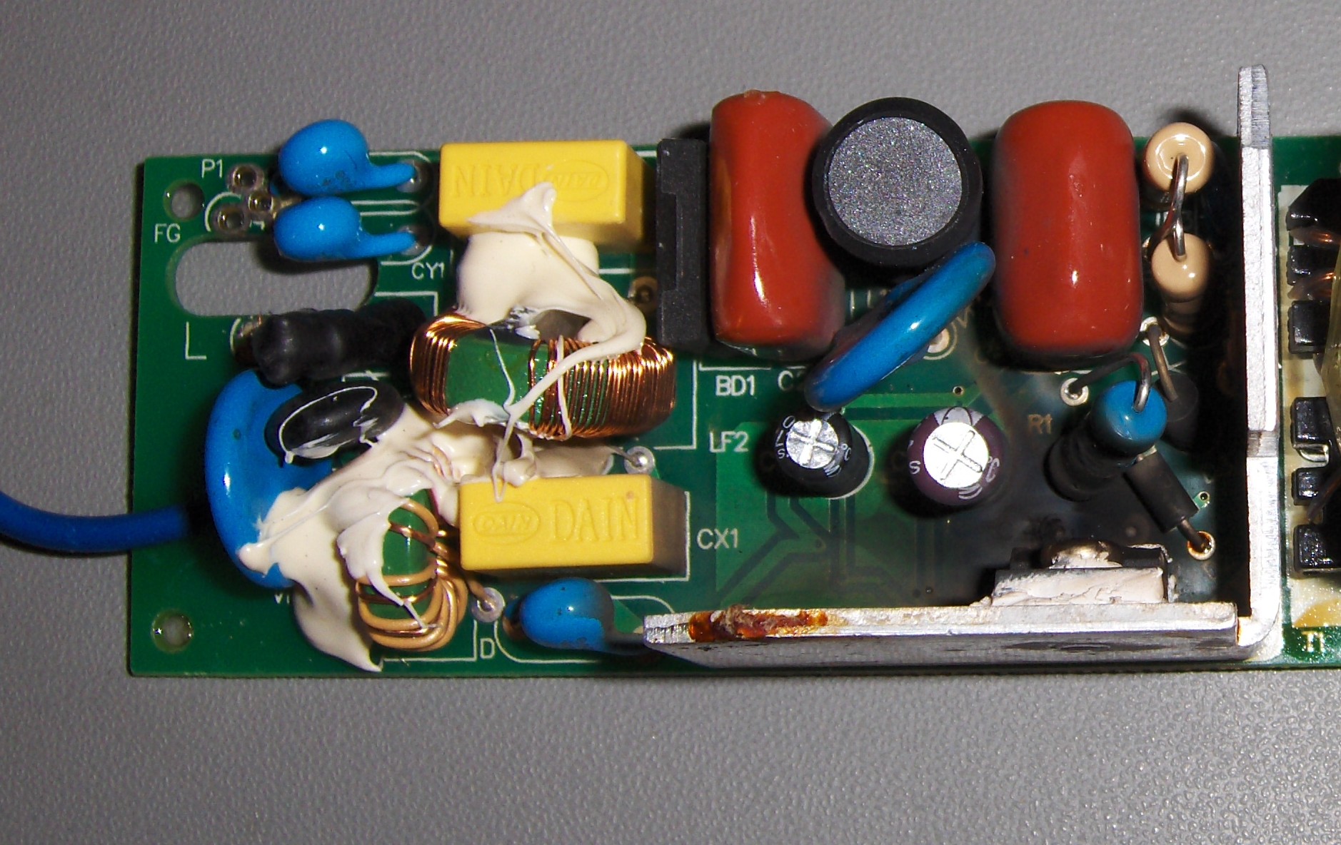

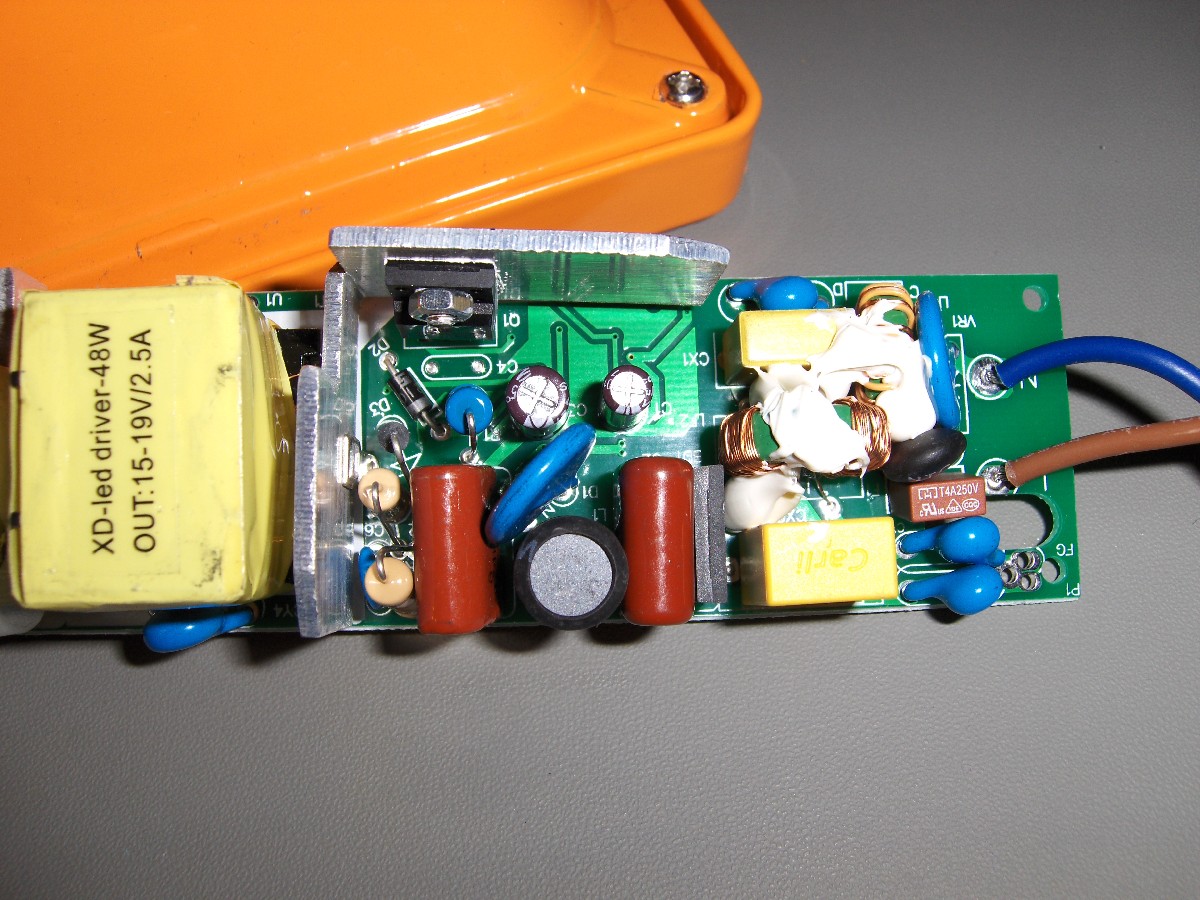

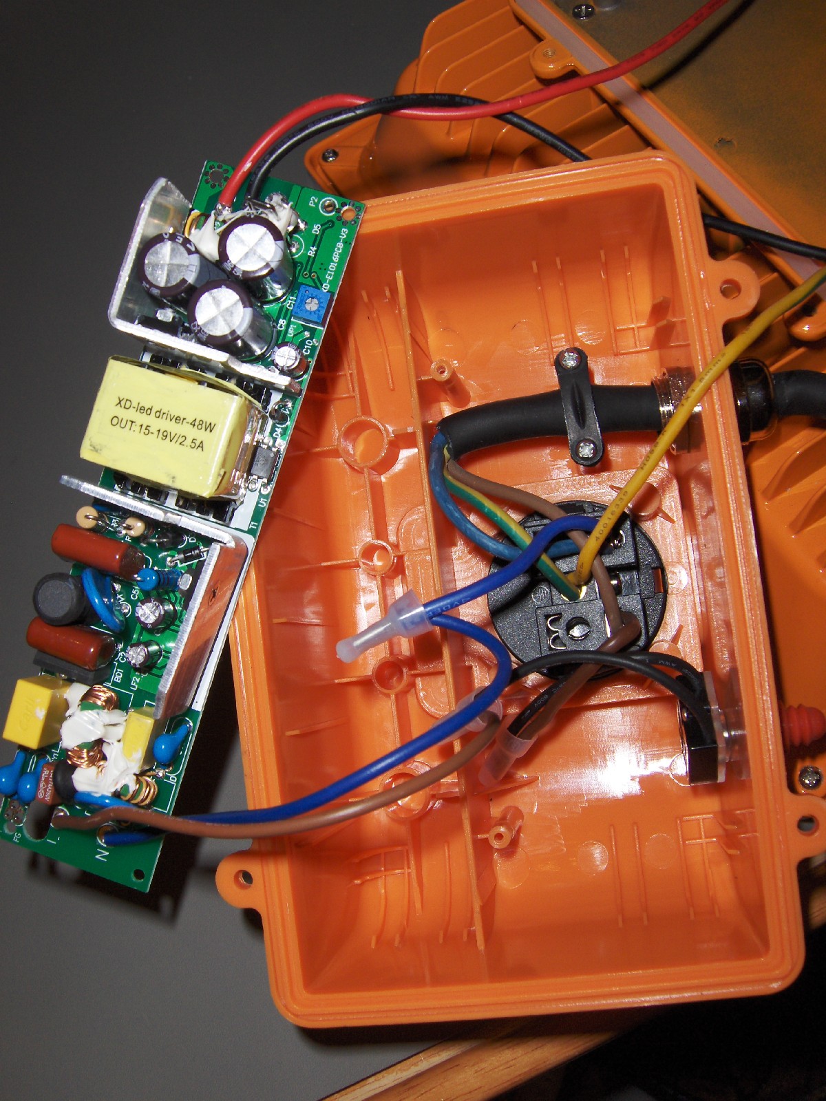

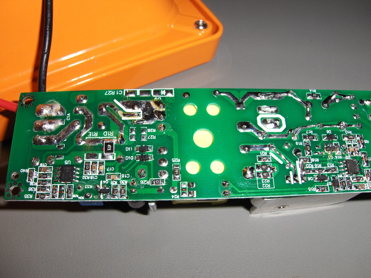

    Have this led lamp that works perfect fine in room temperature but wont light up outside in cold winter.
    Is this because of the startup capacitor is not made for cold enviroments ? startup cap are su'scon - see picture second last picture.
    Link to manufacturer site - Cob Led 50W

    Re: Led lamp - won't work in cold enviroment
    you probably answered your own question.
    the problem is electrolytics hate cold.
    you may have to increase the value.

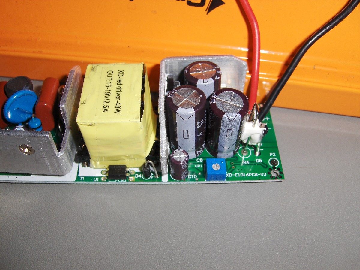

      Thanks for your answer - Are both the 47uF 50V and the 33uF 50V caps considered startup caps ?
        • 31246
        i dont know - your the one with the board!

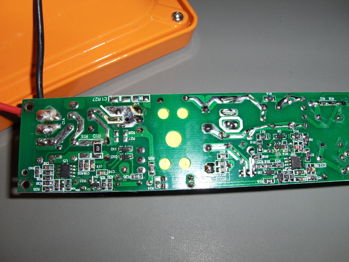

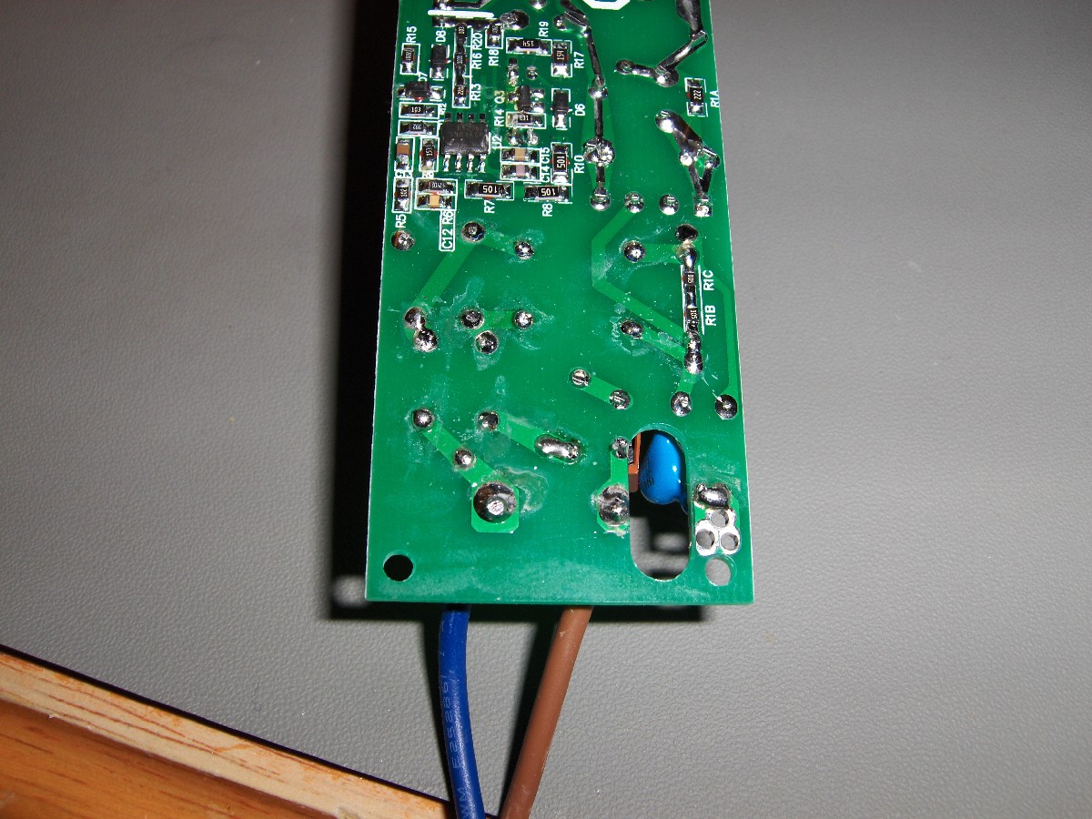

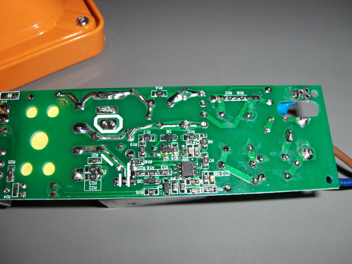

        i cant see a controller in the foto's - got any foto's of the other side?

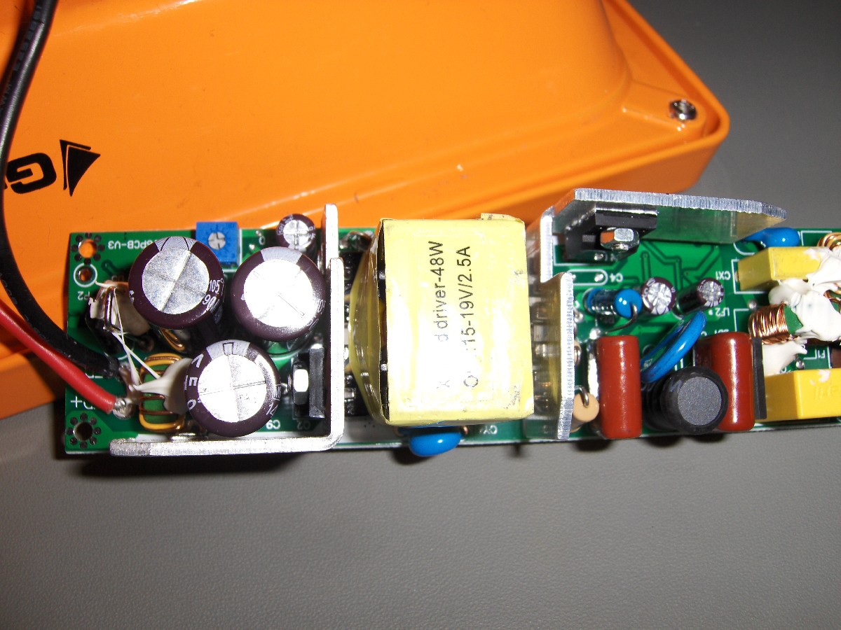

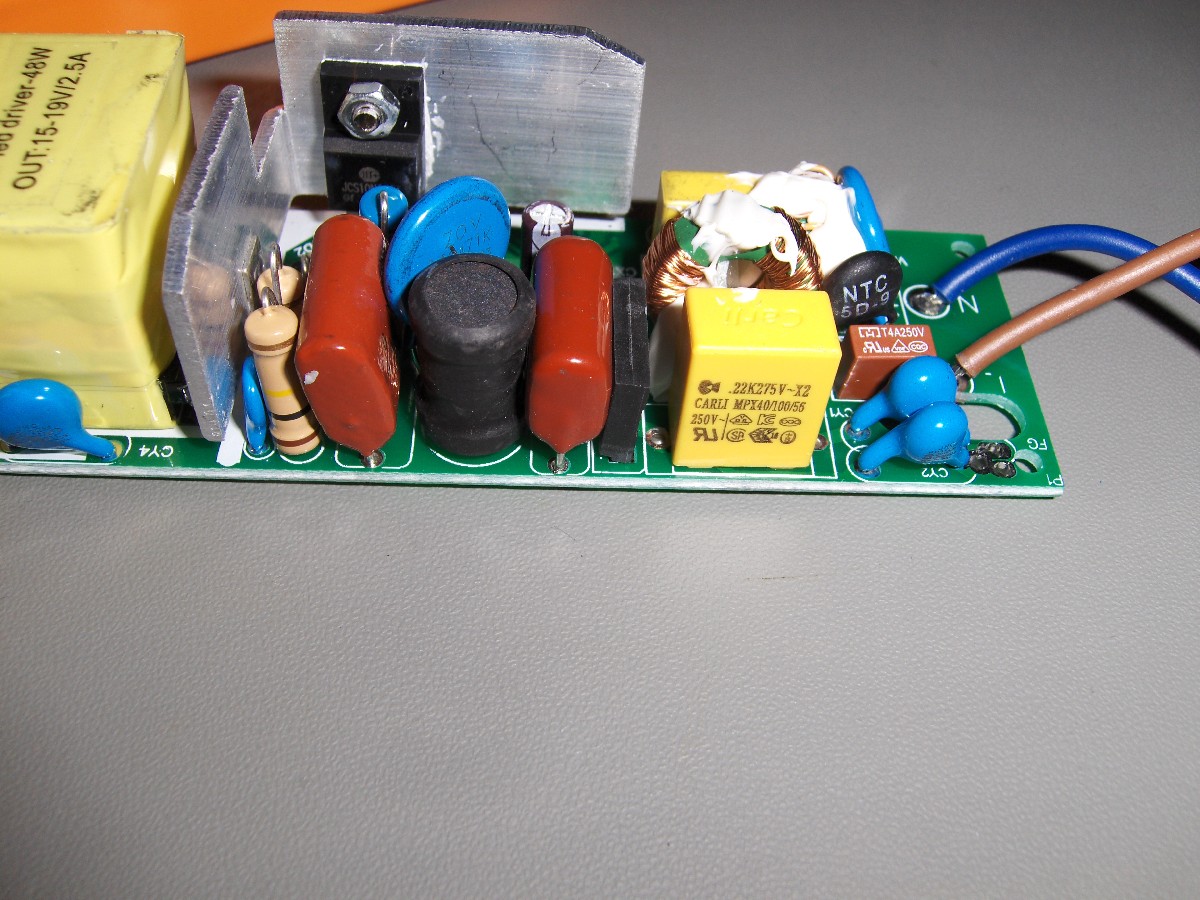

          I got a few pictures of the underside - looks like the 8 pin so on the primary side is marked F52966 but I can't be sure.
            ESR goes up when temperature goes down, and ESR goes down when temperature goes up.
            Caps are cheap, I would just recap it with good caps.
            There are two small caps (start/run caps) in the primary side close to Q1.
                I guess average at -2C to -5C, sometimes around 7.
                One of the lamps was dead at -1C or perhaps -2C.
                          They are normally stored in cold car or cold storage containers so I guess insulating them wont work.
                          I did have a look at fm datasheet and see they are rated for -40 to +105, I will try to recap one of the laps to see if cold start behavior changes.

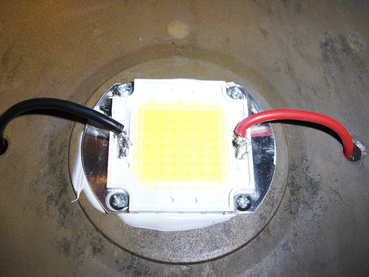

                              you should probably do a FULL recap, because if the others dont work, you could damage the led.
                                  Some sort of ceramic capacitor might help with the high ESR at low temp problem.
                                    Those suscons seem like SK, general purpose. Just use quality low-ESR caps, the ESR should be than similar to warm SKs even while being cold.

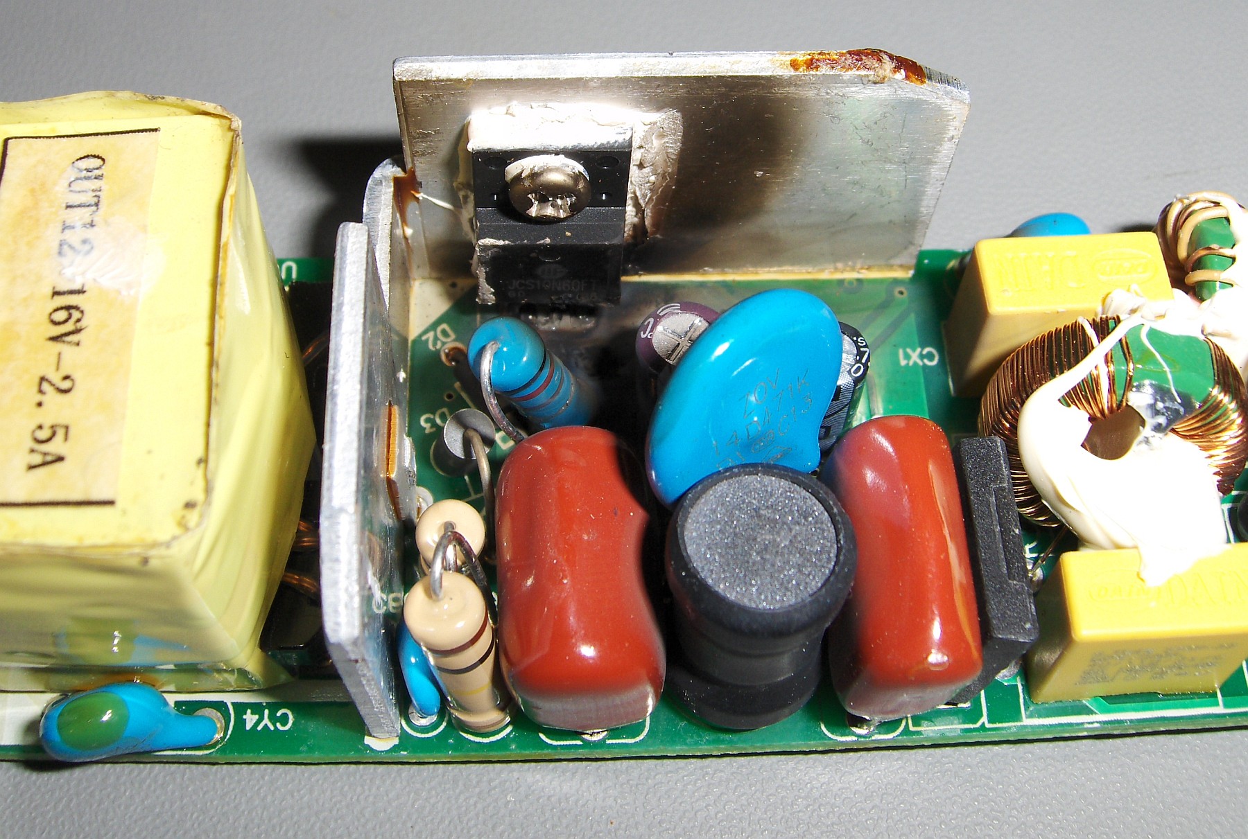

                                      if that is like one my neighbor put up last summer the caps are baked.
                                      his is a dim blue now.several rows of leds are out too.it runs too hot to touch.
