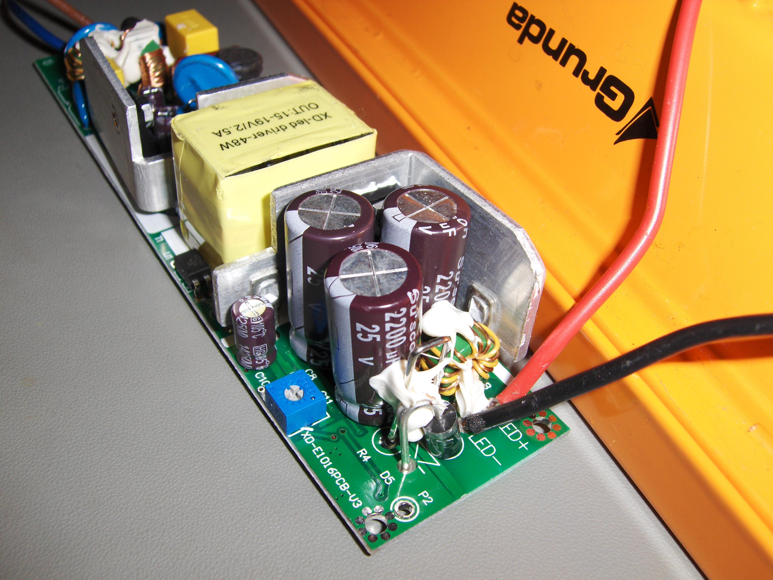

Led lamp - won't work in cold enviroment
  • Gabriel
    • Jan 2010
    • 620
    • Norway
    Re: Led lamp - won't work in cold enviroment
    Originally posted by kc8adu
    if that is like one my neighbor put up last summer the caps are baked.
    his is a dim blue now.several rows of leds are out too.it runs too hot to touch.
    No, had a few of these on for two hours and they get warm but you can still touch the housing just fine and even touch glass without fingers getting stuck.
                Winter is back and my led lamps is again not working.
                I replaced the Su'scon on the secondaryside with Kyb (-40) and the small startupcaps with Lza (-55).
                Still the lap won't turn on - it almost seems like the lamp with Su'scons turn itself on before the lamp with Kyb and Lza when brought inside and heated up.
                Any ideas ? perhaps I will try to modify with ceramic startupcaps and runcap but will that shorten other components life and what size would I aim for ?
                • ben7
                  Capaholic
                  • Jan 2011
                  • 4059

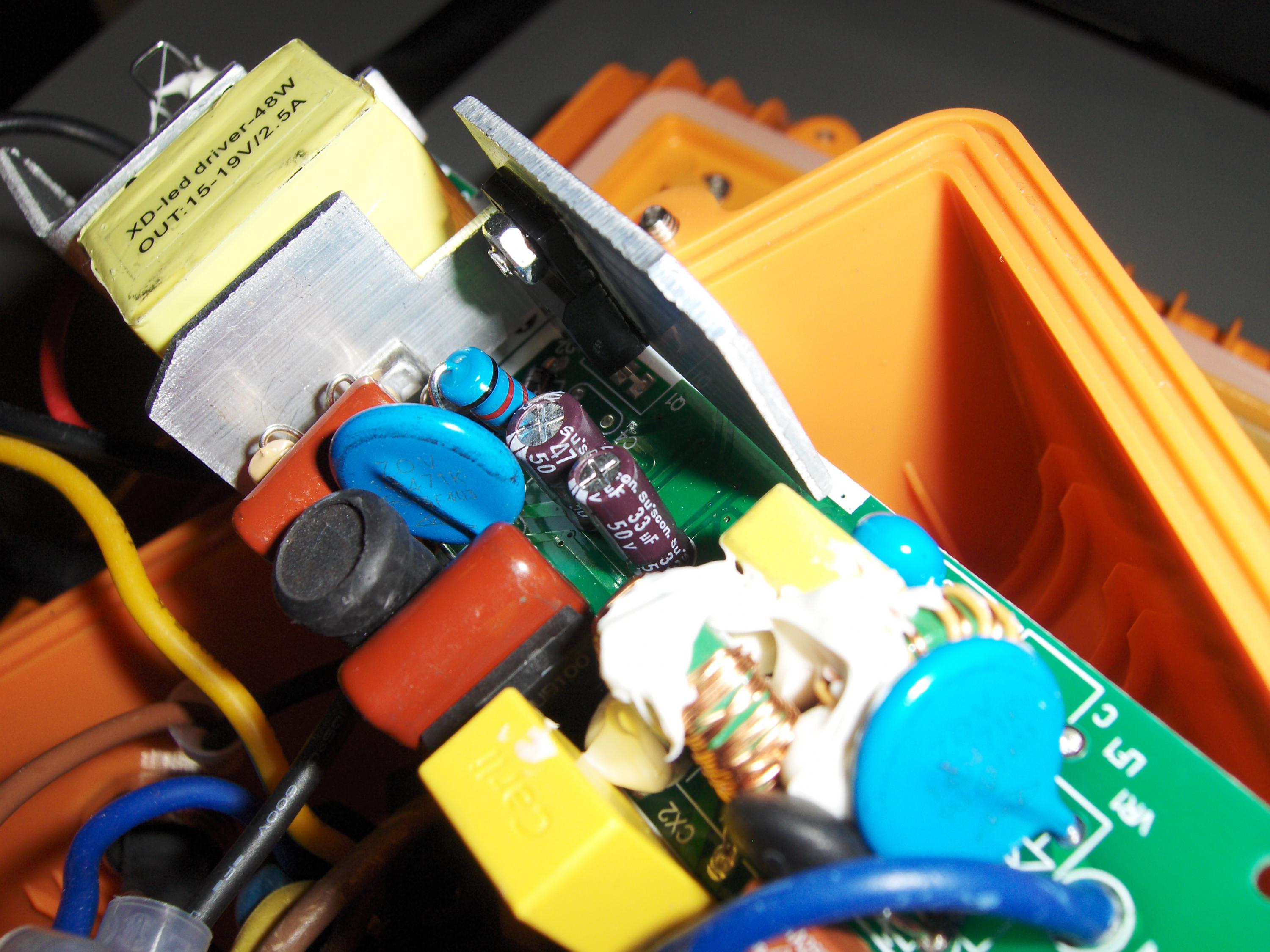

                  If you haven't already, check (when the driver is cold) to see if the PWM chip's VCC voltage is high enough. It might or might not still be a cap problem ... there ARE other parts which could go too far out of tolerance in the cold, my first thought would be resistors.
                  By the way, is it totally dead, or does it flash briefly and then not work?
                  Any little details like those can sometimes help!
                  -Ben
                  Muh-soggy-knee
                  • Gabriel
                    • Jan 2010
                    • 620
                    • Norway
                    #29
                    Ah I thought the caps were the only problem in the cold, don't have the lamps here right now but I will see if I figure out the vcc voltage.
                    No, the laps is completely lifeless, no flash or anything like that.
                    I wonder how cars manage to start in icecold, resistors and caps in the ecu's should suffer from the same problem as this laps does.

                      #30
                      Practically everything is affected by temperature in some way. Some more than others though!
                      Another idea is that the LED COB itself might require too high of a forward voltage when cold, which is causing the driver to not work. (I would think this would result in the lamp flashing for a brief moment though, which you say it is not.)
                      Well it's possible this power supply wasn't designed with low temperatures in mind. I know they take that into consideration most of the time these days when designing cars. Also, modern cars are better at starting their engine when cold because of better alloys, which will help keep enough compression to start it when it's very cold (the pistons shrink slightly in the cold).
                      (Also there are other things, like oil flow and what not. Our Toyota Sienna minivan is noisy when cold, the engine sound is more like a diesel ... it goes back to normal once it warms up enough and the oil flows where it needs to go. Apparently it is normal for the 2GR engines. (The 2GR engines are decent engines by the way.))
                      -Ben

                        #31
                        yes find datasheet for the chip.make sure its supply is well above uvlo.
                        could be just on the edge.

                          #32
                          also check output voltage from working vs not working
                          that PS could be working, but Vo setpoint may be too low for some reason (resistors?) and too low to overcome the Vf of the cheap LED array- itself having higher Vf at low temps

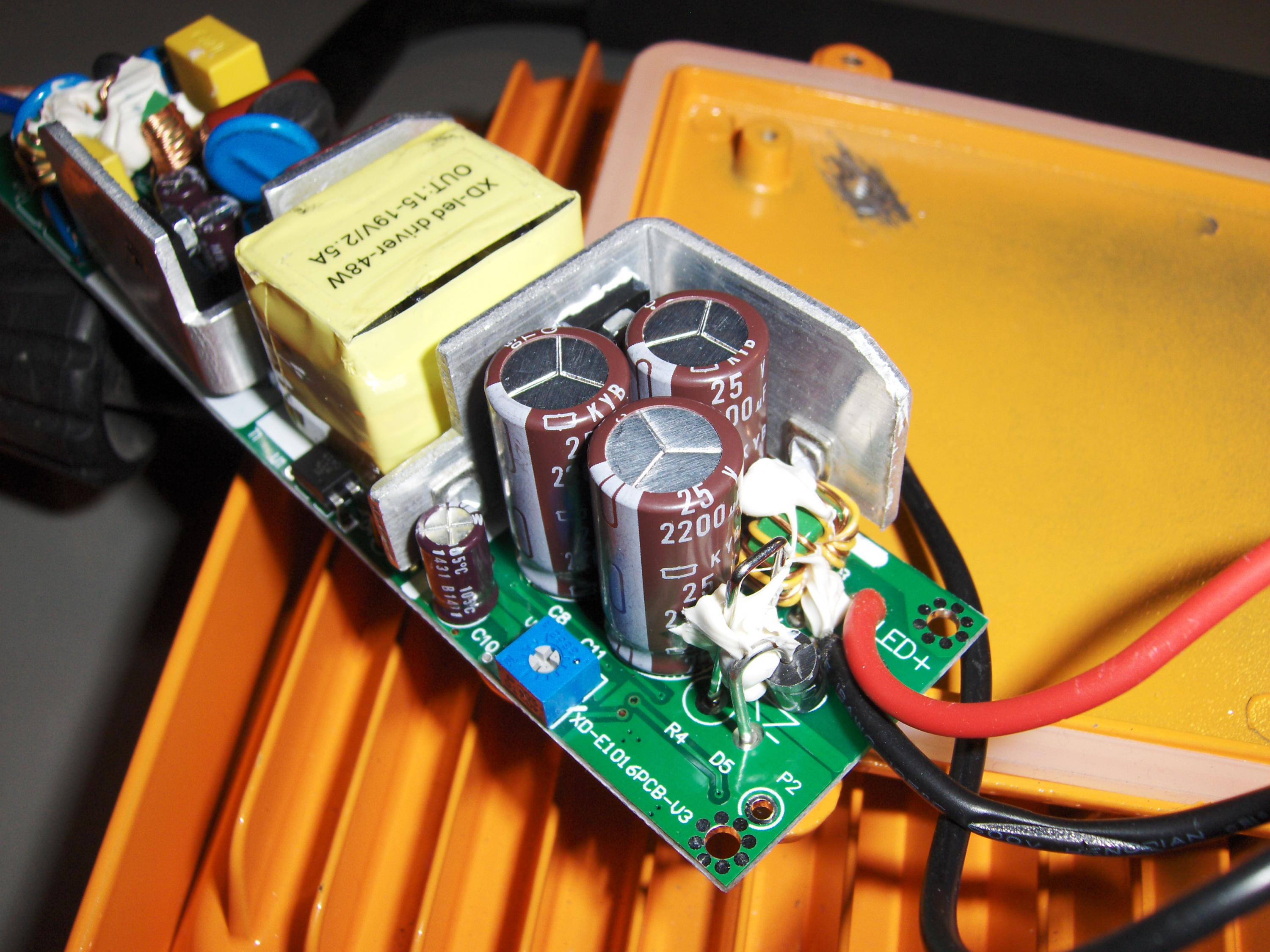

                            You probably don't want to use aqueous electrolytics (ultra-low ESRs) in which the water is likely to freeze. Older non-aqueous electrolytics like NCC LXV/LXY/LXZ or Nichicon PJ/PW or Panasonic FC, etc. should be OK. Most modern electrolytics are aqueous for various regulatory, compliance and competitive reasons.
                              • 31246
                              #34
                              they wont freeze because of the salts,
                              most are rated down to -55'
                              • Behemot
                                • 4845
                                • CZ
                                #35
                                Most are -40 actually (the oil lytes are -55), but still more than enough.
                                • imp
                                  • Aug 2010
                                  • 125
                                  • Sweden
                                  #36

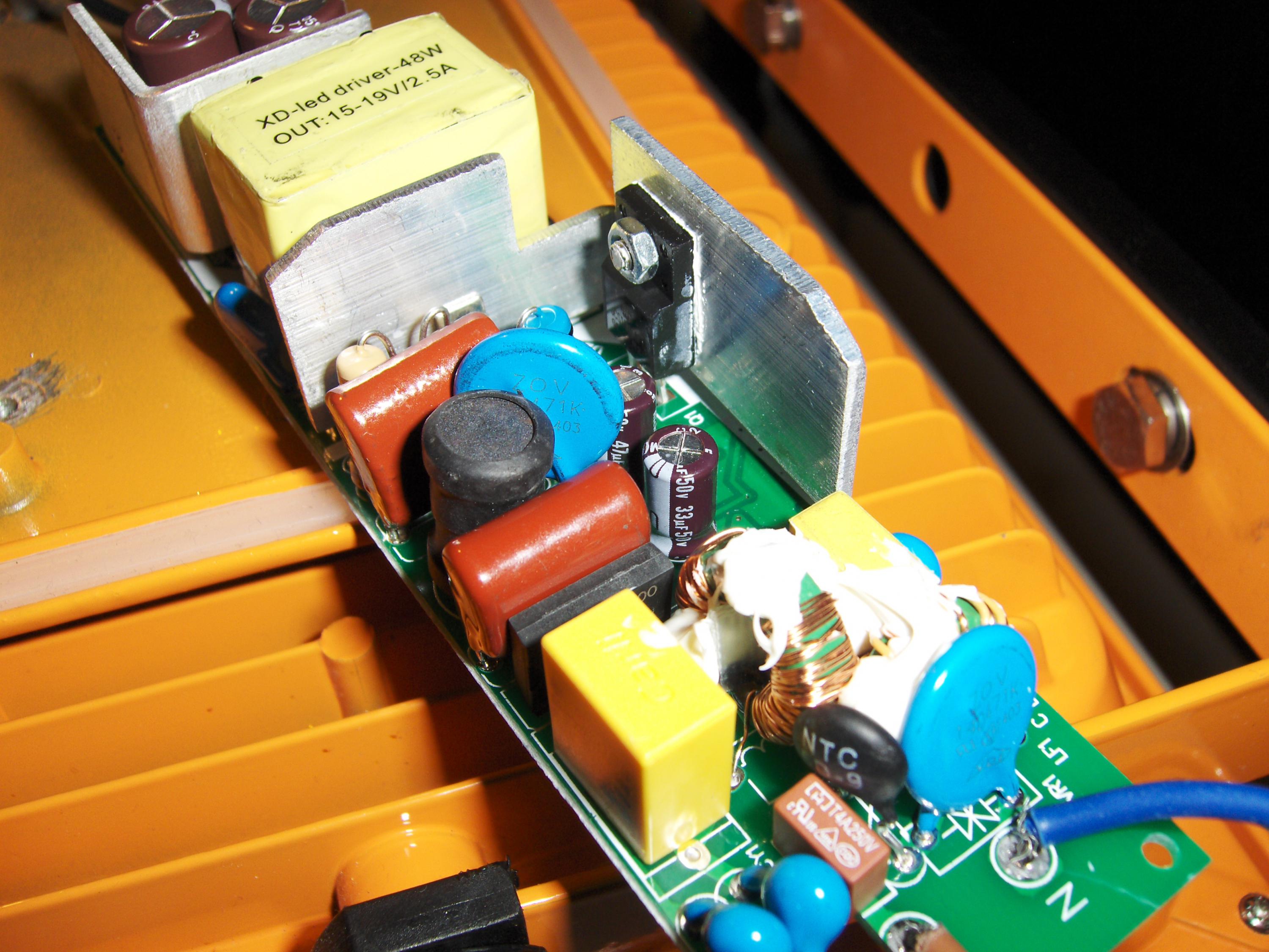

                                  Could it be because of an inrush current limiter (NTC) that never gets warm enough to pass enough current through?
                                  • Behemot
                                    • 4845
                                    • CZ
                                    #37
                                    At 230 V even if the thermistor had 10 ohm all the time that still gives you 23 A at slightly lower voltage. At such situation it woulf off course heat so much it would drop the resistance immediatelly. This thing should take quarter an amp on average.
