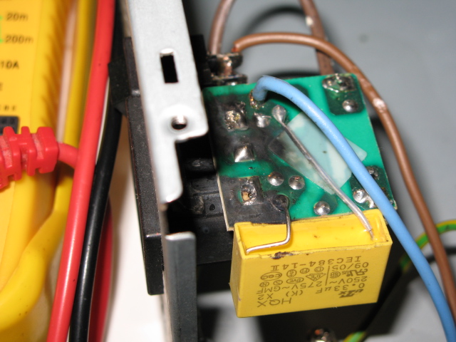

        Re: Truepower 2.0 recap and repair

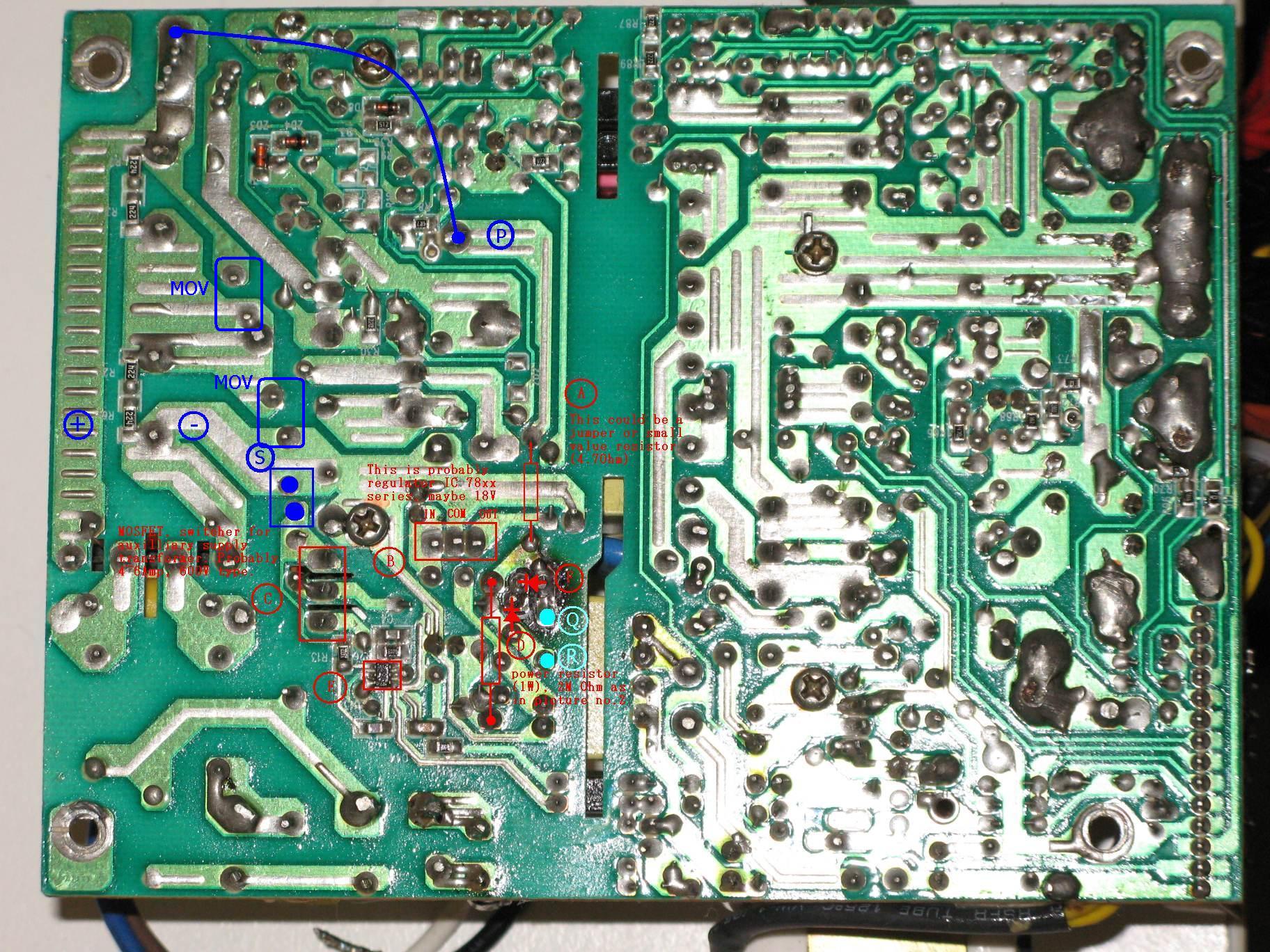

        you can see here where the two probe points contacted the PCB. the tips of both my probes look like abused soldering iron tips I've cleaned them up with some flux and removed the solder that was baked on.
        You can see there the ends of the power cable I butchered to run a nice long ~1m length from the input circuitry to the actual PSU PCB, so i don't have to keep the board in the case if i want to do live testing (which i really don't). I'll get stuck back into it tonight i think, first order of business is to replace the solder I've burnt there.

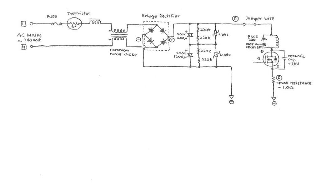

          huh... dealing with AC mains can be very dangerous !

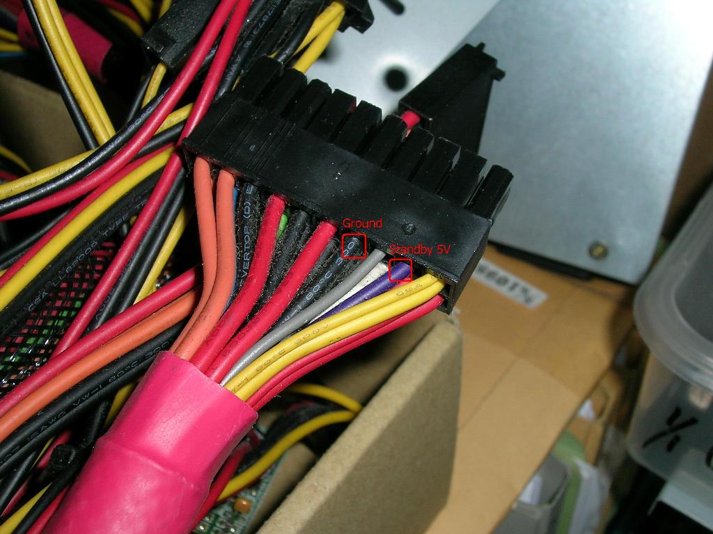

          well, Kane... here are some advices from me.
          (1) The purple color wire on the 20-pin / 24-pin connector carries standby 5V voltage.
          From ur pictures, point (P) is connected to (+) by black color wire on the top side. Point (P) which is the the (+) from bridge rectifier is connected to the transformer winding (Q)(R). Point (R) goes to the Drain of MOSFET (C). The Source of MOSFET (C) connect to (-) via a small resistance (S).
          Pls refer to the attached pictures.
          Now, could u pls check the resistance of few points (in the absent of AC mains).
          (1) Fuse - make sure not blown
          (2) Thermistor - should give low resistance reading
          (3) Transformer winding (Q)(R) - should read few ohms (not open circuit)
          (4) Resistor (S) - Pls check the color code, should be ~1 Ohm (not open circuit)
          (5) MOVs - make sure both MOVs are not short-circuit.
          To check MOSFET (C), u do not need to remove the transistor. U can use solder wick to clean the solder so that the pin is disconnected from the copper pad. Pls see below pic.
          (6) MOSFET (C) - diode test between Drain and Source. make sure not short circuit, and the built-in protection diode is OK. Check Drain-Gate and Gate-Source as well. Datasheet for 4N60B:

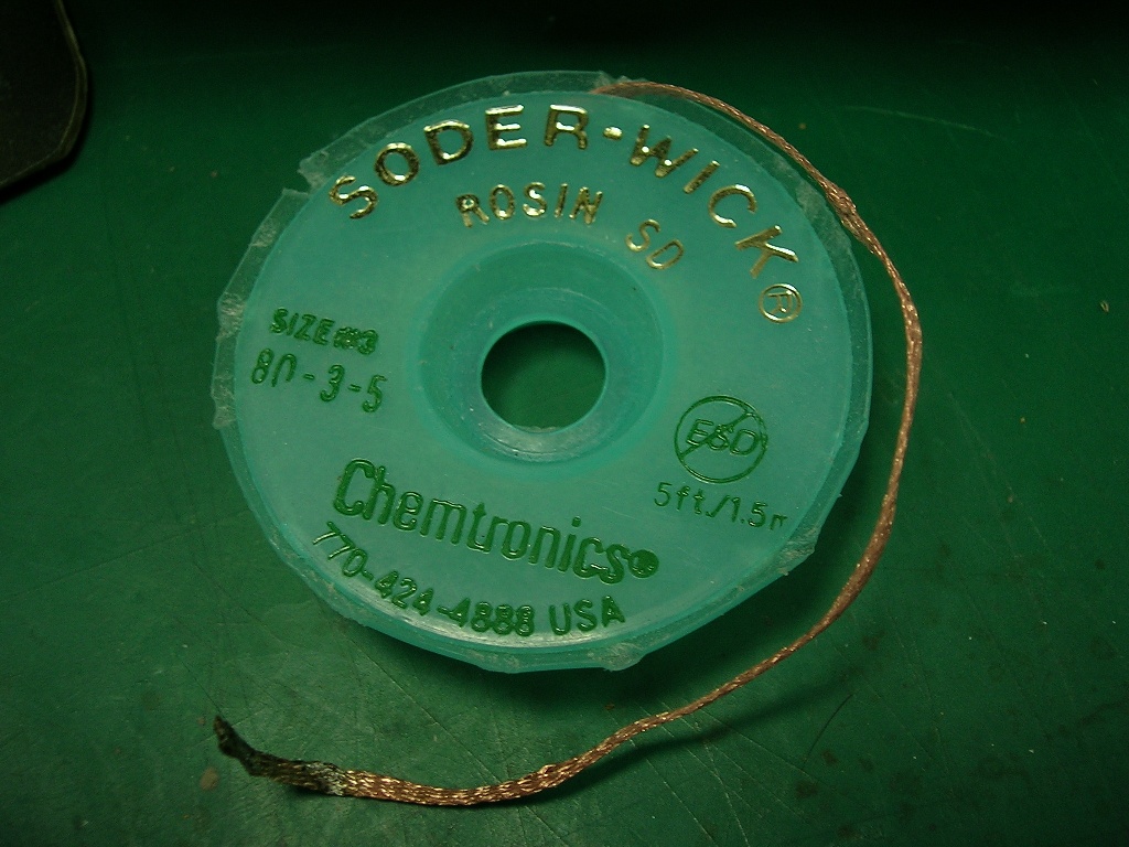

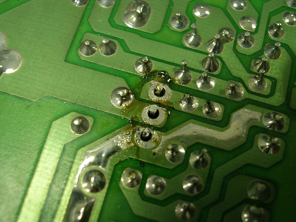

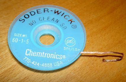

            Wow, sorry to go off topic but what desolder braid did you use?
            The ones I've tried never do a thing, that's a really clean desolder job!
              See the flux left behind in that picture, if your desoldering braid won't pick up the solder very well, try putting some flux on it first, it can help a lot. If that doesn't help enough you may need a hotter iron or cleaner tip.
                It is "Solder Wick" from Chemtronics USA (the right most picture).
                  Ok, thnx, this is the thing I've been trying without much success
                  Guess I'm just doing it wrong
                    Hmm... yours is SOLDER WICK - no clean SD
                    http://www.chemtronics.com/products/product.asp?id=230
                    I am using SOLDER WICK - ROSIN SD
                    http://www.chemtronics.com/products/product.asp?id=233
                    This one performs much better as it has rosin flux... U can try it out.

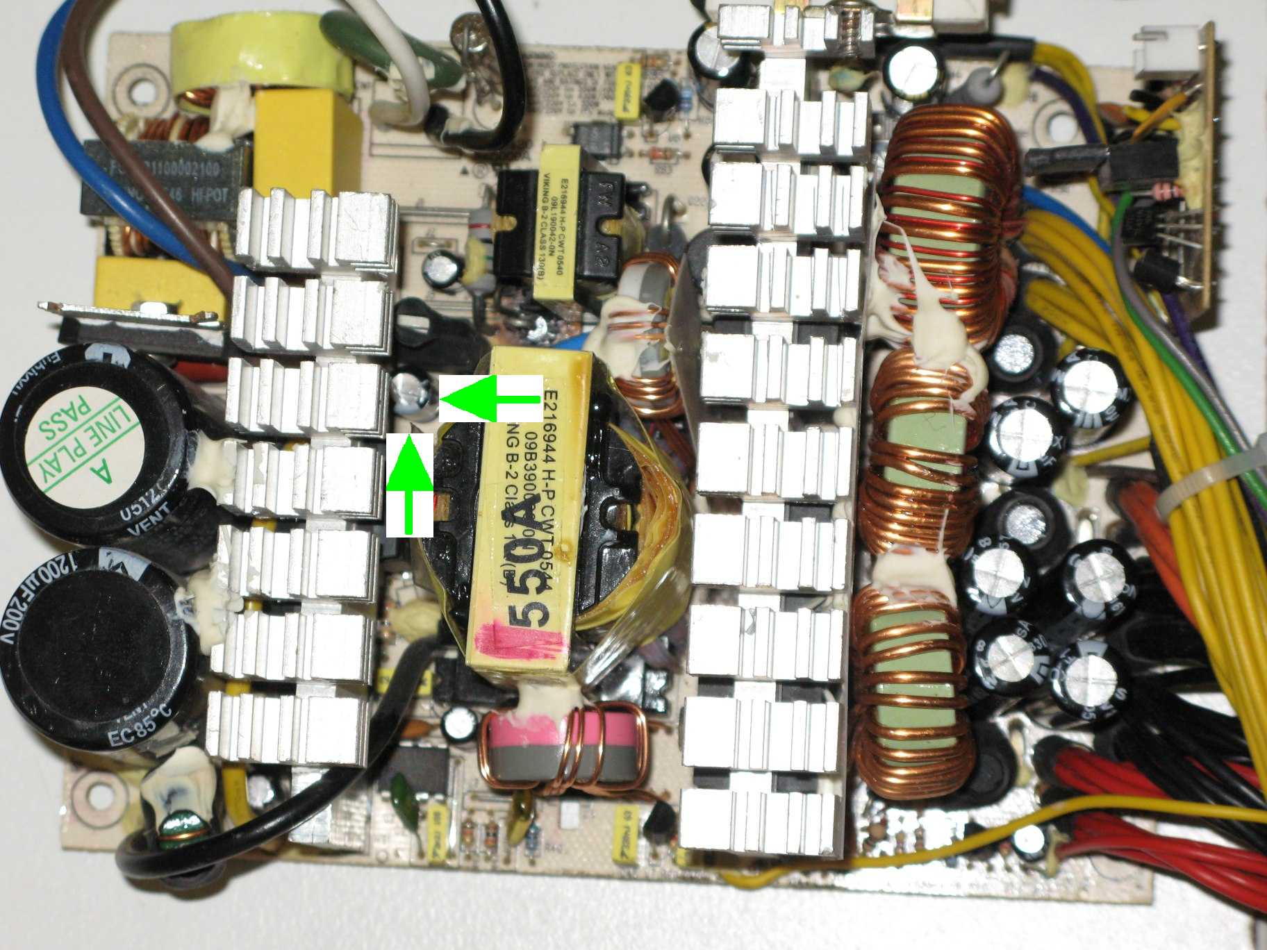

                        Kaine (or anyone)
                        Were you able to see what this cap is?
                          This cap.
                          Attachment didn't stick last time.

                            Originally posted by PCBONEZ
                            This cap.
                            47uF 35V if i'm reading it correctly. Replaced Koshin with a Rubycon YXF.

                            • Kaine
                              • Mar 2007
                              • 55
                              #54
                              (B) is closed circuit on in->out pins, no connection from COM to in or out.
                              (C) doesn't have continuity between any pins.
                              Resistor (S) reads as 2.2ohm (too color blind to read the code in place, removed and tested with multi)
                              Transformer winding QR reads 1.8ohm
                              Neither MOVs are closed circuit. Here's hoping they aren't polarized, I can't be sure I put them back in the same way I took em out. Had to remove a primary cap to get at the little buggers too.

                                  OK Quick update, (C) is positive VRM L7812CV
                                  Here's a quick diagram I did that illustrates the results of the continuity tests I did. Can someone tell me if this is right? I can't really glean from the datasheet what the results should look like.
