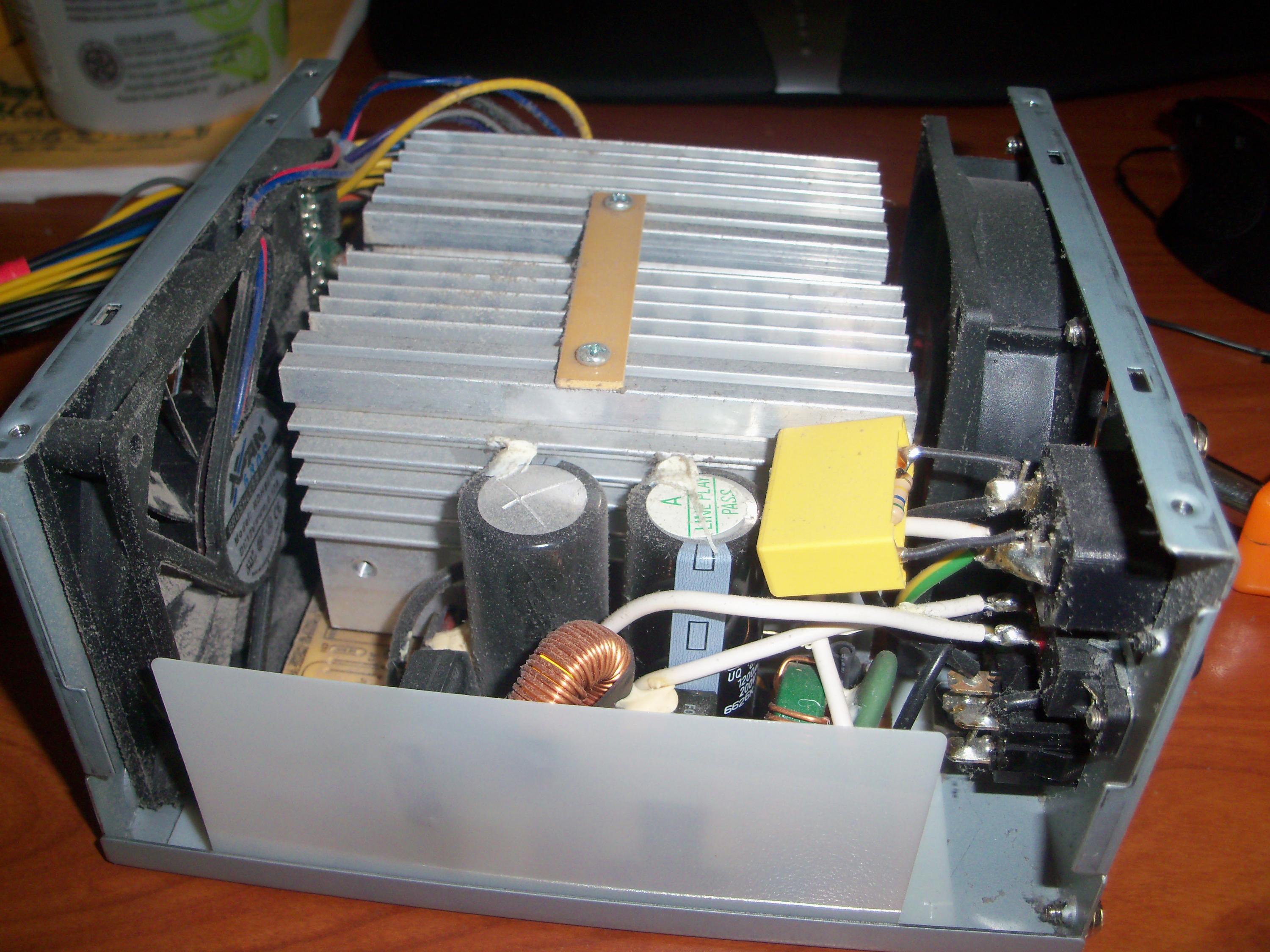

    This PSU was installed in 2006 on a small business server that has been running 24/7 for the last 7 years before the Server would no longer power on. Replaced the Antec and the Server operates normally.

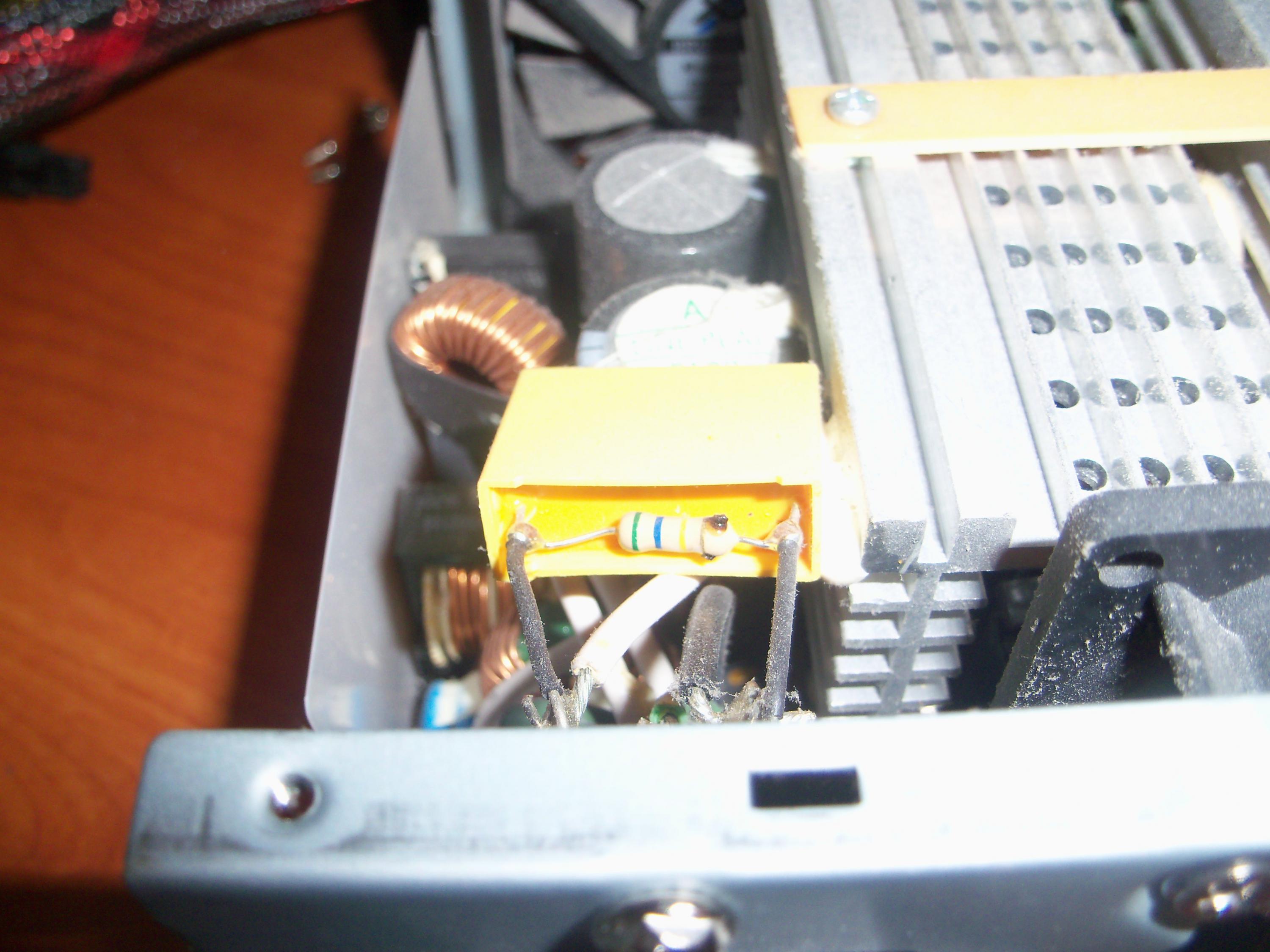

    Visual inspection shows 2 things. 1) There's a small resistor that seems to connect the ground & hot of the 120VAC, that is burnt, and one of the large, (what other threads have called) "filter capacitors", is bulging (but not leaking). I assume both of these will need to be replaced. I have an OCZ that I've gone "maximum" on, and have desoldered every single cap and plan on replacing each of them, but on this Antec I'd like to go "minimum" in order be able to compare the difference between "good enough" and "best possible", so if there's any way to avoid replacing any capacitors that do not need immediate replacement, I'd like to do it that way and see how long the repair lasts.
    Questions:
    What is the purpose of the burnt resistor? Could it alone cause the problem of the Server failing to start on "power on"? (No fans spin, no clicks, no bios beeps, no HD spin, no nothing).
    Could the bulging capacitor cause the no-start problem?
    If no to both of these, what is the most likely explanation for the problem?
    Is the big yellow rectangle next to the burnt resistor a "start" capacitor? Or what?
    Thanks in advance, and any help appreciated.

    Re: Antec SP-500 Burned Resistor and Big Bulging Caps
    That resistor is there to discharge the yellow X Cap (which is for EMI filtering) to make sure you can't electrocute yourself by touching the pins on the AC receptacle after you unplug the power cable. It has no effect, however, on how the unit functions and is not the cause of your problem. It could be the bad primary caps, but chances are, just about every cap in that PSU has failed. It's very rare than one of these lasts longer than 3 years without bad caps. Do NOT do a minimal repair on it. Give it a complete recap now, or you will have to keep doing it.
    Another good idea on these is to put a 2.5K resistor in parallel with the fan control thermistor. The fact that the fans run so slow on these units is a big part of the problem.
        Yellow X Cap looks OK . Use 1M ohms instead of 560K . Your one of the filter capacitor is bulged . You have to change that filter capacitor (changing both capacitor will be better) . There are two resistors value may be 150K or 220K or 330K parallel connected with those filter capacitors . This Filter capacitor bulged due to damage of one of the resistor . You have to check those resistor and replace them also .
        By the way - Is there +5VSB present on the PSU ??
          Likely a faulty fan controller that caused Kentucky-fried caps!!
          (My SmartPower 500 W) (Even when this looks like an earlier revision) had a faulty fan controller it just randomly stopped turning on one of the fans.
              Yeah basically if you loose the ability to balance the caps, one may get higher voltage than 200 V and in time it will fail. If the difference gets too high, it can be pretty fast…
                              Originally posted by Pentium4
                              Ahhh. So this is how SmartPowers find a way to kill Panasonic primaries
                              If I recall, I think you were the one who had a problem with primary caps failing on a PSU. It was because of an open-circuited resistor (As Escort Eagle said)
