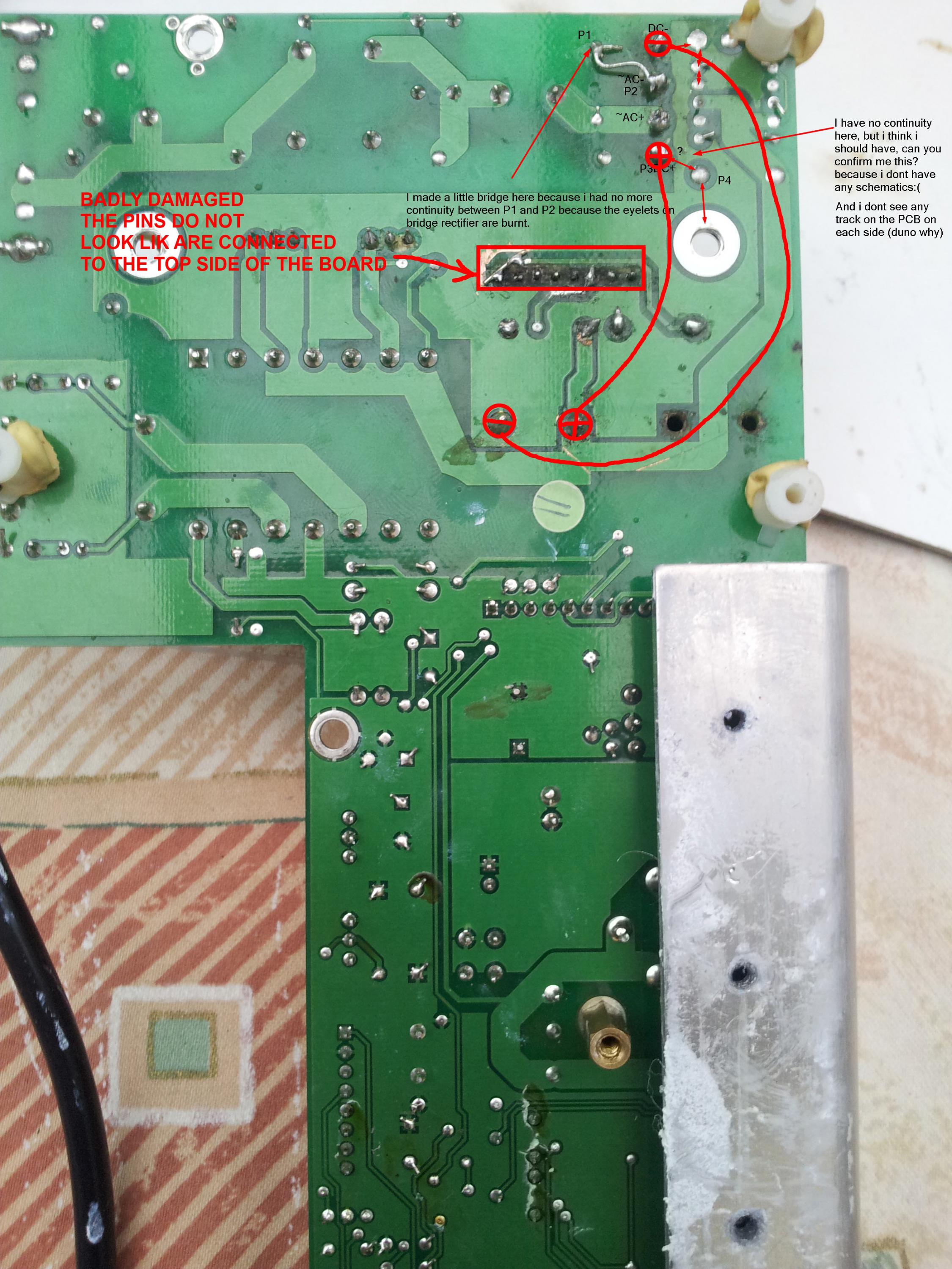

    Pictures of the bottom side of the board so we can trace out the connections of the secondary side of the transformer to see how many output windings it has?
    • int0x13
      • Nov 2012
      • 42
      • France
      Re: Troubleshoot SMPS board with laboratory power supply
      Here you are
      https://dl.dropbox.com/s/u1tti1r6syy...13556.jpg?dl=0
      You can find some high rez pictures here as well:
      http://forums.extremeoverclocking.co....php?p=3774040

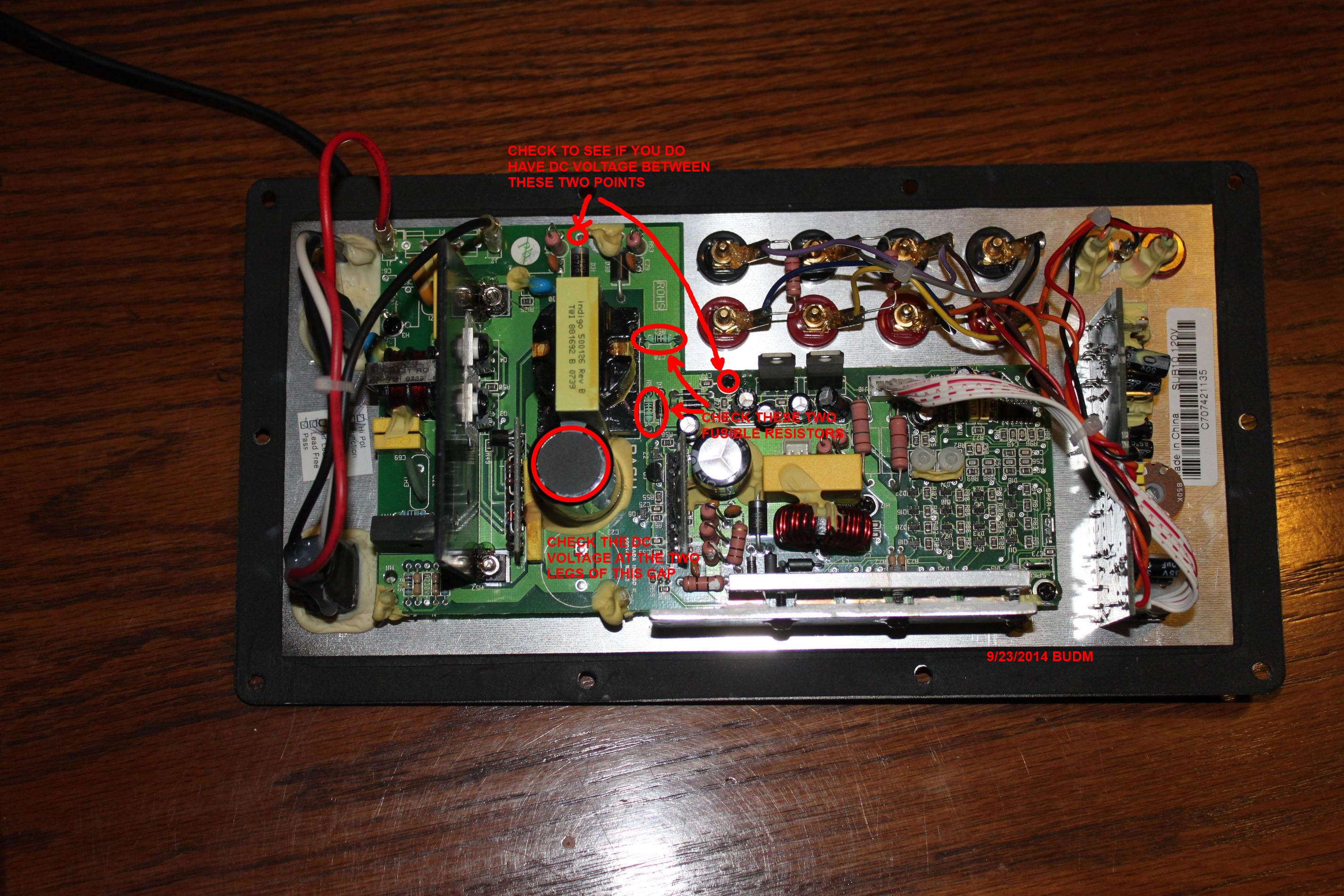

        OK, some test points to test. There are many power supplies in the secondary side.
        Be careful when test the Voltage in the primary side.

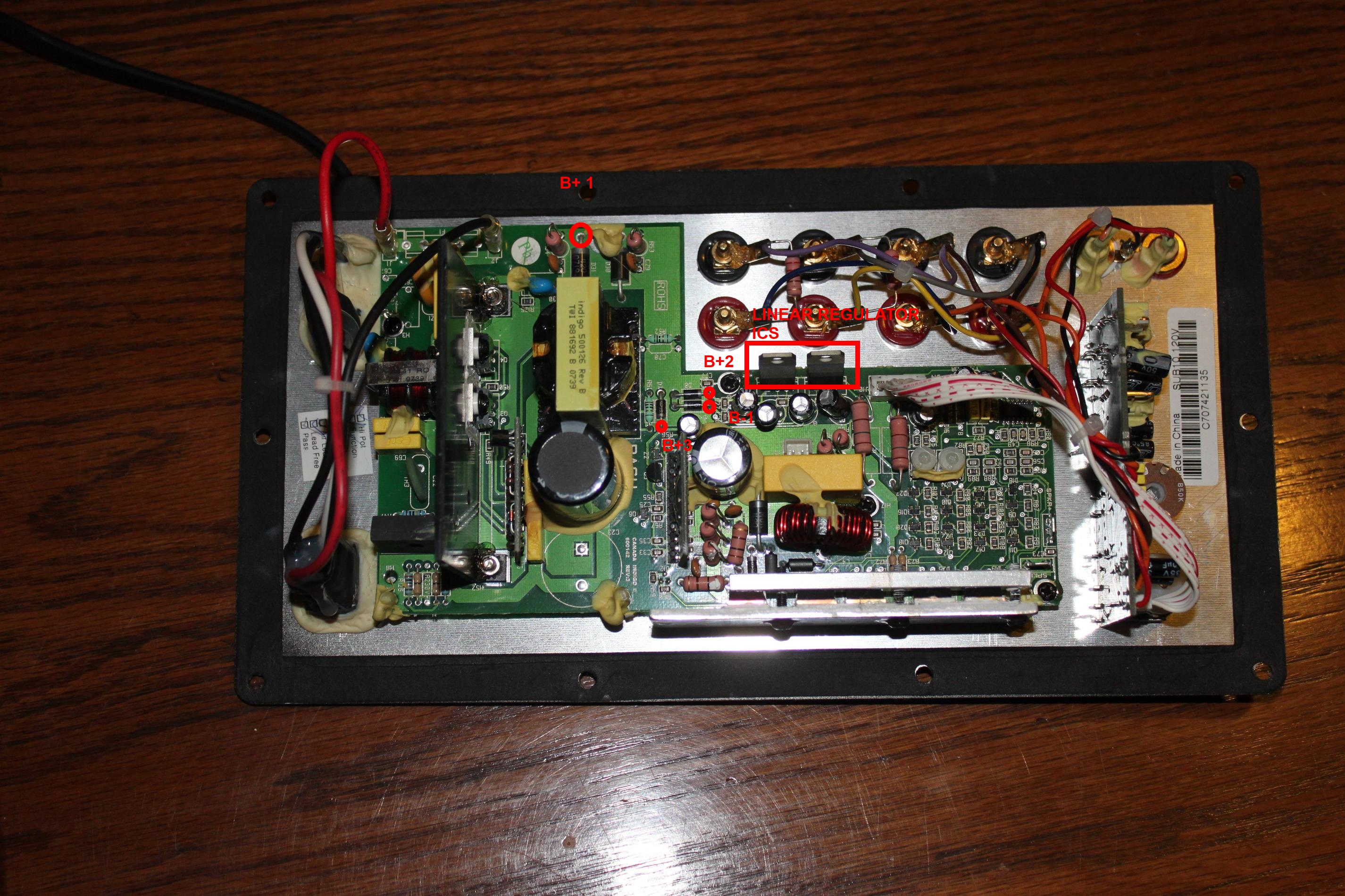

          Excuse me but i dont understand what you mean on the photo1?
          What is b-1, b+1, b+2, b+3 ? It is rectifying diodes, normally there is 4 of them. You say to put the bench power supply on those diodes point?
          About the regulators i know i should put +15v on the output, but on each chip or only one? And the ground on the regulator ground?
          Can you detail a bit more, its the first time i try this experience i dont wana make mistake.
            "What is b-1, b+1, b+2, b+3 ? It is rectifying diodes, normally there is 4 of them. You say to put the bench power supply on those diodes point? " There four outputs (3 positive supplies, and one negative supply) from that power supply, the problem is to figure out what the Voltages should be at those output side of the Diodes.
            Those two regulators, one should be for the Plus and one is for the Minus supply for the Opamp to operate. You should look at the P/N as printed on the body of those two regulators. Since I do not have the board in front of me to look at, I assume they are regulator ICs.
              Did you also check the DC Voltage at the test point as shown in pic# 2? and did you check the fusible resistors?

                Im currently trying to repair the cut tracks before i try to switch on. Ive managed to find out another kipsch service manual, you can see on page 18 the primary side of the amp here:
                https://cdn.badcaps-static.com/pdfs/...327121b6a0.pdf
                The regs are 7815 and 7915. Somebody told me i should put 25V on the diodes first then after suppy the regs with +15v and then the amp should work.
                        Seems like there is no EDIT in this forum?
                        here is my current situation:
                        http://xfaktor.free.fr/20140924_170711_comments.jpg
                          The board looks like it is beyond repair, since I do not have the board in front of me, I think the Negative of the Bridge should have connection to the Negative of the main filter cap, the Positive of the bridge should have connection to the Positive of the main filter cap.
                            Yes, but this power supply is not standard as there are some resistor and a fuse between the bridge and the 2 main filter caps, and also 2 yellow X cap (the ones just between the daughter board and the filter caps).
                            https://www.dropbox.com/s/r5548uni2e...72603.jpg?dl=0 and here http://i.imgur.com/L14Q8.jpg
                            I think this board is good for the garbage too, but before id like to try the trick with my lab PSU on the secondary side. Did you read my previous quote:
                              Yes, I did read the previous, you will need 4 power supplies: +25VDC (Negative of this power supply will be connected to the circuit ground) for the B+1 for running the power amplifier section..
                              +20VDC (+ connected to the B+1, Negative connected to the circuit ground) for for the B+2 for feeding the +15V regulator, -20VDC (Negative connected to the B-1, Positive connected to the circuit ground) for the B-1 for feeding the -15V regulator.
                              The B+3 will be the problem one since we do not know what voltage for that will be.
                              This amplifier is Class D Bridge mode to run off the single power supply instead of from BI-POLAR power supply like the shown in the SCH in the link.
                              BTW, the pictures you posted (post 1) only show 1 main filter cap. Are the two caps connected in parallel?
                                Yes in EU version 220v there is 2 filter cap in parallel that's I think the only diff between EU version and us version. That's why I considered buying a spare us amps and solder one filter cap but I didn't find any spare amps plate. That's why I tried to repair the board although I think it wouldn't work because of the bad shape of the PCB.
                                About supplying the secondary my bench PSU has only 2 Chan+1 aux 1-15v so I miss one in any way. The original guy said only 2chans is enough. Anyway ty for help. I wanted to ask u how did u find out that the transformer had X number of output voltage ?

                                    BTW I've tried to power supply the +20v and -20v on the 2 output diodes as u said and the regs are working:
                                    I got on the output white J10 connector:
                                    Pin1:20v
                                    Pin2:-20v
                                    Pin3 to 5:0v
                                    Pin6:-15v
                                    Pin7:0v
                                    Pin8:15v
                                    I was wondering why not use the same lab PSU channel to supply the +20 and the -20v (with 2wires in parallel of the 20v ones)? That would keep me one free channel for the main 25v right?
                                      You can use the +20V output to feed b+1 and the b+2, but the b+3 we do not know what that voltage should be, there should be a cap connected to that b+3, then you can estimate what the voltage should be
