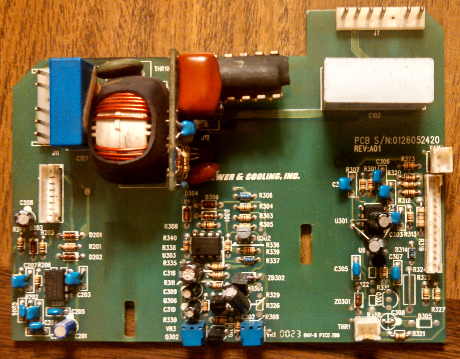

Replacement Capacitors for PC Power & Cooling, Inc. Turbo-Cool 450ATX Power Supply
  • Almighty1
    • Apr 2014
    • 222
    Re: Replacement Capacitors for PC Power & Cooling, Inc. Turbo-Cool 450ATX Power Suppl
    Interesting since it seems like they can just sell the same stuff at different offices.
    Can one actually replace the aluminum caps with polymers for those that something comparable is available while keeping the other ones the same as the original?
    Speaking of which, it appears Panasonic has bought Sanyo and now Sanyo is part of Panasonic, I thought they went bankrupt because of all the lithium-ion battery issues.
    Would this work as a replacement for the Sanyo OS-CON 25v 2.2uF 6mmx7.5mm Polymer cap since it seems Panasonic's lowest is 6.8uF which is a little over 3x the original capacitance?

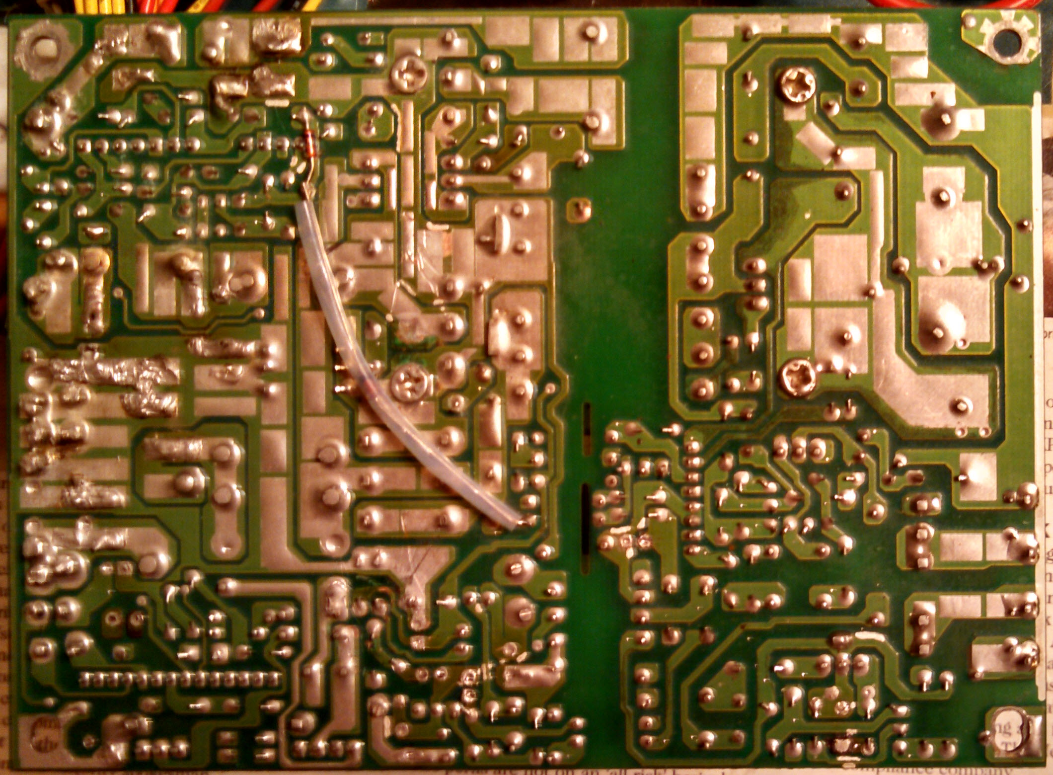

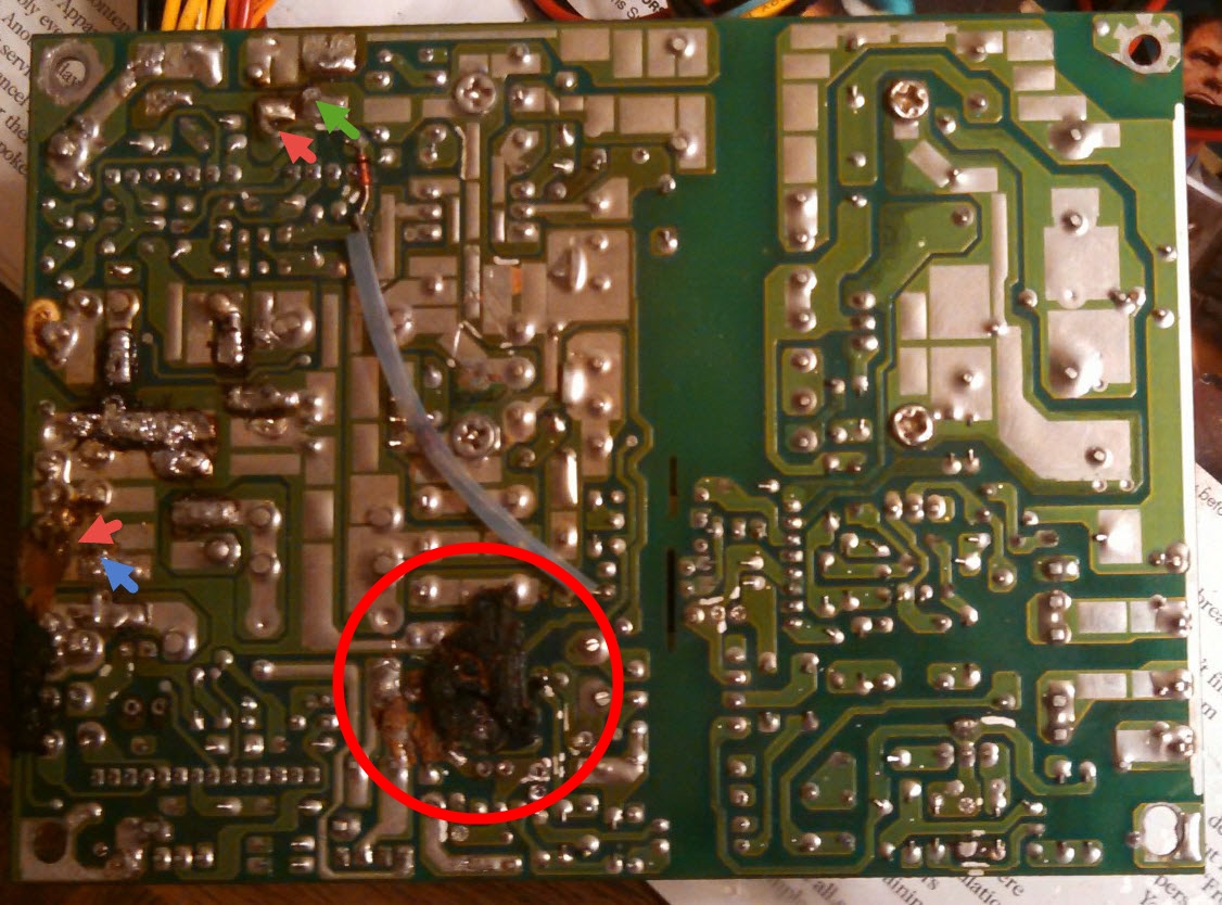

            Is that bad brown corrosive/conductive glue on the soldered side of the board?
            Glue on the top side also?

              budm:
              Not sure what it is but it was basically what was between the copper board and the main PCB other than the two solder joints to keep the boards together so it's leveled so one side won't have a bigger gap than the other it seems as the side of the copper board facing the main PCB is not touching the main PCB, only the copper side rests against the power supply chassis.
                From what I can tell from the picture, the darker brown are dry out bad glue and you see the lighter color smaller size glue that did not turn brown yet, the dark brown section is probably brittler and comes off easily, you should remove it and inspect that real well to see if the traces is damaged, that conductive glue can also cause malfunction to the circuit.
                https://www.badcaps.net/forum/showthread.php?t=34692
                • Almighty1
                  • Apr 2014
                  • 222
                  Thanks for pointing that out budm, what can I use to remove the glue and what can I use in it's place that I can get easily?

                    #29
                    I do that mechanically with sharp screwdriver (but be cautious not to cut the paths here), with long nose pliers or with dental explorer. There is not much possibilities to soften this thing.
                      There is atleast 3 spots where there is this glue as you can see on the left edge. I think it's that clear plastic tube right above where you circle in the picture that basically levels the board. Wouldn't something like Goof Off be able to remove it since I remember that was how people removed things like thermal pads of heatsinks. Seems like I can just use hot glue in it's place as that should be non-conductive. I just tried taking it off, the almost black one is like rubber so it will break off, it's the ones closer to the board that is light brown that is harder to take off as it's brittle.

                                budm:
                                Took me about 15 minutes, basically I used Goo Gone with a toothbrush and then used a mini flathead jewelers screwdriver, the lighter colors as in yellow to medium brown were the ones harder to get off since it was hard while the black colored area was closer to feeling like good year tire rubber and wasn't that hard to get out. I then rinsed it with water followed by 70% Isopropanol as I read Goo Gone uses petroleum so wanted to be safe than sorry. So basically got 99% of it away including cleaning the burned flux. The traces are fine except about 1% of the the green coating in the solder mask came off exposing the bare copper. Looks like they caused their own scratch during manufacturing with that big black line.
                                  #36
                                  Good job, nice and clean.

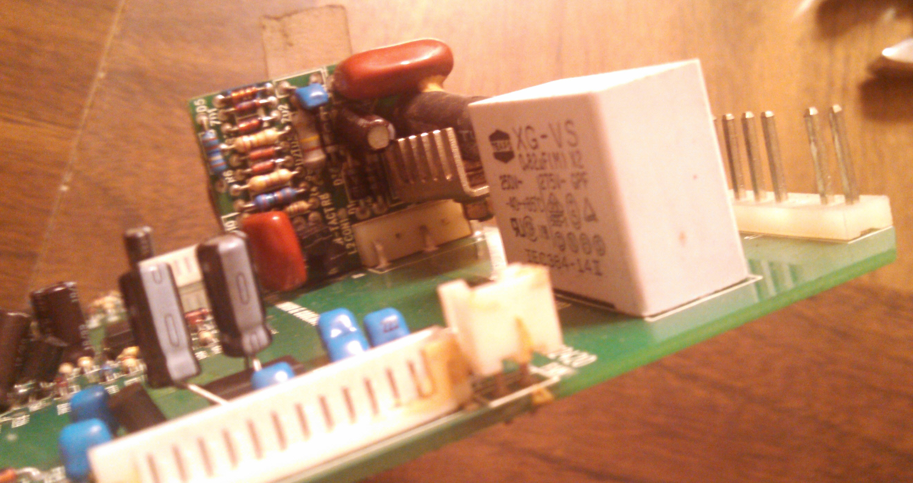

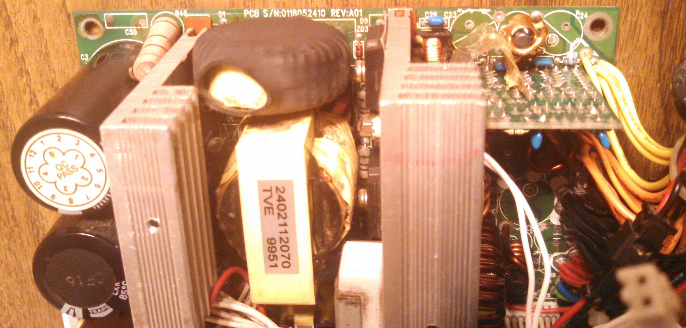

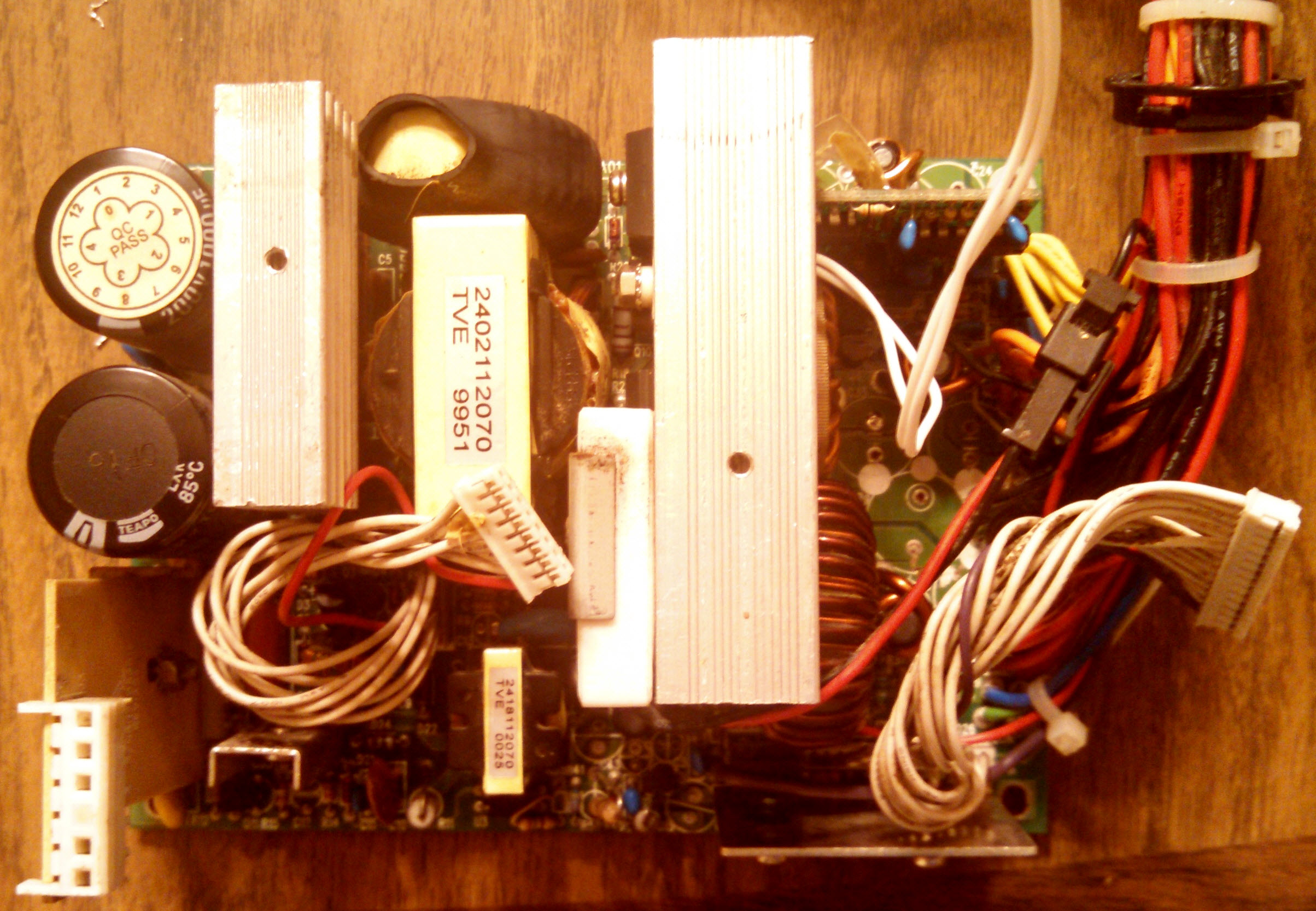

                                          Forgot to post pictures earlier which I have just taken consisting of both the daughter board and main PCB...
