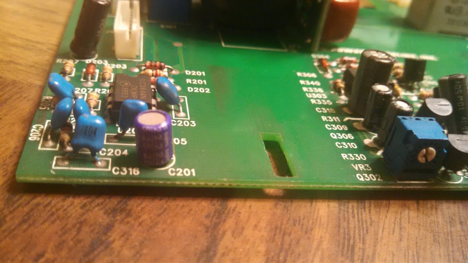

    Greetings:
    It appears that the capacitors in my PC Power & Cooling, Inc. Turbo-Cool 450ATX Power Supply need replacement. This power supply appears to be made by WIN-TACT Corp as the two circuit boards all say PC Power & Cooling, Inc. on them but one of the boards has WIN-TACT Corp stamped on it. In any case, I'm not sure what replacements to get, if I can't find something with the exact voltage or uF, would there be problems using something with a higher voltage of uF rating or what's the correct way to go for it? I bought the power supply in I think 2000/2001 which was used on a Pentium 3 and later a Pentium 4 with the P4 power adapter later on. All the capacitors are dated from 1998-2000 as the quality check date is August 2000. The power supply died once in 2005 or 2006 when it would shut off by it's own while I can still boot the system afterwards and I sent it back to PC Power & Cooling for warranty repair, it seems the capacitors replaced 3 x Hermei 10v 4700uF 0436 at c40, c35, right of c35 with the date code 0436 (36th week of 2004) and the 1x Teapo 10v 6800uF (swollen & leaking) September 2004 datecode at c39.
    In any case, this is the capacitors list as I basically de-soldered all the capacitors as the voltage and uF was on the side I can't see:

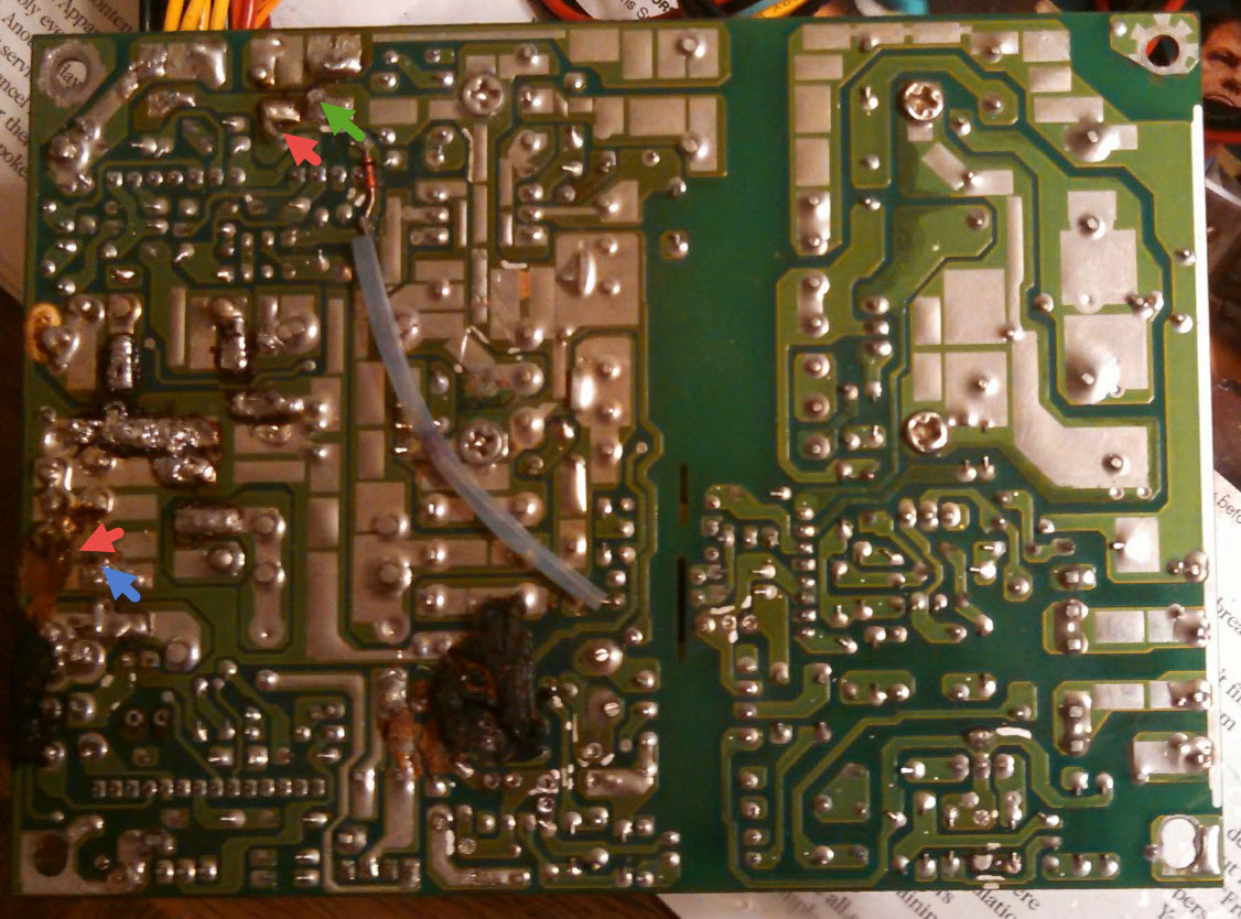

    There is a small circuit board which has nothing on one side which has two soldered connections to the other side which is copper from the bottom of the main board. I can only find one of the connections as the other one is probably one of the pins from one of the capacitors I de-soldered, anyone know if this is important and what is is used for? Thanks in advance for any assistance!

                1 x 25v x 2.2uF 6mmx7.5mm - see attached picture
                Not sure if this is 25v 2.2uF or 25uF 2.2volt, don't see anything with this uF rating anywhere.
                        Not sure if this is 25v 2.2uF or 25uF 2.2volt, don't see anything with this uF rating anywhere. odds are a sanyo cap is good looks like UCC KY is available in 2.2 uf 50v 5mm diameter if you want to replace it though http://www.digikey.com/product-detai...1595-ND/756111

                          My other question is that on the bottom of the main PCB, there is a another plain PCB mounted to the main PCB that has no traces or anything on the side facing the main PCB but the other side is copper and has 2 connections or 2 holes on the entire board, one seems to connect using a soldered small wire to the same trace as the negative (-) side of (c23) 16v 4700uF capacitor. The other one I am not sure as apparently the soldered wire broke off when I desoldered it but the hole basically matches up with the negative (-) side of (c40) 10v 4700uF capacitor. Is this board required since I'm worried if c40 is not the correct location, it might mess everything else up since I have no idea what it is used for and I don't see anyone else has this power supply.

                            If the board was there originally, then it probably is required. Hard to say for sure, though. Also, I wouldn't bother replacing the 2.2uF cap which you posted a picture of before, it's a Sanyo OS-CON, which are a polymer cap and are very reliable.

                                  Didn't know what that copper piece is called, it does have two holes at the upper and lower corner where the two screw standoffs from the chassis goes for screwing down the main PCB to the chassis with the copper plate sandwiched between them. The copper side of the copper plate touches the chassis.
                                  I'll include a picture so it might illustrate it better as far as the main PCB is concerned.
                                  The top red arrow still has the soldered wire on it which was soldered to the upper hole on the copper board. The green arrow is the negative (-) leg of the 16v 4700uF capacitor. Am I correct that the top red arrow and the green arrow is internally connected and the wire can basically be at the green arrow and it'll still do the exact same thing?
                                  The lower red arrow is where the other hole on the copper board directly sits on top of. I found a broken wire with solder in the same box I put the copper board by itself so it was probably stuck to the copper board when I took it off. The blue arrow is the (-) leg of the 10v 4700uF capacitor. The other soldered joints in that area are untouched so it should be correct so not sure if connecting the negative side of two capacitors to a copper board as described above would do any harm. I accidentally bridged the area above the lower red arrow and will fix it when I get desoldering braid since I don't think the manual desoldering bulb or pump will help fix that problem.
