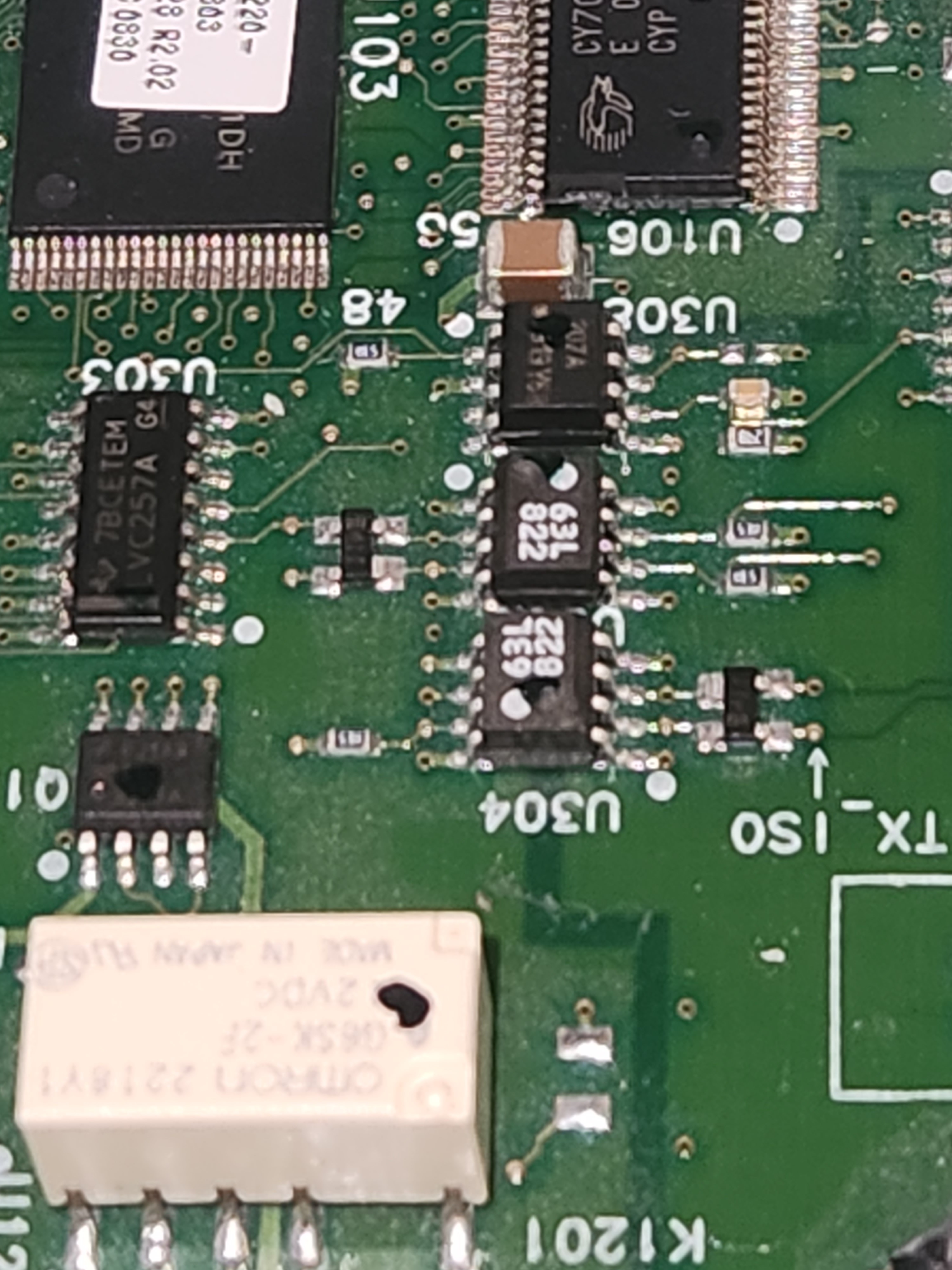

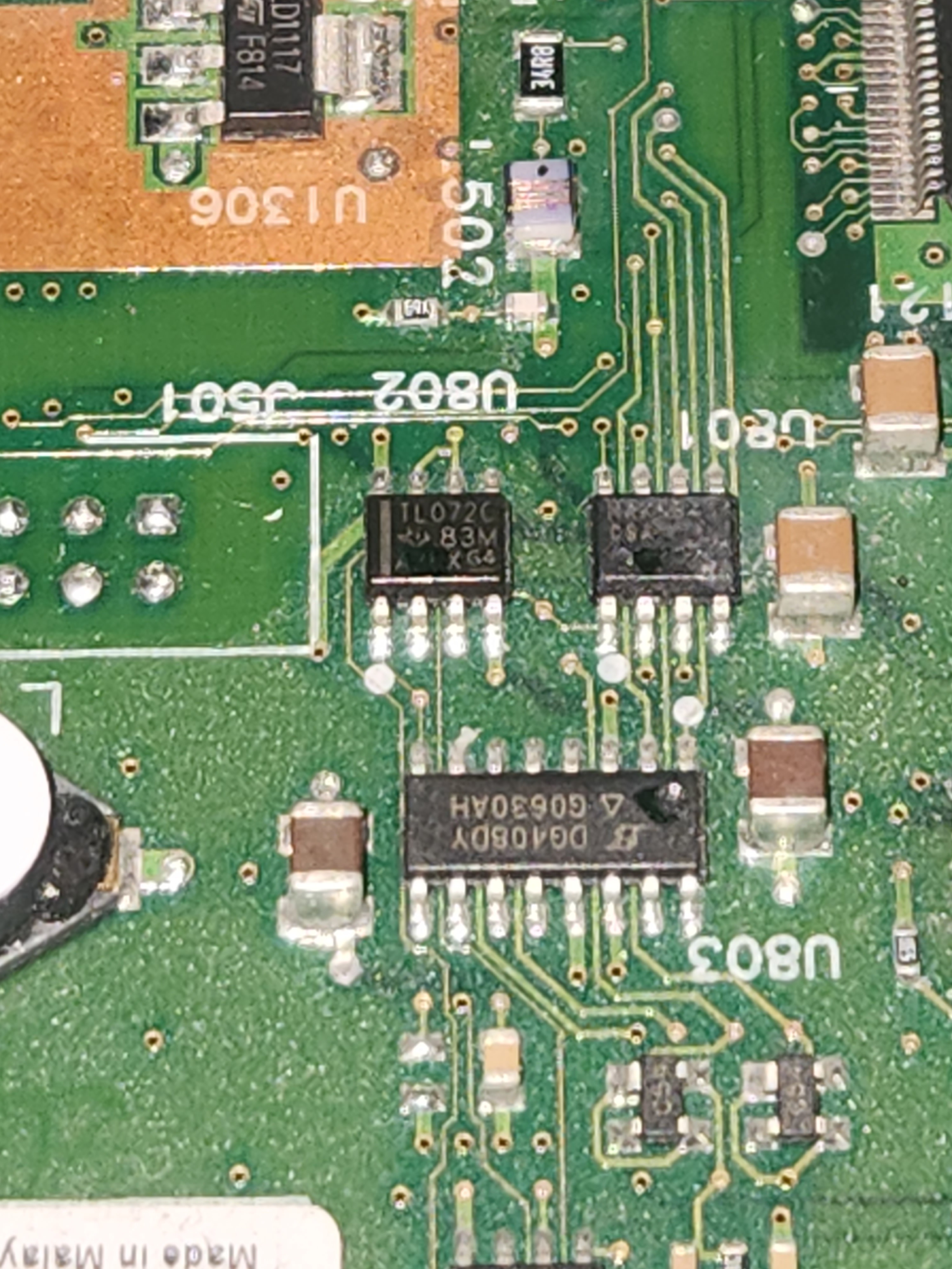

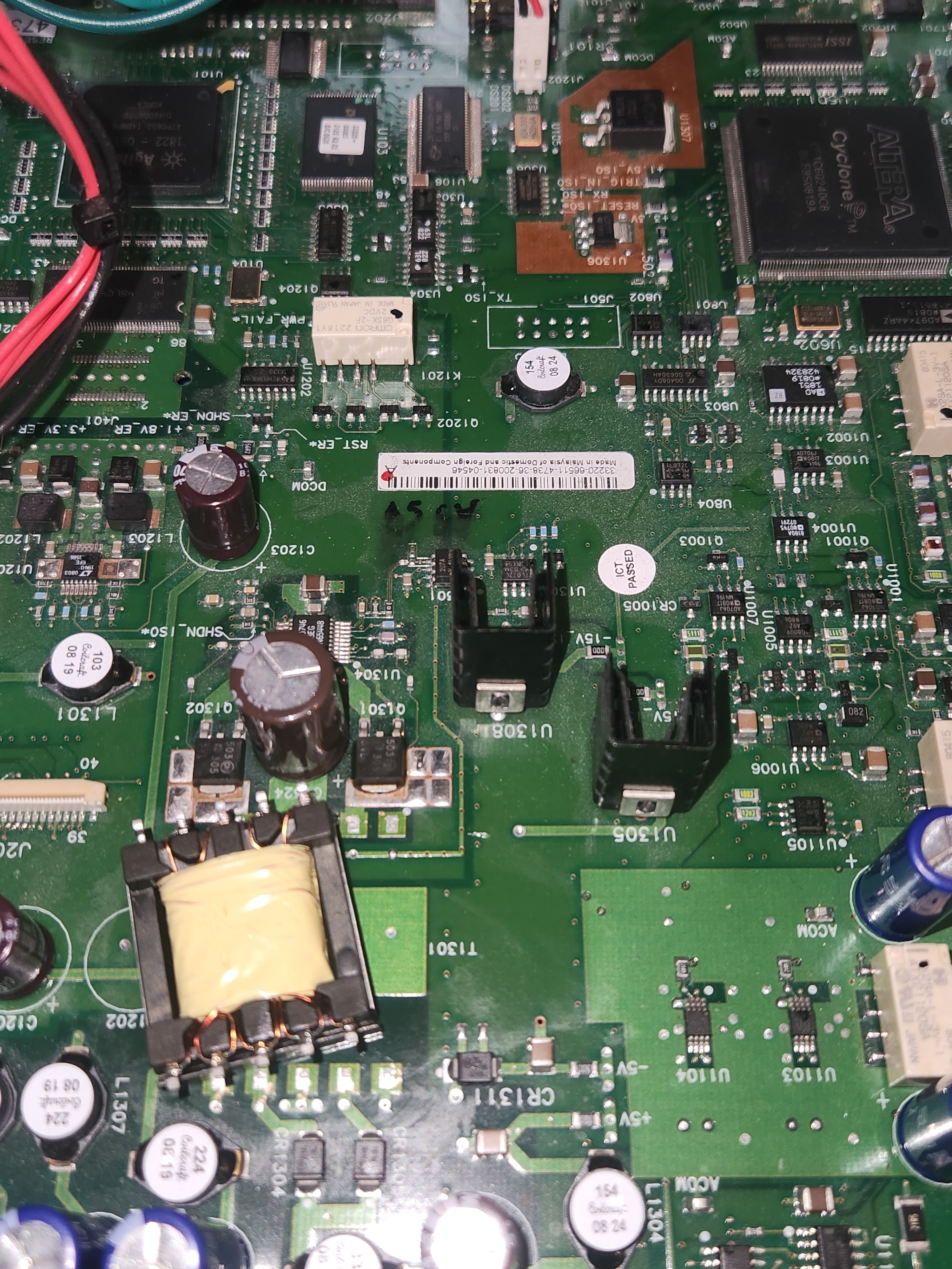

    looks like most ICs have some marker / dots on them. I took some photos below. I wish I were 20 years old.. no, this 50 plus can hear it. Seems to change with frequency output - I hear it most prominent at 650 Hz and up.. as you change the output frequency, it's like you're playing a musical instrument.

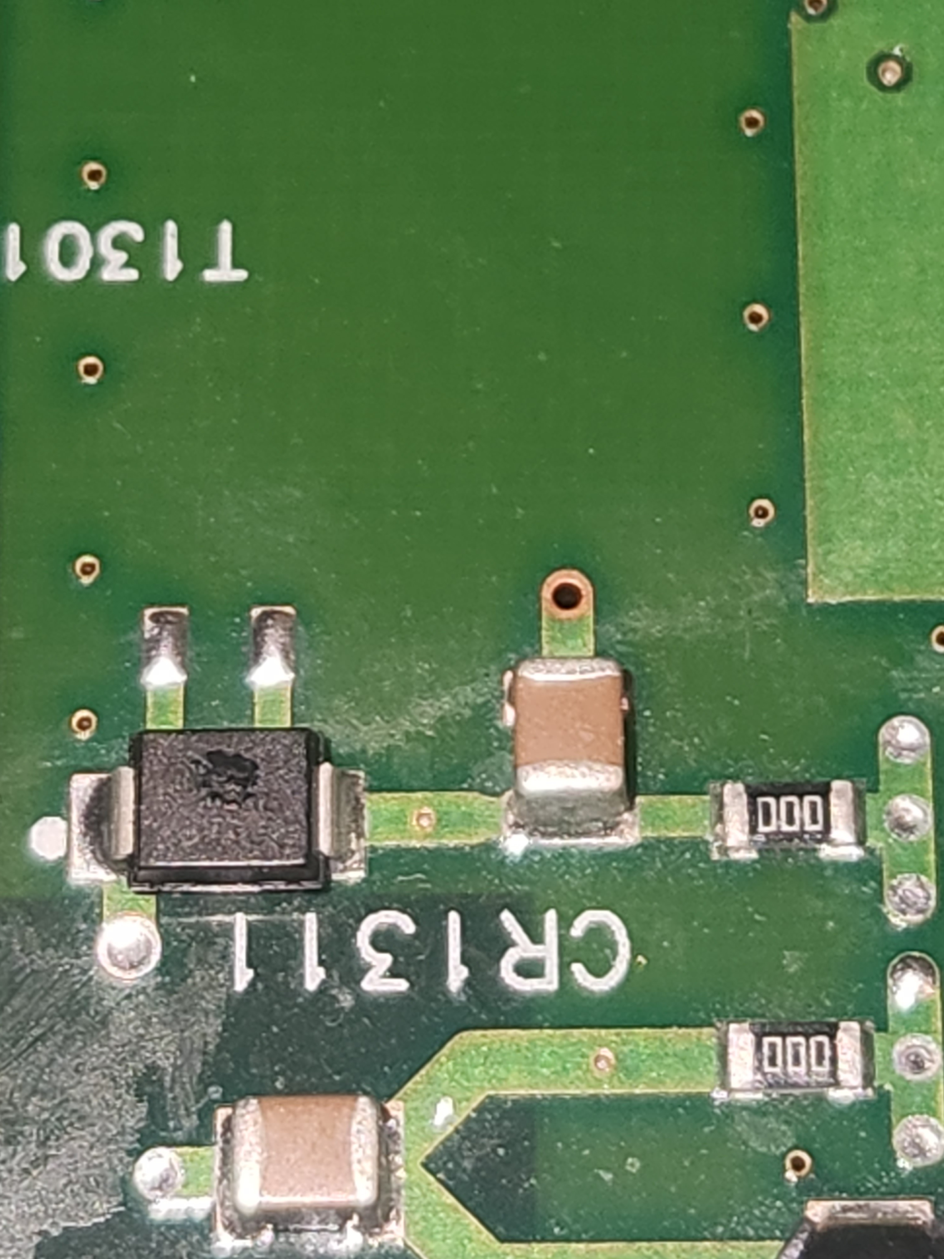

      Look at the tab of Q1301 and Q1302 and some other components around that area... almost like Agilent was saving on solder?

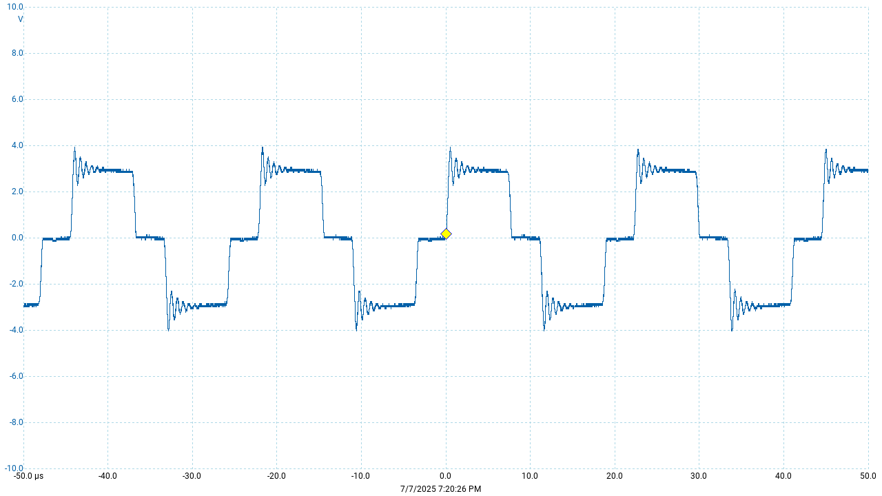

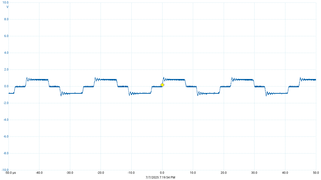

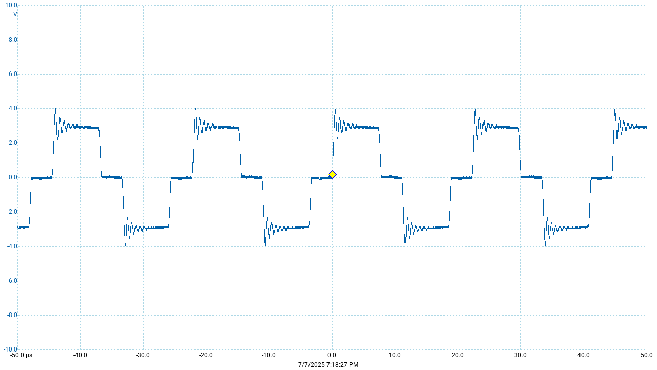

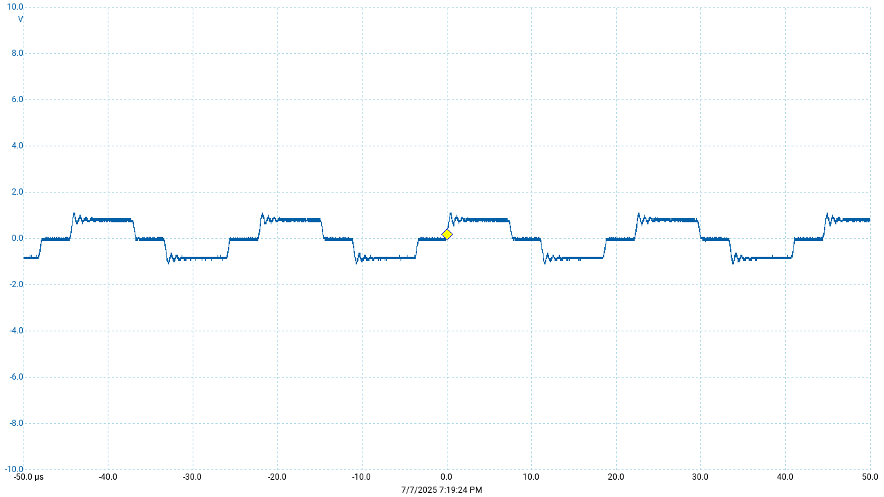

        Well, this is a bit anti climactic / bitter sweet - so I had taken the transformer off the board to replace it - a replacement is not available, this is custom transformer specifically made for Agilent. In order to get the plots R_J asked for, I soldered it back on, and miraculously the audible noise seems to have disappeared! I still got the scope captures at the output pins of the transformer, reference to pin 8 of the transformer "ACOM"
        Seems to have been solder joint issue? Does anyone have other suggestions? Thank you for the help folks - great team as always. hover over the plots below as the name indicates where it was taken

          • 31250
          a fix is a fix.
          in the old days we used to resolder all transformers and heatsink-mounted parts before even thinking about the fault.
          cracked solder was that common

            Yes! That could have been an issue! Just not enough solder and with all these years of heating and cooling or a little corrosion they can cause weird issues. Basically anything that gets hot and the transformer. Just about the same we used to treat old stubborn TV’s. Call it a win! To me it just really looked liked Agilent was skimping on solder. My next step would have been to resolder all these components with 60/40 solder and see what that gives.
